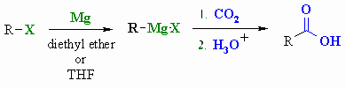

I would like to do some experiments with making methanol or maybe a CO generator down the road or maybe some other things that use CO2. I know CO2 can be used to make carbonates when bubbling it through hydroxides or oxides but other than that, I'm not sure what I could use CO2 for so I'm open to suggestions to that.
You could always use CO2 to make carboxylic acids from alkylhalides in grignard reactions.
True, but your carbon dioxide must be very dry and reasonably pure (unlikely if you're generating it yourself then storing it in an old cylinder). Using dry ice is far easier and more common when preparing carboxylic acids from organometallic reagents.
