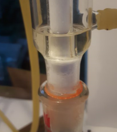

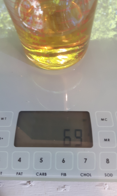

The first time, 37 grams of urea and 57 grams of propylene glycol (Henceforth referred to as PG because i’m lazy.) were mixed along with slightly less than one gram of Zinc Oxide in a 500ml Erlenmeyer flask. A reflux with a 200mm Liebig condenser was set up, and the heating was turned on. (Just using a small electric hotplate and sand bath) Both times I had the gas being piped out through a vacuum take-off adapter from a distillation that I had put on top of the Erlenmeyer, but I do not have the required vacuum pump for this purpose. All reactions were carried out under atmospheric pressure. With the heating on, the white opaque liquid that neither the Urea or ZnO had fully dissolved into yet started to boil off and condense into the condenser. A white solid covered the inside of the condenser, as was described in the original post by oscillator. (More on this later.)
img1.png - 163kB
(Note: The orange colour at the joint is the grease I use, and the slightly yellow colour inside the cooling tube is because I use rainwater as my coolant.)
3 hours later, no more ammonia was being produced, and the final yield was 71 grams, about 67ml, of an amber coloured liquid.

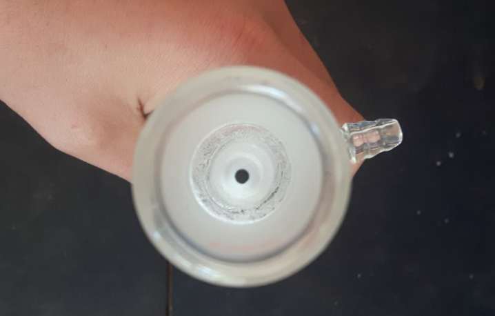

While I was doing cleanup, I noticed an extreme amount of the mystery solid in the condenser. Unlike Oscillator’s reaction, that only a small amount was produced and ended up on the inside, my condenser was completely opaque with this solid. Near the bottom of the condenser, there was only a tiny pinhole through which any gases could leave.
img3.png - 197kB

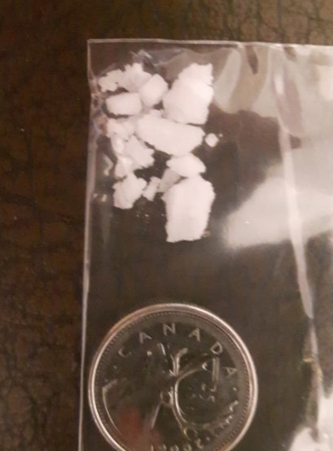

While cleaning, I managed to pull some bits out and put them in a small baggy. Canadian 25 cent piece for scale, not actually inside the bag. I might look more into them in the future, but I don’t really care enough to bother trying to find out right now.
img4.png - 260kB
I believe it is recrystallized urea, forming on the inside of the cooler condenser. The second reflux I did, I used slightly less urea and slightly more PG because I didn’t want to end up plugging my condenser. The arbitrary ratio was 35:60 grams urea: PG respectively. Two and a half hours later, the trap was producing no more bubbles, and the reaction was stopped. The final yield for this time was 90 grams, and about 90 mls, but it was contaminated with water from the ammonia trap that ended up sucking back into the reflux setup. It was also a slightly different colour. However, there was noticeably less of the mystery material in the condenser, so I guess a step in the right direction.

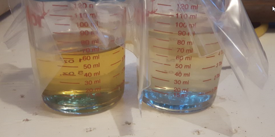

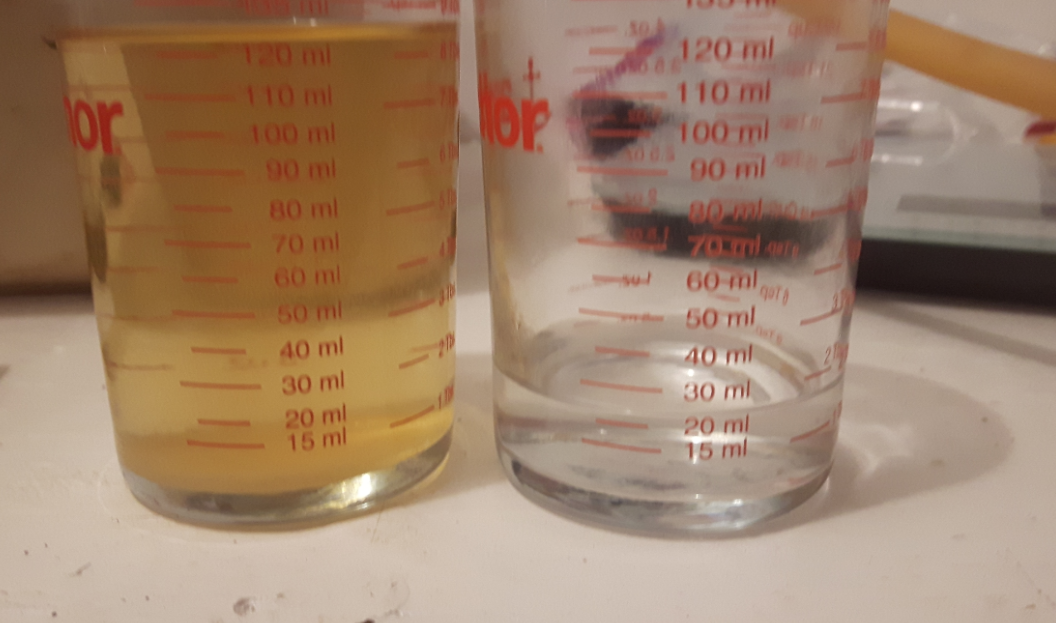

Nonetheless, I decided to combine them in a 250 ml RBF and proceed with the distillation. Again, it was put in a sand bath, with a bubbler trap. Over an hour, the temperature rose to 90 C., and a large amount of water (and probably some other stuff.) came over into the receiver flask. Over the next half hour though, the temperature at the still head remained steady just around 90 C, no matter how much tin foil I wrapped around it. An hour and a half after starting, I accepted defeat and turned off the heat.
In the receiver was 25mls of what was, according to my knowledge and limited test equipment, water.
The boiling flask contained 125mls of an amber coloured liquid. Comparison below.

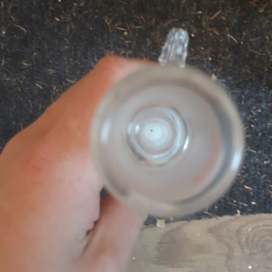

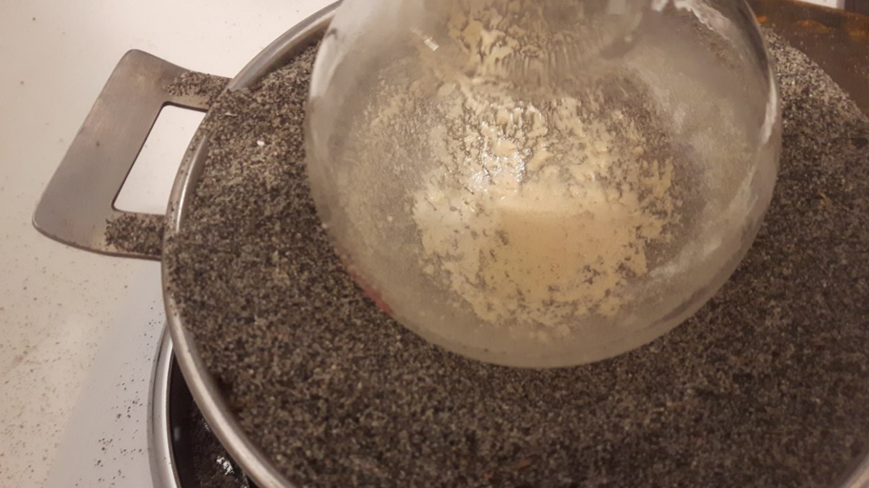

Interestingly, there was a large amount of some off white precipitate in the bottom of the RBF.
img5.png - 1.1MB
Oh well. It was a failure for the main reason that I didn’t get >100 mls of <5% impurity propylene carbonate. If anyone knows ways I could get the temperature at the still head up by almost 300%, i’ll continue this, but otherwise I’ll leave the hotplate for someone with greater ability than me.

deltaH suggested that the white powder in the condeser might be ammonium carbonate. Perhaps a drop of HCl (to observe fizzing), followed by a drop of NaOH solution might resolve this?
I'm excited that you are working on this, well done!.
Can you get to an oil bath (I sometimes use baby oil - cheap, clean, safe)?
Keep us all posted!
ps: a work in progress is not a failure, and certainly not when so nicely written up.

I seem to recall at some point that I used an aspirator as a vacuum during the refluxing of PG and urea. This is probably what caused me to have less of the mystery white substance (probably ammonium carbonate) than you, because ammonium carbonate tends to sublime away at low pressures. I think maybe one way you could improve your reaction in lieu of a vacuum is to find some other way to help remove the ammonia from the reaction to drive it forward. Perhaps bubbling plain air through the apparatus could work? That's just an idea though...
With regards to not being able to raise the temperature above 90 degrees, you didn't mention if something was coming over then? if it wasn't then having a temperature like that just means that you are measuring the temperature of the hot air inside your flask and not anything meaningful. If you did have any propylene glycol present the best way to remove it would be to raise the temperature only slowly, discarding the first fraction (like you did) until the temperature reached near the boiling point of PG. the fact that this didn't happen to you is either because you didn't have any PG, or because your heating wasn't powerful enough. Looking at you sand bath the sand seems quite thick so I would recommend placing a thermometer in the sand to measure its temperature too. If it is less than the b.p. of PG, then you know what your problem is.
Either way you've done some great work here and made an excellent first post, well done. I look forward to your future efforts!
