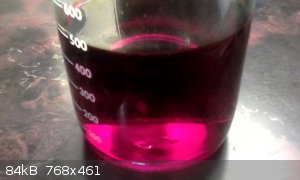

Shortcut Lab Preparation of 2 2/3 M Chromic Acid Reagent from Sodium Dichromate
199 grams of technical sodium dichromate dihydrate was added to a media bottle. The weighing dish was rinsed 3x with a small amount of distilled water (~30 mL total) and the washings were added to the bottle. An additional 100 mL of distilled water was added to the media bottle and it was shaken until nearly all of the sodium dichromate dissolved. The dissolution of sodium dichromate is endothermic, and the outside of the bottle became cold. 289 grams of 90.5% sulfuric acid were then slowly added, generating considerable heat. Towards the end of the addition, a voluminous precipitate formed, probably chromic anhydride. The funnel and flask used to add the sulfuric acid were rinsed and the rinsings added. The solution was diluted to just under 500 mL. Two layers were visible in the bottle, a lower layer that contained the undissolved chromic anhydride, and an upper layer consisting of more dilute solution. An egg-shaped stirbar was added, but though stirring was evident, it could not effectively agitate the mixture. The bottle was swirled, causing the upper layer to gradually grow until it filled most of the liquid portion of the bottle, and then the last of the precipitate was dissolved under magnetic stirring, resulting in a homogeneous, cherry-red solution. The solution was then diluted to just under 500 mL and allowed to cool.
IMG_20170624_203313[1].jpg - 84kB
Notes:
Next I plan to remove and rinse the stirbar before diluting as close as possible to 500 mL and labeling the bottle. I have no plans to use the solution for volumetric work, and an excess of Jones reagent is typically used, so high precision is not necessary. I can easily get two significant figures by simply diluting to the bottle markings. If more precision is required, carefully dried and measured reagents should be mixed in volumetric glassware, and I would consider more dilute solutions of potassium dichromate.
I read Jones' original paper on his reagent, discussed by S.C. Wack here, before writing up this procedure: http://www.sciencemadness.org/talk/viewthread.php?tid=24744 The solution prepared here is clearly not exactly the same thing the reagent that Jones specified in his paper, but it's very similar. Is there anywhere this solution cannot be substituted for Jones' reagent?
It looks like Jones used 2.67 moles of chromic anhydride (which he referred to as "chromic acid") in 3 moles of sulfuric acid, diluted to one liter. It's possible to make chromic anhydride from sodium dichromate, but it's definitely easier to use sodium dichromate and additional sulfuric acid.
I have noticed that often, the exact concentration of Jones reagent is not specified in procedures in the literature. When concentration is specified, it appears that the most popular is 3 M, with some procedures calling for 2.75 M.
It might be technically more accurate in some contexts to state that the solution contains NaHSO4, but most of the time, it's reasonable to consider this formulation as a ~2.67 M Jones reagent with sodium and sulfate spectator ions. Right?
[Edited on 25-6-2017 by JJay]
