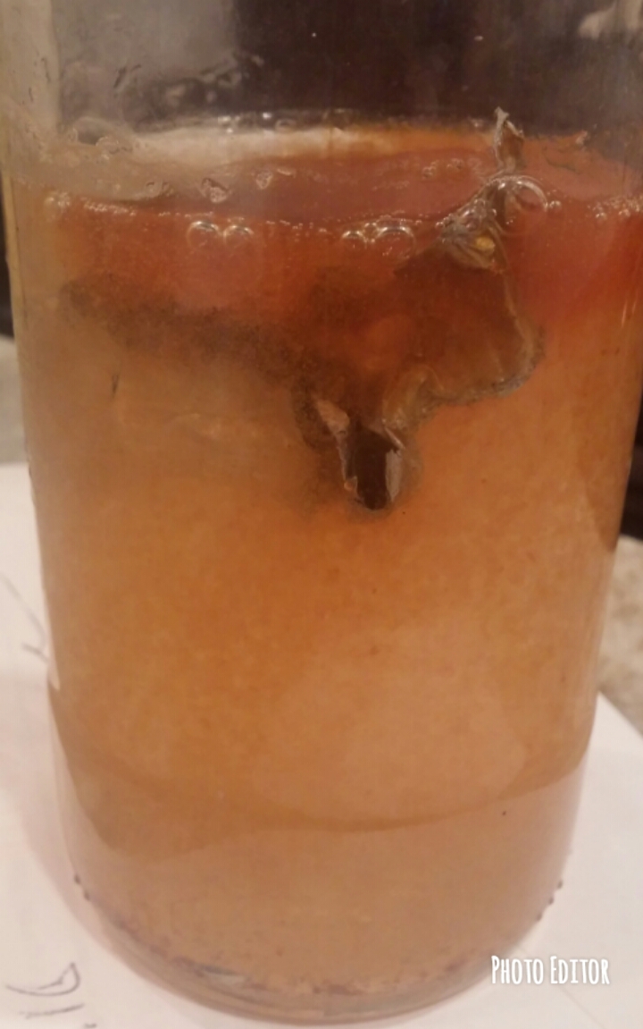

Preliminary Experimental Results
Fascinatingly within the first few hours, a small viscosity difference was apparent in the solution. After 24 hours, evidence of a reaction increases, which regardless of its to be determined precise products, is nevertheless supportive, in my opinion, of the concept of a direct acidic radical attack.

Start of reaction pictures:
Photo Editor-20180925_094356.jpg - 246kB
Photo Editor-20180925_094319.jpg - 270kB
[Edited on 25-9-2018 by AJKOER]

[*] posted on 25-9-2018 at 06:12
24 hours latter, more viscosity....
Photo Editor-20180925_094245.jpg - 202kB
Photo Editor-20180925_094213.jpg - 173kB

[*] posted on 25-9-2018 at 07:17
Is that aluminum foil?

[*] posted on 25-9-2018 at 08:38
That is, indeed, aluminum foil that has been heated in a flame (in places till it is red).
Apparently, the heat treatment removes any protective coating and weakens the annealing process (which makes the Al foil seemingly inert). Here is an extract of my prior comment on this topic:

[*] posted on 26-9-2018 at 06:15
Now, at 48 hours, a fluffy white precipitate visible. The aluminum foil displays only minor degradation.
Photo Editor-20180926_085712.jpg - 364kB
Photo Editor-20180926_085459.jpg - 329kB

[*] posted on 26-9-2018 at 06:52
Al/Fe/H2O2 with some NaCl System:
Picture on the far right is the pre-reaction mix without H2O2.
Note, the colored solution (without red) is likely ferrous rich and is formed quickly.
Per my reaction system outline above, the Fe(ll) is converted into red Fe(lll) in proximity to the anodic aluminum zone in the electrochemical cell.
Photo Editor-20180926_094750.jpg - 295kB Photo Editor-20180926_094545.jpg - 255kB
Photo Editor-20180926_095126.jpg - 372kB
