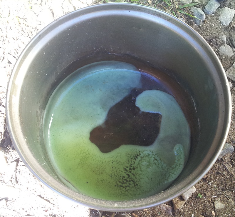

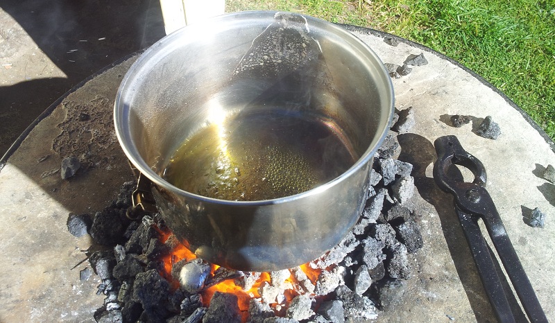

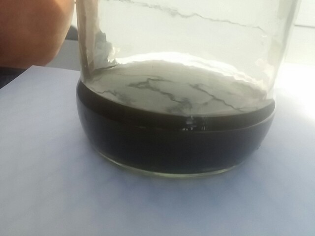

A couple of my own observations regarding potassium nitrate -> nitrite through thermal decomposition:
Over several batches, approx 250g KNO3 was boiled in a stainless steel saucepan for about 15 minutes. The source of the heat was a coke-fired forge that had previously proved itself capable of melting steel During the boiling, copious quantities of smoke was evolved.
IMG_20130803_104052.jpg - 197kB
When the molten salt was cooled down, it formed a distinctly green solid (greener than it looks in the photo). perhaps this is some kind of iron compound from the stainless steel?
IMG_20130803_105350.jpg - 211kB
This was then dissolved in approx 500ml of water, heated by placing it on the forge. This brought the 500ml of water to the boil in about 10-15 seconds :o. The resultant brown muddy liquid was filtered to obtain a clear yellow solution that formed brown fumes upon addition of HCl. When the liquid was cooled down, large quantities of needle-shaped crystals formed that proved to be potassium nitrate :mad:.
IMG_20130803_141450.jpg - 201kB
This solution was then boiled down and a second crop of crystals were formed. They had a slightly different shape, and I am not certain that they are KNO3 or KNO2, but I'm afraid the odds favour the KNO3. Irrespective of that, large quantities of KNO2 were formed in this process, as least enough that the evolution of NO2 was so great that the test tube almost bubbled over.
It is interesting to note that wikipedia and a number of other sources say that KNO2 explodes when heated above around 700 degrees. I am 90% sure this is not the case based on the fact that a rounded tablespoon of KNO3 was fully decomposed all the way to some black gunk that bubbled when water was dropped on it. Presumably this black substance is K2O. At any rate, it was sitting on top of a red-hot piece of steel and didn't do anything that could be described as an explosion :).
I do have a hypothesis regarding the entire method of producing nitrites by thermal decomposition: Is it possible that as the nitrate decomposes the formed nitrite also decomposes, so at no point in time is there a solution (if thats the right word) of 100% nitrate?

Nice try, but it was known thermal process works so so and need multiple fractional crystallization. Try to use lead or copper powder next time.
S.C. Wack - 4-8-2013 at 05:29
Boiling point 537 °C (explodes) may be total bullshit. Perhaps 700C is what it takes for this to "work" (15 minutes is probably still not long enough), as has been noted in this thread.
http://www.sciencemadness.org/talk/viewthread.php?tid=52&...
PS My summary of all this is: probably best done with some form of protection from O at a temperature not much below where N in some form is lost. No explosions IME.
[Edited on 4-8-2013 by S.C. Wack]
watson.fawkes - 4-8-2013 at 06:24
Chromium oxide, I'd guess. Stainless steel is stainless because it forms passivating surface coatings of chromium oxides. I'd guess you've liberated some of the Cr from the outer layer of the pot.

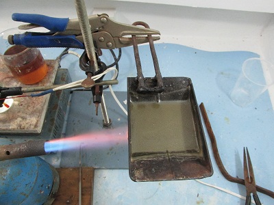

aga - 28-8-2016 at 07:43
To attempt to follow the Congo Red sysnthesis, 0.5g of sodium nitrite is required, hence this preparation.
According to this procedure :
http://www.prepchem.com/synthesis-of-sodium-nitrite/
71g of sodium nitrate and 172g of elemental lead was added to an iron vessel, then heated strongly with a blowtorch.
(this represents an excess of lead).
The mixture was stirred with an iron bar throughout the process.
After 20 minutes of heating & stirring, a pink scum was evident on the surface of the liquid, presumably PbO.
melted.JPG - 63kB

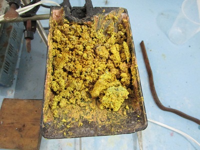

After 1 minute the mass began to solidify, so stirring was continued to try to achieve a small fragment size as per the reference.
The cooled mass appeared as a yellow/ochre 'rocks' with some pink showing, mostly in areas furthest away from the flame.
rocks.JPG - 77kB

Σldritch - 16-9-2016 at 06:02
Im trying too make nitrite by reduction with sulfur (2 NaNO3 + S + NaX --> 2 NaNO2 + NaSO4 + X2) and i have had some minor success with igniting what is essentially yellow powder with extra nitrate but i am trying to do this in solution now because of the explosion hazard.
When i tried melting sodium hydroxide and sulfur together i got red to orange goop and i poured it out on a rusty iron plate to cool to later add it to a solution of potassium nitrate. When i did i obtained a very dark green solution which mostly dispeared on boiling down the solution.
So what is the green compound? Iron complex with polysulfide or nitrite? Iron nitrosyl is brown and the ph is really high so i doubt that it would exist in the solution. I will post progress if i make any.
Sorry if this is supposed too go in beginnings not sure tough.
Melgar - 16-9-2016 at 21:43
Blue Fe(II)SO4 mixed with yellow sulfur would give a green color. Eventually, the iron II sulfate would oxidize to iron III, which is more of a yellow/orange/brown color depending on concentration.
Σldritch - 17-9-2016 at 13:13
I dubt that is what caused the color because it was very dark green to the point that after i washed out the beaker and neutralized some sodium bisulfate in it the color returned albeit not nearly as dark and it seemed to move down to the bottom of the solution.
Anyway the aqeous reduction with liver of sulfur was a failure as expected, worth a try atleast.
theAngryLittleBunny - 22-7-2017 at 14:49
I tried reducing KNO3 with tin today, and I think I should tell you what happend and why it isn't a good idea.
So I melted 62g of KNO3 in a metal can on a gas burner and put a 35g piece of tin into it. It obviously quickly melted and on stirring, within a few minutes a lot of gray SnO appeared and it seemed to be going well, the mixture became quite thick from the SnO. But after a substantial amount of SnO built up, the KNO3/KNO2 started reacting with it in a thermite like way, a ton of SnO2 smoke was released from the steel can, and as soon as I saw that the can started to melt, I knocked it from the gas burner and it cuntinued reacting violently for a like 30 seconds and melted completely through the container.
So just don't use tin for this, it's not a good idea.

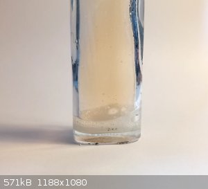

OK, I ran an experiment per my reaction (actually, cited in the literature under alkaline conditions, see, for example, [EDIT] "Nitrate Removal from Ground Water: A Review", by Archna, et al., E-Journal of Chemistry, 2012, 9(4), 1667-1675), link: https://www.google.com/url?sa=t&source=web&rct=j&... ):
2 Al + 3 NO3- + 3 H2O -- 6OH- --> 2 Al(OH)3 + 3 NO2-
I dissolved 7 g of KNO3 in 12O cc of distilled water. I added 1.4 g of aluminum foil (a sheet of 14 cm x 23 cm). Used an excess of NaOH (5 cc). ([EDIT] As a old prior source spoke of a pH around 9.0, a better procedure may be to add the stoichiometric dose of NaOH over divided doses, with stirring and stopping before if all the aluminum is dissolved). All the aluminum dissolved. Left a fine black suspension of which I was able to filter most out of the very alkaline solution. See picture of pre-filtered solution below:
Added the hopefully now nitrite rich mix with added sea salt to 97% ethanol ([EDIT] Ever Clear, not Evergreen), and currently awaiting sunlight to breakdown the alcohol (smell change) via photolysis of aqueous nitrite/sea salt (reference: please see http://onlinelibrary.wiley.com/doi/10.1029/JC086iC04p03173/a...). Not a classic test for nitrite, but it is one of my intended uses (for photolysis).
20171005_100153-640x480.jpg - 31kB
[Edited on 5-10-2017 by AJKOER]
[Edited on 6-10-2017 by AJKOER]

Have you realized that that's a link to a file on your local computer? It seems to indicate that you have a Unix-like filesystem, and that your username (or the system name) is "chronos". Possibly on a public computer, since your files are in a folder with what appears to be an MD5 hash in the username, and may be a way of allowing guest users to save files locally.
I dissolved 7 g of KNO3 in 12O cc of distilled water. I added 1.4 g of aluminum foil (a sheet of 14 cm x 23 cm). Used an excess of NaOH (5 cc). All the aluminum dissolved. Left a fine black suspension of which I was able to filter most out of the very alkaline solution. See picture of pre-filtered solution below:
Added the hopefully now nitrite rich mix with added sea salt to 97% ethanol (Evergreen), and currently awaiting sunlight to breakdown the alcohol (smell change) via photolysis of aqueous nitrite/sea salt (reference: please see http://onlinelibrary.wiley.com/doi/10.1029/JC086iC04p03173/a...).]
Evergreen? You sure you don't mean "Everclear"? Maybe it's time to get some sleep now, eh?

AJKOER - 6-10-2017 at 04:40
Melgar:
Fixed the link on another machine and inserted article title.
Thanks. I was using an alternate computer (Acer Chrome book). Apparently, just copying the url as displayed on that machine for certain links (like to locally stored downloaded files) is problematic for the other computers. Lots of new things with the Chrome book computer got to get acquainted with, but it does have a low price, large screen and even HMDI ports to play online movies onto big screen TVs,...... Recommend it for word processing (talk and it enters your text fairly accurately based on context), research,..., but not for anything like online games and such.
I don't drink the alcohol, else I would at least known what to call it if I have to buy more!
Cheers!

AJKOER - 6-10-2017 at 13:47
Updated picture following photolysis in sunlight for 6 hours:
The reaction mix is now more intensely colored (resembling olive oil) together with a diminished smell from the former strong scent of the EverClear.
Some photochemical reaction, in alkaline conditions, has apparently occurred, which may be supportive of the claim of the initial nitrite presence given the short time frame of treament. The latter with sea salt, alcohol and distilled water in the presence of strong sunlight, may have produced hydroxyl radicals, as would be expected per my prior cited source, thereby further producing new products. Definitely, no smell of NH3.

I performed a test with this. I ground up 100g of KNO3, 48g of NaOH and 20g of potato starch and placed the mix in steel pot and placed a steel plate as a lid. I heated it slowly with gas burner, and it started to buff up, smoke, and then a controlled reaction kicked in and it appeared to be burning for several seconds, generating white smoke, and then it stopped and ceased totally. I let it cool, and yellow rock hard mass was formed with slight greenish tint, not sure if it was from the red impurity of KNO3.
I dissolved it with 100mL of boiling water and added a little, but part was left undissolved. I filtered it clear, orange liquid, and cooled it. KNO3 and apparently what is Na2CO3 crystallized out. I concentrated the liquid by heating, and white mass what is likely Na2CO3 crashed out. I plan to process it further by cooling it down to 0 and see if it solidifies completely, and if, add just a bit to extract the KNO2, and eventually dry it in desiccator.
What I was afraid if this reaction could have generated any cyanides, according to my previous post. I haven't smelled any almonds, but if I try to sniff it too much, I begin to imagine that I notice a trace of it, but this happens every time. I suppose it should be detectable, unless there's that genetic thing? I smell normal and bitter almonds(BzH), though.

Ah, thanks for the input. I thought you were long gone, as this is a few years old topic.
Is the ratio of starch/sucrose indeed 1mol per 12mol of nitrate and hydroxide? I used 100g of KNO3, 48 grams of NaOH and 20g of starch (16g would've been the original, but the amount was so insignificant I upped it just in case).
I was originally gonna use calcium hydroxide, but I thought that since you got it working, I should follow is as exactly as I can, because I urgently need the nitrite. Good thing is, I'm gonna react it with nitric acid, so any nitrate or carbonate residue does not matter, they will just be either consumed or be a spectator in the reaction.
If I need more, I'll use your instructions, use sucrose and calcium hydroxide and probably I'll blend them together with mini blender as I've done prior with different similar reactions.
I'm just currently cooling the solution to 0C. After filtration I'll put it in desiccator.
Σldritch - 5-11-2020 at 14:42
Im still here but as i no longer have year round access to my lab i can usually not add much to the discussion. To this one, however, i can.
The stochiometry is correct. Starch is basicly carbon hydrate and theoretically we want the carbon to end up as carbonate which means two nitrate molecules for every carbon atom. Without the base the acidic Carbon Dioxide probably displaces much of the nitrogen dioxide. But really you might have success using more carbon, i have never had a reason to try because the Potassium Hydroxide is the most valuble to me. Theoretically using more carbon means using more base to keep the acidity down but since so much nitrate always is left over this may not reflect reality. I guess a lot of the carbon is oxidized to carbon monoxide which is much less acidic leaving base and nitrate. From the crude product this seems to be the case, which is another reason to use Calcium, the hydroxide salts are easy to separate.
If you make the mix from Calcium Hydroxide and Potassium Nitrate you may want to add something to slow down the reaction. Normally water does it. I think the reaction running too hot is the cause of it going reddish. It forms a foam of Nitrogen Dioxide which can be smelled.
Another thing is, i never fractionally crystallize the crude nitrite but use it as is. With the amount of Alkali Hydroxides and the very soluble nitrite itself it is hard to do from water. You may have more luck with methanol or ethanol-water.
Fyndium - 5-11-2020 at 15:00
Could it be beneficial to actually use less nitrate compared to base and carbon, or does this kill the reaction kinetics?
I did not check if the stuff was red hot, I just left it cool when it stopped under a steel lid and came back when it was cold and rock hard. I ignited the reaction by simply heating the can, and definitely not too much to make it glow, more like how I heat my liquid reactions. It started very easy, foamed and bubbled a little, and then the big smoking started, lasted maybe 10 seconds or more, and ceased. The reaction seemed going extremely smooth, like it was buffered by something.
I first filtered the liquor after cooling a little when dissolving the rock, removing all solid impurities and crashed out stuff, cooled it to 0C, decanted off the formed crystals of likely KNO3, and concentrated it by boiling, and during boil, white mass crashed out.
When I cooled down this with the crashed white mass, a lot more of sharp crystals formed, and a liquid was left. I drained this liquid in another petri dish, and scraped the crystalline mass off from the clearly separate layer of white hard stuff, that is likely carbonate of something, and collected this crystal mass, which formed a watery slush in another dish, and placed them both in a desiccator with lots of CaCl2. I'll trickle some HNO3 on them samples when they are in a more solid form. My interest in optimizing this reaction due to other ventures is little, and I only need the nitrite in catalytic amounts, hence I'm well happy with tens of grams of it, and if this nitr-o-pot method works to produce at least that per run, it probably lasts more than my need for it. But I'll write on any notes I come up with.
Σldritch - 6-11-2020 at 11:27
Maybe it could be beneficial. But depends on what you are optimizing for, if it is yield from nitrate you can probably increase it as there tens to be a lot left over. There is risk of overreduction, and kinetics will probably be faster not slower. Faster kinetics means higher temperature, which may not be a problem. However what may be a problem with increased rate is that it should become more sensitive to particle size to some degree, this effect should get stronger with increased proportion of reductant, too.
I suspect the best way to increase yield is to increase the amount of base making sure to capture all the nitrogen oxides. Calcium Oxide/Hydroxide can be very cheap, problem is just getting it fine enough, which is why is why i recommend using Calcium Nitrate/Potassium Hydroxide. Another way is to replace the carbon which has the problem of forming carbon monoxide making it harder to get the amount of reductant correct because different amounts of carbon monoxide is formed depending on rate and physical conditions changing the stochiometry.
When i first did this i tried using sulfur. It seems to be able to reduce nitrate at a lower temperature with one caveat, it loves to explode - even with excess oxidizer and base present - think some solvent could make it work but nitrite is so soluble it is probably not worth it (the solvent would probably have to be 200 C + so no distilling away an organic solvent without fire/explosion hazard). I would not recommend it but if someone is mad enough this is probably the route to very high yields.
I should probably have documented this when i did it but i did not bother because interest was so low anyway. If not you maybe someone else will optimize it further, verification helps either way.
Fyndium - 6-11-2020 at 12:04
Calcium hydroxide is sold in hardware store 50c a kg, so the base is the least of the issues.
I'm not sure which method is best or better than this, but this is the first one that I found documented and working, because I already struggle with the endless scale of economies, where I have to make every reagent's pre- and even pre-precursors, and if I have to test and try all different methods, no time in the world is enough.
Calcium hydroxide probably allows for better separation, because what's insoluble is always easier to process than soluble, unless the sol curve is very steep. Potato starch residues should have very limited solubility in water in cold temps.
The stuff is half-dried by now, I'll keep it in desiccator for one or more days to get it completely dry, and then measure the collected weight. I presume this is far from pure, though.
Fyndium - 8-11-2020 at 05:42
I got it dried. Desiccator dry weight is 58g. I suppose the product is not very pure because the yield is so high. Maximum theoretical yield would be about 85g, hence the starting point is 68%.
Like I previously said, I first dissolved it in boiling hot water, filtered, cooled to 0C, filtered again from KNO3 and carbonates, and concentrated about half, cooled, decanted what was likely more Na2CO3 and KNO3 off, and then evaporated. If there is more than 50% of KNO2 I'm highly happy.
Gonna test it soon so I'll tell if it works. Can't determine yields though because I will be using just a catalytic amount.

Fantasma4500 - 28-2-2022 at 10:09
hey i would just like to put out a warning for method similar to which was posted
im trying to find the best and most efficient method for nitrite as i have a way of purifying it and quantifying how much the specific yield for each method happens to be
one of these bags i mixed up happened to be..
20g NaNO3 10g NaOH 4g D-glucose
as from flour 165g - 3.3g
NaNO3 85g 1020 20g
NaOH 40g 480g 9.6g
which i acquired from the original post of this thread
scaled it down to fit the sizes im doing for test
initially i used way too much flour and too little NaOH- of course this turned into a flare, only had about 10g of mixture however. so i fixed the ratios with my bag of nitrate glucose and NaOH and put, 2-3g into my crucible, put it on the gas burner, covered it up with some aluminium foil just for good luck and stood back, eventually left the room as 10 seconds had passed
then all of a sudden a loud explosion came about
https://gyazo.com/5a22662db19e4ff9ed53b7e6d9d24db2
the aluminium foil was blown off, but not torn to shreds and there was barely any smoke
now im having flashbacks to playing around with a mixture that explodes when being melted down, yellow powder i believe it goes by, its a mixture of KNO3 K2CO3 and S
could i just have created a more OTC friendly version?
"Yellow powder is potassium nitrate, potassium carbonate and sulfur melted together in a 3:2:1 ratio. "
and i was using 20-10-4 NaNO3 NaOH d-glucose
with the loud explosions im gonna have to let this one method go for producing nitrite, i might give it a go in aqeous solution- not sure if i dare yet to try with flour instead

low viscocity NaNO2 + ~800*C hotplate https://i.gyazo.com/bf38097573567358c1d5f48eb38b0934.jpg
i can see NaNO3 is insoluble in acetone, but i cant find anything on NaNO2, so for purification it may be easier to do it with potassium nitrate, as theres major difference in potassium nitrite/nitrate solubility in water, KNO2 is also soluble in ethanol where KNO3 isnt really.
tl;dr thermal decomposition of NO3 = NO2, KNO2 can be extracted with ethanol, KNO3 cant
