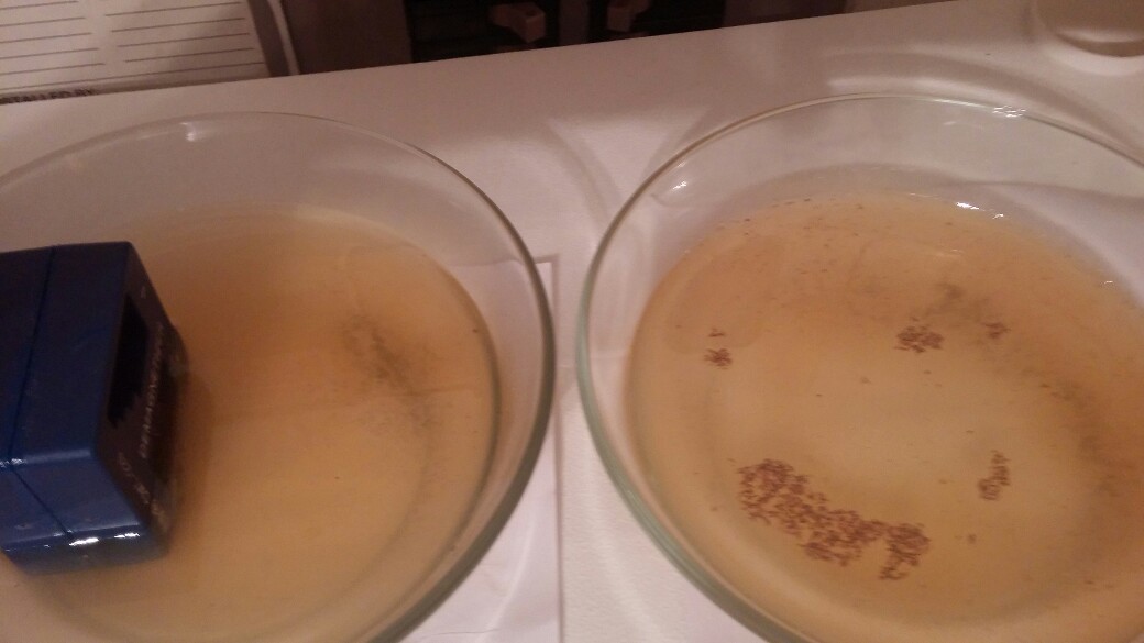

Experiment 2
Repeat based on a mixture of boiled tap water/ some vinegar/ bit of sea salt. Near equal amounts of iron filings added to half the volume of the prepared solution. One solution has a Magnetizer inserted into it. Picture taken some 15 hours latter.
It appears that the Magnetizer solution has a different viscosity and a taint darker color.
The reaction with atmospheric oxygen appears to be occurring a little more rapidly in the presence of the weak magnetic field. This is in accord with the reference material provided in the opening thread with regard to the an apparent increase rate of oxygen dissolution. To quote from the Martin Chapman reference:
"Surprisingly, even very small magnetic fields may affect the solubility of gases in seawater (solubility increasing with the magnetic field (20-50 µT) [1492], probably by their effect on the clathrate stability. This reinforces the view that it is the movement through a magnetic field, and it associated electromagnetic effect, that is important for disrupting the hydrogen bonding. Such fields can also increase the evaporation rate of water and the dissolution rate of oxygen (due to its paramagnetic nature) but cannot, despite claims by certain expensive water preparations, increase the equilibrium amount of oxygen dissolved in water above its established, and rather low, equilibrium concentration [176]. Magnetic fields can also increase proton spin relaxation [623], which may speed up some reactions dependent on proton transfer. "
Note, there was no stirring or any other agitation of the respective solutions. To be fair, I will point out that the presence of the Magnetizer together with a small amount of attached Fe particles thereto does provide possibly more opportunity for some iron related surface chemistry (in a weak magnetic field) with respect to the control solution.
20171002_144414.jpg - 291kB

Glad to see you experimenting! You really need to be measuring things, though. As it is, this is only qualitative and difficult to draw conclusions from.
"Some vinegar" and "bit of sea salt" isn't descriptive enough for someone else (or yourself) to repeat your experiment, which I'm sure you know is an important part of doing science. "Near equal amounts of iron filings" also isn't accurate enough to see a difference, since if there is an effect here it is likely to be very small. Thus the importance of measurement and accurate scales.
Your results are also qualitative, with no reported measurement (just a subjective description of color). If you measure your initial reactants, run the experiment for a set period of time, then measure your results (filter and weigh the precipitated rust), it makes for a much more convincing and repeatable experiment. You'd also want to place the magnet outside the solution, to ensure it is only the magnetic field having an effect. Put the dish on top of the magnet instead.

[*] posted on 3-10-2017 at 02:37
The magnetic field could just be causing the iron filings to clump together more, and thus have less surface area exposed to react.

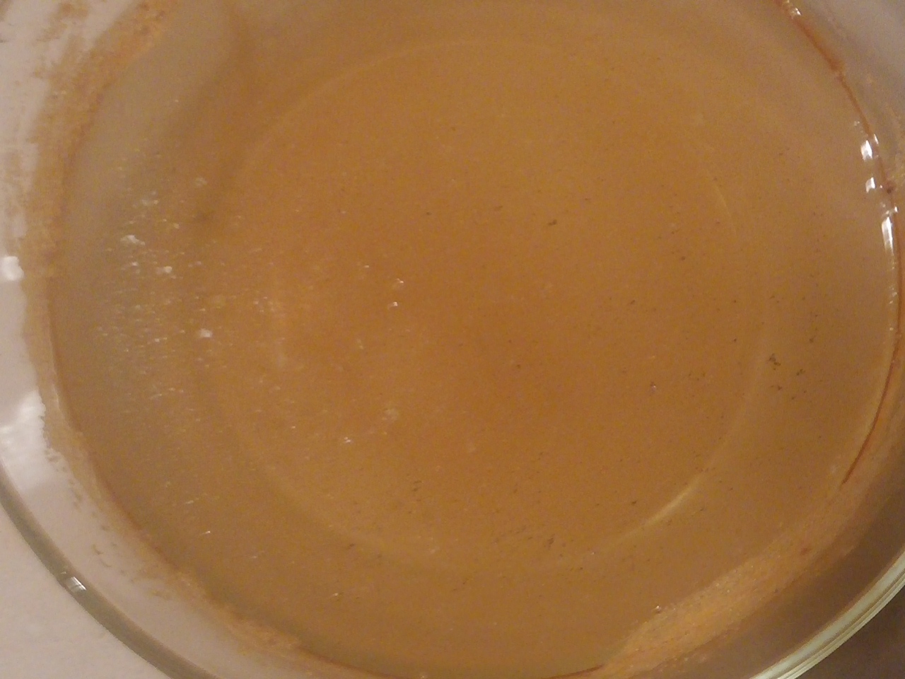

Updated pictures side and top view!
My comments are the concentration of iron salts appears higher in the magnetizer treated mix. Also the top side view interestingly shows froth, reflecting air interaction, with the iron powder. Note also, the relative size of the froth area over the magnetizer and in total as compared to the control solution.
I suggest that per the last article link, which I provided above (source by the way: 'Magnetic field induced motion behavior of gas bubbles in liquid', by Keliang Wang, Pucheng Pei, Yu Pei, Ze Ma, Huachi Xu & Dongfang Chen, in Scientific Reports 6, Article number:21068 (2016), doi:10.1038/srep21068 ), interesting article comments are:
"the kinetics of oxygen bubbles is mainly proportional to intensity of the electromagnetic field. The magnetic-field induced rotational motion of oxygen bubbles in a square electrolyzer can increase liquid hydrodynamics, thus solve the problems of oxygen bubbles coalescence, and uneven distribution of electrolyte composition and temperature. These types of oxygen bubbles movement will not only improve energy saving and metal deposition for energy storage and metal refinery, but also propel object motion in application to medical and martial fields."....
And interestingly also:
"In addition, Oxygen molecules were found to possess paramagnetic characteristics due to unpaired electrons in its molecular structure [20,21]."
Link again: https://www.nature.com/articles/srep21068
So, in short, my take is that magnetic fields can increase molecular oxygen kinetics. The latter could also be accomplished, for example, with stirring, sonolysis, or heating. The latter, unfortunately, reduces O2 solubility, so is really not an option.
20171003_091842-640x480.jpg - 33kB 20171003_092400-640x480.jpg - 40kB

New pictures!
Concentration appears to have increased in both solutions and more discernibly in the control solution, but not yet entirely caught up to the magnetizer treated solution.
What is striking, to me, is the relative degree of N2/O2 bubbles related frothing (in height and area) occurring in the magnetic field scenario.
20171004_113340.jpg - 322kB

Last run pictures for Experiment 2:
The solution are pretty much the same except today the control solution has a little more height to the froth, which is apparently centered around a piece of iron.
The observation that the Fe metal is floating does seemingly support that, at least to some extent, the reaction:
Fe + 2 H2O → Fe(OH)2 + H2(g)
is occurring.

I nearly drained the solutions and added water in order to examine the sediment. The picture below is from the sediment in the control solution showing no more iron, except for a few larger ensembles, one of which was captured above:
20171005_110242.jpg - 351kB
[Edited on 5-10-2017 by AJKOER]
AJKOER
Radically Dubious
Posts: 3026
Registered: 7-5-2011
[*] posted on 5-10-2017 at 08:17
The magnetizer treated sediment was basically nill.
One might hypothesize that the magnetizer treated solution represents around a day of acceleration over the control, or approximately 20%.
This is however nearly insignificant as compared to some reported results in select electrolysis experiments. See Zou, P.; Leddy, J., 'Magnetized Nickel Electrodes for Improved Charge and Discharge Rates in Nickel Metal Hydride and Nickel Cadmium Batteries', Electrochemical and Solid-State Letters 2006, 9, A43-A45. To quote:
"magnetized electrodes yielded higher currents than the corresponding nonmagnetic electrodes by 70 and 230 %, respectively."
Link: https://www.electrochem.org/dl/ma/206/pdfs/0541.pdf
