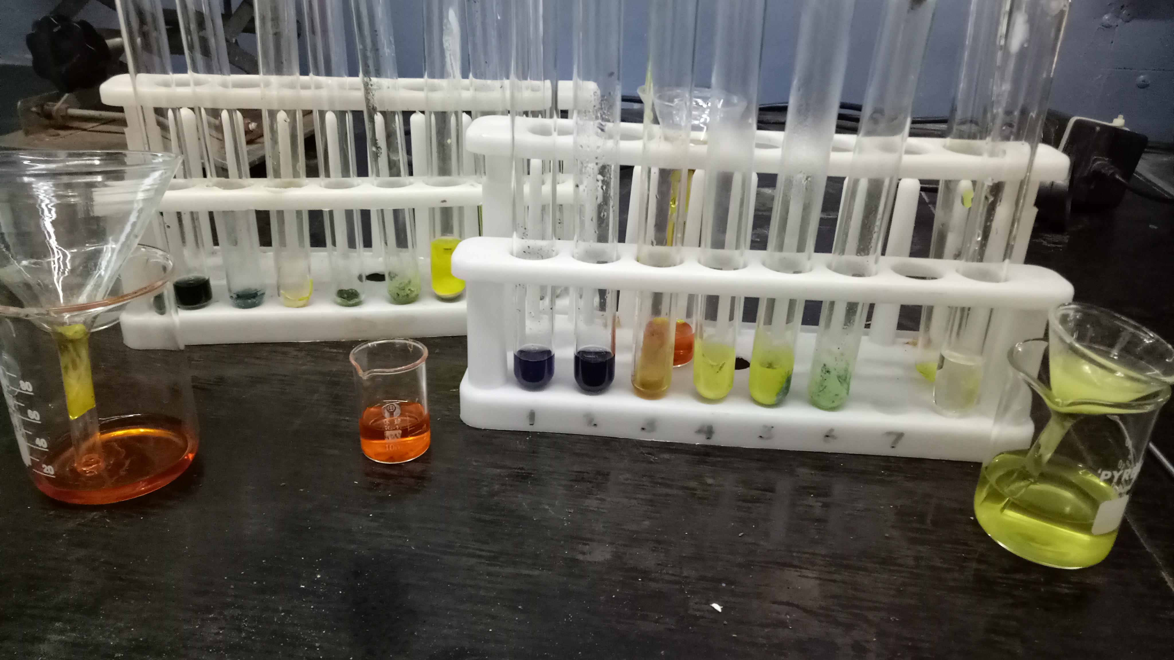

Potassium dichromate
One of my first ever experiments was the aluminothermic reduction of pottery grade chromium oxide to obtain elemental chromium for my element collection. Product was obviously impure with lots of aluminium products in the mix. Recently I have been attempting to make something useful from the mixture. Procedure as follows:
  • Digest with concentrated HCl to make a solution containing Cr(III)
  • Neutralise and precipitate with sodium carbonate.
  • Repeated filter and wash steps to obtain Cr2(CO3)3 of acceptable purity. (Stuff is a dog to filter: not as bad as calcium sulfate but close.)
  • Dry and roast to obtain Cr2O3
  • React with KNO3 to get potassium dichromate. Cr2O3 + 2KNO3 --> K2Cr2O7 + 2NO.
  • Dissolve in water, filter and crystallise.
    I have had a bit of fun playing with other routes and other oxidisers to target other useful Cr(VI) compounds: sodium or ammonium dichromate of chromates. The problem with sodium dichromate is separating it from soluble byproducts at sensible yields. Similarly, ammonium dichromate is going to have high yield loss and impurity issues due to other species that will crystallise out at the same time. Isolation of calcium chromate might be a good idea, and easy to separate since it has an inverse solubility curve and is quite insoluble anyway. But I have very little calcium nitrate and so it is not very practical as a recovery method.
    I do have a lovely array of bright coloured test tubes for my efforts.
    Everyday chromium.jpg - 2.7MB
    [Edited on 1-4-2023 by j_sum1]
    Admagistr - 31-3-2023 at 23:58
    @ j_sum1
    Are you sure that chromium (III) carbonate exists??When I precipitated it out of solution, after a short time CO2 was released and undoubtedly Cr(OH)3 was formed. Similarly, aluminium carbonate cannot be prepared...Even in the literature-Remy,Inorganic Chemistry-It is said that carbonates of Al and Cr cannot be precipitated from aqueous solution because they are unstable and turn into hydroxides when CO2 is released...
    [Edited on 1-4-2023 by Admagistr]
    j_sum1 - 1-4-2023 at 03:49
    You are probably right. The dried chromium compound did not produce much gas when tested with acid. So, probably oxide or hydroxide. With some residual Na2CO3 present.
    Carbonate was what I intended and what I wrote above and also in my lab notes. But after testing with acid I proceded as though it was oxide and reacted with KNO3. I should have spotted my error when writing that post.
    K2Cr2O7 solution looks good and is forming nice crystals. I think I have made good use of some waste I had lying around.
    Admagistr - 1-4-2023 at 12:53
    j_sum1:
    K2Cr2O7 solution looks good and is forming nice crystals. I think I have made good use of some waste I had lying around.[/rquote]
    Dichromate is visually very beautiful compound;)! I plan to reduce it with SnCl2 and also by its reaction with Na2CO3 to form compound 3K2CrO4.Na2CrO4,which during crystallization produces light flashes(triboluminescence.)
