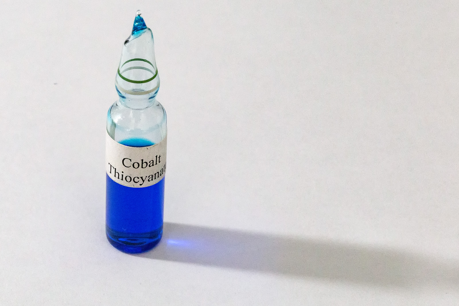

I've messed about with a few cobalt compounds in the past. Here are a couple of pictures of cobalt complexes.
Cobalt (III) complexes.jpg - 231kB Cobalt Thiocyanate.jpg - 474kB

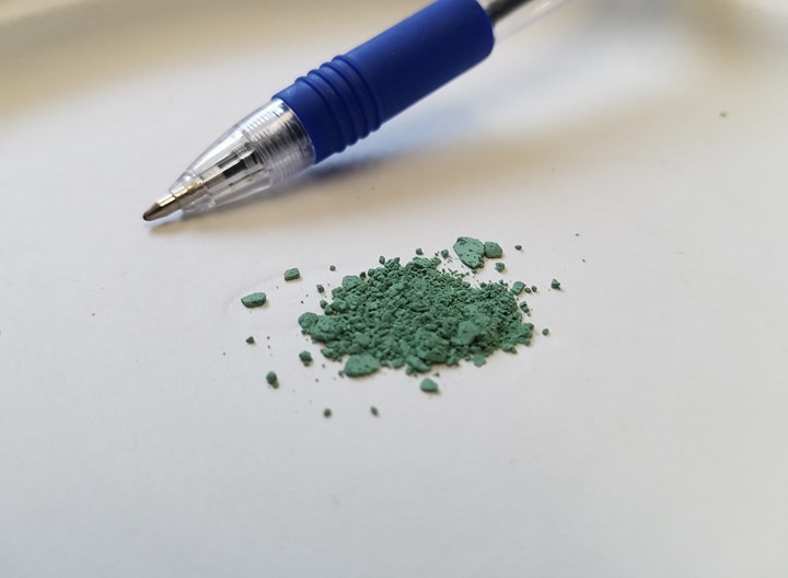

Wow, the carbonate looks very interesting. A green complex of cobalt? I never have seen such a thing.
How did you make the green carbonato-complex? That definitely is something I would like to reproduce.

Posts: 4519
[*] posted on 4-12-2017 at 20:18
DOI: 10.1021/ja01504a004
Cobalt chloride, sodium carbonate, and hydrogen peroxide.

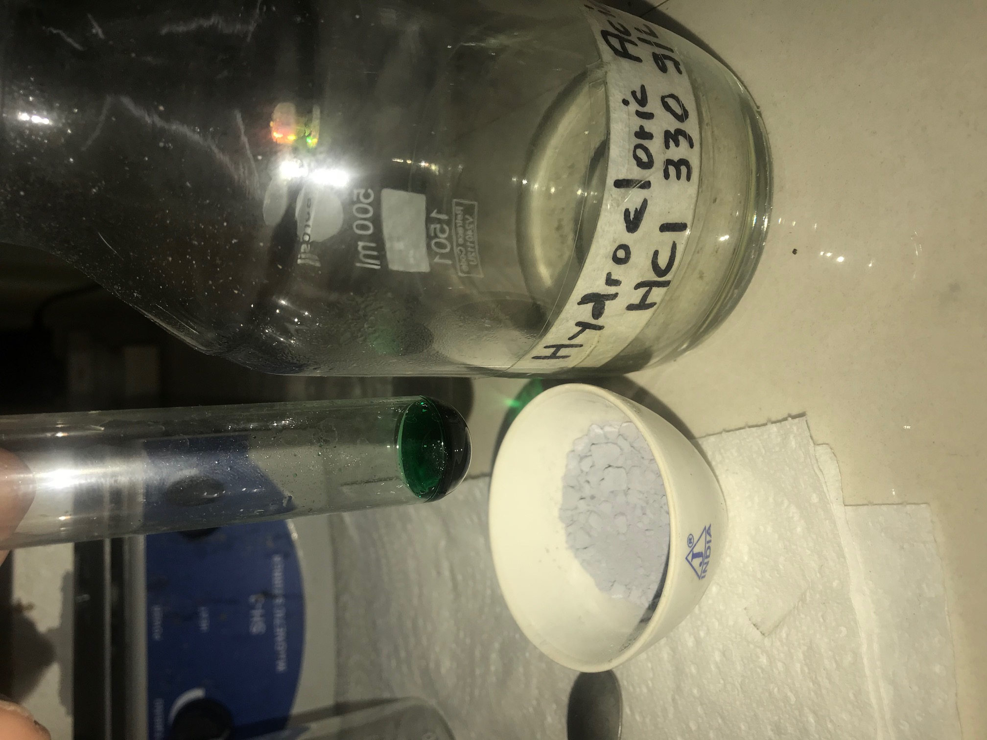

I accidently seem to have made a cobalt compound that gives a lovely dark green solution with concentrated HCl - but what is it?
The idea was to see if cobalt iodate could be made by doing a double displacement reaction between solutions of sodium iodate and cobalt acetate. This failed as far as I can see but I ended up with something interesting: a light grey powder that gives a lovely green solution with concentrated hydrochloric acid. How this happened:
- 10g NaIO3 dissolved in 100ml hot water. This NaIO3 was some 9 months old (in a clear jar) and a slightly brown, so there was probably some free iodine. It dissolved quite easy and gave a very pale brown solution.
- 6.4g (CH3COO)2Co.4H2O was dissolved in 30ml water, giving a red solution
- The cobalt acetate was slowly poured into the sodium iodate while stirring
- A maroon-purple suspension formed.
- The solution was then brought to boil while stirring. The reason I did this was to try and get a anhydrous cobalt iodate to ppt out; it is said to have low solubility at 100C.

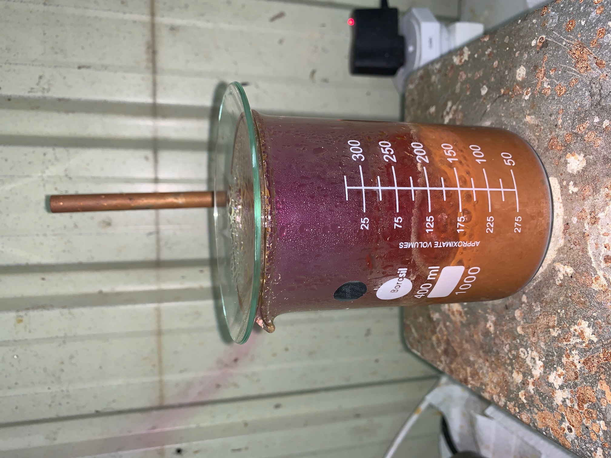

- Close to boiling the color became more brown and it started to offgas lots of I2! See photo below.
1 Reaction proceding.jpg - 697kB
- I initially thought this may be free I2 from the NaIO3 and continued to keep it boiling. After some 10 minutes the color of the solution was a bit lighter brown but there was no sign of the I2 coming off reducing.
- There was visible suspension, so I switched off the heat and let the solution cool down slowly, and then stopped the stirring. This have a brown solution with a dark layer on top (looking like I2 in water) and a heavy grey-pale blue ppt - I say heavy because it settled out quickly.
- The supernatant solution was decanted, and the ppt washed with ethanol to dissolve remaining I2. It was then gravity filtered. In the filter, the remainder, a dark grey powder, was twice washed with acetone by which time the acetone ran through clear. See photo of the dark grey remainder below.

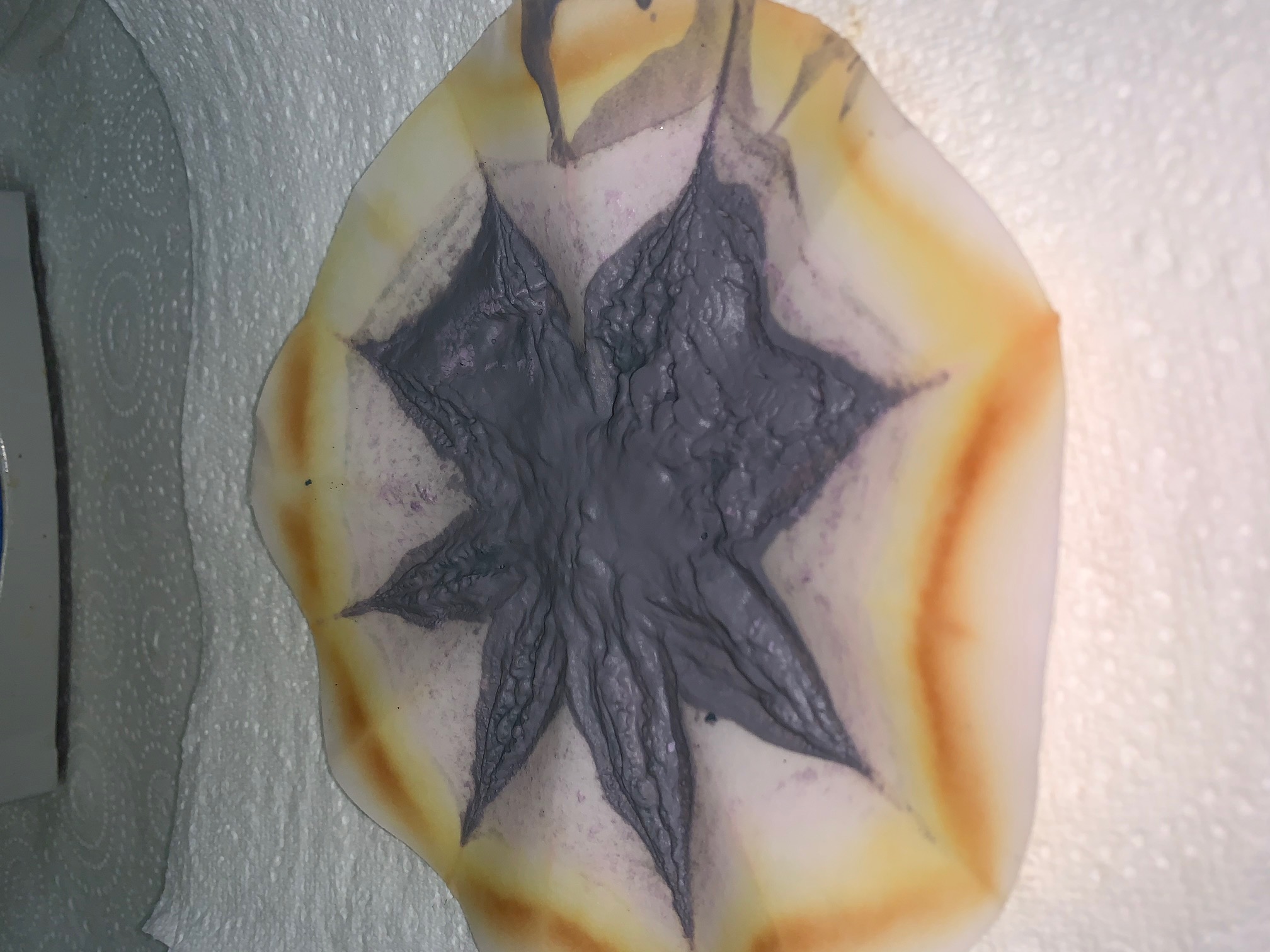

2 Dark grey filtrate.jpg - 442kB
- The filter paper with the remainder was put aside to be dried in the sun the next day.
I started to clean up. The reaction beaker had a difficult to remove layer of the grey ppt on the bottom. I added a bit of concentrated HCl to see if that would dissolve it...expecting the usual blue solution of anhydrous CoCl2. The grey layer dissolved in an instant...but gave a lovely green solution! See photo.
3 HCl added to beaker to clean.jpg - 388kB
I started to look online mainly on Atomistry and Wikipedia to try to understand how cobalt wth HCl can give a green solution. What I did learn was that Cobalt makes many complex oxides, and in some circumstances iodine play a part in this. The oxides / oxide hydrates can have many colors, including grey.
The next day the power had lightened in color and after trying for some hours in the sun under a steel dish it appeared bone dry and light grey with just a hint of blue to the naked eye. See photo. Recovery was 3.4g

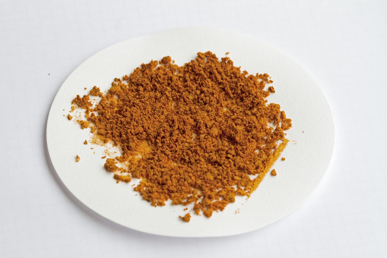

4 Dry light grey powder.jpg - 483kB

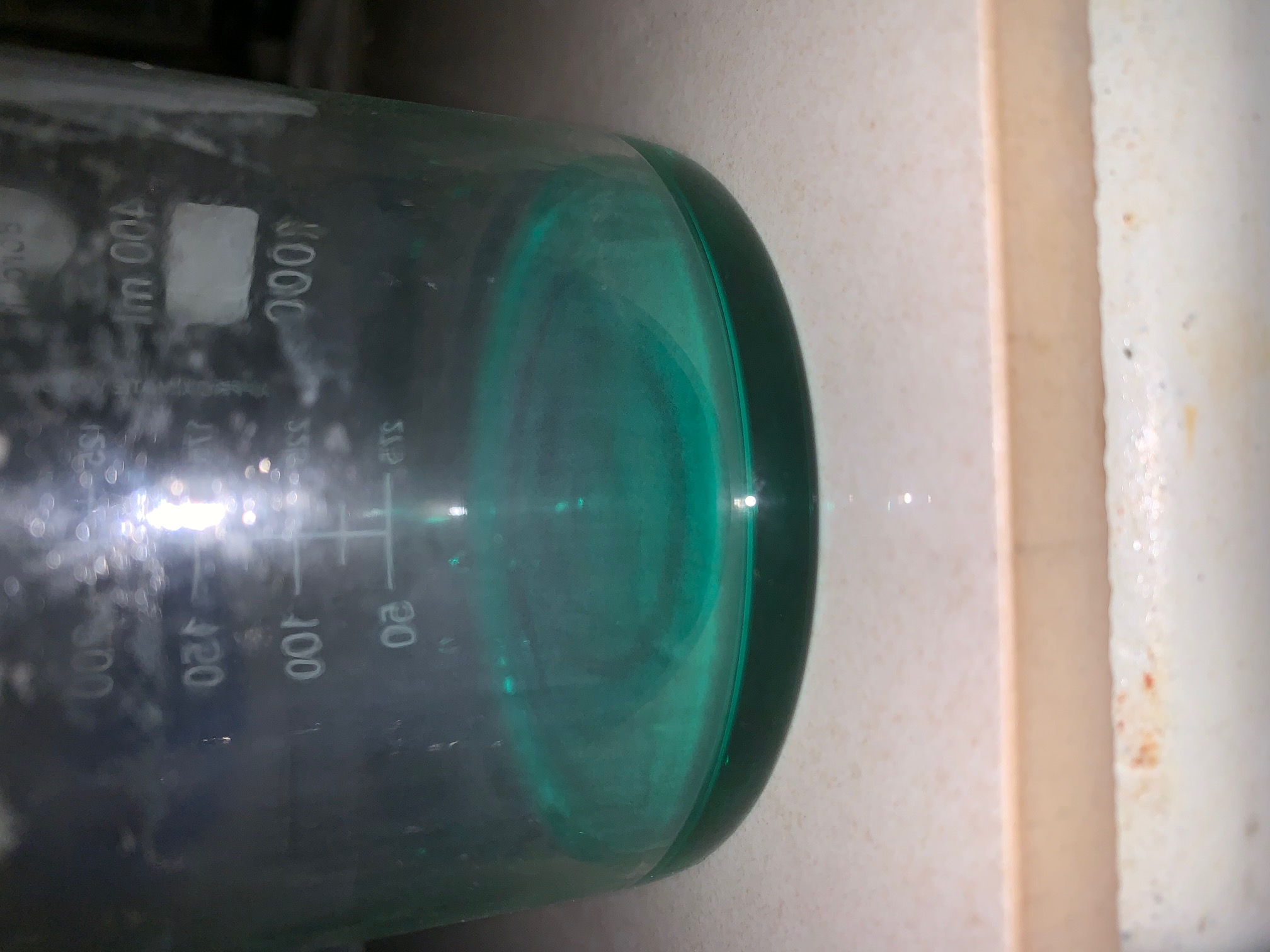

I tested the dry light grey powder with concentrated HCl, and again got a deep green solution. This time I stoppered the test tube with the green solution and put it aside to see if it remains green over time.
5 Powder with conc HCl.jpg - 466kB
What is the grey powder that gives a green solution with HCl, and what is the solution? Did I accidentally make a complex?

Lion850: Blue Co solution in conc. HCl isn't anhydrous CoCl2 but [CoCl4]2-.
Co2+ + 4Cl- <--> [CoCl4]2-
IO3- + 6HCl - - > [ICl4]- + Cl2 + 3H2O
[CoCl4]2- is blue, [ICl4]- is yellow. Blue + yellow = green.

Lion850: Grey compound must definitely contain iodate and cobalt, because of reactions which I wrote in my first post.
Here is something about CoIO3:
http://cobalt.atomistry.com/cobalt_iodate.html
