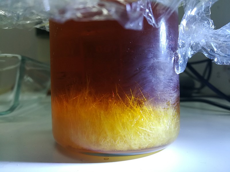

I am not sure why, but the product eventually crystallized out of solution anyway. I just moved the beaker several times between fume hood and a freezer, doing few test-tube experiments, and it suddenly crystallized.
I filtered the product and washed with cold MeOH. It indeed looks like phenyl-2-nitropropene:
9wiK16y.jpg - 75kB
One of my test tube experiment was successful in precipitating phenyl-2-nitropropene (probably). I simply added some methanol to decrease solubility of the said compound:
FDnpxTm.jpg - 82kB
Therefore I added methanol to the filtrate and got a second crop of crystals:
eMeqEa2.jpg - 89kB
I will recrystallize everything from MeOH since I have serious doubts about purity. The yield about 1/4th of the expected, but I am glad the method even works!

Tsjerk - 23-2-2019 at 12:52
That is P2NP! Those needles are indistinguishable.
[Edited on 23-2-2019 by Tsjerk]
nimgoldman - 24-2-2019 at 11:42
Yes I am happy for the success. It means the benzaldehyde extraction from kernels of Prunus spp. and the nitroethane synthesis were both successful.
morganbw - 24-2-2019 at 15:01
Perhaps not failed after all.

I don't have any thoughts as to Urushibara Nickel, but I can say that the NaBH4 + NiCl2 doesn't work. I lost many hours and lots of starting material trying to get it to - don't waste your time with that one. Your best bet really honestly is using Hg/Al. You can deal with the waste Hg by treating it with sulfur and turning it into cinnabar - a naturally occurring ore. Hg/Al is also going to be your best yielding, just shy of LAH.
Also, do future-you a favor and save a seed crystal of your nitropropene to help your future reactions crystallize. That is beyond all other methods the best and easiest way to induce crystallization.
Your product is most certainly P2NP, you should be happy with those crystals - they look good. I always used IPA to recrystallize, but I don't see why MeOH wouldn't work just as well. Any other questions I can answer please ask - I love helping other chemists work through places I've been before!

karlos³ - 27-2-2019 at 01:04
Use NaBH4/CuCl2, it happens to become the new standard among a group of clandestine chemists, putting the Al/Hg to rest for now.

nimgoldman - 27-2-2019 at 20:23
Thanks for all the input and references!
I know Al/Hg works, but I am quite opposed to working with highly toxic materials. My original project is actually getting to amphetamine all the way from bitter almond kernels (or bitter apricot kernels) using only easy to obtain materials. This is just a hobby project.
The reason for choosing Urushibara nickel was 1) the fact I found some tricks to improve it's activity based on NurdRage and ChemPlayer's videos, 2) that I have NiCl on hand, which is readily available, unlike HgCl which I was unable to get without causing unwanted attention, 3) becasue I read in some chemistry texts, that aliphatic nitro groups can be reduced to amino groups using zinc and acetic acid ... but I might not work after all and I have to get back to the drawing board and books (still having lot to learn unfortunately).
What seems more plausible now is making the ketone (phenylacetone) followed by the Leuckart reaction.
In the worst case, I was thinking about making water soluble Hg salt from cinnabar (which is easily obtained), but this would spawn another huge project.
Even getting to phenyl-2-nitropropene took several months of preparations (mostly going through hardships of making nitroethane and almost every non-working method there is), it seems one step away from finishing the project, but maybe the hardest part is actually there.
