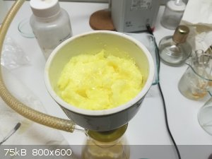

I am not sure why, but the product eventually crystallized out of solution anyway. I just moved the beaker several times between fume hood and a freezer, doing few test-tube experiments, and it suddenly crystallized.
I filtered the product and washed with cold MeOH. It indeed looks like phenyl-2-nitropropene:

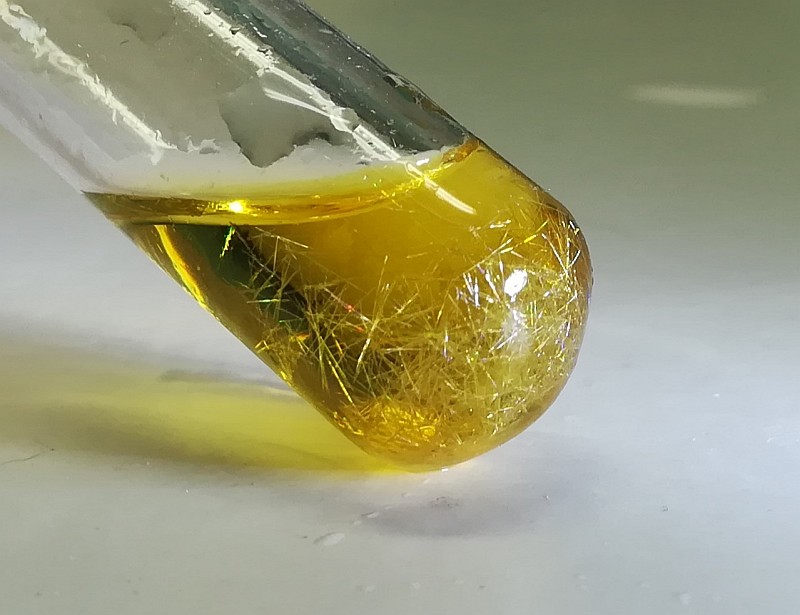

One of my test tube experiment was successful in precipitating phenyl-2-nitropropene (probably). I simply added some methanol to decrease solubility of the said compound:
FDnpxTm.jpg - 82kB

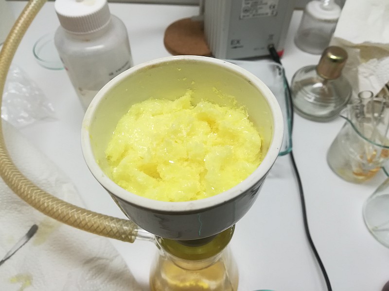

Therefore I added methanol to the filtrate and got a second crop of crystals:
eMeqEa2.jpg - 89kB
I will recrystallize everything from MeOH since I have serious doubts about purity. The yield about 1/4th of the expected, but I am glad the method even works!

That is P2NP! Those needles are indistinguishable.
Yes I am happy for the success. It means the benzaldehyde extraction from kernels of Prunus spp. and the nitroethane synthesis were both successful.

https://imgur.com/9wiK16y
https://imgur.com/FDnpxTm
https://imgur.com/eMeqEa2

I'm not sure what you mean by how is it dehydrated.....the dehydration isn't solvent dependent. The majority of your reaction mixture will solidify, but only upon final cooling. You will be left with some orange-red liquid, but the lions share will solidify. This is the best yielding reaction method that I personally have found.
I don't have any thoughts as to Urushibara Nickel, but I can say that the NaBH4 + NiCl2 doesn't work. I lost many hours and lots of starting material trying to get it to - don't waste your time with that one. Your best bet really honestly is using Hg/Al. You can deal with the waste Hg by treating it with sulfur and turning it into cinnabar - a naturally occurring ore. Hg/Al is also going to be your best yielding, just shy of LAH.
Also, do future-you a favor and save a seed crystal of your nitropropene to help your future reactions crystallize. That is beyond all other methods the best and easiest way to induce crystallization.
Your product is most certainly P2NP, you should be happy with those crystals - they look good. I always used IPA to recrystallize, but I don't see why MeOH wouldn't work just as well. Any other questions I can answer please ask - I love helping other chemists work through places I've been before!
