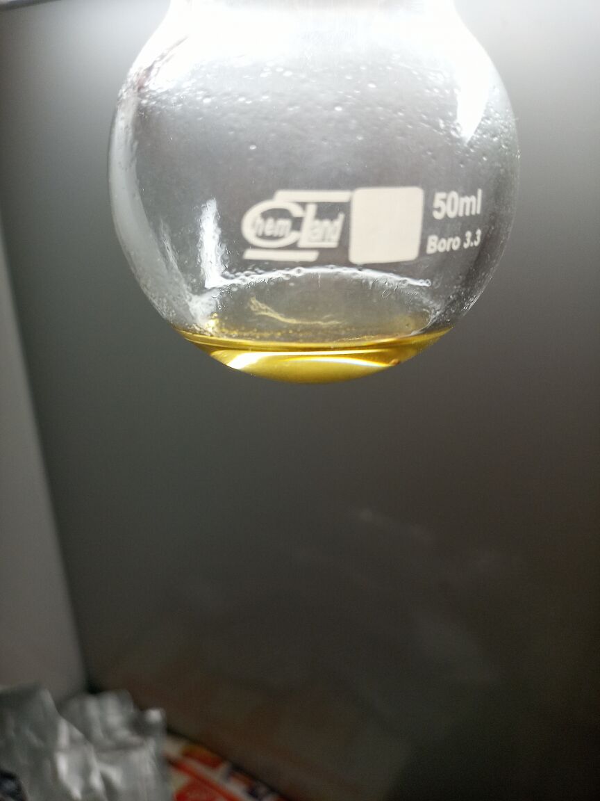

solvent was distilled out
IMG_20221202_051649_7.jpg - 99kB
remainders of solvent were removed by applying water aspirator pump vacuum to still hot RBF while swirling it in hand
IMG_20221202_062201_0.jpg - 41kB
the product
IMG_20221202_062519_1.jpg - 52kB IMG_20221202_062522_5.jpg - 64kB IMG_20221202_062541_3.jpg - 61kB
Pumukli - 2-12-2022 at 10:11
Very good, Fery! A low pressure hydrogenation on Pd/C! Without inert atmosphere. With the help of a repurposed plastic bottle. Semi professional amateurism? ;)
On the serious side: did you check the purity of the end product in any way? The difference in polarity might be not big enough after the hydrogenation that it would make a big difference in Rf values of a TLC... If there were some alcohols produced too, it would surely show up though.
I have some Pd/C and it is a free flowing powder. I would calculate with the dry weight of the catalyst if I were you.
Once I used Pd/C in methanol and after filtering it off of the reaction mixture it almost caught fire. The filter paper started to smoke but I noticed it and drenched it with water. The time between finishing the filtering and the detection of the first smoke trails was around one minute at room temperature. So yes, Pd/C in methanol if left to dry surely will self-ignite - at least if it was previously activated by H2 exposure.
Fery - 2-12-2022 at 11:01
Hi Pumukli, I was very afraid of fire too. I studied all solvents and there is a link in the initial post that alcohols are the most prone solvents for igniting and methanol of course the worst due to its lowest b.p.
20 ml of burning methanol wouldn't be any disaster but the product could be lost. That's why I let the catalyst to settle overnight and filtered quickly the supernatant and only then washed the catalyst with fresh methanol. I let the H2 to be consumed overnight, in the morning there was significant vacuum in the flask, maybe that helped. Also the Pd/C was 10% which has less active surface than 2-fold weight of 5% Pd/C. The catalyst was bough in sale-out, with unknown age, unknown activity, whether it was already used and then recycled or whether it is fresh is also unknow. The only info on the package states that it is 10% Pd/C, nothing else. Whether that 10% means in dry form or wetted form - unknown.
I believe leaving it overnight in sealed reactor made the remainders of H2 to be consumed and maybe that helped to avoid fire???
Unluckily I do not have any inert gas yet. Just before the hydrogenation I replaced air with vapors of low boiling point solvent (methanol) and after the hydrogenation I did not use inert gas either but I was prepared to choke the air availability for possible flames in filtration funnel using an hour glass.
I did not check the purity of the product. My goal was to smell this fragrance compound. Even the reactant has nice scent but weak, the product scent is very pleasant and much stronger. According the small amount I did not purify it further. If I would do something with it I would try water solution of KMnO4 which could oxidize alcohol back to ketone and make diol from unreacted double bond, the diol could then be removed as a residuum after vacuum distillation (I expect much more higher boiling point for the diol).
I did not perform chromatography. The volume of H2 consumed matched very nicely and there should not be too much side products (in one link there is written that not more than 4% of alcohol is produced).
I like to reuse "useless" things like the 6V batteries charger and empty plastic bottle from milk.

kmno4 - 2-12-2022 at 14:17
I made this ketone years ago, but in very similar way: 10%Pd/alumina with H2 generated by electrolysis (directly, without any separation).
Also slightly yellow product was obtained. It was then converted into NaHSO3 adduct and washed with toluene (or something similar). It gave much less coloured ketone (after its recovery), and deeply orange toluene solution.
The ketone was then distilled under normal pressure.
It turns out, that I still have foto of the distillate :o
DSCN0053.PNG - 477kB
Fery - 2-12-2022 at 21:57
@blogfast25 the target product was only the benzyl acetone so far
@Pumukli - this catalyst may perhaps have slightly different properties according the usage it was made for? E.g. for lab usage vs. for industry usage (more elevated pressures of H2 expected in industry?), for reductions of nitro to amino vs. hydrogenation of alkenes etc? Also its age and count of cycles it was already used may change its properties? I already performed aldol vanilin+acetone but the product was not satisfactory. In fact I initially wanted to make zingerone but then I changed my mind and did benzaldehyde+acetone and then hydrogenation on Pd.
@kmno4 - that's very useful info, thx! Your product has much better color! Its b.p. is 233 - 235 °C @ 760 mm Hg. You produced quite nice amount of it! I did only some very small scale of it, just to try it. If synthesizing more in the future I would certainly vacuum distill it. But I usually do not repeat experiments because I have a big list of to-do experiments waiting in queue...
kmno4 - 3-12-2022 at 05:25
My distilled product was completely collorless, as it should be.
I do not like making impure preparates, especially as end-products.
As far as I remember, I prepared oxime of this ketone and reduced it into amine in two independent ways.
Anyway - good luck in experimentation and let your products be always in high yields !
Amen.
[Edited on 3-12-2022 by kmno4]
