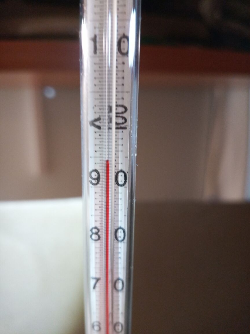

Then lazy setup removed and attached regular water condenser, themometer, Anshutz-Thiele adapter and connected to 2-stage oil rotary vane vacuum pump (my mechanical vacuum gauge is unable to measure such low pressures and it just shows 0 atm). Initially cold water circulated through condenser and product solidified in the adapter as well condenser. Warm water 50 C was passed through condenser to melt the product so it slid into the receiving adapter. Collected distillate at 86-95 C. Receiving adapter heated to melt the product, product then poured into a dish with a bed from aluminium foil, let to solidify and crushed to smaller pieces.

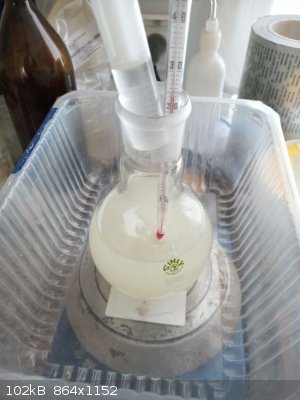

beginning of the reaction, in the flask there is benzaldehyde + acetone + water + stir bar

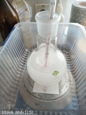

dripping solution of NaOH into reaction, as seen the reaction was slightly exothermic, the mouth of the flask was covered by a plastic foil to reduce air entering and oxidation of benzaldehyde thus destroying catalyst (by reaction into sodium benzoate), after the addition the reaction was further stirred
IMG_20221010_145602_6.jpg - 102kB IMG_20221010_150128_5.jpg - 78kB IMG_20221010_151543_1.jpg - 102kB IMG_20221010_173513_3.jpg - 63kB

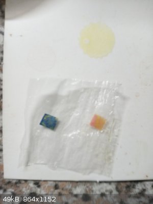

the reaction stopped by neutralization of NaOH by diluted HCl, universal indicator paper showed initially strongly alkaline pH (left blue paper) and slightly acidic after the neutralization (right reddish paper)

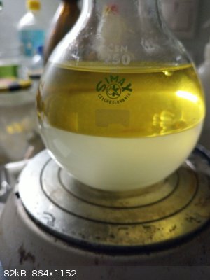

after the neutralization the mixture was allowed to settle
IMG_20221010_184605_3.jpg - 86kB IMG_20221010_185106_6.jpg - 106kB IMG_20221010_190115_4.jpg - 82kB
using separatory funnel the upper yellow organic phase was separated and bottom aqueous phase discarded (its density was higher very likely due to NaCl)
then the yellow organic phase was washed with water but now the water phase was as upper layer and the organic phase was bottom layer... densities of the product and water seems to be quite close together

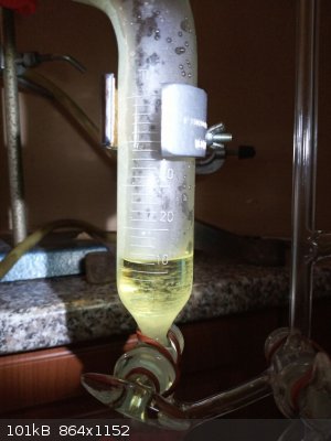

drying with CaCl2, still surprisingly a lot of water phase (colorless) on the bottom due to higher density thanks to CaCl2, using only as little of CaCl2 as dissolves is enough, no need to waste organic layer adhering to crystals of CaCl2 hydrate

vacuum distillation using stronger vacuum (2 stage oil rotary vane vacuum pump) and regular setup including thermometer and condenser... Anschutz-Thiele adapter later revealed to be unnecessary, predistillation removed all forerun, instead of the adapter also 2 neck receiving flask could be directly connected to the condenser (similarly as used in predistillation)

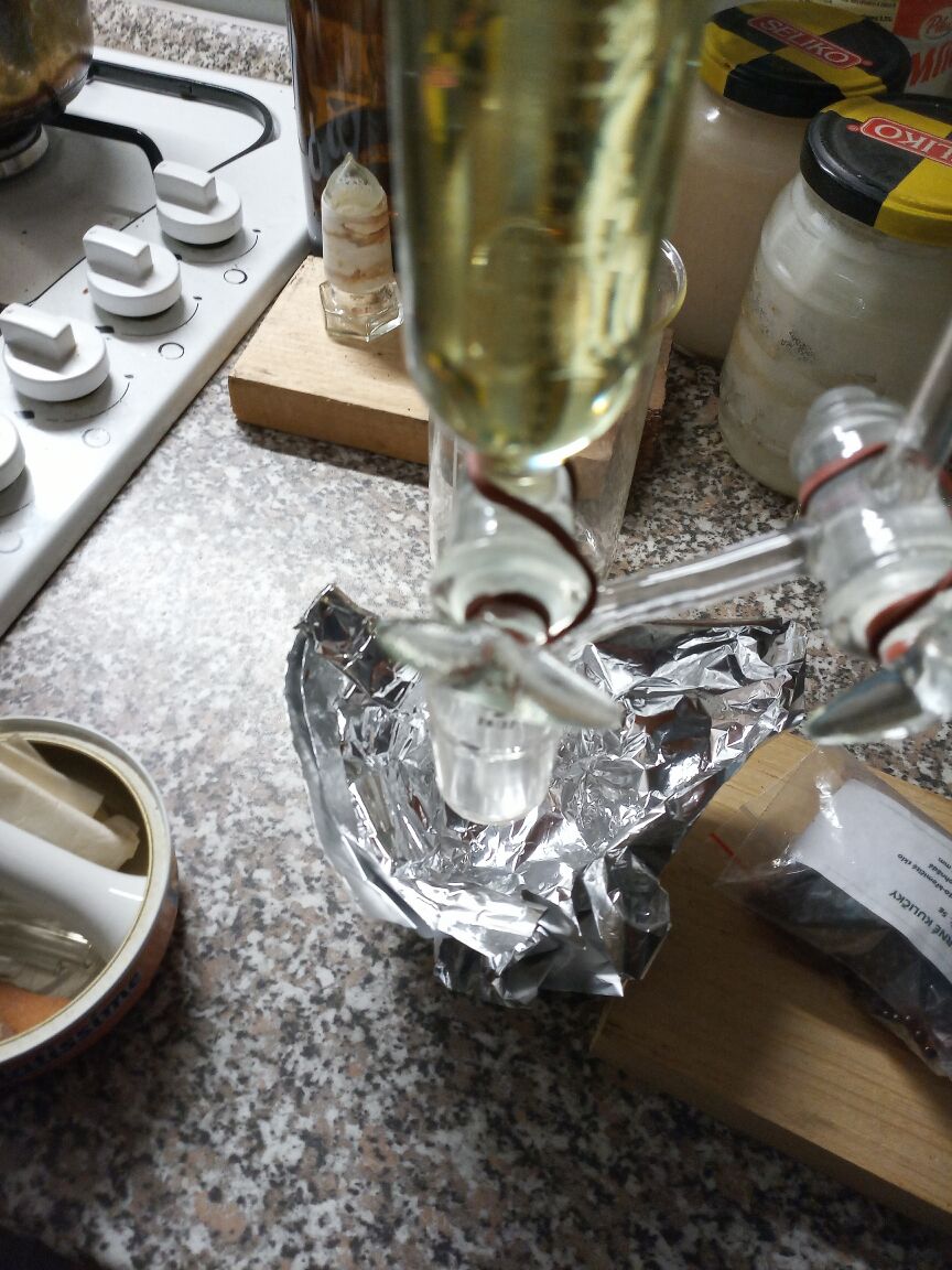

finally the receiver was warmed to melt the product completely
IMG_20221115_162525_4.jpg - 80kB

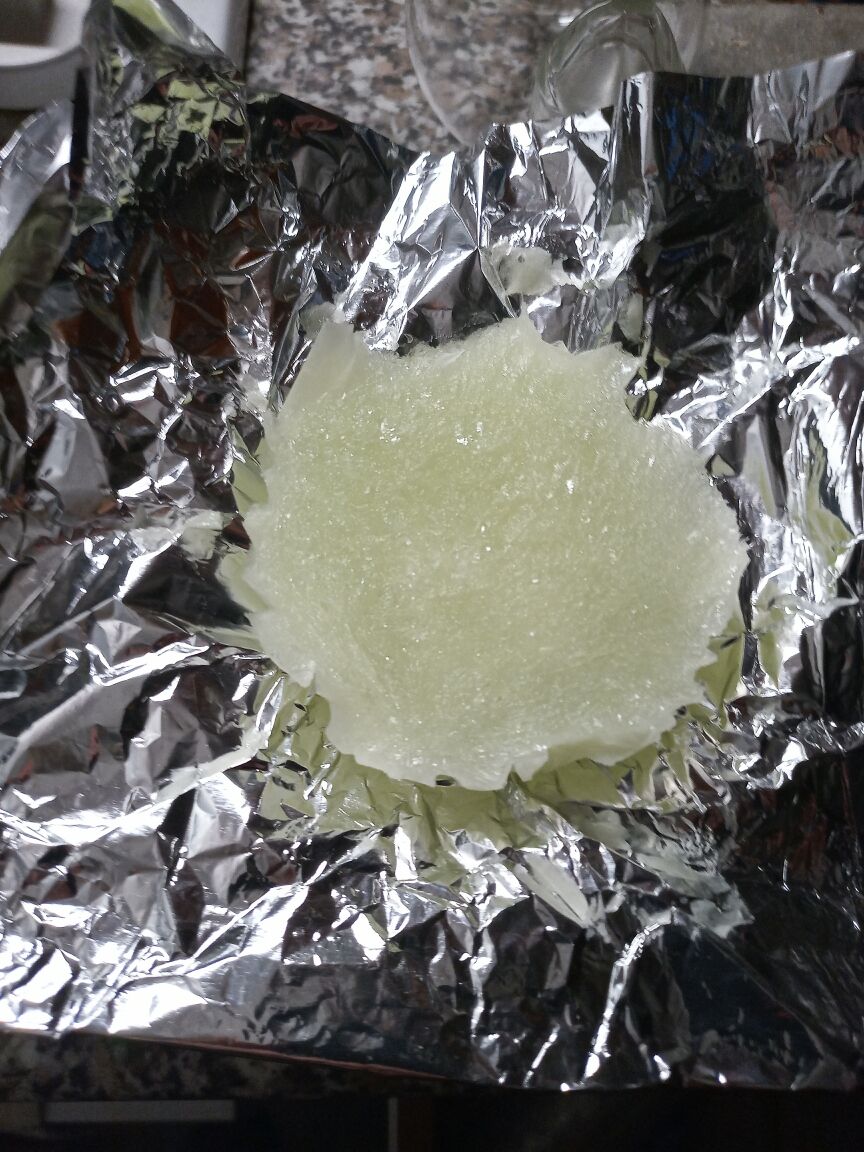

and liquid product was drained into a dish with aluminium foil bed in which it was let to solidify
IMG_20221115_162542_6.jpg - 165kB IMG_20221115_162638_2.jpg - 127kB IMG_20221115_171740_4.jpg - 189kB

Hi Bedlasky, its scent is nice, some kind of sweet, but hard to describe.
Dibenzalacetone should be in the remainder in the distillation flask after vacuum distillation, but it was quite dark and contaminated with some aldol polycondensation compounds so I discarded it.
