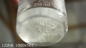

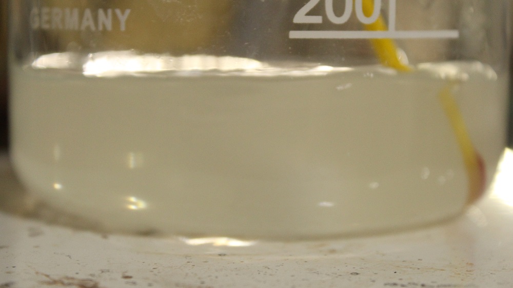

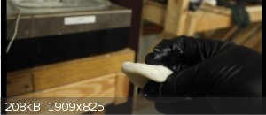

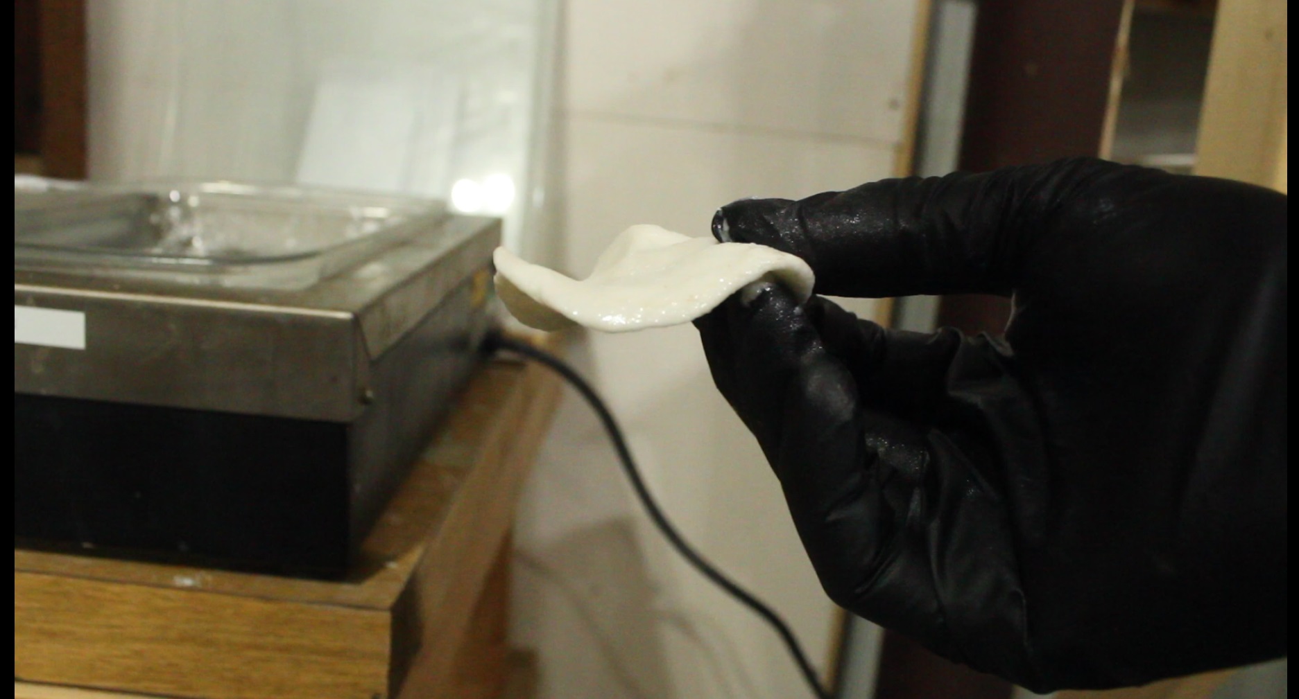

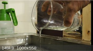

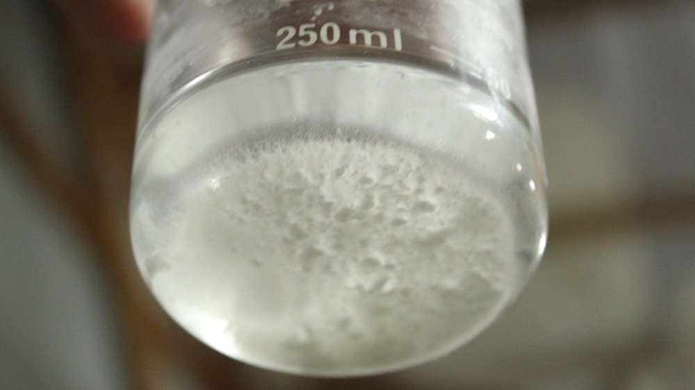

I wanted to double displace with glycine ammonium perchlorate and HCl, it didnt happen, here's why...
The first thing I did was heat up 50ml H2O to around 90 C then added .083 mol NH4ClO4 with a matching molar of glycine. At some point during boiling, I detected ammonia with my sniffer. The next thing I knew I was looking at a thick white paste. I put it on a hot plate, it started melting weakly around 140 C or so. I put some under a propane torch, it seemed to melt and let off higher energy perchlorate response with the occasional flash and blue white light.
I then repeated with .485 mol equivalents. This time I refluxed in an open beaker. I first heated the NH4ClO4 in water to around 80 C and had no detection of ammonia. Glycine was added, the temp dropped a little then around 85 C bubbling began and the smell of ammonia was detectable. Litmus paper was hung over the beaker and it gave an alkaline color change ~7-8 pH. Ammonia is being evolved from NH4ClO4 after glycine is added to a boiling solution. I refluxed this, adding water to reduce foaming until I couldnt detect a positive ammonia smell over the beaker, around an hour, fifteen minutes of boiling. Then it was poured into a few hundred ml isopropanol and a precipitate separated to the bottom of the beaker. It melts on a hot plate much lower temp... Probably around 103 C, it has a wide melt temp shelf, I took it up to 145 C and it melted easily, no decomp.
Glycine decomp is 233 C, NH4ClO4 is 200 C. Neither materials melt.

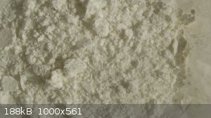

I think this may be glycine perchlorate. It's drying right now.-- It's possible glycine perchlorate can be made by refluxing glycine and ammonium perchlorate until ammonia is lost. If that is in fact what is happening, and if the specs on glycine perchlorate are correct, it's the easiest 8400m/s 32 GPa 103 mp material that I know of. Ive found threads on glycine nitrate. There is nothing on glycine perchlorate. It blows away most amino acid salts in performance, the closest follow up is iso-leucine perchlorate at 7900 m/s and aspartic acid nitrate at 7500 m/s 22 GPa. BTW ASP.NO3 has an mp of 98 C and Td of 183 C. TNT is 6800 m/s 19 GPa mp 80 Td 295.

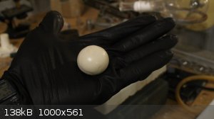

Hey Buddy - 18-12-2022 at 23:09
IMG_9274.jpg - 168kB IMG_9286.jpg - 176kB IMG_9288.jpg - 130kB
IMG_9269.jpg - 183kB IMG_9289.jpg - 155kB

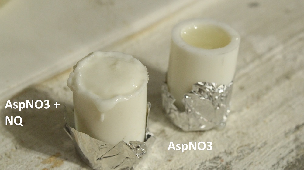

I got some aspartic acid. Obviously I'm going to test feasibility of boiling displacement of ammonium nitrate/aspartic acid in the morning.
Perhaps guanidium nitrate ASP or Glycine... I believe glycine might condense as a cyclic.

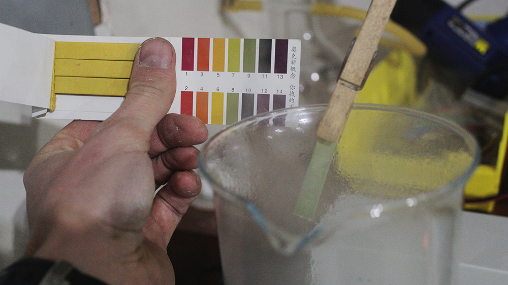

Hey Buddy - 19-12-2022 at 11:18
Aspartic acid in NH4NO3 does not have the same effect as the perchlorate. There is no detectable liberation of ammonia and no change of litmus paper.
It definitely looks like the addition of glycine to ammonium perchlorate is displacing the ammonia. During the repeat test with glycine, I dipped a litmus paper into the solution and it gave a slight acidic response, this would suggest free perchloric acid is in the solution.
The only thing that is unclear to me is if this is making proper glycine perchlorate. The reason is the dried product is not very reactive to flame. In the referenced literature there is a picture of GlyClO4 combusting with a clear 10 cm flame. When I hit this produced material with a torch it lets of sparks and decomposes into black residue with melting at surface. There is no big flame. Perhaps it could be crystal structure? Possibly not dried well enough?
I also wonder if the simple displacement is only attributed to glycine alone or if it is possible with other larger carbon amino acids.
I suppose a test of glycine in NH4NO3 would be good and a test of aspartic acid in NH4ClO4. That could give a better idea of what is generally going on.

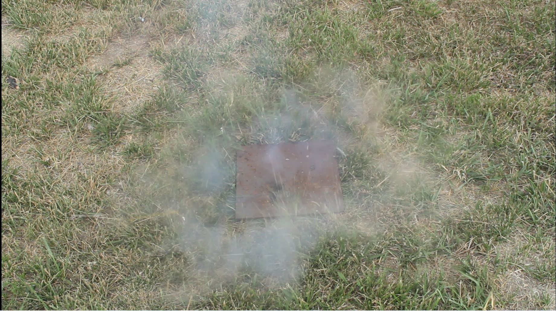

Im stumped on flame size not being the same as the referenced test. The GlyClO4 in picture is clearly more vigorous burning than controls of TNT RDX TNP and HMX. In the tested displacement phenomenon, there is only NH4, ClO4 and Gly present. If ammonia is liberated, which it is, then there can only be glycine and perchlorate both of which have much higher bp than water. It should be producing GlyClO4. I don't know why the reactivity appears much lower than it should.

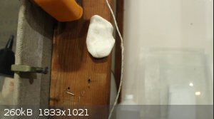

Artboard 1.jpg - 155kB amino_ionics_chart.jpg - 279kB gly_clo4.jpg - 135kB
[Edited on 19-12-2022 by Hey Buddy]

Based on his description his material sounds close to what Im seeing in this material.
I now strongly suspect GP can be produced by the refluxing of NH4ClO4 and Glycine.
If this is GP, then the Zhang article may not be accurate. Their GlyClO4 stats might not be correct either. Im going to have to make a new personal rule to disregard chinese researchers because I have been served so much confusion and misdirection over the years taking their reports at any literal interpretation. Their flame color in the photo isn't really even consistent with the appearance of flames from the many perchlorates and perchlorate compositions that are known.

Etanol, this is exactly what I mean. The paper uses photos of burn tests suggesting the materials burn vigorously more so than RDX control sample. The photo line up and charts in combination are convincing enough, although they seem exaggerated. I'd assume their numbers are calculated not measured. I dont think they faked the photos, because that would be a lot of effort and wouldnt make sense. But I'm not yet convinced that the results are reproduceable nor accurate. My intent was to show how glycine was displacing ammonia from its perchlorate. I do think the amino acid materials need a lot more investigation, they definitely melt, so that makes it worthwhile. I havent had time nor weather to do much experimenting lately. Id like to test some glycine perchlorate from HCLO4 to compare and see if their burn tests are repeatable that way.

Samples made from ammonium displacement are burning nothing at all like their claimed burn profile, but they do melt and do react to heat. That would suggest glycine perchlorate is produced but maybe it has contamination of unconverted NH4ClO4 or Ammonium Glycinate. If it can be determined how to push reaction to GlyClO4 with that method, it would really qualify as a high yielding inexpensive OTC explosive preparation. IMO to produce it using HClO4 is fine in small quantity, but it is a bit laborious to produce for a lot of material. So displacement is preferable. If it were possible via displacement, you could buy glycine and make a perchlorate cell for your salt, then drop it out as ammonium cation. It would be a magnitude simpler route to achieve 8km+ melt cast explosive, rather than say K-6/RDX. Also insensitive. Not sure what critical diameter would be but I dont see why it would be large. If critical diameter were low, and high performance were realistic, GlyClO4 would have a lot going for it. You can find glycine ~$10-20/lb but it doesnt have to come from limited pyrotechnic stores. If the ammonium displacement method could be worked out, no acid would be necessary, which is a considerable savings. The perchlorate can be had at the cost of NaCl and NH4 and kW/hr/$.

Hey Buddy - 12-1-2023 at 17:18
--Philou, that is excellent info on the diketopiperazine. I think a nitramide variation is interesting but the diketopiperazine should in itself make its own metal complexes shouldnt it? I think tetrazole lover in the past prepared piperazine extracted from OTC dewormer. IIRC in a comment he stated that piperazine perchlorate complexes were some of his preferred initiation compounds. I can attempt a controlled decomp. I have aspartic acid and glycine on hand.
--If it assists in making it more clear, the preparation I used to come up with the blue crystal was approximately:
Molar equivalents of perchlorate and glycine heated in minimum water, nickel wire was added in excess with stirring, soln turned bright green after an hour or so. Alcoholic hydrazine was added in molar equivalence. Solution was heated/stirred at around 30C overnight. Solution was royal blue next morning and was then gently air dried in an open container until crystals remained. They are still in drying but I may try to get a picture of them tonight and if they seem dry I may try to get a cautious idea of the sensitivity. I have read of some impractically-high-sensitivity Ni/N2H4/ClO4's so I will be careful in handling. It is a small sample and I will be prepared for detonation. I was thinking that complexing the perchlorate with the glycine and nickel before the hydrazine may be the safest way to experiment and it seems like it went through perhaps at least one intermediate complex changing from green to blue. Im not really sure though.
edit:
It is not flame or impact sensitive like a primary explosive. It burns like an angry version of a nitramine where the mass shoots around on foil. It produces a good amount of smoke. Not sure on residue because it burns holes through foil. A burning test can only give little idea of profile but in terms of things I've burned, it seems to have the most violence in burning, not like a ddt substance but more like ANQ or K-6. But with very little flame. And a bit of smoke. Mostly shooting out jets and smoke. Something about it just seems angry though, hard to explain. It seemed like only small spots burned reacting to flame but they burn with a lot of gas pressure and noise so it makes you think it's going to detonate, but it just burns. It seems to be holding water too. It doesnt seem to be totally dry despite drying for ~2 days on low heat. Sensitivity to hammer impact by hand seems fairly low, maybe a little more impact sensitive than ETN. Im not in search of this kind of material right now but it is interesting. The simplicity of Gly/ClO4 is the most intriguing. Maybe I should try nickel with hydrazine and add to GlyClO4 instead... 2,5-Diketopiperazine seems worth a test in complexation. I assume it can be prepared from heating glycine to under the decomp temp of 230 C.
edit 2: also seems like there was a red spot or two on crystals, not sure if this is a contaminant or a different oxidation state. I burned one of the red crystals and it behaved the same as the blue.
[Edited on 13-1-2023 by Hey Buddy]

Hey Buddy - 18-5-2023 at 21:15
I'm back on glycine perchlorate again. The original samples from direct NH4ClO4 displacement have been stored until this last week. The samples appeared to have a slight color change, browning. I attempted to melt cast the samples. They would not melt. Im not sure what to make of that. I attempted a double displacement of glycine and ammonium perchlorate with equivalent HCl. The solution was boiled down to precipitation and then dried over night. A white powder dries out of evaporated solution. This material was put in a pan over 120 C and it melted easily. I have cast a test cylinder for firing. The glycine perchlorate made this way casts very densely and is probably the best material I've casted with. It seems denser than TNT and is very flat and smooth on its surfaces. There are no air bubbles nor off gassing during melting. I tried to burn a piece to see if it's burn flame matched the images from earlier in the thread. It did not behave with a large flame as in the pictures but rather fires off gaseous hisses through out burning and in this limited test the material didnt entirely catch fire and required continuous flame to decompose. I tested some of the first old material by firing against a can, it explodes in small mass and has a low critical diameter. I have fired it as low as 50 mg mass in confinement. I will churn out some more glycine perchlorate and continue testing but it's a pretty useful material simply from the castability alone.
UPDATE:
apparently glyClO4 melt cast detonates from a cap of NAP directly with no booster. I loaded a 1"x1.5" cylinder. couldn't find anything remaining in the dirt.
I only made one sample as a test, so now I will replicate

Here is a sitrep:
It looks good, Im really pleased. but it's not settled at all. First, there are some issues with the production methods and their products. I'm not entirely sure that only glycine perchlorate is being produced. Or how much of the material is being converted to glycine perchlorate. Is it 100%, 90%, 80%? This I dont know. Obviously the way around that is to use HClO4. In my opinion, HClO4 is a last resort because it adds a magnitude of effort to an otherwise effortless preparation. The two preparations Ive used so far at small <20 g samples:
1) Reflux NH4ClO4 + Glycine in a beaker, several hours, evaporate, dry.
2) Reflux NH4ClO4 + HCl + Glycine in a beaker, several hours, evaporate and dry.
Method 1 produces a powder which appears to melt above 100 C and less than 140 C. I did not try casting with the material, only tested if it melted in correct range. This material detonates in small masses ~50 mg+. This material undergoes some browning over months of storage in air tight container. This material after long storage lost its ability to melt at the same temperature range as before.
Method 2 produces a white powder that melts between 100-120 C. It melts very easily and homogenous pour that isnt too thick or thin. I casted this material into a 1x1.5" PEX line, buried it in dirt. Primed it with an NAP cap of stainless steel. There is a hole in the ground wide enough for my hand and ~8" deep. With pulverized dirt on the edges. I found no remaining plastic in the hole, no shreds, no powder or melt cast material. I went back out to the hole again and dug out the pulverized dirt and recovered 2 strips of flat stainless steel from the blasting cap. The hole was impressive for the size of the charge. It was a small charge so when it detonated in dirt the report wasnt impressive to the ear.
The sensitivity of GlyClO4 is supposed to be very low. I will hammer test for impact on the next batch to verify insensitivity. Overall, it is capable of doing work. It's hard to say from only one small charge shot, but it seemed less powerful than Comp B but more powerful than TNT. The hole was more than I would expect from TNT. Overall it just needs a lot more testing. I also think maybe some of the amino acids not from the original paper would be worth trying because if they can hold a positive OB with the oxidizer addition and melt at low temp, it could be the perfect cast carrier. I think glycine perchlorate for the price and availability and ease of preparation is really good, already. TNT and even TNP is way more effort and time in production compared to this. Even the NQ eutectic melts are more time/effort.
I need to distill some nitric and try the AspNO3, it should be boiling water bath meltable. Glycine is about twice as cheap as aspartic acid...
And it melts well, the glyClO4. It is very workable, pourable. dries so flat. Hardens like a thermo plastic. I may try a couple with Al to see if they thermobaric...
I think a high energy material like ANQN or K-6 would be well within the safe temp of cast and would probably be pretty high performance for cast comps. I wonder if ANQN would be protected and stabilized further by the melt cast?
[Edited on 20-5-2023 by Hey Buddy]
UPDATE:
I just went out to measure the actual hole and Im glad I did because my assumption of 8" was way overblown. It was really about ~5". Diameter was around ~4".
Still, GlyClO4 is looking pretty good in my book.
IMG_0818.jpg - 838kB IMG_0819.jpg - 784kB

disappointing update:
Well, Im still drying out the 2nd batch of glyP to validate the first test. I was mowing the field today and found the section of PEX from the test about 25 meters from the test site. It is expanded but barely damaged, not even ripped apart. Assuming it is the casing from glyP test, it must have fired out of the hole like a rocket. Somehow, despite not destroying the casing, it managed to blow a hole in the ground. Im not sure what exactly to make of that... I found blasting cap segments in the hole at time of test but no casing fragments, so I assumed it was practically destroyed. It's possible it could be a casing from an entirely different test at another time, but I think it is the glyP test. If it is, then glyP made from the salt methods cant be as powerful as TNT. TNT shreds this stuff.
The modified update is: glyP from HClO4 needs to be tested. Mixed salt glyClO4 dodesnt look "as good" as it did. It still melts and fires, but it's certainly no 8km/s. Maybe glyP from salts is a good rocket fuel if it is launching pipes like that?

Regarding explosive character of the dirty version of GlyClO4:
I used NAP to test all detonations of the material.
The brown version from the bottle (mentioned before, prepared without HCl), could be detonated but not melted. It can be detonated in small masses like a primary explosive (>50 mg). I believe this is only possible due to the power of NAP.
--A fresh sample made with HCl was cast within 2 days of drying in a 1" diameter x 1.5" length. It was not hygroscopic.
That sample detonated entirely and I believe it is detonating at reduced velocity. I couldn't say for sure, but suspect it's detonating around 5-6km/s. That test's results are in the photos posted earlier.
I attempted to prepare a sample using Isopropanol solvent. Neither glycine nor ammonium perchlorate appeared to dissolve into boiling IPA. the IPA sample was dried then refluxed again in water. Ammonia was evolved.
Reflux lasted 1 hour. The sample was cooled to room temperature and stayed dissolved in the water. While in liquid phase, and at RT, 90% IPA was added to the sample.
White material precipitated. The beaker was left out overnight and resulted in two crystals. A long needle crystal which consolidated over the ptfe stir bar, and large blocky square crystals which formed on the bottom of the beaker. The crystals were decanted and separated on a hot pan. The crystals would not melt at 120 C.
Im not sure what any of this means, but I thought I would just describe this and maybe someone would get value out of it. I have no idea why the material seems to behave unpredictably. My only guess is there are variable proportions of impurities at play here.

60 ml dH2O was added to a beaker (@ rt ~30 C), water was stirred as 70.6 g Aspartic Acid was added.
Asp conglomerates in a somewhat insoluble, self-clinging, white mass at the bottom of beaker. It can be stirred into the slurry but it quickly settles back to the bottom as a thick mass.
Nitric was added slowly. At 10ml addition of HNO3, the temperature of reaction increased 7 C and the mass concentration of aspartic acid changed as it was converted to nitrate, dissolving into solution.
*60 ml H2O was probably too much H2O. two-thirds or even half is probably suitable, despite the insolubility of aspartic acid at first addition.
On complete addition of HNO3, temperature was 40 C. The reaction changed from thick and opaque to thin and clear like water within around 10 minutes.
The reaction was stirred ~15 minutes after complete addition of HNO3.
The viscosity of the finished nitrate product in this volume of water is a syrup, similar to mineral oil.

I've been playing with AspNO3 for the past day. Here are some findings...
Regarding AspNO3 itself:
This material is hygroscopic and water soluble. When dried, it is a semi-solid similar to a glassed soft-polymer like melted sucrose. It melts below 100 C as referenced in paper. In melt phase, it is thicker towards 100 C, perhaps like a melted sugar. It becomes thinner at higher temperatures like melted butter.
I mistakenly used too much nitric acid because the concentration was unknown. During melt phase, a lot of what (I'm assuming) was excess HNO3/H2O was vaporized into the air.
AspNO3 casts as a clear semi hard flat cast, similar to a soft epoxy. It is hygroscopic on the surface.
It is soluble in acetone, MeOH and IPA
Insoluble in nitromethane
It forms a milky solution and in acetone, falls out of solvent as a powder and when removed, quickly returns to goo. It possibly reacts with the solvents changing its properties, like melting point and opacity.
Now the interesting part:
Melted AspNO3 plasticizes nitroguanidine. I cant tell you what the rate is, because I learned this in haphazard experimentation, not expecting it to melt NQ. Not only does it melt NQ, it does so with impressive proportions of NQ. It seems endless. I stopped adding NQ because I simply didn't want to use that much nitroguanidine stock.
The NQ is dissolving in AspNO3 presumably at or near max density. It is certainly the easiest way to achieve max density of NQ. Plasticized NQ is very sticky while hot but cools in a few minutes to consistency remarkably similar to comp C4. It shapes and forms practically identically to C4 warmed to body temperature. It has greater adhesive properties than C4, and easily bonds its surface to concrete, wood, metal and plastic. It can be molded into shapes and can mold into thin sheets.
The NQ plastique has two components, the AspNO3 and the NQ plastique itself. The AspNO3 component appears to retain hygroscopicity at surface of material and cast shape but the inner volume of material is unaffected. The NQ plastique can be exposed to water where the ASPNO3 in exposure to water is dissolved, leaving the NQ at ultra high density which cures to a hard plastic like PVC. The plasticity of the NQ plastique (without additional hydrophobic plasticizer) is moldable on exposure to atmospheric air for around 6 Hours. At 6 hours the plastic begins to set hard. I haven't tested if it can be remelted yet.
FYI: Nitroguanidine has been underutilized due t its low density crystal form which really cant be overcome easily. High bulk density techniques are used but are under performing. propyl nitroguanidine is another way to melt NQ but its not really feasible and I believe it loses some of the benefit of NQ. The performance of NQ at high density is reported to be 8344 m/s Vd, 29GPa pressure @ 1.759 g/cc according to Koch.

Hey Buddy - 27-6-2023 at 20:48
The AspNO3 cast into a 1" body began to leak out of the bottom today as temperatures got into 90 F in garage. In my mind, there was no reason therefore to attempt a detonation of that straight sample because anything that leaks at ambient temps isnt really a suitable material in stand alone casting. I attempted to fire the unknown qty NQ/AspNO3 mix. It did not detonate on a 1g NAP cap. Thats business as usual for nitroguanidine. It projected the material all over in small pieces.
I then attempted a PETN pbx and recorded numbers this time. 13.44 g AspNO3 were melted at 110 C on a glass dish. 13.46 g PETN were slowly added and carefully kneaded into melt. The entire mass appeared to melt in with the aspNO3. By the end of addition, consistency was like a dense dough. The material stuck to the watch glass and a ball of 23.95 g was recovered from the melt. This is a plastique 50:50 w/w AspNO3/PETN. The material is very much like C4 again, but you can feel it is less dense. Its pliability and rigidity attributes are quite similar to C4. It sets into hardening slower than the NQ mix. I rolled it into a ball as well as I could and calipered the diameter (31.92 mm) and came to the density of 1.406 g/cc which is somewhat low, presumably entrapped air and water. No degassing. C4 is at ~1.72 g/cc, for comparison. PETN should be 1.77 g/cc and the AspNO3 should be 1.60 g/cc. This PETN/AspNO3 should fire with less fuss than the NQ analogue.
Last image is high density NQ separated from water solution of the NQ plastic from earlier. This technique, melting NQ into a water soluble substrate, then dissolving substrate, may be handy for high NQ density. More testing needed, but looks promising.
Aside from hygroscopicity, the quality of these plastics is quite good. The PETN version seems less attracting to water, but the NQ version wasn't maxed out on w/w NQ, so it may actually work better. I made a sample of the NQ version and added a small amount of PETN as sensitizer to test as well.
If a low temp melting amino acid were found, without hygroscopicity, it could be very useful in a simple 2 part mix alone. Additives could improve these I'd imagine, but for two simple components, energetic melt carrier and filler, they are quite good. I'm familiar with government contract produced C4, and these two materials are pretty similar in handling. Which is interesting to me because they are so simple with no inerts, and were randomly learned of.

report for anyone interested:
I recovered NQ from one of the NQ/AspNO3 charges by simply soaking it overnight in water, then rinsing with water and drying on heat for 24 hours. I believe all of the AspNO3 is dissolved in water. NQ is left behind. The density measured was 1.4 g/cc - 1.5 g/cc on the sample recovered. There could be something unseen at play responsible for that reading, such as an unkown chemical reaction of the molecule, but assuming it is actually NQ, it's higher than industry standard high bulk density NQ, which is .97 g/cc in strict cases. In broad application, high bulk density NQ is considered >.81 g/cc. I give the range of 1.4 -1.5 g/cc to cover error. 1.4 g/cc is certainly attained by this material recovered out of AspNO3/NQ melt.
IMG_9770.jpg - 188kB
[Edited on 30-6-2023 by Hey Buddy]

It appears glycine nitrate is hygroscopic as well. I've been drying a sample for 24 hours on heat...
Glycine is so inexpensive its probably the most realistic for the cast purpose. Maybe a complex is the way to go...so many combinations. endless... I got the isoleucine but it has added sugars making it useless. I got lysine but they sent the HCl by mistake. Perhaps its a sign its time to take the ANQN/TNT pill and get off these fancy fly by night amino acids.
IMG_9773.jpg - 186kB
GlyNO3 melts technically at reported mp but is workable around 170-180 C. It dissolves NQ but its composite isn't very dense. I'm melting in NQ to these amino acids to inspect their melt character.
[Edited on 1-7-2023 by Hey Buddy]
It's now the next day, the NQ/GlyNO3 and straight GlyNO3 are definitely less hygroscopic than aspNO3 or NQ/NH4NO3 eutectic. Unfortunately, the mp of glyNO3 makes it only useful for high temp explosives and it's also low power. If there is great variation in hygroscopicity in amino acid nitrates, perhaps there is a low melt non hygroscopic amino acid ionic compound.
