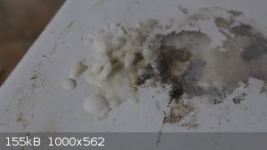

[*] posted on 19-12-2022 at 11:18
Aspartic acid in NH4NO3 does not have the same effect as the perchlorate. There is no detectable liberation of ammonia and no change of litmus paper.
It definitely looks like the addition of glycine to ammonium perchlorate is displacing the ammonia. During the repeat test with glycine, I dipped a litmus paper into the solution and it gave a slight acidic response, this would suggest free perchloric acid is in the solution.
The only thing that is unclear to me is if this is making proper glycine perchlorate. The reason is the dried product is not very reactive to flame. In the referenced literature there is a picture of GlyClO4 combusting with a clear 10 cm flame. When I hit this produced material with a torch it lets of sparks and decomposes into black residue with melting at surface. There is no big flame. Perhaps it could be crystal structure? Possibly not dried well enough?
I also wonder if the simple displacement is only attributed to glycine alone or if it is possible with other larger carbon amino acids.
I suppose a test of glycine in NH4NO3 would be good and a test of aspartic acid in NH4ClO4. That could give a better idea of what is generally going on.
Im stumped on flame size not being the same as the referenced test. The GlyClO4 in picture is clearly more vigorous burning than controls of TNT RDX TNP and HMX. In the tested displacement phenomenon, there is only NH4, ClO4 and Gly present. If ammonia is liberated, which it is, then there can only be glycine and perchlorate both of which have much higher bp than water. It should be producing GlyClO4. I don't know why the reactivity appears much lower than it should.

Based on his description his material sounds close to what Im seeing in this material.
I now strongly suspect GP can be produced by the refluxing of NH4ClO4 and Glycine.
If this is GP, then the Zhang article may not be accurate. Their GlyClO4 stats might not be correct either. Im going to have to make a new personal rule to disregard chinese researchers because I have been served so much confusion and misdirection over the years taking their reports at any literal interpretation. Their flame color in the photo isn't really even consistent with the appearance of flames from the many perchlorates and perchlorate compositions that are known.
[Edited on 20-12-2022 by Hey Buddy]

[*] posted on 12-1-2023 at 17:18
--Philou, that is excellent info on the diketopiperazine. I think a nitramide variation is interesting but the diketopiperazine should in itself make its own metal complexes shouldnt it? I think tetrazole lover in the past prepared piperazine extracted from OTC dewormer. IIRC in a comment he stated that piperazine perchlorate complexes were some of his preferred initiation compounds. I can attempt a controlled decomp. I have aspartic acid and glycine on hand.
--If it assists in making it more clear, the preparation I used to come up with the blue crystal was approximately:
Molar equivalents of perchlorate and glycine heated in minimum water, nickel wire was added in excess with stirring, soln turned bright green after an hour or so. Alcoholic hydrazine was added in molar equivalence. Solution was heated/stirred at around 30C overnight. Solution was royal blue next morning and was then gently air dried in an open container until crystals remained. They are still in drying but I may try to get a picture of them tonight and if they seem dry I may try to get a cautious idea of the sensitivity. I have read of some impractically-high-sensitivity Ni/N2H4/ClO4's so I will be careful in handling. It is a small sample and I will be prepared for detonation. I was thinking that complexing the perchlorate with the glycine and nickel before the hydrazine may be the safest way to experiment and it seems like it went through perhaps at least one intermediate complex changing from green to blue. Im not really sure though.
edit:
It is not flame or impact sensitive like a primary explosive. It burns like an angry version of a nitramine where the mass shoots around on foil. It produces a good amount of smoke. Not sure on residue because it burns holes through foil. A burning test can only give little idea of profile but in terms of things I've burned, it seems to have the most violence in burning, not like a ddt substance but more like ANQ or K-6. But with very little flame. And a bit of smoke. Mostly shooting out jets and smoke. Something about it just seems angry though, hard to explain. It seemed like only small spots burned reacting to flame but they burn with a lot of gas pressure and noise so it makes you think it's going to detonate, but it just burns. It seems to be holding water too. It doesnt seem to be totally dry despite drying for ~2 days on low heat. Sensitivity to hammer impact by hand seems fairly low, maybe a little more impact sensitive than ETN. Im not in search of this kind of material right now but it is interesting. The simplicity of Gly/ClO4 is the most intriguing. Maybe I should try nickel with hydrazine and add to GlyClO4 instead... 2,5-Diketopiperazine seems worth a test in complexation. I assume it can be prepared from heating glycine to under the decomp temp of 230 C.
edit 2: also seems like there was a red spot or two on crystals, not sure if this is a contaminant or a different oxidation state. I burned one of the red crystals and it behaved the same as the blue.
[Edited on 13-1-2023 by Hey Buddy]
_MG_9297.jpg - 168kB 2.jpg - 120kB
