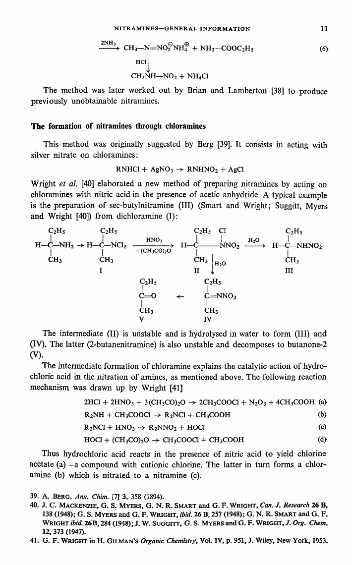

Not sure if the below relates to this topic:
The nitration of aliphatic secondary amides and of primary and secondary aliphatic amines has been studied extensively and some understanding of the reaction is now at hand. Firstly it has been found that the ease of nitration in acetic anhydride varies inversely in respect of increasing base strength. Secondly those strong amines which cannot be nitrated directly can be converted to their nitramines via the intermediate preparation of the chloramines, presumably because the chlorine substituent reduces the base strength of the amine. In many cases the chloramine may be prepared in situ in the acetic anhydride - nitric acid medium by adding a small amount of hydrogen chloride. The hypochlorous acid thus produced forms the chloramine and is regenerated when the chloramine is converted to the nitramine. A chain reaction is thus developed which is largely self-sustaining. Finally primary amines, which cannot be nitrated directly, may be converted to primary
nitramines via the primary dichloramine. The alkylchloronitramine (which can be converted separately to the alkylnitramine) is the actual product of the latter reaction. This is fortunate because primary nitramines decompose in nitration media, often violently, in strong sulphuric or nitric acid. In acetic anhydride or acetic acid the decomposition rate is dependent on the amount of excess nitric acid which is present.
MECHANISM OF GUANIDINE NITRATION
George F. Wright
Canadian Journal of Chemistry, Volume 30
Could someone look into this excert?
The method was later worked out by Brian and Lamberton [38] to produce previously unobtainable nitramines. The formation of nitramines through chloramines
Urbanski

Rosco Bodine - 24-9-2012 at 21:46
George F. Wright
Urbanski
This is off for AH regarding the George F. Wright article in the Canadian Journal of Chemistry here is the article pdf
http://www.nrcresearchpress.com/doi/pdf/10.1139/v52-008

Trichlorohexahydrotriazine
Axt first broached the present topic in this thread
http://www.sciencemadness.org/talk/viewthread.php?tid=9370
The_Davster observed that =>
http://www.sciencemadness.org/talk/viewthread.php?tid=9370#p...
The reference cited from
Chemistry and Technology of Explosives vol 3 by Urbanski
Chloramine Urbanski.gif - 63kB

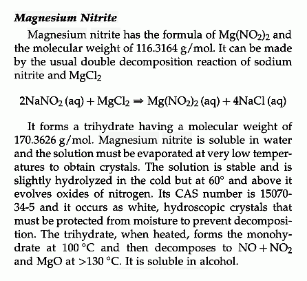

Electronic character of Magnesium Nitrite , Mg(NO2)2
Electronegativity Mg = 1.3
Electronegativity -O = 3.4
the difference is , 3.4 - 1.3 = 2.1 > 2 , an ionic bond ( although weaker than with sodium )
MgCl2 and Magnesium Nitrite are soluble in Methanol
The addition of some MgCl2 ( de-icing salt ) to the solution will procede as follows _
2 NaNO2 + MgCl2 => 2 NaCl + Mg(NO2)2 , , 2(-98 ) - (-154 ) = - 43 kcal
MgCl2 = ∆Hf -154 Kcal/mol
NaCl = ∆Hf - 98 Kcal/mol
Magnesium Nitrite.gif - 27kB
Encyclopedia of the Alkaline Earth Compounds from page 210[/size][/font]
http://books.google.com/books?id=yZ786vEild0C&pg=PA210&a...
Magnesium Nitrite is not stable and re-formation of MgCl2 favors exchange
with the organic Chloramine. Mg(NO2)2 + 2 ( =NCl ) => MgCl2 + 2 ( =NNO2 )
Starting materials total bond energies is 102 kcal _
Chloramine : H2N-Cl , 60 kcal
Magnesium Nitrite : NO2Mg-ONO , 42 kcal
Reaction result total bond energies is 118 kcal _
Nitramine : (CH2)2N-NO2 , ~ 41 kcal
Magnesium Chloride : ClMg-Cl , 77 kcal
MgCl2 does form a complex with Methanol
Magnesium Chloride forms hydrates with 2, 4, 6, 8, and 12 molecules of water.
Both the anhydrous and hexahydrate salt are deliquescent and need to be stored
under dry cool conditions. Magnesium Chloride is very soluble in water 54.6 gm
100 ml, and the hexahydrate is the only stable hydrate between 0 and 100 °C.
The anhydrous salt is also soluble in Methanol ( 20.4 gm at 60 °C) and Ethanol
(15.9 gm at 60 °C). On cooling , these solutions crystallize the alcoholate addition
compound , such as Magnesium Chloride hexamethanolate , MgCI2 •6CH30H ,
and Magnesium Chloride hexaethanolate , MgCI2 •6C2H5OH
The Chemistry and Technology of Magnesia from page 216
http://books.google.com/books?id=0ShuV4W0V2gC&pg=PA216&a...
Heating MgCl2•6H2O yields the basic salt, Mg(OH)Cl
MgCl2•6H2O => Mg(OH)Cl + HCl + 5H2O
Pure anhydrous chloride can be prepared by heating the double salt
MgCl2•NH4Cl•6H2O
MgCl2•NH4Cl•6H2O => MgCl2•NH4Cl + 6H2O
Ammonium Chloride sublimes on further heating , leaving pure anhydrous MgCl2
MgCl2•NH4Cl => MgCl2 + NH4Cl

as I see it , is that NaONO is soluble as ions whereas the organic Chloramine is solvated as a covalent molecule , so there is no basis for metathesis.
The N-Cl bond is weaker than the C-Cl bond. Chloramines can be protonated which leads to easy hydrolysis of the chlorine off the amine.
Trying to perform a substitution reaction in this situation has several potential problems, but getting the chlorine to come off is not really one of them.
One investigation mentions that nucleophilic substitution on chloramine to form chloride ions proceeds at a rate more than 100 times that of chloromethane (which may still be rather slow, considering that the hydrolysis of chloromethane with water takes around a whole year)
"Gas phase reactions of NH2Cl with anionic nucleophiles: nucleophilic substitution at neutral nitrogen", Roustam Gareyeva, Shuji Katoa, Veronica M. Bierbauma
Organic Chemistry of Explosives, p234, claims:
Metathesis reactions between N-chloramines and silver nitrite in alkaline solution are reported to give the silver salt of the corresponding primary nitramine.
There are some other threads in this forum about nitrogen trichloride, where you can read about how it reversibly hydrolyzes at low pH to ammonium ions and hypochlorous acid. At higher pH, it can hydrolyze to chloramine, though such solutions can be unstable if not highly diluted. It is much too complicated to try to get into the details of the reaction here, but the point is that the N-Cl bond can easily be hydrolyzed.
There has been similar discussion on this forum several times before. Typically what happens is some topic is being discussed, and then some member brings up this idea of making RDX by metathesis with NaNO2 or AgNO2 . I have seen it happen at least 3 times before. Someone should really start a specific thread for this idea.
I would suggest trying to react trichlorohexahydrotriazine with sodium nitrite in the absence of water, using propylene carbonate as the solvent. If there is any water, the nitrite will just be oxidized.
Even using alcohol, there might be undesirable reaction. Methanol apparently seems to be fairly inert to TCCA, but I would not completely discount the possibility of the solution containing some equilibrium of methyl hypochlorite, which could potentially be a reaction pathway for the oxidation of the nitrite. And I am not even sure how soluble NaNO2 is in alcohol.
