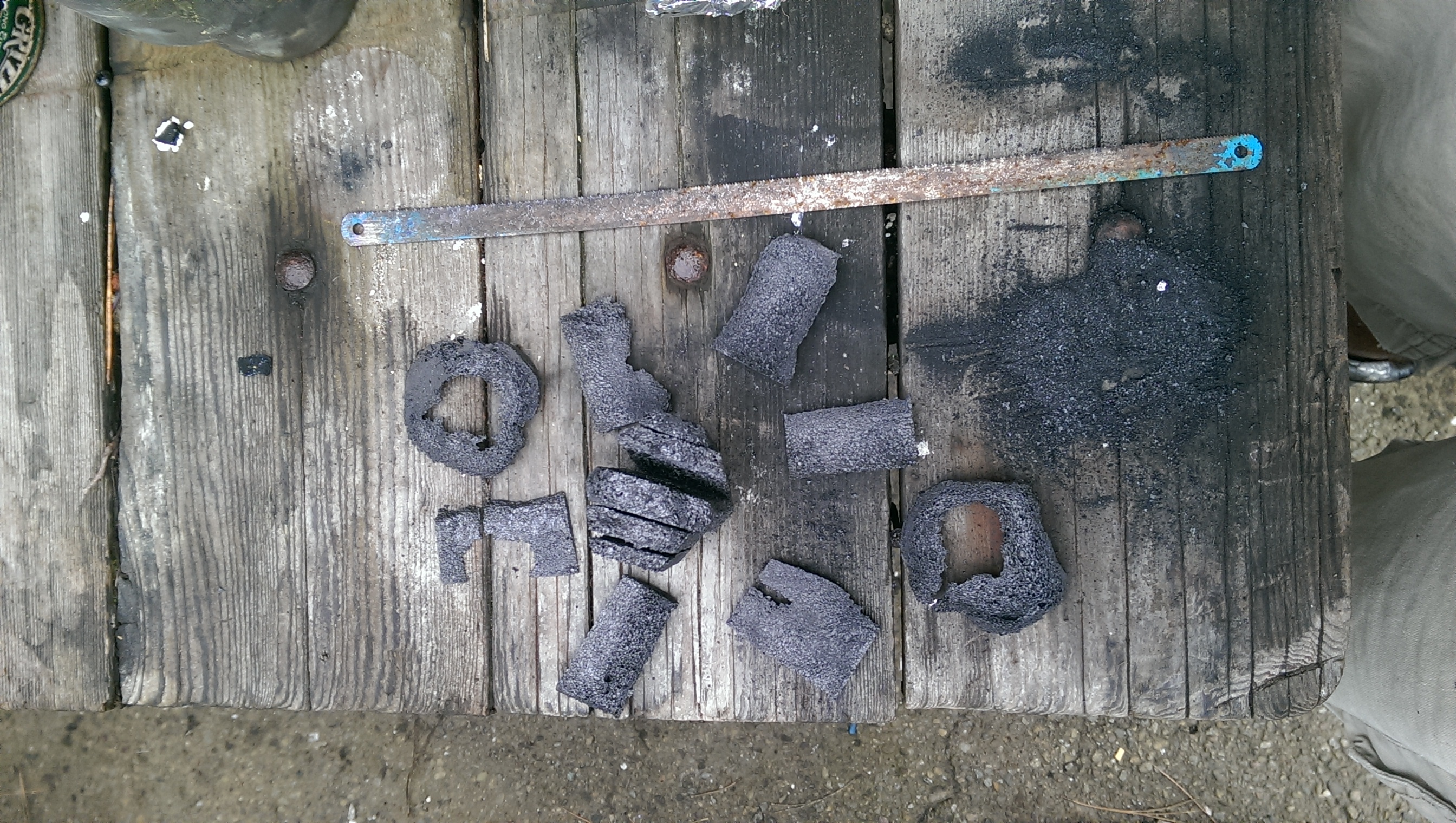

Two slices of bread (one a dense brown, the other white) were weighed at 31.75g and 32.50g respectively.
before.JPG - 43kB
The samples were prepared (wrapped in tinfoil) and introduced into the custom-built pyrolysis apparatus (a wood fire).
fire.JPG - 85kB
The fire was left to burn for 1 hour and the bread samples were recovered and allowed to cool for 5 minutes.
The brown slice had disintegrated almost completely, the largest fragment being approx 2cm across.
The white slice had entirely retained it's shape, although the size had decreased by approximately 50%.
It weighed 5.35g, representing an 83.5% weight loss.
after.JPG - 62kB
Under a cheapo USB microscope, the material appears very porous.
scope2.jpg - 76kB
Those lines are 1mm spaced.
I wonder how this will fare as a method to activate carbon ?
One way to find out ....
[Edited on 1-11-2016 by aga]

aga - 1-11-2016 at 06:40
The 'bread' is now rigid, yet breaks if you try to bend it, although it does not just fall apart.
Before doing the I.N. thing, i thought i'd test the bread's heat resistance.
Here's a piece with some copper melted on top of the bread with an electric arc.
copper.JPG - 72kB
Neither the arc (2000+ C) nor the 1085 C copper appear to have bothered it at all.

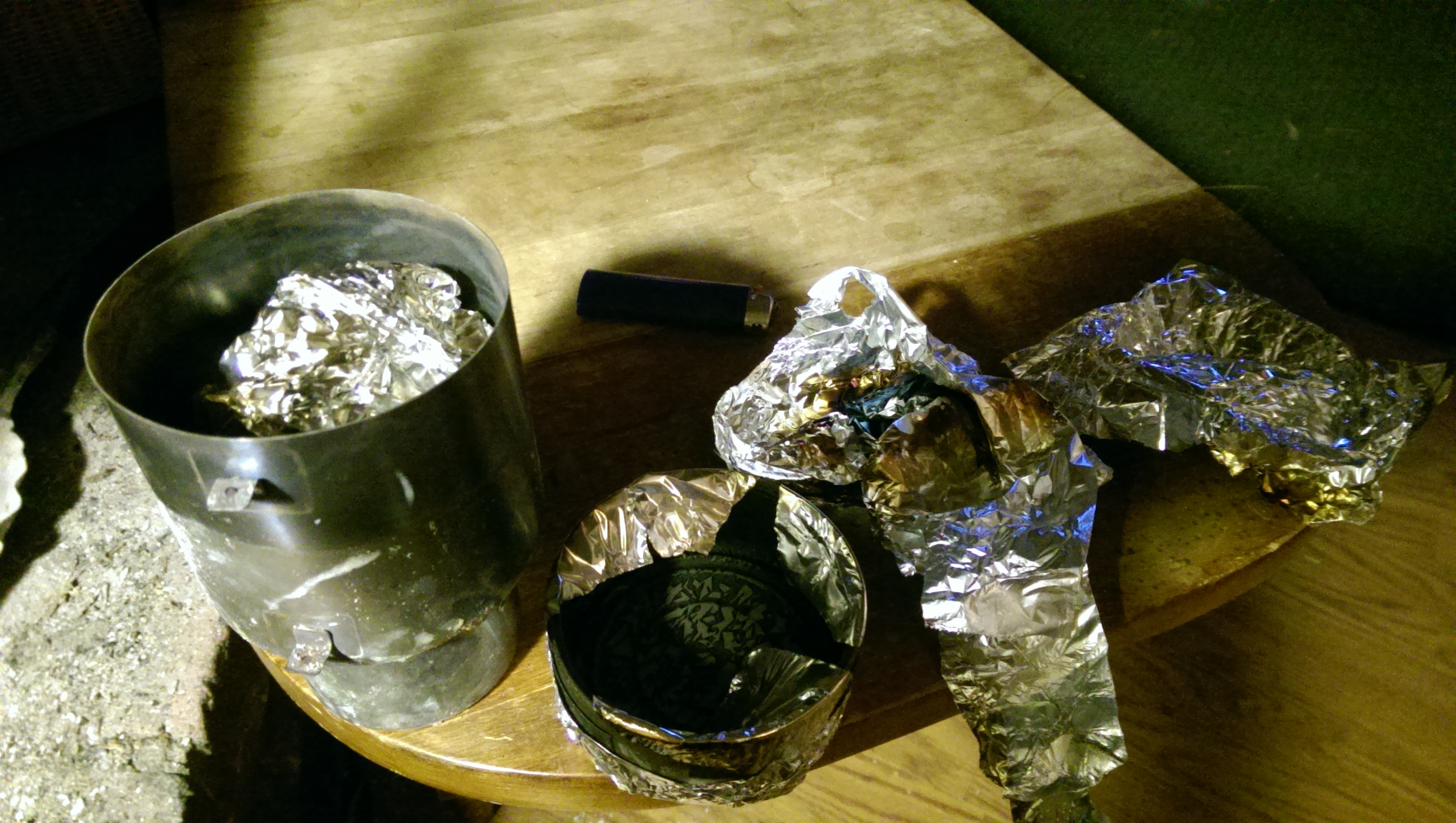

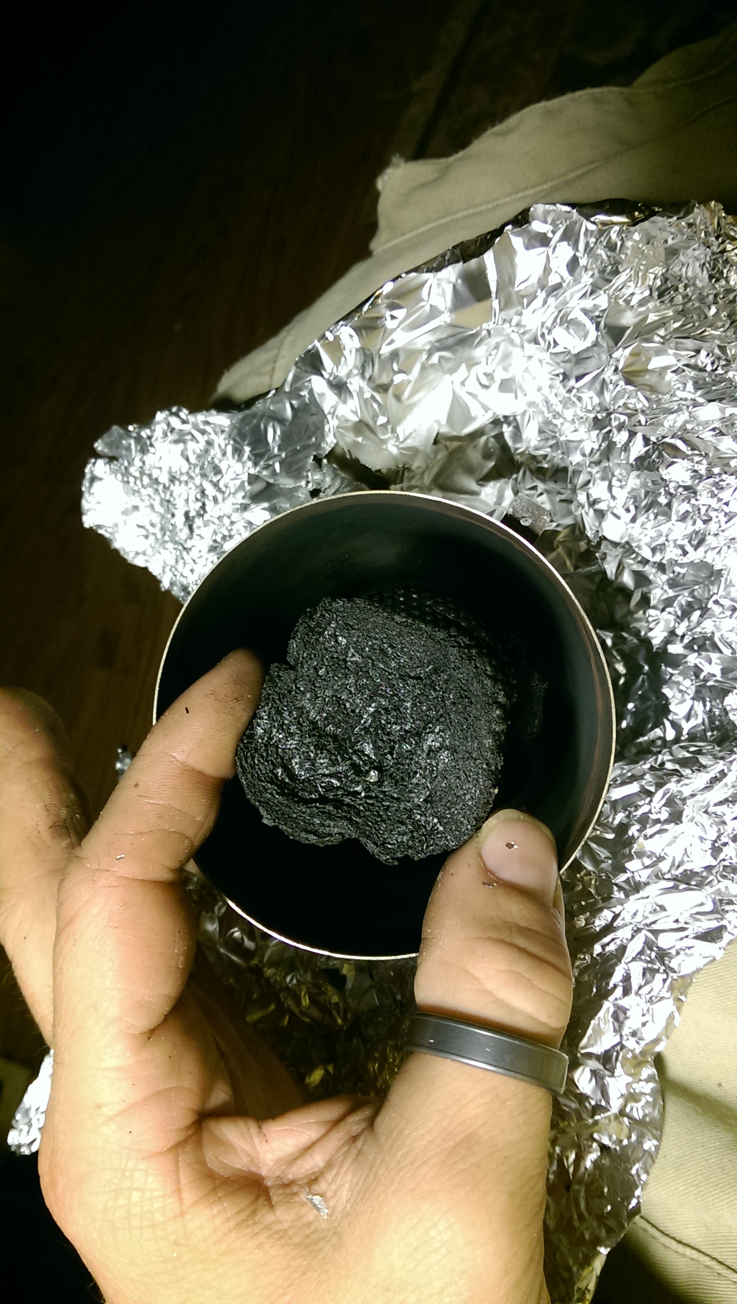

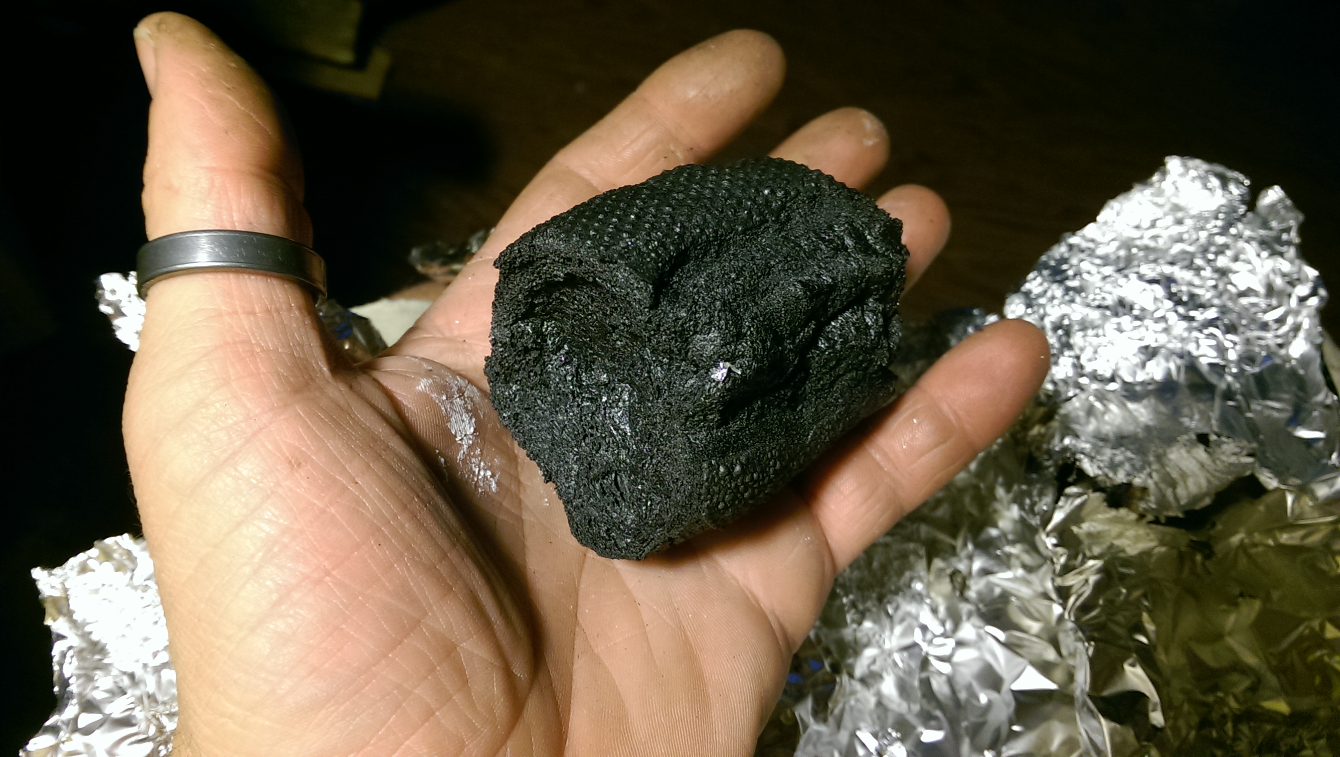

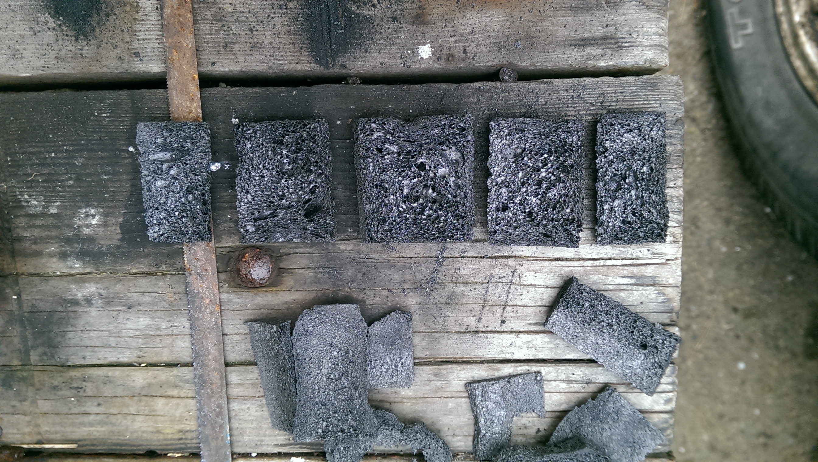

violet sin - 4-11-2016 at 23:33
Got it to work. Took more care and a few bucks, $4.50. But a plastic insert stainles steel coffee cup from the thrift store was stripped to just the stainless shell. Safeway bakery -european french bread, cut to size, wrapped in dollar store Al foil and ends twisted, put in ss cup shell, Al foil over top, aluminum cat food can( free) covering top but fits just inside the ss shell, then the top covered in a couple pieces of foil. Put in wood stove used for heating a home. 1/2 hr leaning on few coals- rotated on 15 min, another 1/2 hr in warmer parts, repeat for a total of 2.5hr with final half hour cup glowing red on one side in a the hottest part of coals.
IMAG8107.jpg - 1.2MB IMAG8109.jpg - 997kB
IMAG8133.jpg - 1.3MB IMAG8136.jpg - 1.1MB
IMAG8138.jpg - 1.1MB
It now clinks when jarred and feels sturdy. Tomorrow I'll cut it up a bit to hopefully make some test squares. Try some soak in and reheat additives to increase conductivity or something. Hate to set up Ni bath and clean it up if there isnt enough conductivity to strike something on. Well, there ya go, did some toast burning. No scale to calculate loss on charring.
aga - 5-11-2016 at 00:32
Superb !
I think that is the largest single chunk anyone has made so far.

violet sin - 5-11-2016 at 10:34
Used an old hacksaw blade to regularize it's shape, then part it out.
IMAG8139.jpg - 1.7MB IMAG8140.jpg - 1.7MB
IMAG8142.jpg - 2.1MB IMAG8143.jpg - 1.3MB
Looks nice!!! Makes me wish I could sputter metals onto the surface. The outside chunks are quite strong, resist breaking and the lot still sounds clinky when jarred together.
Wondering about second and third roasts now. Gauzing up the outside of a block with cotton balls/matting streched super thin.
