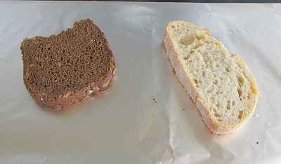

Two slices of bread (one a dense brown, the other white) were weighed at 31.75g and 32.50g respectively.

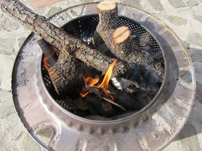

The samples were prepared (wrapped in tinfoil) and introduced into the custom-built pyrolysis apparatus (a wood fire).
fire.JPG - 85kB
The fire was left to burn for 1 hour and the bread samples were recovered and allowed to cool for 5 minutes.

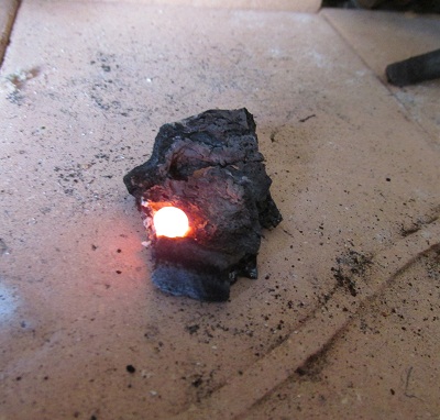

Here's a piece with some copper melted on top of the bread with an electric arc.
copper.JPG - 72kB
Neither the arc (2000+ C) nor the 1085 C copper appear to have bothered it at all.
