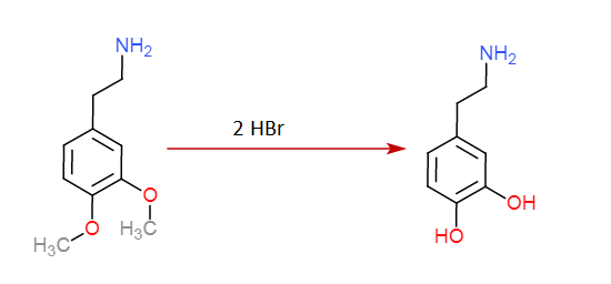

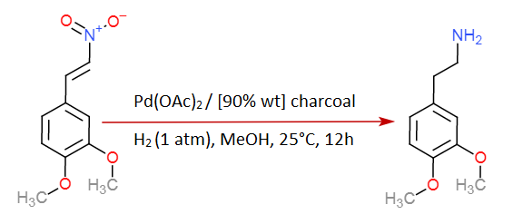

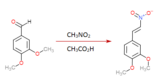

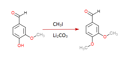

BlackDragon2712 - 6-11-2017 at 16:08
I gave it a thought once... came up with this:
Step 1:
Step 1.png - 9kB
Step 2:
Step 2.png - 10kB
Step 3:
Step 3.png - 13kB
Step 4:
Step 4.png - 7kB
Each step has its reference... I was an idiot and didn't save them but I could look them up (Not on these molecules of course but in rather similar ones)... the funny thing about this is that step 3 is a rather easy hydrogenation that can be done at practically normal room conditions, the bad side though is that palladium acetate is quite expensive... you don't need much though and is not very hard to get either.

@BlackDragon2712 For the demethylation, is there some trick or procedure, assuming you have 48% hydrobromic acid? I'm having trouble finding a good descriptive procedure.

BlackDragon2712 - 7-11-2017 at 19:42
Well... I'm going to be plain honest here, I lost all references but for step 2 and 3 a long time ago :( ... though it is by no means conclusive if it works in this case, the cleavage of methoxy group in guaiacol with HBr is described in Org Syn. here:
http://www.orgsyn.org/demo.aspx?prep=CV1P0149
... The double cleavage of a cathecol like ring is described in page 7 of this link:
https://www.thevespiary.org/library/Files_Uploaded_by_Users/...
I would expect HI to be better in cleaving alkoxy groups...
On a side poorly relevant note though, on this book it's mentioned that LiCl apparently can cleave aromatic methoxy groups on refluxing in DMF for 4-72 hours... though vaguely described it does seems interesting...
https://books.google.cl/books?id=B2BEBAAAQBAJ&pg=PA550&a...
BlackDragon2712 - 7-11-2017 at 19:49
Safer hydrogenation protocol:
http://onlinelibrary.wiley.com/doi/10.1002/chem.201001377/ab...

Melgar - 8-11-2017 at 00:03
I forgot if this has been posted or not, but this paper describes reduction of nitrostyrenes to dopamine analogs with just zinc and hydrochloric acid in methanol:
https://www.researchgate.net/publication/274084261_Chemosele...
BlackDragon2712 - 8-11-2017 at 00:34
