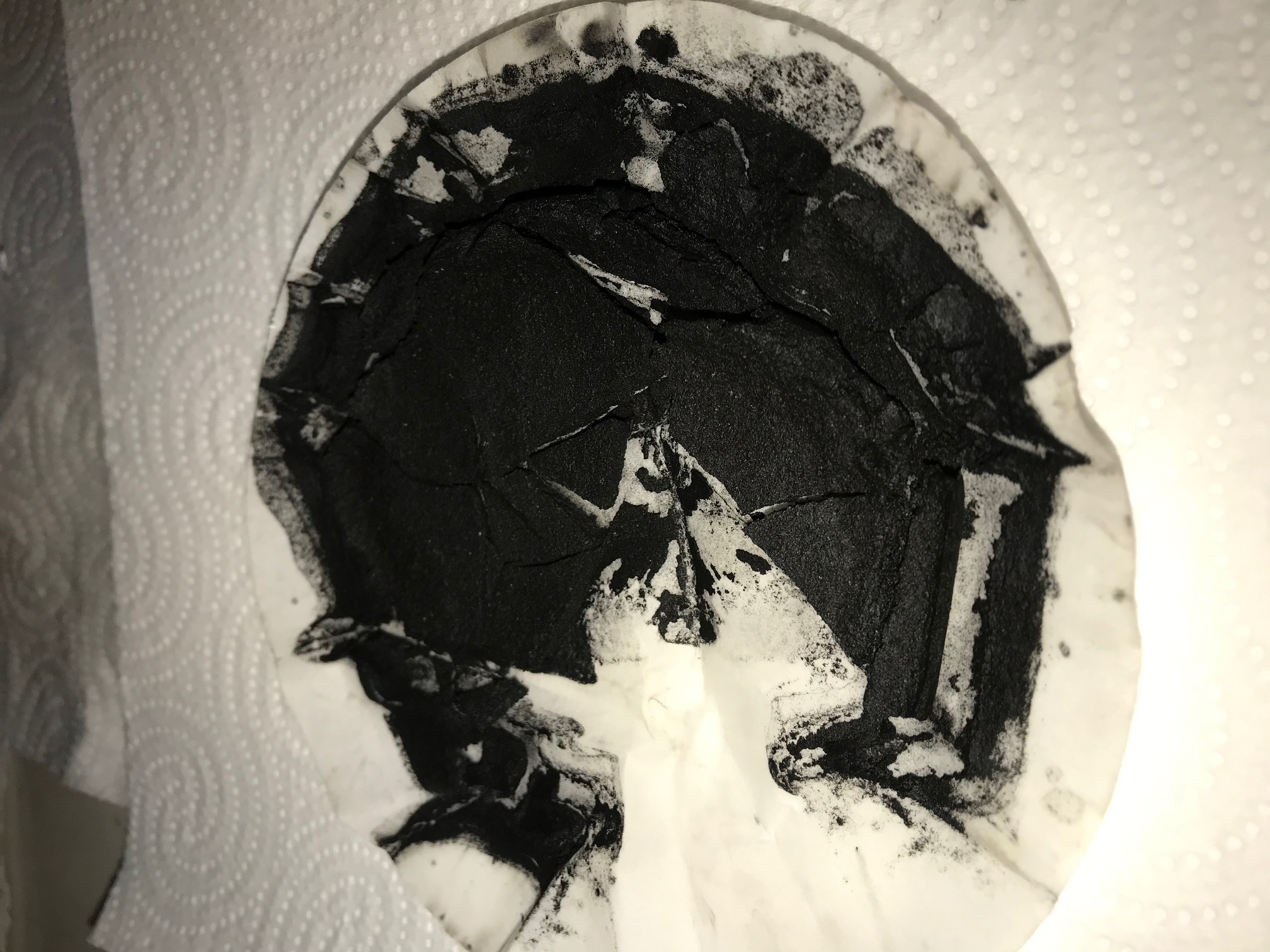

I accidently seem to have made a cobalt compound that gives a lovely dark green solution with concentrated HCl - but what is it?
The idea was to see if cobalt iodate could be made by doing a double displacement reaction between solutions of sodium iodate and cobalt acetate. This failed as far as I can see but I ended up with something interesting: a light grey powder that gives a lovely green solution with concentrated hydrochloric acid. How this happened:
- 10g NaIO3 dissolved in 100ml hot water. This NaIO3 was some 9 months old (in a clear jar) and a slightly brown, so there was probably some free iodine. It dissolved quite easy and gave a very pale brown solution.
- 6.4g (CH3COO)2Co.4H2O was dissolved in 30ml water, giving a red solution
- The cobalt acetate was slowly poured into the sodium iodate while stirring
- A maroon-purple suspension formed.
- The solution was then brought to boil while stirring. The reason I did this was to try and get a anhydrous cobalt iodate to ppt out; it is said to have low solubility at 100C.
- Close to boiling the color became more brown and it started to offgas lots of I2! See photo below.

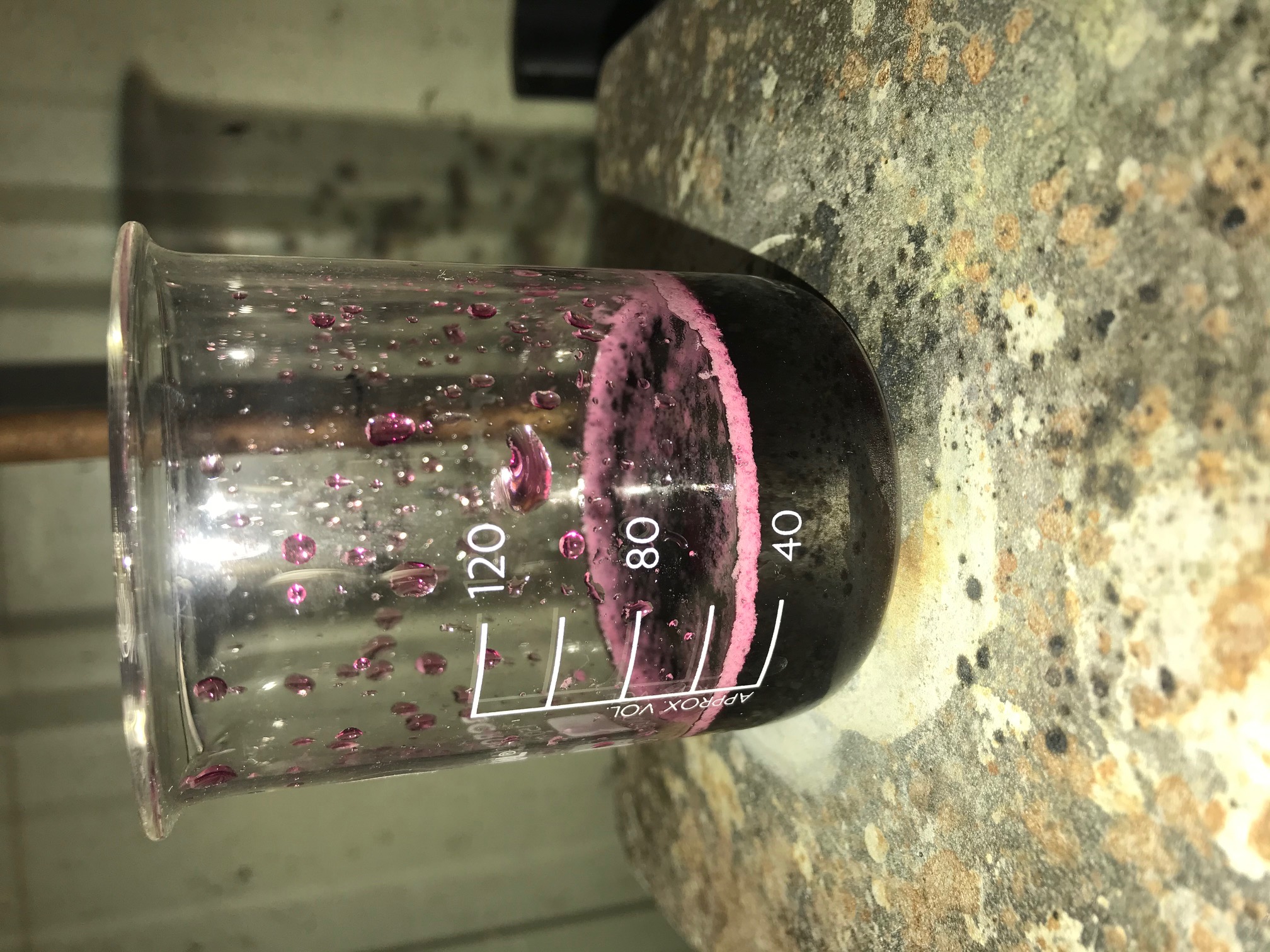

- I initially thought this may be free I2 from the NaIO3 and continued to keep it boiling. After some 10 minutes the color of the solution was a bit lighter brown but there was no sign of the I2 coming off reducing.
- There was visible suspension, so I switched off the heat and let the solution cool down slowly, and then stopped the stirring. This have a brown solution with a dark layer on top (looking like I2 in water) and a heavy grey-pale blue ppt - I say heavy because it settled out quickly.
- The supernatant solution was decanted, and the ppt washed with ethanol to dissolve remaining I2. It was then gravity filtered. In the filter, the remainder, a dark grey powder, was twice washed with acetone by which time the acetone ran through clear. See photo of the dark grey remainder below.

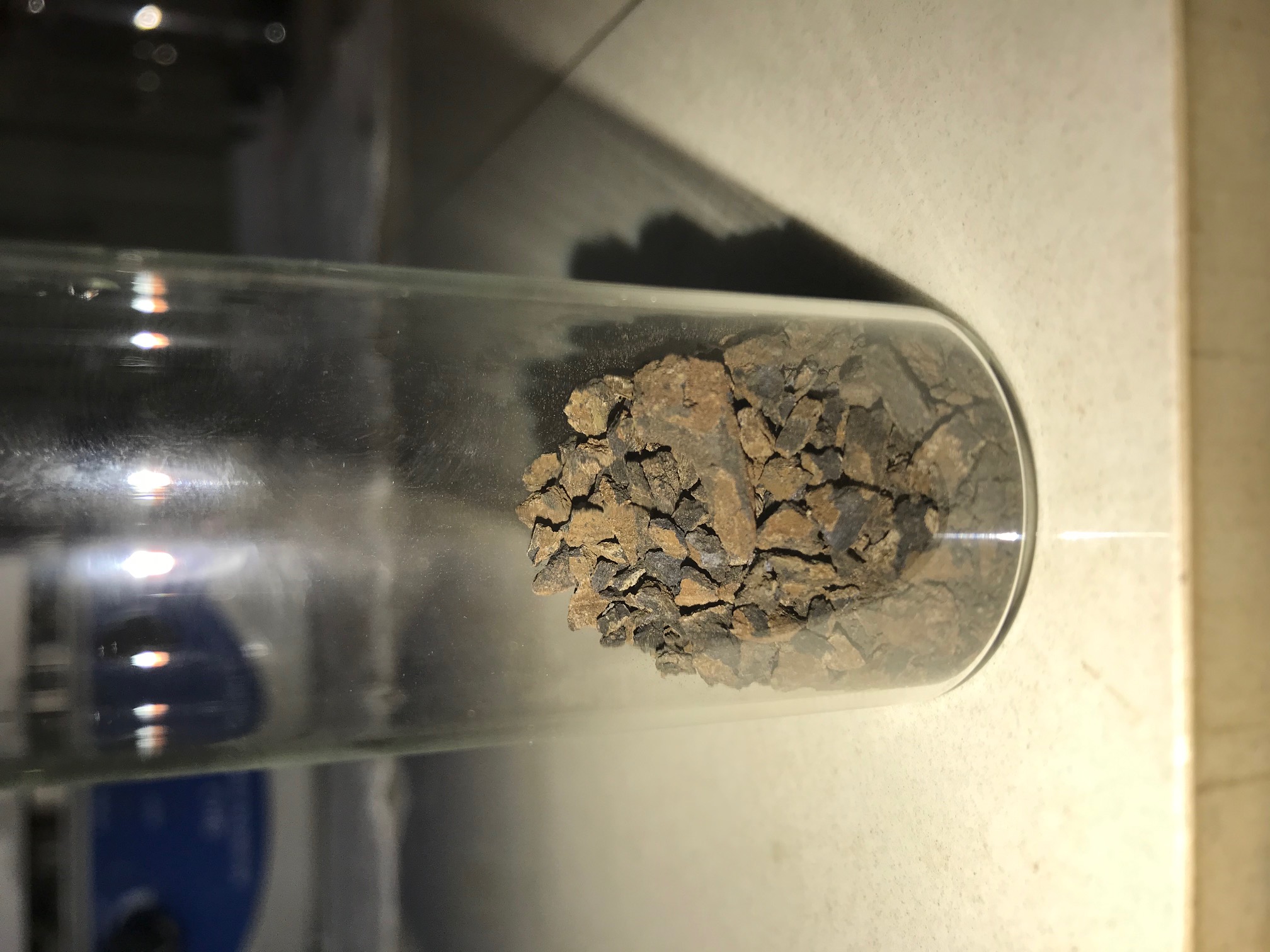

I started to clean up. The reaction beaker had a difficult to remove layer of the grey ppt on the bottom. I added a bit of concentrated HCl to see if that would dissolve it...expecting the usual blue solution of anhydrous CoCl2. The grey layer dissolved in an instant...but gave a lovely green solution! See photo.
3 HCl added to beaker to clean.jpg - 388kB

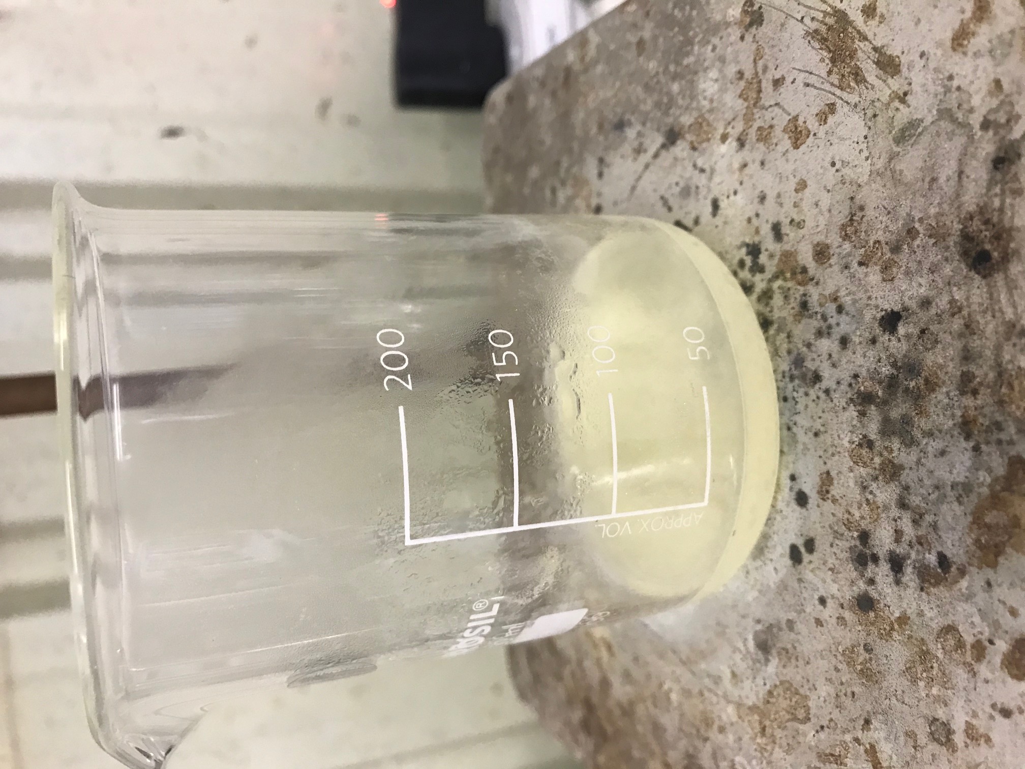

The next day the power had lightened in color and after trying for some hours in the sun under a steel dish it appeared bone dry and light grey with just a hint of blue to the naked eye. See photo. Recovery was 3.4g
4 Dry light grey powder.jpg - 483kB

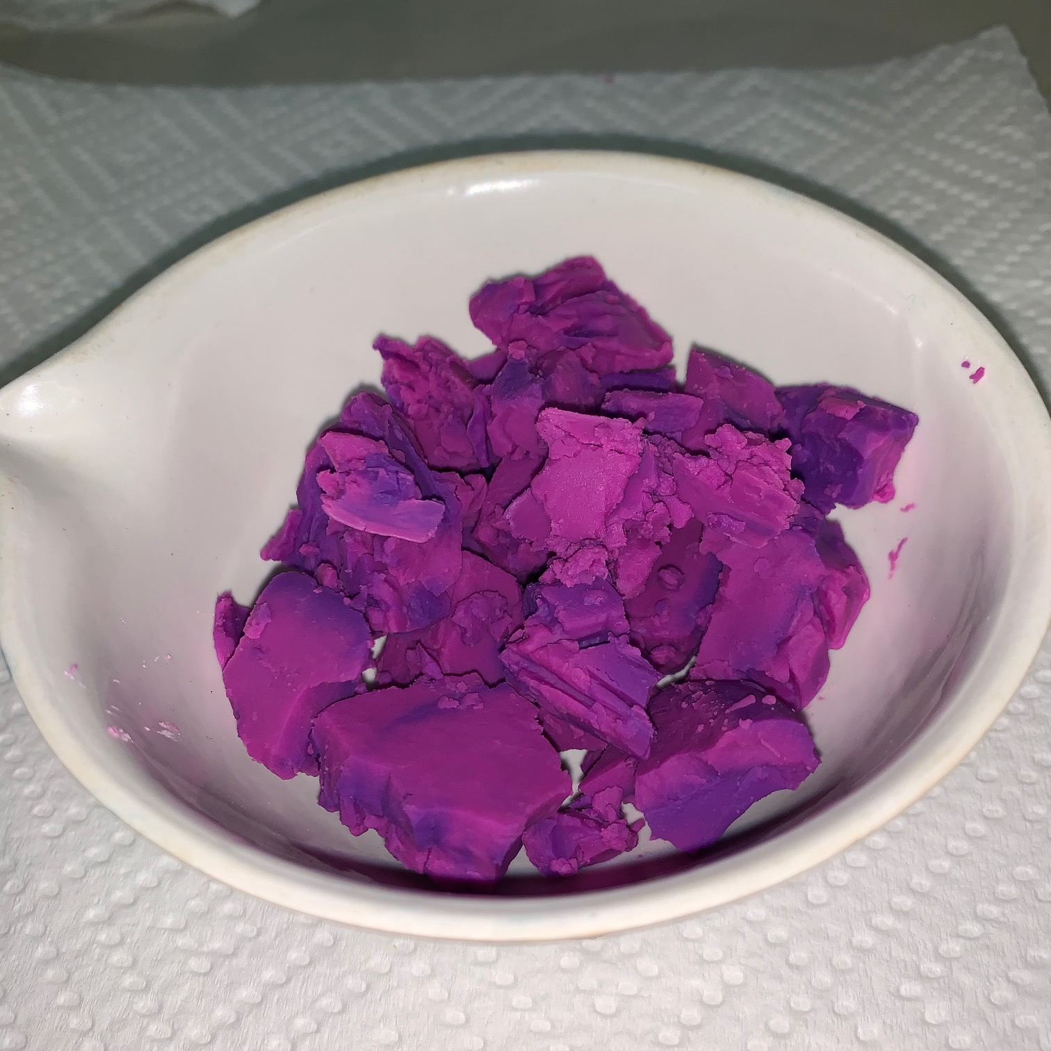

I tested the dry light grey powder with concentrated HCl, and again got a deep green solution. This time I stoppered the test tube with the green solution and put it aside to see if it remains green over time.
5 Powder with conc HCl.jpg - 466kB
What is the grey powder that gives a green solution with HCl, and what is the solution? Did I accidentally make a complex?

Lion850: Blue Co solution in conc. HCl isn't anhydrous CoCl2 but [CoCl4]2-.
Co2+ + 4Cl- <--> [CoCl4]2-
IO3- + 6HCl - - > [ICl4]- + Cl2 + 3H2O
[CoCl4]2- is blue, [ICl4]- is yellow. Blue + yellow = green.

Lion850: Grey compound must definitely contain iodate and cobalt, because of reactions which I wrote in my first post.
Here is something about CoIO3:
http://cobalt.atomistry.com/cobalt_iodate.html

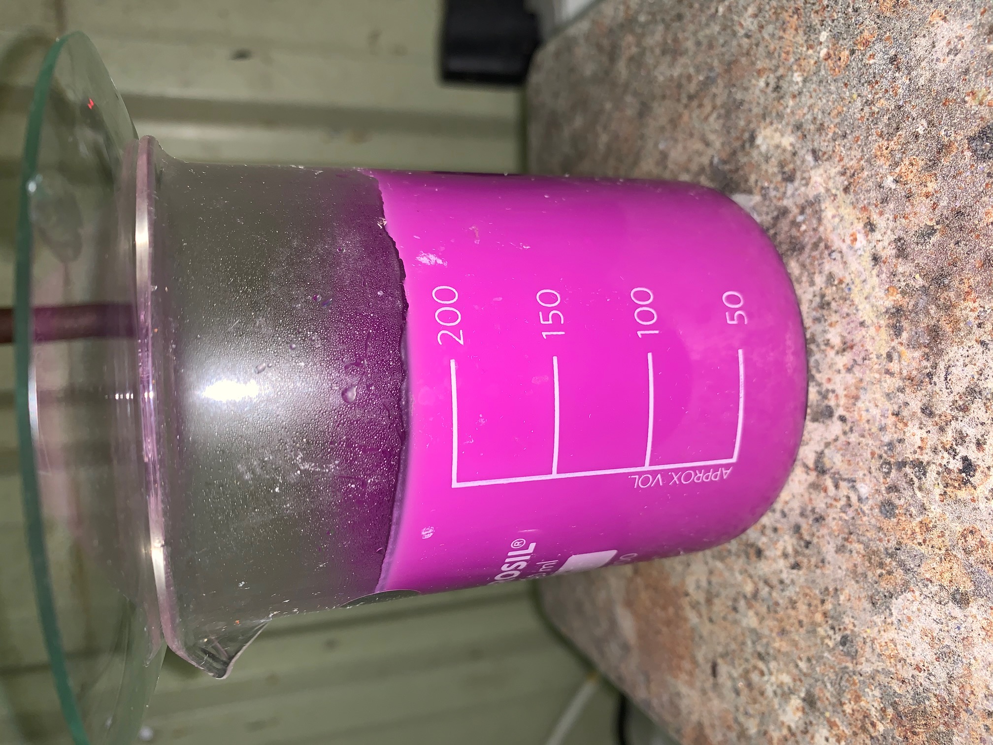

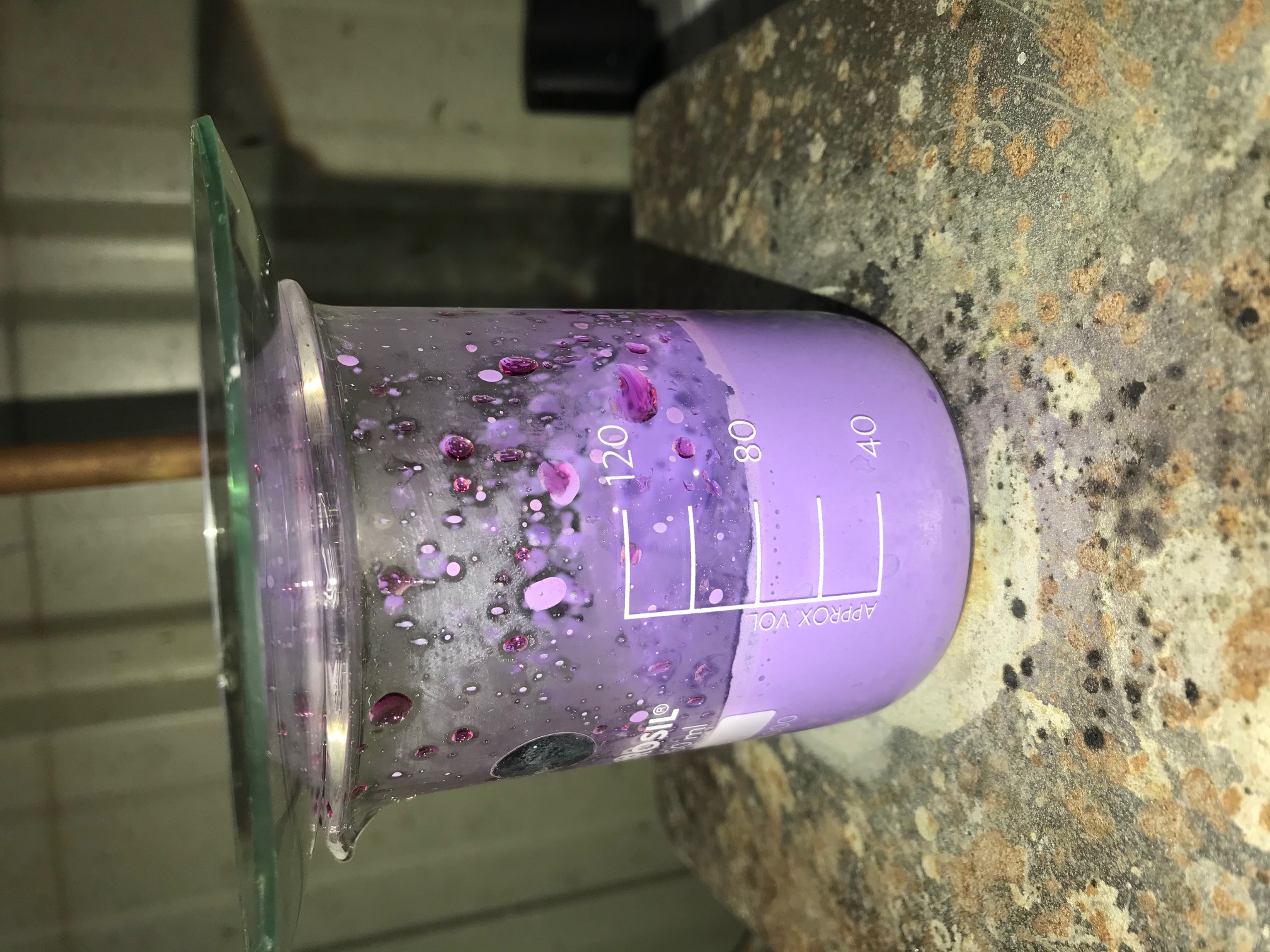

Lion850 - 17-9-2020 at 19:17

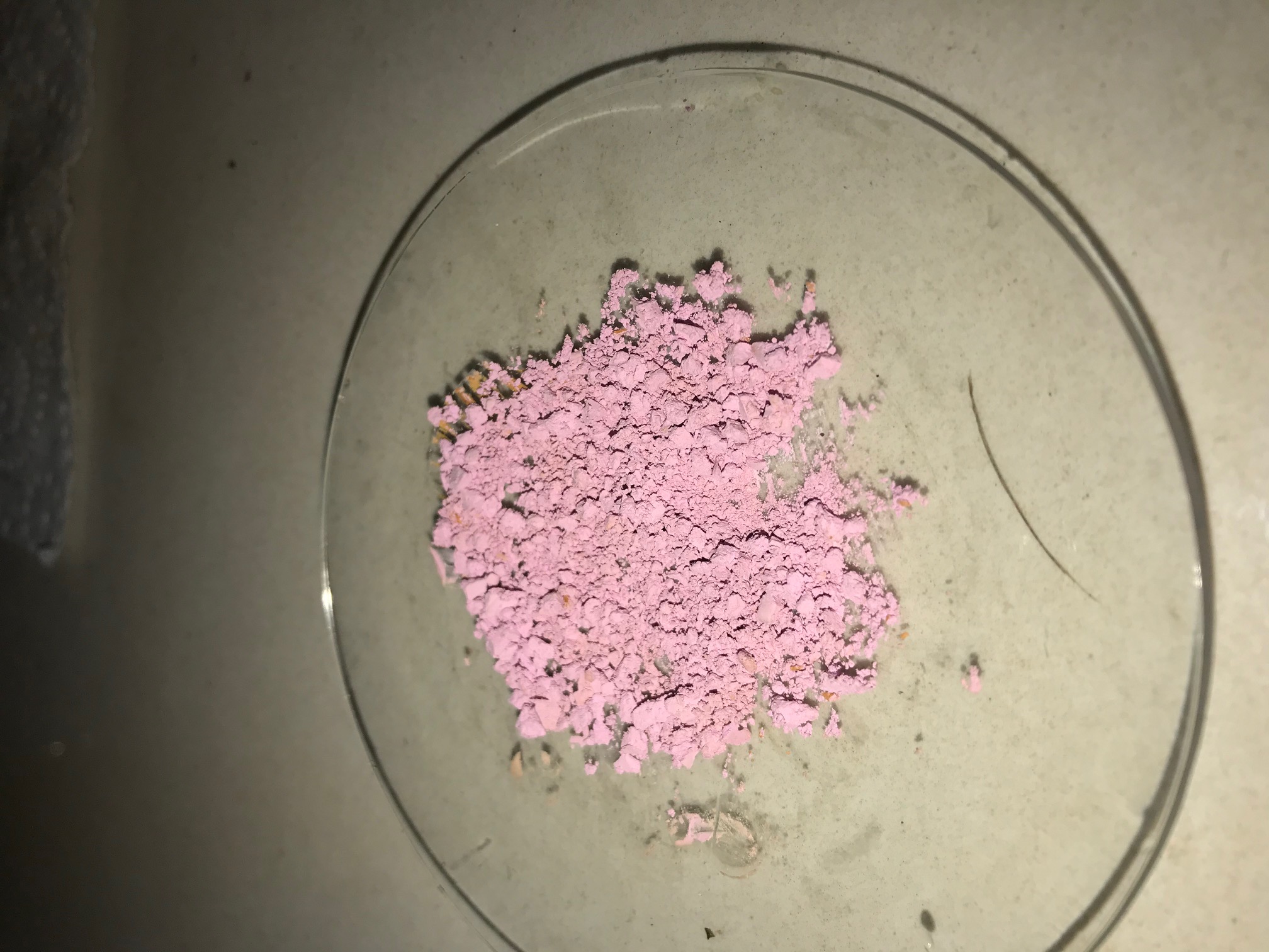

Second attempt at cobalt iodate:
I had another go at making cobalt iodate, basically trying the same double displacement reaction but at lower temperature. And I filtered the sodium iodate solution before using.
- 5g NaIO3 in 30ml water, slight heat until all dissolved into a slightly brown colored solution.
- Filter the solution which cleared it up. Some dark specs as remainder; I don't know what this contaminant is, it does not appear to be free iodine.
- Dissolve 2.2g cobalt acetate in 12ml water, giving a red solution.
- Mixed the solutions as approximately 40C while stirring. The solution went through color changes as it cooled to room temp, see photos below. No I2 gassing off this time which was good!
1.jpg - 714kB
2.jpg - 766kB
3.jpg - 821kB
- Vacuum filter, wash once with cold water in funnel, and keep sucking air through to dry it more. Color of this still moist product as below; bit of a mix of colors.
4.jpg - 553kB
- Leave out exposed to air in the shed to dry; after some 3 days (when I again remembered to look at it!) the color was as below, which to me is lavender.
5.jpg - 511kB
2.5g dry product recovered. I did 2 tests on the product which I think confirms it to be cobalt iodate:
- At high heat (on the center of the hotplate so should be around 300C) it decomposes. I2 fumes are seen and a black looking residue remains, probably a cobalt oxide.
- It dissolves readily in concentrated hydrochloric acid, releasing bubbles that smells like Cl2 gas and forming a green solution.

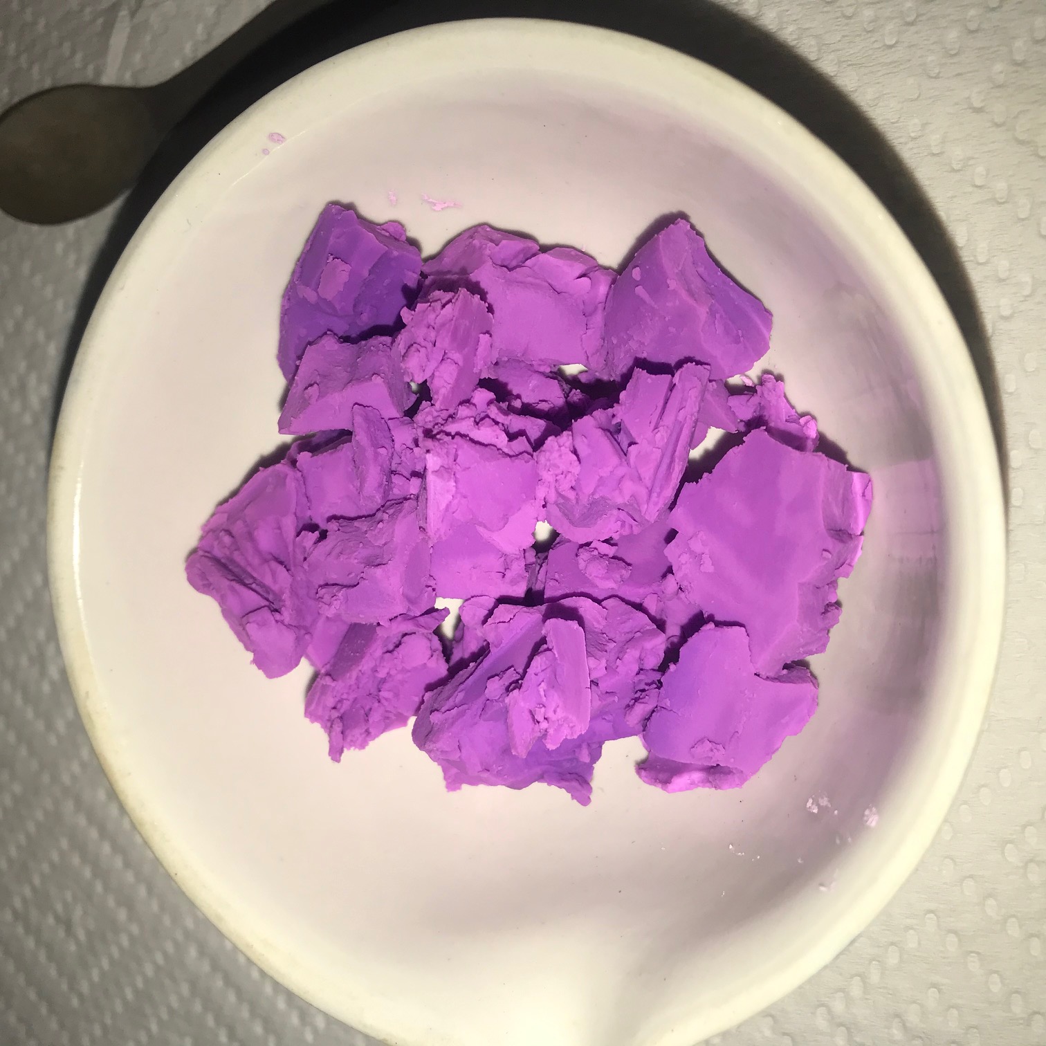

Lion850 - 18-9-2020 at 01:36
Report on making cobalt chloride CoCl2 anhydrous. My cobalt source is cobalt acetate - only because I got a reasonable quantity cheap! Seems that one advantage of using cobalt acetate is that when acetic acid is a side product this is easy to boil out of solution. Cobalt chloride was made as follows:
(CH3COO)2Co.4H2O + 2HCl = CoCl2 + 2CH3COOH + 4H2O
- 31g concentrated HCl added to a small beaker
- Slowly add cobalt acetate with stirring until a total of 30g added. This should have placed the HCl is excess.

- 11.8g of light purple of presumably cobalt tungstate recovered. Photo of final product below.
5 Dry remainder.jpg - 487kB
I searched online for the color of cobalt tungstate and various colors are mentioned, like red. However there are some photos that shows a similar color to what I achieved, for example:

Probably you are right. So, I've made probably CoCl2 * 2H2O from CoCl2 * 6H2O by this method. I didn't check the water contents, it was just an experiment to check how the alcohol acts on the hexahydrate (in some old children book I have an experiment of destroying CoCl2 * 6H2O by acetone, so I just was experimenting with this approach). Here are the photos:
CoCl2.jpg - 94kB CoCl2_6.jpg - 654kB
[Edited on 23-9-2020 by teodor]
Lion850 - 23-9-2020 at 13:51
Nice colors Teodor. I tried to make the hexahydrate but ended up with a mix of colors.

- The final solution was black and was vacuum filtered. The remainder was a dark grey / black powder which was rinsed in the funnel with lots of water.
- The still-wet remainder was tested with concentrated hydrochloric acid. It very quickly dissolved with some bubbling into a light blue solution, which turned maroon-ish when water was added. All the powder dissolved with nothing left over. So it seems it was mostly cobalt powder.
** I later saw that a very small amount of black ppt settled out of the filtrate once it cooled, and this black ppt did not seem to react with HCl. I don’t know if this was maybe a boron compound.

- After some 24 hours there was a dark red-ish mass in the desiccator. Photo below.
3 Filtrate in desiccator.jpg - 378kB
- But when I looked again a few hours later it turned black/very dark green! Photo below.
4 Final color in desiccator.jpg - 308kB

As a side note, the cobalt remainder that was left when the iodine solution was filtered off has been exposed to air for some days now and is turning olive green, see below. I don’t know which compound is forming?
9 Leftover cobalt.jpg - 508kB

Lion850 - 2-1-2021 at 02:34
Cobalt gluconate.
- 10g calcium gluconate was dissolved in 100g water. Once near boiling the salt completely dissolved giving a clear solution.
- 6.6g cobalt sulphate heptahydrate was dissolved in 30g water, this gave a dark red solution.
- The hot cobalt sulphate solution was added to the hot calcium gluconate solution, and stirred for 40 minutes while keeping it very hot.
- Stirring was stopped and a heavy white ppt quickly settled, presumably calcium sulphate. The solution was then filtered and a wine-red remainder obtained.
1.jpg - 307kB
- The beaker with the remainder was placed in a bigger beaker of boiling water. After some hours all that was left was a sticky maroon coloured layer.
** The last time I tried this experiment, a month or so ago, I obtained the same sticky stuff. I then put it on a sand bath at around 200C but it decomposed into a mess. So I know to try something different.
- Add 150ml methanol to the beaker and boil, topping up with methanol from time to time. This worked recently when I made copper gluconate, but it had little effect on the cobalt: it remained a sticky blob.
- I then added xylene to get a higher boiling temperature. After boiling for 30 minutes or so it became a swollen mass!. Photo below.
2.jpg - 635kB
- This mass was no longer sticky. I broke it into smaller pieces so the stirring could work, and stirred it for another 10 minutes or so in near-boiling xylene. The result was a coarse powder.
- Most of the xylene was decanted off, and the rest filtered off. The remainder was a coarse powder, still wet with xylene as shown below.
3.jpg - 622kB
- The product was then dried on a steam bath. The xylene evaporated quickly, after 1 hour the weight was steady.
- Final recovery was spot on 10g of a dry free-flowing powder. Colour is probably maroon, anyway a somewhere between red-pink and purple.
4.jpg - 636kB
10g represents a yield percentage of 95 which is almost to good to be true. This powder is very fluffy; it occupies a larger volume when one considers the weight is only 10g.
Cleaning the beaker with concentrated HCl immediately have the lovely blue colour of cobalt chloride.
Anhydrous CoCl2
teodor - 11-7-2021 at 14:09
Today I prepared anhydrous CoCl2 by reaction of cobalt acetate 4 hydrate with acetyl chloride in benzene. The procedure is from Brauer, p. 1515.
Co(AcO)2 * 4H2O + 6 AcCl = CoCl2 + 2 Ac2O + 4AcOH + 4HCl
I didn't notice the evolution of HCl, probably it was fully absorbed by the liquid.
The colour change sequence during this reaction is very beautiful, unfortunately I've made a photo only of the start and finish state.
CoCl2_1.jpg - 171kB CoCl2_2.jpg - 160kB
Some notes about preparation of the cobalt acetate 4 hydrate powder. I made it by a reaction of cobalt carbonate and acetic acid, but crystallisation without seed crystals is a challenge. I've got the seed crystals by evaporating water solution with acetic acid to the syrupy state and adding ethanol to this.
I did 2 washing of Co(AcO)2 * 4H2O - first with water, and after that the mass became very dense and second with ethanol which converts crystals to a very fine and diffuse uniform powder.
[Edited on 11-7-2021 by teodor]
teodor - 14-7-2021 at 02:04
It's amazing how fast wet anhydrous CoCl2 turns pink on contact with the air. When I opened the flask the compound which was adhered to the stop changed it colour in few seconds. The only way to keep it anhydrous on contact with the air is to keep some quantity of AcCl in the solution.
I tried to pipette out the solution through cotton wool but its not easy. I think to order an immersion filter.
Also I did interesting experiment adding ether into the flask. The ether dissolves CoCl2 forming very nice blue anhydrous solution.
[Edited on 14-7-2021 by teodor]
