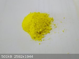

4-propoxy-3,5-dimethoxy-beta-nitrostyren
To obtain nitrostyrene, cyclohexylamine was chosen as a catalyst and a mixture of IPA and acetic acid as a solvent. These reaction conditions allow obtaining pure nitrostyrene in good yields.
Mix 4.3 gr 4-propoxy-35dimethoxy-benzaldehyde in 20 ml IPA , mix 1.5 gr cyclohehylamine in 10 ml acetic acid and add to IPA solution of aldehyde . Add nitromethane 3.5 ml stirred and heated at 70…75 3 hours . The mixture is poured into 30 ml of H2O, and the nitrostyrene solution crystallizes in the refrigerator within an hour. After filtering and washing with cold water twice 50 ml -3.6 g of bright yellow crystals are obtained. Recrystallization from 20 ml of IPA and 6 hours in the refrigerator yielded 3.4 g of nitrotyrene (65%).

4-propoxy-35dimethoxy-BA
IMG_20260116_094054.jpg - 501kB
4-propoxy-35dimethoxy-betanitrostyren

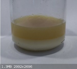

Two methods for synthesizing proscaline have been described in the literature. The first was by the Czech chemist Leminger in 1972, followed by Shulgin and Nichols in 1977 using a nitrile. It was interesting to follow Leminger's route, obtaining syringaldehyde, then 4-propoxy-3,5-dimethoxy-aldehyde, and 4-propoxy-3,5-dimethoxy-beta-nitrostyrene. The aldehyde was obtained in DMSO in good yield and isolated as a white crystalline compound using the method of Trachsel (2002). Nitrostyrene was obtained by cyclohexylamine-catalyzed condensation in IPA-acetylic acid, yielding a pure, bright yellow crystalline product with a 65% yield. To obtain the amine, the method chosen was reduction with sodium borohydride and CuCl2, which I will describe below.
Reduction
3.2 g NaBH4 (0.087 M) was added to the IPA-H2O mixture (26 ml and 14 ml) with stirring, then, after dissolution, 3.14 g (0.0117 M) nitrostyrene was added in small portions. The flask was placed in a water bath at 20 degrees, and the temperature of the reaction mixture did not exceed 30 degrees. Each portion discolored fairly quickly, and the entire addition took 10 minutes (Note 1). Next, a solution of CuCl2 in water (0.7 ml of a 2 M solution) 0.18gr CuCl2 was added in a thin stream, causing the mixture to darken. The reaction mixture was heated to 80 degrees, and refluxing was continued for 30 minutes. Afterwards, the mixture was cooled to room temperature.
Note1
Initially, the reaction was run longer, for about 30 minutes before adding CuCl2 and 40-50 minutes of reflux at 80°C, but the yields were much lower. The original article (lit1) describes a reaction time of 10-30 minutes, after which a dimer and other byproducts form. Therefore, the first part of the reaction was completed in 10 minutes; copper chloride solution was added and refluxed for 30 minutes, after which the reaction stoped.

IMG_202601.jpg - 2.1MB
first part - lose color
IMG_202602.jpg - 2.2MB
second part - refluxing
IMG_202603.jpg - 1.3MB
hydrofumarate presipitation
Workup
The reaction mixture is poured into a 150 ml beaker and the flask is rinsed with 10 ml of IPA. The layers are immediately separated, with the IPA-amine layer on top and the aqueous layer below. 25 ml (7 g NaOH + 20 ml H2O) are added. The upper layer is carefully separated to avoid dark copper flakes. The aqueous layer is then extracted with two 15 ml portions of IPA. A saturated solution of K2CCO3 (18 g + 20 ml H2O) is prepared. The IPA solution is shaken twice with 10 ml of K2CO3, then dried with MgSO4. The result is approximately 55 ml of a clear, slightly yellowish solution of amine in IPA. The alcohol is evaporated, and the resulting solution is dissolved in 10 ml of acetone. A solution of 0.8-0.9 gr fumarik acid is prepared in hot acetone and added to the amine solution until pH = 6. White crystals of hydrogen fumarate immediately precipitate; after washing with acetone and drying, 2.75 g (0.0077 M) was obtained.

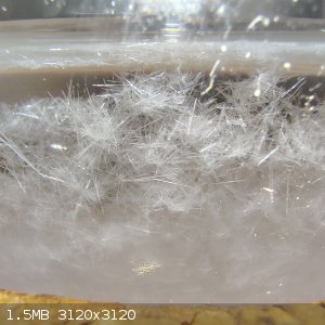

Good job, it is an interesting class of compounds. The 4-cyclopropylmethoxy derivative made some stunning crystals as the hydrochloride, see attached picture. If you want to go for the secondary analogues, say the 4-isopropoxy isomer, time for the alkylation is significantly longer and monitoring via TLC to replenish the 2-bromopropane may be helpful.
Two questions: I assume you used anhydrous CuCl2 for the reaction, was this reagent purchased or prepared? If prepared, how? I preferred making CuBr or CuI as it is easier to get anhydrous starting from hydrated Cu(II) salts. Additionally, did you ever TLC the syringaldehyde? I attempted methoxylation of 5-bromobourbonal some time ago in a botched attempt (conditions not kept entirely anhydrous) and ended up with a complex mixture of starting material, bourbonal (which was not present in the precursor, so must have dehalogenated) and what I assume to be the product 5-methoxybourbonal. Did you TLC your syringaldehyde to ensure homogenous product?
PS: Depending on the substrate, higher catalyst loading and NaBH4 can be beneficial in the NaBH4/Cu. It seems like molecular oxygen coming into contact with the Cu particles can be particularly detrimental, even up to the filtering step. Excess NaBH4 and inert atmosphere can be helpful. Some substrates seem to benefit from significantly longer reflux periods than outlined in the publication, but it is probably best to keep the reaction under inert gas then. Against the findings of the publication, depending on substrate and exact conditions, partial to full dehalogenation of brominated substrates has been observed by various connoisseurs of nitrostyrene reduction.
