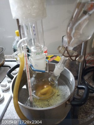

all together before starting stirring, 1-nitronaphthalene still undissolved

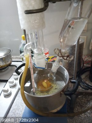

stirring, 1-nitronaphthalene dissolved, hydroxylamine hydrochloride mostly undissolved, the solution still relatively clear

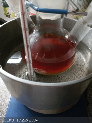

product forming with red color, stirring continued, for seeing the color the stirring temporarily interrupted just to make a photo

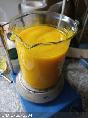

after pouring into stirring 700 ml of ice+water in large beaker

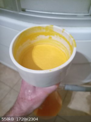

vacuum filtration on Buchner funnel

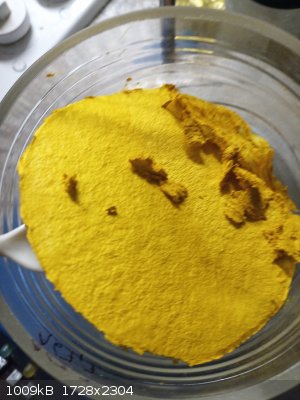

filter paper with product transferred outside of Buchner funnel and let to dry
IMG_20260308_223656_8.jpg - 1012kB IMG_20260308_223704_0.jpg - 1009kB
dry product easily separates from filter paper in a form of a sheet
IMG_20260309_172139_3.jpg - 1.2MB

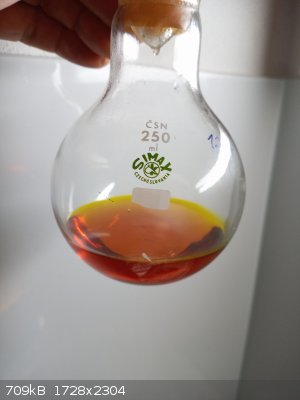

recrystallization from ethanol on wood stove to boil some ethanol and heat the funnel by ethanol vapor to prevent premature crystallization in filtration apparatus at this small scale, very little of something dark filtered out (very likely some oxidation product of amine??? because active charcoal was NOT used), filtrate crystal clear
