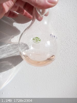

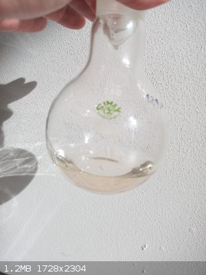

In 250 ml FBF (100 ml should be enough) in ice cold water bath was mixed 0,40 g anhydrous LiCl, 8 ml 35% HCl (LiCl fully dissolved), 0,80 ml 70% HClO4 (to make 1,0 g LiClO4 in situ). Then 15 ml 95% ethanol (free of butanone) was added. Then 7 ml furan (0,1 mol) and 15 ml acetone (0,2 mol) was added while mixing. Clear colorless homogenous reaction mixture obtained. Flask stoppered and put aside. After 10 minutes pinkish coloration, after 20 minutes more pink color. After 4 hours already some crystalline product (small amount). The mixture will be let to react undisturbed at room temperature for 2 weeks.
LiClO4 is one of the best soluble from all Li salt in organic polar solvents. The Li cation facilitates 4 furan member ring cyclization. The reaction runs without Li cation too, just much slower and very likely also 5 and 6 furan member molecules are produced.

after 10 minutes pinkish color

after 20 minutes pink color

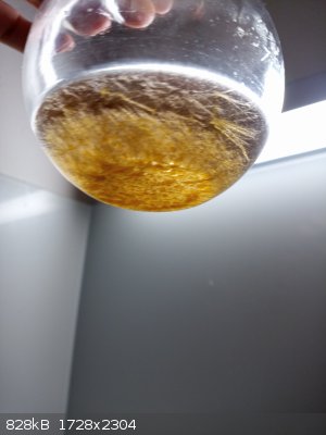

after 4 hours already some product, the reaction is very slow and facilitated by Li cation which has a template effect to create 4 furan ring crown molecule, the reaction will be sit at room temperature for 2 weeks further

Hello, after 1 day the mass in flask was already quite thick, yellow-green colored.

If using bigger cation, maybe Ag+, NH4+, Cs+, Rb+ maybe 5 or 6 membered ring will be formed? This is a template reaction so the molecule binds around the cation, the bigger cation the bigger macromolecule. Li facilitates 4 membered ring formation. But the reaction slowly proceeds even without any cation. If you have only 4 days time then certainly use a cation. If you have 2 weeks time then if you do not have any cation you may try it that way. I do not know whether LiCl instead of LiClO4 will dissolve, if not fully maybe at least partially will dissolve?
