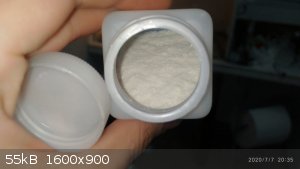

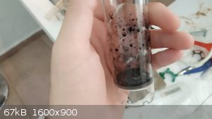

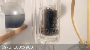

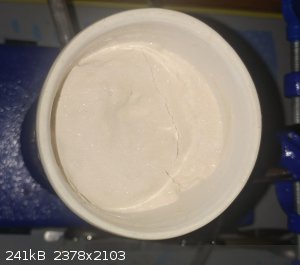

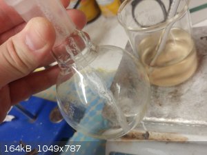

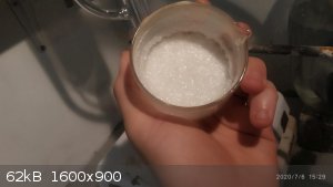

pictures & descriptions:
beginning: a brown powder(somewhat sticky)
a bit after the beginning:
end:
extracted product(after recryst with methanol):
slower evaporation of the methanol:

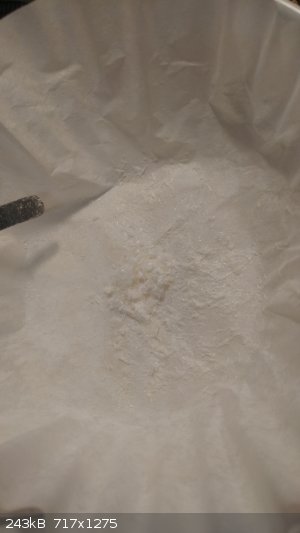

I was doing another anthranilic acid synthesis today, getting enough so that I can get enough to put in my soxhlet extractor whenever I get the time
to try this out, and after I dropped the pH to 3.5 and the AA precipitated out, I couldn't believe the color, it was the best color I've gotten thus
far! Just a very light beige (I think I could get by calling it "off white" even).
I was thinking that maybe I wouldn't have to do the soxhlet extraction using heptane... Instead, I could just give it a quick recryst with some
boiling water...
This stuff is so damn touchy How the hell does it get darker in the recryst??
Looks like I'll be trying this out after all. I might even skip the recryst on some of the runs and go right to the soxhlet trick detailed above.
P.S. Here's the other pictures I took, if anyones curious. And some other photos of the previous synthesis runs.
[Edited on 12-2-2021 by SuperOxide]

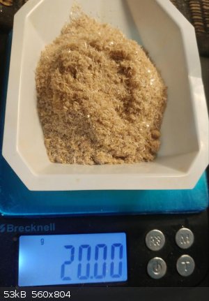

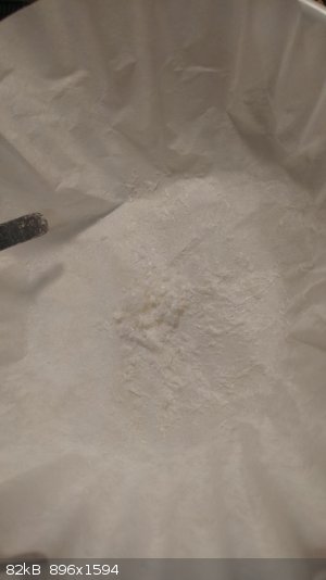

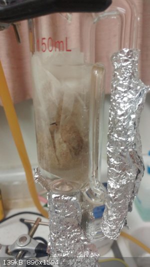

Procedure
I added 20g of anthranilic acid (which was made via the Hofmann rearrangement of phthalimide, then recrystallized in boiling H2O) to my
150mL soxhlet extractor, added the heptanes (extracted from Super Tech Starting Fluid, which distilled over at 91 °C - 93 °C, suggesting it's not n-heptane) and cranked up the temperature. I ran it for a
little over 12 hours. I timed how long it took to cycle in the soxhlet extractor, and it was aprox 7 min and 20 sec, so that means it cycled
approximately 100 times (give or take a couple considering as the anthranilic acid got extracted, there was more room for solvent in the soxhlet
apparatus and less room for it in the flask)
20g of recrystallized anthranilic acid
Acid placed in the soxhlet extractor (in a coffee filter to prevent clogging, which was a problem
before)

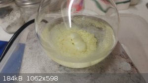

At the end of the 12 hours, there was a yellow solid that was forming in the boiling flask, which was sticking to the stir bar pretty strongly.
The light yellow solid that precipitated out and clung to the stir bar
Flask with yellow solid from a different angle (notice there seems to be quite a bit on the sides)
I took the remaining anthranilic acid out of the soxhlet apparatus, dried it and weighed it at 15.69g - meaning only 4.31g was extracted over 12
hours. Thats about 0.359g extracted every hour. Even if one were to assume that the extracted solid was pure enough to use (which it seems to need a
recryst, so not likely), this is still a pitiful yield. Obviously this means the soxhlet is absolutely required if you want to use this route.

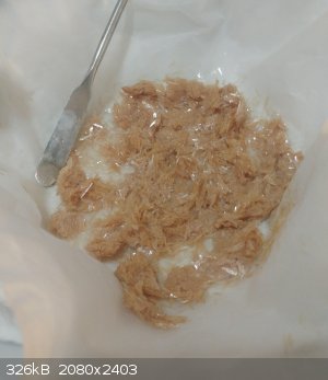

From here I kinda messed up a bit. I decided to just filter off the yellow solid and do a recryst with water, which was a bad idea. The crystals were
also yellow, as opposed to white (or slightly off white) that I expected to see from my previous smaller scale shorter run (also mentioned in a
previous post above).
Recrystallizing the yellow anthranilic acid in boiling H2O seems to yield long needle like crystals,
still light yellow in color
Filtered off (still slightly wet, but they looked the same when dried)
I did another recryst with MeOH which seems to have cleaned it up a bit more (though it's still in solution), but not as colorless as I was hoping.
Crystals of anthranilic acid starting to form in the MeOH as it cools
Same flask, but you can see some of the color seems to come off when the flask is tilted on its side and the
solvent is allowed to settle to the side (gives me hope it may clean up once filtered and dtried)
If anyones interested, I may post some photos of the filtered/dried crystals if they're any lighter in color.
This doesn't mean that a white solid can't be attained, since on a smaller scale, I added MeOH directly to the heptane/anthranilic acid mixture, then
heated it up with strong stirring and this yielded perfectly white crystals:
Crystals NOT from this run, just used as a comparison.
The fact that I was just messing up the recryst seems to be evident in that whenever I dissolve the anthranilic acid in MeOH, then pour it into a
different container after heating it up, the dribble that runs down the outside always turns out pure white!
So basically I messed up the recryst on this longer run by not just adding the MeOH directly to the heptane/anthranilic acid solution. Somehow that
yielded a much cleaner product - Perhaps the recryst from boiling H2O caused some oxidation due to the higher temperature? Not
sure about that.
Two things I may try next before running away with my tail between my legs:
Running the soxhlet extraction using hexane instead of heptane - Will this be better? I have no idea. But the boiling point is
much lower than heptane (69 °C instead of ~93 °C). Perhaps lower BP = more cycles = more extraction? no idea.
Try a multi-solvent recryst (of the brown crystals right from the Hofmann rearrangement of phthalimide) with heptane and diethyl
ether - Anthranilic acid is basically insoluble in heptanes, but very soluble in ether, so I'm just curious what will happen if I dissolve it
in some ether and crash it out with heptane.
Question for B.D.E: How long did you let the soxhlet extractor run? What was your yield? How long was your vacation you took in the
interim? (I'm assuming a month).
[Edited on 19-4-2021 by SuperOxide]

Quote: Originally posted by draculic acid69  | | Water seems to be a no go for this substance. Going off everyone's before and after pictures water seems to make the stuff worse not better.
Yep... I'm now convinced of that, 100%. I wish I could go back in time and slap myself before I made the stupid decision to use water (I tried to wash
the product with ice cold water, since it's much less soluble in ice cold water - still didn't work well). That's 12 hours, wasted, lol.
I may actually just try the whole synthesis again, and instead of using water when I recryst the crude product, I may use MeOH. The crude product in
my experience is almost white:
But when I use boiling water for the recryst, this is the same product:
So yeah, lets see if it keeps its color using MeOH as the solvent, keeping water out of it entirely.
