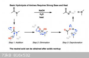

Yeah it isn't hydrolysis, but then again, many reactions are called "hydrolysis" even though the main reaction taking place doesn't involve water.
For instance the "hydrolysis" of an ester, or an acyl halide, with dilute NaOH.
The hydroxide ion is so much more nucleophilic than water, so the water will hardly participate at all, but it is convenient to call it hydrolysis.
The DEET reaction, however , can be more accurately called alkaline decomposition :D
@tsjerk I think the reaction mechanism involves nucleophilic attack on the amide carbonyl, resulting in an amide anion as a leaving group.
The amide anion is a stronger nucleophile than hydroxide, so the reaction requires forcing conditions such as an excess of alkali, or distillation to remove the amine...
I hope I'm right, I spent long enough working on this reaction!
Posts: 3040
[*] posted on 15-5-2023 at 05:05
Hydrolysis can occur without water, sodium hydroxide dissolved in some other solvent will do the trick just fine. Hydroxide is just deprotonated water.
hydrolysis.png - 73kB
https://www.masterorganicchemistry.com/2019/10/07/amide-hydr...
