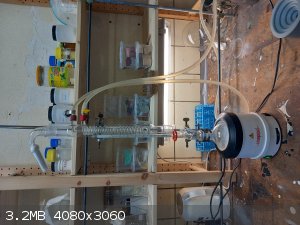

20250318_171824.jpg - 3.2MB
If you ever thinking how I can get the amount of water adsorbed - easily, by the acid boiling point drop.

20250322_134426.jpg - 2.7MB
The weight of the empty "pralinevormpje" is 0.529g and together with (NaPO3)n (bought from labshop.nl) is 60.645g.
Let's check the mass change in few days.
