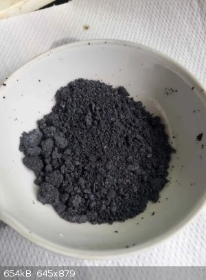

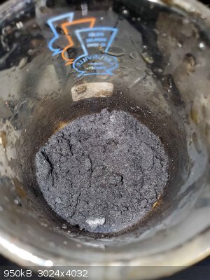

-After most of the vapors faded away the setup was disassembled and the remaining fumes were sucked away. The dry black solid was rapidly scrapped off the rbf walls and was poured into a frit funnel to prepare for washings and vacuum filtration.
-At this step water can be added to both the filtered solid, and remaining product stuck to the rbf walls. However be aware that it will neutralise the remaining AlCl3 and produced a lot of smoke. Surprisingly, water actually worked quite well with a little scrapping to remove all the crystals. The dark cristalline product was then filtered under vacuum and washed with 30ml of water, before letting it dry on the pump.
-Finally the black powder was scrapped and weighted, giving a mass of 35g (88% of theorical yeild) wich is actually better than the 60% reported by litterature
