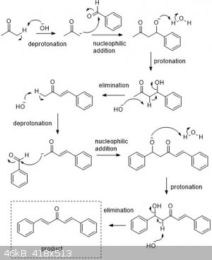

The crossed-aldol reaction on aromatic aldehydes proceeds as here
crossed aldol mechanism.jpg - 46kB

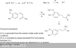

Attempted novel reduction
dehydrozingerone reduction.jpg - 42kB
As a novel reduction experiment, a small-scale novel experiment to attempt to reduce the α,β-unsaturated carbonyl compound was conducted using dehydrozingerone. I can't find much on similar techniques in the literature, other than doing similar with Raney Nickel coupled with electrochemically generated nascent H2 [2]. Wasn't sure if the platinised titanium would have sufficient surface area vs something like Pd/C etc to work, but it looks like it converts the dehydrozingerone to new Rf constituents.

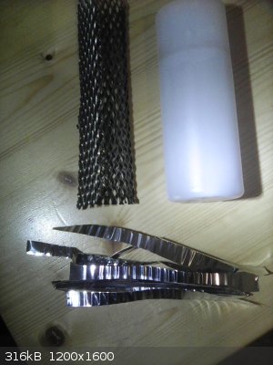

The materials for the experiment
reduction1.jpg - 316kB

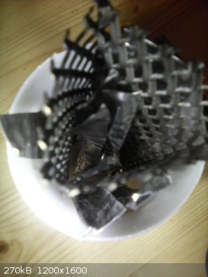

Reaction vessel set-up
reduction2.jpg - 270kB

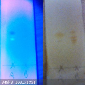

It seems to (?) be quite effective on the 0.5g scale with the compound dissolved in 50% aqueous ethanol. TLC indicates complete reduction of conjugated fluorescent compounds (? divanillylideneacetone impurity in starting product?) and formation of new, similar but lower Rf potentially unsaturated constituents
TLC - sorry for poor image
reduction3.jpg - 349kB
Left lane (A): dehydrozingerone (B) Reaction mixture after novel hydrogenation attempt. Viewed under UV 395nm – first plate and I2 visualisation – second plate.
Olfactorily, there is a formation of a new ginger scent and loss of the yellow colouration of the starting material
It's as simple as some folded platinised titanium mesh as the catalyst, allowing for easy and complete catalyst recovery, whilst generating nascent hydrogen in situ from dissolving aluminium strips and gradual addition of HCl, near the mesh. It's very friendly and simple to do
