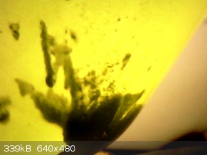

0.1 [cc] of crystals, 4 [cc] H2O dissolves them, 2 [cc] of paraffin/kerosene to cap it off.
Use soldering iron which extremely slowly will boil water out and cause and dissolved oxygen/nitrogen to go away. The solution is almost clear, just the tiniest tinge of dull yellow.
I take a clean glass stir rod .. touch to the top of glacial acetic acid with it. Shake off droplet so only a tiny film remains on glass ... and push it through into the bubbly hot water.
Instant yellow, quite visible, and it's turning rapidly yellow green. But it's not bright yellow like with hydrogen peroxide or NaNitrite. I think it likes to make a hot coloidal solution even with tiniest amounts of acetic acidifying.
vlcsnap-2026-03-27-17h30m35s320.png - 294kB
Now, let's see how it crystallizes (eventually).
vlcsnap-2026-03-27-19h53m55s783.png - 339kB
The colloidal particles fall out just above the soldering iron, which is maintaining the glass bottom at 150[°C]. Pretty much there isn't enough surface area to transfer heat effectively, so we get microboiling right at the point of contact with the glass. When I first heat the test tube, gas bubbles are released and the tube gets hot to the touch (but not enough to burn). But after a half hour or so, no more gas bubbles appear and all semblance of boiling stops.
Basically, a cycle is set up where coloidal particles (white to the eye, or a paler yellow than the liquid -- though the picture has them in shadow) build up above the hottest part of the test tube. Then they slide down onto the hot spot, and explode into dispersed particles again with a tiny bubble or two of gas escaping. Then the glass is clean ... and over a period of an hour the colloidal particles build up again.
There's two ways I expect this experiment might progress. One, the acetate may slowly be gasiffied and removed from solution because the cyanide is more stable (AKA: a weaker acid). In that case the solution ought to become more and more yellow, and closer to clear water. Or the acetate might stay at a constant value because it's made a salt that's stable in this environment.
Depending on how it progresses in the next few days, I might need to add more acetate solution; or I might need to think of a different way to introduce acetate in smaller amounts.
At first it looked like it was becoming darker green with time, but now it looks to be turning a lighter brighter yellow (slowly).
This is going to take a few days ...
