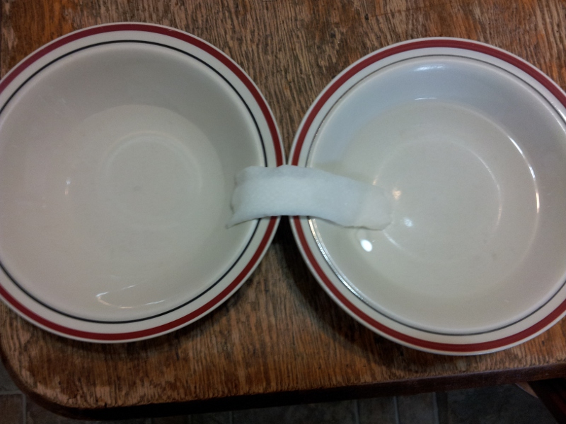

DDNP Recrystallization by Capillary Action Addition of Water to Acetone Solution
The idea of using a wick is not a new one. The idea of transferring a fluid in a controlled manner from one vessel to another using a wick has been mentioned here and at the old E&W forum. I decided to give it a try since unlike evaporative recrystallization, it would purify the DDNP and would not put a lot of acetone vapors into the air. I first tried a piece of loosely rolled up paper towel, to transfer water from one bowl to another. It took about one hour and fifteen minutes to transfer about 50mL of water, in such an even and slow manner that no human could match it with a pipette and if they tried they would be driven to frustration and then madness. :D
Wick Starting.jpg - 193kB Wick After 1h15min.jpg - 202kB About 50mL of Water in 1h15min.jpg - 444kB

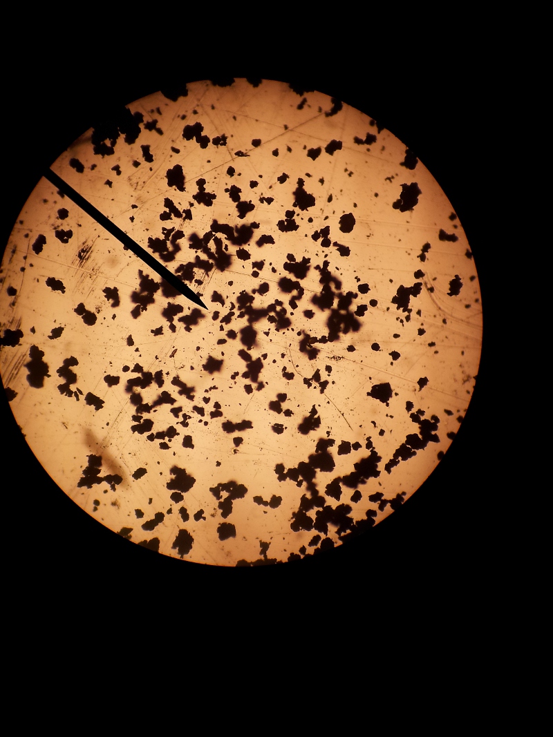

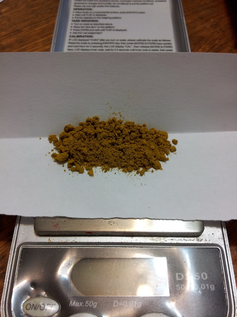

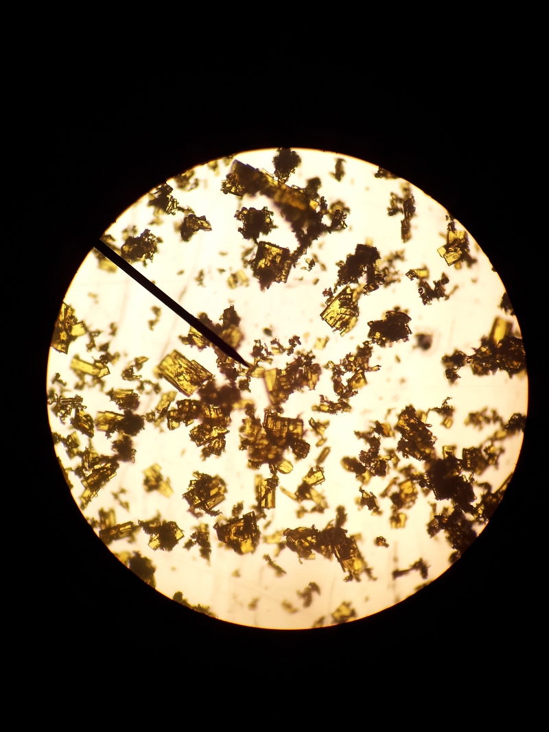

Yield from Capillary Action Recrystallization Experiment
Just took the yield from yesterdays capillary action solvent addition recrystallization experiment. From 2g of crude product, which was made by method B from the article, "DDNP a Detonating Explosive", 1.3g of very pure crystalline product was obtained or about a 65% yield based on the crude DDNP started with. The filtrate is an extremely dark brown with a bit of red to it (I am not great at describing colors).
Below on the left is a 100X microscope picture of the unrecrystallized product, which no matter how hard I tried to focus in on it or prepare the sample I could not make look like anything other than little clumps. BTW, this crude material is what I have been using for the last few explosive tests. The middle picture is a 100X microscope shot of the recrystallized material. It has very well formed large crystals of yellow DDNP. I may have to try 0.2g of this material initiated with 0.05g or less of lead azide or silver azide to initiate 2g of picric acid. The picture on the right is of the filtrate.
Unrecrystallized DDNP 100X.jpg - 307kB Recrystallized DDNP 100X.jpg - 304kB Filtrate.jpg - 390kB
BTW, the DDNP produced using method B from, "DDNP a Detonating Explosive", is not really in as nice a form as I indicated earlier in this thread.
It is more or less free flowing, but has fairly low density and is quite fluffy and dusty. Although I would have to go back and check that I followed their procedure exactly to the letter.

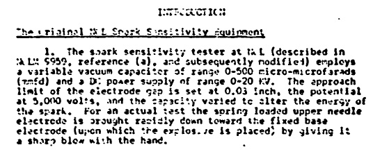

Static Sensitivity of DDNP
Found a little information on DDNP static sensitivity, though in the body of the report the authors state that the sample was old and they didn't verify its purity. The report is titled, "The Electrostatic Spark Sensitivity of Bulk Explosives and Metal-Oxidant Mixtures", and can be found in the DTIC database. I have made jpgs of the introduction and the table which shows DDNP's static sensitivity curves in relation to several others. The copy is an extremely poor one, but it is still readable for the most part.
Introduction.jpg - 64kB DDNP Relative Static Sensitivity Graph.jpg - 94kB
On the x-axis of the graph is capacity in micro-microfarads (picofarads), and on the y-axis is static energy in ERGS.

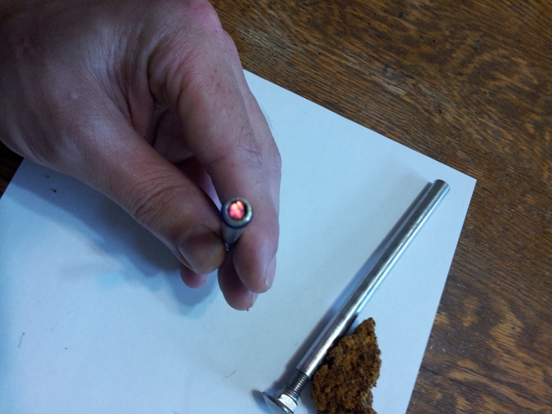

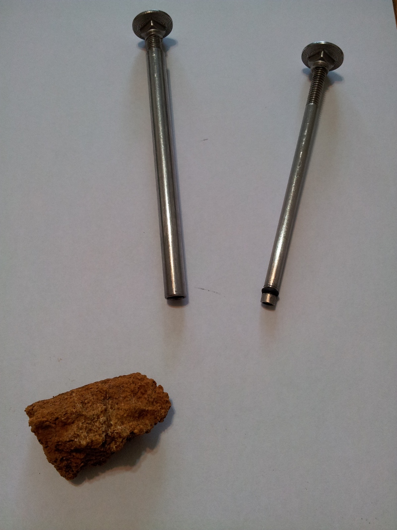

Adiabatic Compression Ignition (a.k.a. The Diesel Effect)
The Fire Piston
This is maybe a little off topic, but I think these little devices do a wonderful job of demonstrating compressive heating. I have built several of these using various materials, and the one shown in the picture is the last one. I was at a yard sale a few years ago and I noticed a box of stainless steel hardware with $10 marked on it. Being interested I dug through the box and at the bottom of the box, and accounting for more than half the weight of the contents, were long 1/4" SS bolts with only a small amount of thread on one end and close fitting SS sleeves to go with them. On inspection the sleeves were found to be seamless, so of course I bought the box. IIRC there were about 30 of these bolt sleeve pairs in the box.
I just dug out my fire piston and took a few pictures. There are lots of YouTube videos of people demonstrating fire piston operation. The tinder I am using is a type of tinder fungus called the Chaga mushroom. About eight or ten years ago, after learning about the Chaga mushroom, I would always stop to collect it whenever I saw it in the woods. My parents started to complain after I had three large cardboard boxes full of it in the living room. Whatever happens I will always have lots of tinder fungus. :D
Adiabatic compression is compression were theoretically no heat is transferred to the surroundings. This is a very close approximation of what happens when there is rapid compression like in a diesel engine, a fire piston or especially in a blasting cap. The effect is so rapid, that a negligible amount of heat escapes. I think a fire piston makes a wonderful demonstration of this concept. Simply using human power to compress a gas (air) to above the ignition point of tinder makes a very interesting demonstration. IIRC temperatures often reach several hundred degrees Celsius in a fire piston, for a brief moment, at the point of maximum compression.
Fire Piston Kit.jpg - 325kB Fire Piston Kit 2.jpg - 174kB
Empty Fire Piston.jpg - 323kB Tinder Fungus Combustion.jpg - 295kB Fire Piston loaded with Tinder Fungus.jpg - 218kB
