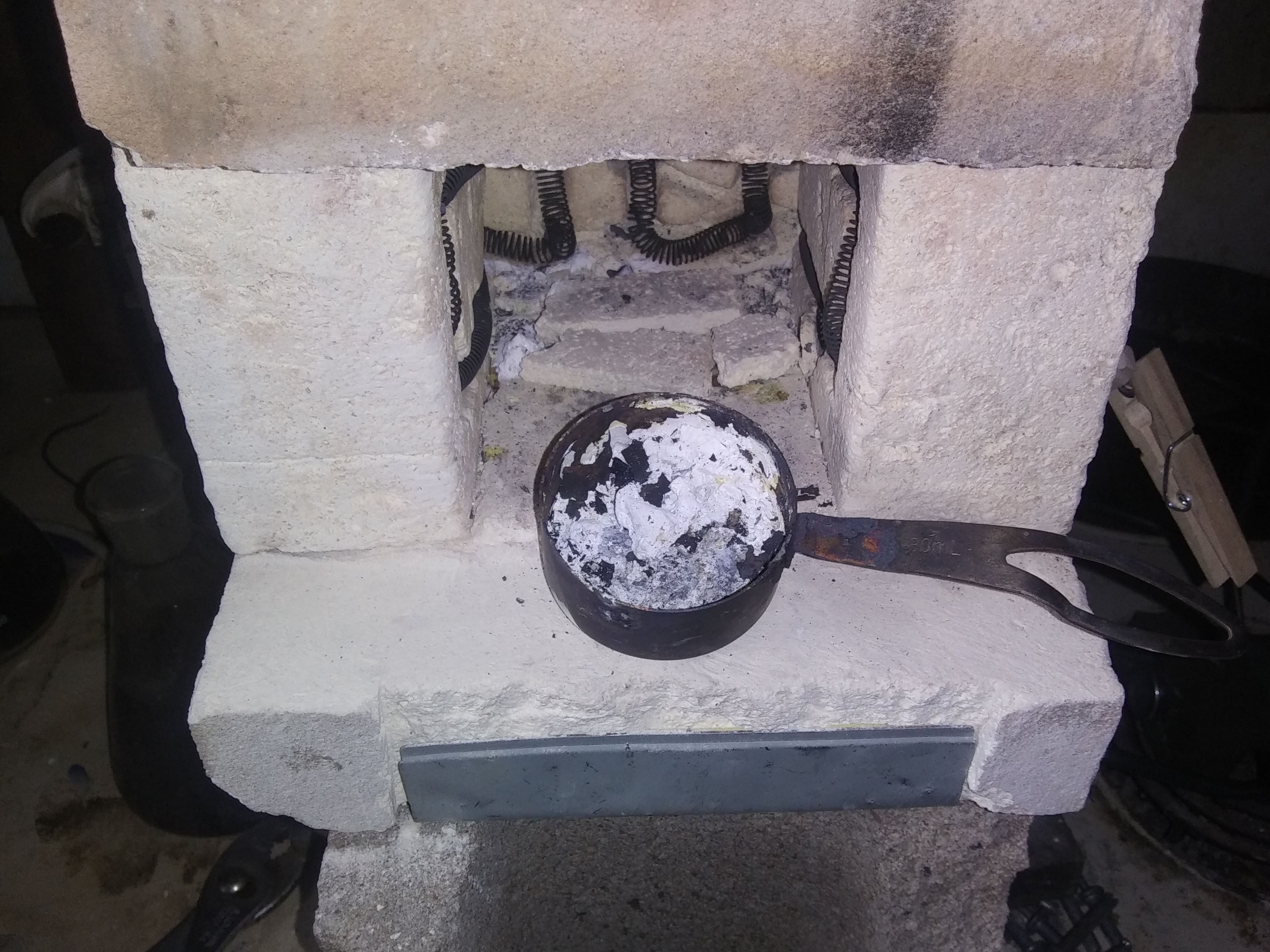

Unknown metal oxide
Wasn't my intent, but when melting some white metal the other night I inadvertently got some (X)O. Opened the front of my furnace and there was what looked like and actual flame coming off the crucible content.
