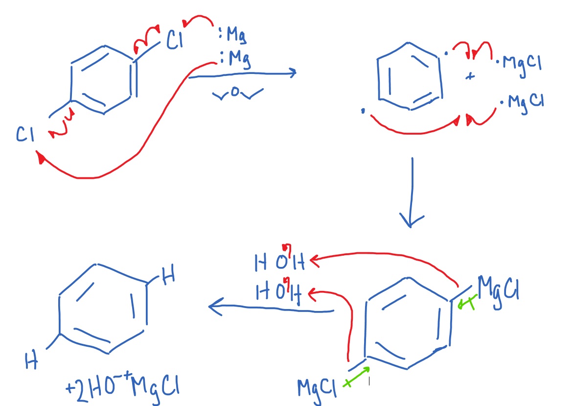

WHAT'S NEXT? How about BENZENE from DOLLAR STORE CHEMICALS!
All you need is some para-dichlorobenzene mothballs, magnesium, ether from engine starting fluid and water! Tell me if you guys think it will work, I attached the mechanism, but I am very terrible at grignard-type radical mechanisms so please let give me your critiques!
mechanism.jpg - 110kB

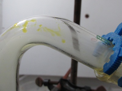

Using just a small spirit burner, this actually worked (kind of) and gave a tiny, yet totally clear product which smelt distinctly like i always thought benzene smelled.
1styield.JPG - 55kB
A blowtorch was then used to raise the temperature and speed up the reaction. Perhaps doing that caused the next distillate to become orange ?
Unfortunately the metal tin seal began to leak, also the lid, which led to to small benzene fire which was immediately extinguished.

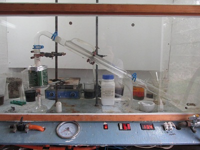

Undeterred, the contents of the tin were extracted and around half was loaded into a 100ml RBF. They're the cheaper to replace than the 250ml+ sizes.
rig2.JPG - 54kB
Again the spirit burner was used, this time with aluminium foil for insulation.
The product came over after 8 minutes at a rate of 1 drop every 3 seconds.

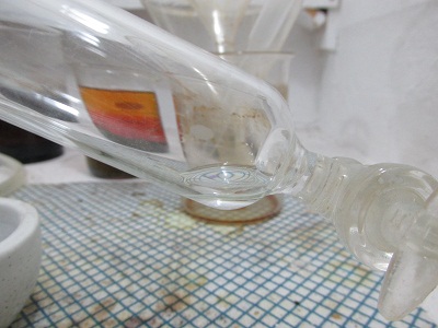

The gas escaping from the pot appeared as 'threads' in the condenser.
gasthreads.JPG - 40kB

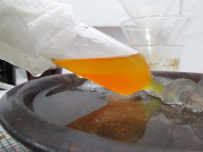

The result of this distillation was a yellow/orange liquid which clearly has two layers.
2layer.JPG - 46kB
The rest of the reagents will be distilled soon, the products combined, then re-distilled to work out the yield.

All of the available sodium benzoate was used (~80g) resulting in about 37ml of orange liquid, still to be re-distilled to get any actual product.
The spread of heat appears to be vitally important.
In an RBF one can see the area affected by the flame becoming black and bubbling, while the rest of the white powder remains unaffected.
With a naked flame (spirit burner) this can be moved to target an unaffected area, which seemed to squeeze out a brief run of more drops of distillate each time the flame was moved.
A steel conical flask with a huge bottom surface area might work, so that the powder remains in a very thin layer and gets heated enough for the reaction to complete.
Maybe a steel reactor where an inert atmosphere is super-hot and the powder gets fed in somehow, while allowing the benzene gas to escape.
Edit:
The products were redistilled and a cloudy liquid came over between 71 C and 75 C, the orange stuff stayed in the boiling pot.
Yield at this point is 24.1g = 56.7%
Probably needs drying so that % will reduce :(
[Edited on 28-11-2016 by aga]
I made my benzene in steel solvent cans. I punched a hole in the top and attached a brass compression fitting, which I connected to a copper tube that ran through a thermometer adapter into a condenser. I loaded a powdered mixture of sodium hydroxide and sodium benzoate into the cans, and heated I heated the cans over a propane stove. This resulted in an orange distillate, which was washed, dried, and fractionated. Each can is good for several runs.
The yield was far from quantitative, but the reaction is easy to do, and the reactants are cheap and readily available. I was very careful not to breathe any benzene; I'm not really sure how severe a carcinogen it is, but it has been proven to actually cause certain cancers.
[Edited on 27-2-2017 by JJay]

This all went a bit wrong and destroyed a 100ml and a 250ml RBF on cooling, as expected.
Edit:
Exactly the way I did it. Stainless biscuit barrel, tank connector and some 15/22mm copper pipe plus fittings. Yield not great but better than nothing. I got the same orange distillate which I then redistilled in a glass setup
