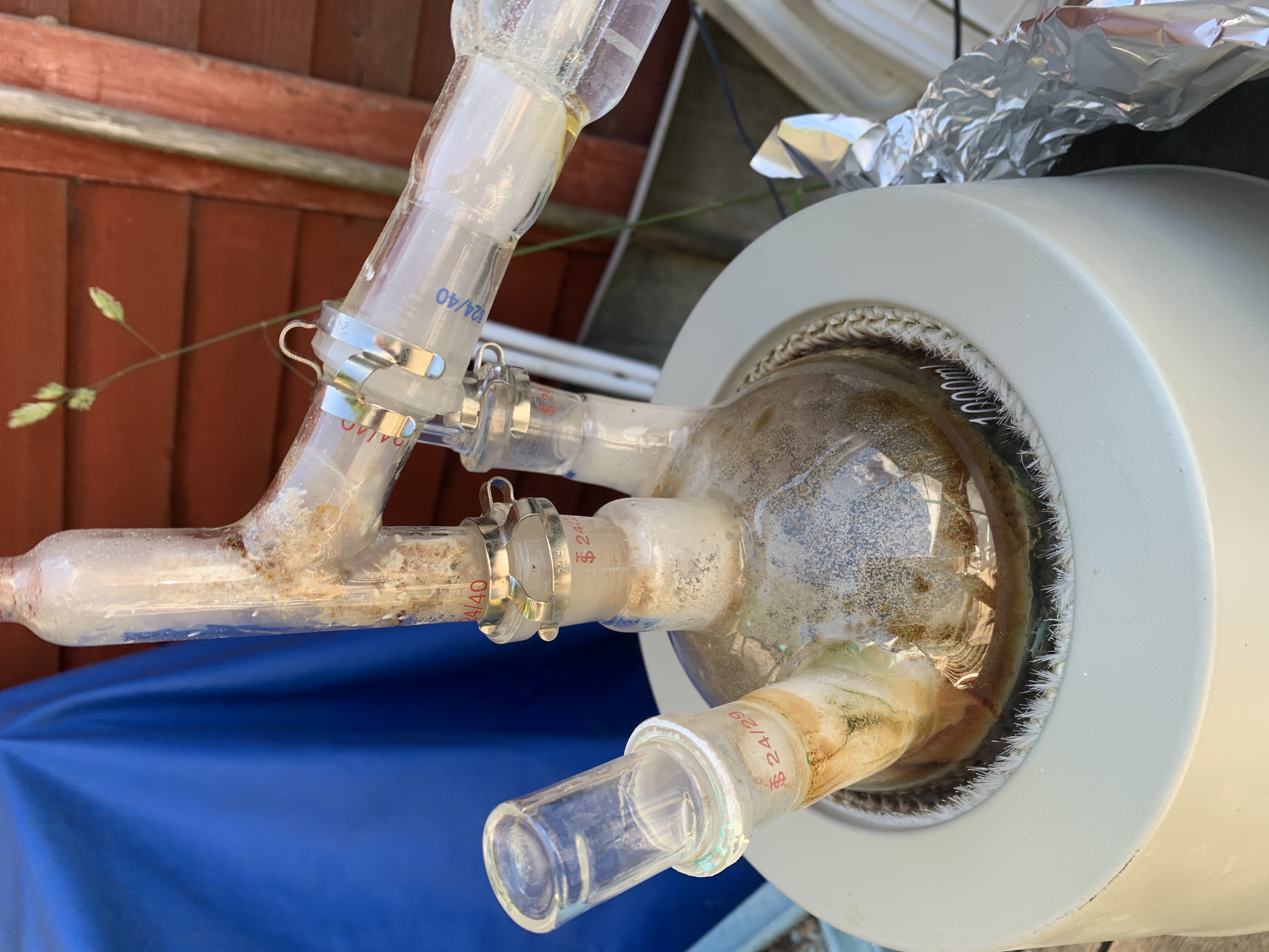

An overly destructive decarboxylation
A pyridine quest. Niacin + copper carbonate + heat. Unfortunately I got impatient and cranked up the heat too much, so the distillation setup got overflowed with sublimated niacin and pyridine vapours. And the yield was TERRIBLE as a result.
The crude, yellow distillate was mixed with a few grams of sodium hydroxide and redistilled. I fractioned out nice, clear pyridine and some cloudy drops in a spider. The cloudy fraction was dried with magnesium sulphate overnight and cleared up fine. In the end I actually got around 140 ml of nice, pure pyridine.
On a side note I really can't understand how people can compare this smell to rotten fish. That can only be done by people who never smelled either rotten fish or pyridine.
I actually don't think the smell is that bad. It's not nice, and I have no urge to smell it again, but rotten fish? Really?
Doing my chemistry on the countryside and actually fishing between sessions, I happened to have some discarded fish parts rotting away closeby.
Nope. No likeness.
And as for the title, I'm not sure I'll ever get that RB clean again. I tried a base bath, sulphuric acid, oven cleaner, everything. it remains partly charred.
Sigh.
We had a good run.
IMG_0240.JPG - 3.8MB IMG_0256.JPG - 2.1MB
[Edited on 20222222/7/25 by DocX]

Some more pics: charred 3 neck RB and horribly, horribly overflowed receiving flask.
Also visible is my sloppy addition of the starting powder. Let it snow, let it snow, let it snow ...
IMG_0241.JPG - 2.7MB IMG_0242.JPG - 3.4MB
[Edited on 20222222/7/24 by DocX]
The stains are from the copper? Hot oxalic acid will fix it then, no problem.

DocX
Posts: 179
Registered: 22-10-2015
[*] posted on 25-7-2022 at 00:11
/ORG
I'll try that too, but I don't think it's copper per se. I've already tried some of my precious nitric acid without result. It's most probably just carbonised residues. Burnt stuff. A lot of it was removed with oven cleaner, but there are spots in there that are just really really tough to get out.
I also don't have any H2O2 of decent concentration, otherwise I would try piranha solution, naturally. I guess chromic acid is next. My sulphuric acid is very dear to me though. My precious. Hate to waste it for cleaning purposes.
[Edited on 20222222/7/26 by DocX]
