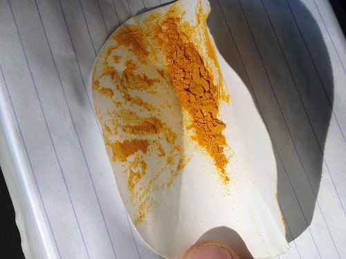

DBX
Did some homework 2day. This stuff should be DBX-1. I have used the synthesis without NaNTZ but only acid CuNTZ and sodium-ascorbate. I cannot post the synthesis again because it is patented at the moment.

Interesting! In the article continuous microreactor.... they mention a synthesis for pure NaNTZ which should be even more safe and easy.. why all the effort for NaNTZ with purifying etc in other articles :(
@ Rosco: this DBX looks like the right color right? Think I made a little to much at once. Is it advised to separate the stuff into 0.5 grams portions or even less? Don't really know what to expect of it when it's dry!

I would have expected the DBX-1 you synthesized to be a little more redish. I would not keep for long term storage. However, I doubt that you would. Any excess can be rendered inert by combing it with 10% sodiumhydroxide. This is an extremely interesting compound and is being sought as a replacement for Lead Azide for military applications. Based on former life, I have learned that the military is always trying to find ways to be more earth friendly. They don't care about what they blow up, but heaven forbid if there are heavy metals left behind.

The DBX-1 turned almost black in the end. When dry it became little chunks of DBX-1 who where impossible to be powdered. They were quite sensitive for impact but did not work when ignited by fuse unfortunately. The synth I used was whithout the use of NaNTZ. Maybe this synth was not so good after all. I now have an amount of cupric(II)cloride and I will try the synth again in a while. I indeed decided to put away the stuff. Have you tried DBX-1 yourself btw?
