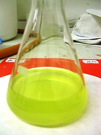

About the IP extract + IP nitrit method.
Schema of reaction:
HS Extract (3 times) + NaOH + IP nitrite == NaN3 + Na2SO4+IPA
1/8 mol=16g + 5g + 13ml == 7,5g
Extracted was 5 h at RT ,reaction was 24 h at -5C in freezer.Precipitated was with 3 vol. of ethanol(tech.)+aceton 1:1
Pictures: 1,2,3= extraction chemicals and extraction beaker
4=extract + NaOH solution in 40 ml IPalc.
5= extract with NaOH sol + IPnitrite=reaction mixture
6= the reaction mixture after 12 h.
7= reaction mixture after 24h.
8,9,10,11=filtration and amorph product
12=giving the product in the beaker before diluting
13 =product diluted in watter,very solubile
14=precipitation with alc./aceton mix
15=precipitation after 12 h. in freezer at -5C=ZERO
Conclusion: This reaction I did 13 x.Only one of these was with yield,all other reactions produced either dark liquid or ,like this -nothing.Does
somebody knew what is wrong or what to do for to have some yield?

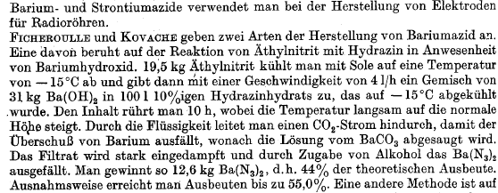

In the literature is citate the Thiele/Stolle method in relation to industry to the end of WWI.After only like method for labors.Simmilar method in
the industry is citate by Urbanski.
This reaction has 2,59 mol of ethylnitrite and to this ethylnitrite is added during 24 h suspension of 1,8 mol Ba(OH)2 in 2 mol of
10% hydrazin hydrate.All freezed deep under OC.After they bubbled it with CO2 for to remove barium hydroxide.
This reaction should be theoretically 1:1:1 ,but they want to have surplus of etylnitrite and less of hydroxide.

Precipitation of Ba(OH)2 happens as carbonate (BaCO3 is white precipitate).
Because
CO2 + H2O --> H2CO3
H2CO3 <--> H(+) + HCO3(-)
HCO3(-) <--> H(+) +CO3(2-)
and
Ba(OH)2 -aq-> Ba(2+) + 2 OH(-)
OH(-) + H(+) <--> H2O
finally
Ba(2+) + CO3(2-) <--> BaCO3(s)
Don't add to much CO2.
because
H2CO3 + Ba(N3)2 --> BaCO3(s) + 2 HN3
and
HN3 is very toxic (like cyanide) and volatile
PH Z (PHILOU Zrealone)

The Barium azide could be advantageously,because it seems be easier to purify.
In this moment I am doing other experiment-I converted the data from BaN6 manufacture to the NaN3:
2,59 mol of ethylnitrite=ekv. 2,59 mol of IPnitrite=265,22ml IPnitrite
1,8 mol of Barium hydroxide=ekv.3,6 mol of NaOH=144g NaOH
2 mol of Hydrazin hydrate=extrakt of 2 mol Hydrazine sulphate=260 g Hydraz.sulfate.
(The citation from Urbanski says nothing about solvent,but if it should be freezed to -15C,then it could be some alcohol.I take technical ethanol)
I gave one half of 1/10 of these amounts= 13ml IPnitrit + 7,2g NaOH(in 50ml tech.ethanol) + extraction of 13 g HS(in 50 ml tech.ethanol). To the
IPnitrite I added yeasterday each one half of hour 5ml of extraction + hydroxide.Hydroxide I gave less than I should gave.And it was funny,I saw the
ethylazid on the bottom there.
Now,after 24 h it is cloudy liquid and I am waiting until it will be clean.
[Edited on 15-10-2016 by Thraxx]
