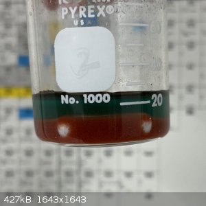

Axt, I tried that method you posted with some changes and it works phenomenally. Procedure was as follows:
1.4g of Aminoguanidine bicarb was added to about 25 mL of warm water and 70% perchloric acid was added incrementally until it completely dissolved. Then, 1.6g of nickel perchlorate was added and a light green solution formed. pH was adjusted using a 25% ammonia solution, as it was added the solution changed to a dark blue color. When the pH hit around 6-7, NAP immediately began precipitating in the form of very fine crystals. The NAP was vacuum filtered and washed with isopropanol. The product deflagrated with a pop when touched with a flame, and detonated even in milligram amounts when heated on foil.
IMG_3498.jpeg - 427kB
This method produces a superior product to the nickel carbonate method and is also safer as you don’t need to heat a solution of primary explosive to high temperatures.

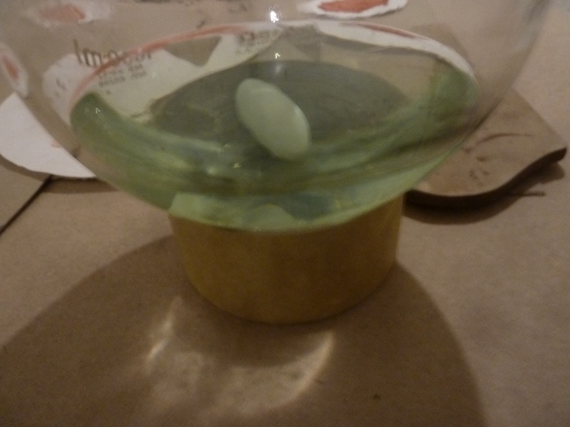

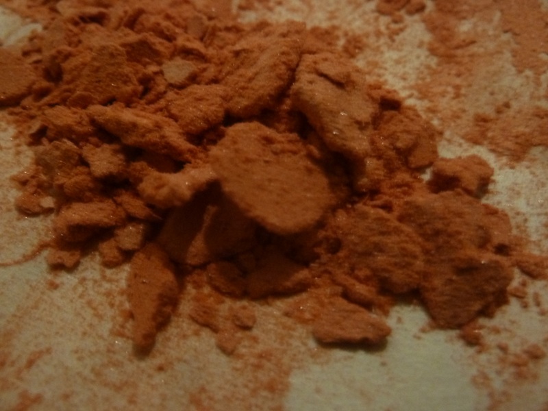

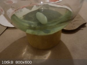

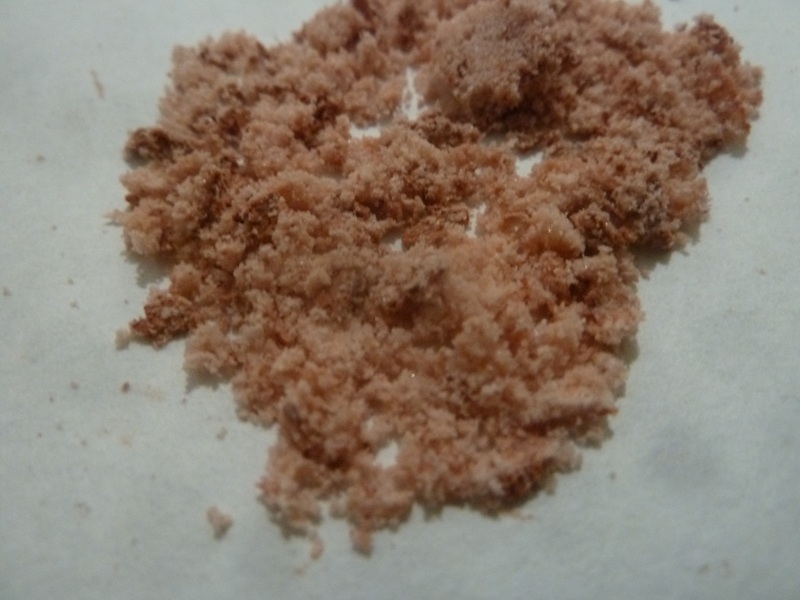

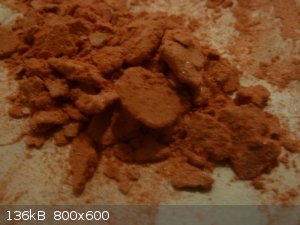

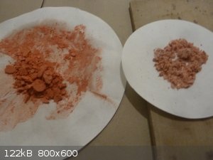

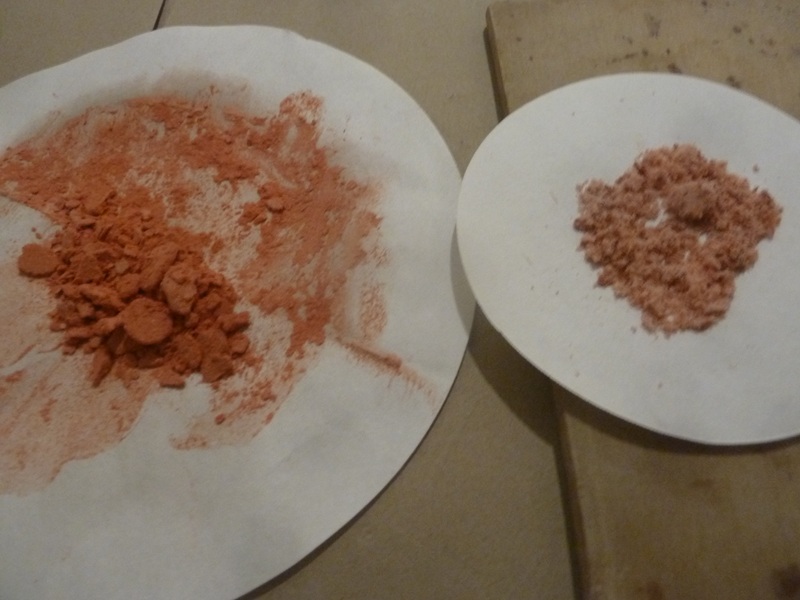

The method described by Axt and Sir_Gawain is indeed superior. I´ve tried it in the follwing way:
0,1 mole aminoguanidine bicarbonate covered with a several ml distilled H2O, followed by an equimolar amount of 70% perchloric acid immersed in a warm water bath to speed up dissolution, followed by 0,05 mole Ni (ClO4)2 * 6 H2O.
A dark green solution and nothing happened, not with days of patience nor with further heating (contrary to the patent claims!).
Dropwise addition with magnetic stirring of an equimolar amount (0,1 mole) of 25% aqueous ammonia gave a blue discoloration which fades immediately with stirring. After several drops added, a dark salmon colored precipite appears. After complete addition, the flask was cooled with an external cold water bath and further stirred .
Even after prolonged stirring and cooling, there was still a dark green supernatant solution above a generous precipitate of salmon-colored fine crystals, which were filtered, washed with distilled water and air-dried.
The filtrate was transferred in a RBF with a magnetic stirrer, claisen distillation bridge and placed in a warm water bath. A vacuum supplied by a two stage diaphragm pump was applied. I´ve used a warm water bath (no electric heating mantle) for two reasons.
1st, I want to avoid "hot spots" which are easy created if dried spots inside the RBF are no longer covered with the residual filtrate.
2nd, in the case of a broken RBF there is no risk of a contact with a hot heating wire which could cause an explosion. Additionally, the dangerous mixture of a running magnetic stirrer and glass splinters (which would act as a sensitizer) is immediately quenched with a large quantity of water.

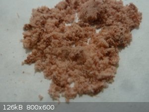

My original intention was to get some ammonium perchlorate as by-product, but to my surprise I got a second crop NAP. Probably somewhat contaminated with ammonium perchlorate, but after cooling down, suction filtration and washing with distilled water I got an appreciable second crop NAP.

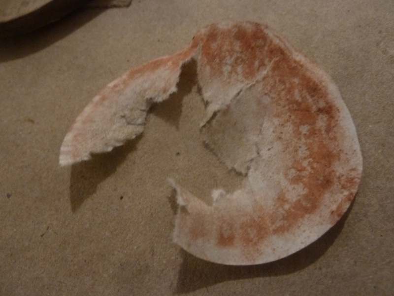

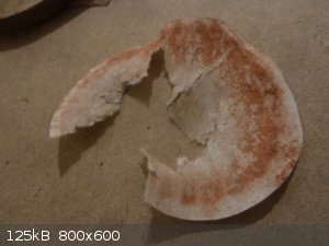

See attached pictures, large filter paper is first crop and small filter paper is second crop. Judged by the naked eye, it seems different compared with the first crop. Even if it contains some AP as contamination, it´s definitely high energetic. After transfer of the second crop of NAP to a fresh filter paper for further drying, I´ve hold the still wet used filter paper (which contains milligram quantities of NAP) in the blue bunsen burner flame and got after a few seconds a considerable bang.
On the other side, a small quantity (matchhead-size) from the first crop hold with a stainless steel spatula in a blue bunsen burner flame gave a very fast "whomp", but no bang. It seems that the very slight confinement in the porous filter paper is enough to promote ddt even in tiny amounts, whereas completely unconfined material need a larger quantity for ddt.
Even after the second crop, the filtrate does still contain some nickel, judged by the pale green color of the filtrate. But I doubt that it is worth to try a thirth crop.
Comments welcome.
