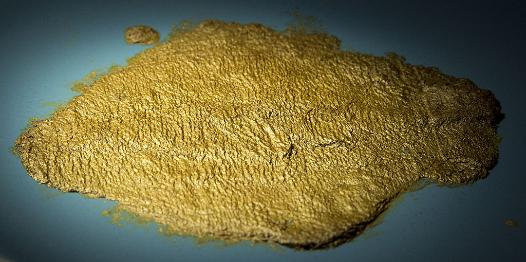

I was thinking, maybe it doesn't need complete neutralization at all. :) Maybe adding ice and a very strong solution of sodium sulfate (maximum about 1 mole per mole of sulfuric used can lower the solubility of the DNAc or potential acid soluble compounds, without changing pH leading to an exotherm. Sort of salting out procedure. Can't find a solubility chart for sodium bisulfate, but according to Sigma-Aldrich it is 390g/L at 16 Deg C, meaning it would likely stay in solution.
The attempted 10% acetic acid diazotization produced an amorphous fluffy DDNP with more carbon deposits, no benefit there it seems, maybe stronger AA would be better.
The isopicramic when recrystallized from methylated spirits is really one of the most beautiful compounds I've seen yet. It is almost like pure gold foil. (The imprints are from blotting dry with paper towels). Picture of 3 gram (test run) recrystallized ispicramic attached. The earlier mentioned 12 grams solubility per liter is probably inaccurate, it may be that the insolubles are actually impurities that remain behind and crystallize earlier from solution in the cold. When filtered off and boiled to nearly dryness, this remained, which corrseponds to Dabneys report on the gold lustre. So far it keeps the gold lustre very well, no sign of surface oxidation yet. It is not known what is in the methylated spirits, I just hope that it isn't some compound formed from heating of the solution with isopicramic. Ah well, OTC is gold...
Isopicramic recrystallized ethanol.jpg - 224kB
Almost seems like a waste to diazotize :D

Very nice, the purified isopicramic acid has a shiny golden luster like a gold bronzing pigment. You should save a vial of the material as a pH indicator good for mineral acid titrations and perhaps good for other special things.

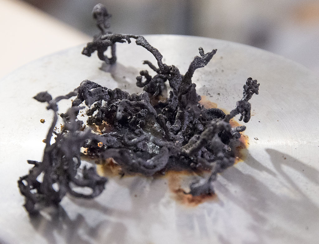

Oh, also did an experiment with diazotization in ethanol by the following procedure:
1 gram of recrystallized isopicramic acid was dissolved in 50 ml of ethanol (gentle heat applied to speed things up). This was placed in an ice bath and allowed to cool to about 5 deg C again, after which 1 ml of 98% sulfuric acid was added (no sign of precipitation) and again cooled to 5 deg C. Thereafter, a solution of 0.5 gram sodium nitrite in 4 ml of water was added dropwise while stirring over the course of about 5 minutes. Crystal growth was much better using this method, forming a fine gllistening product over the course of about 10 minutes. It's still drying though. :)
Isopic burning.jpg - 198kB

Great finds Rosco! Initiating power equal to lead azide for the potassium salt of DDNR sounds great, looks like it can be recrystallized from water as well. Difficult part will undoublly obtaining the dinitro aminorescorcinol, and SnCl2 to perform the reduction.
The fun with these compounds just doesn't seem to stop. Apart from the fact that paracetamol makes an easy route to isopicramic acid and a word class primary(ies?), the isopicramic acid also seems to crystallize as an almost pure gold compound...and burning it is very funky. Burning one gram reminded me somewhat of mercury(II)thiocyanate, producing these organic looking "branches" of carbon when it is burning. Picture attached, it was even better looking before I tried to move it and part of it fell apart. :)
Great news that the alcohol idea is working out. There are several variations using alcohol with or without acetic acid and in different orders of addition for different nitrous precursor reagents to accomplish the diazotization, so I figured one or more of the alcohol processes should work to provide a complete diazotization and decent crystals. Technique is important with difficult solubility of the isopicramic acid being the complication to overcome.
