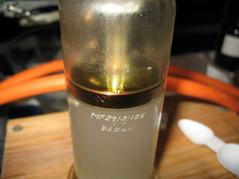

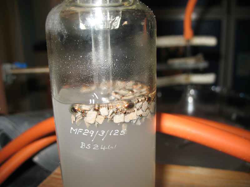

Excellent thread. Have been looking for a way to make lithium amide in order to use it to synthesise 9, 10-bis(phenylethynyl)anthracene (one of the fluorophors used in glow sticks) according to this patent:
http://www.freepatentsonline.com/3911038.html
The sequence to lithium bronze and onwards to lithium amide appears relatively straightforwards according to the beginning of this thread
Anyhow I set up an ammonia generator using solid NaOH and (NH4)2SO4 initiated by a few drops of water. THe ammonia was led through a 'U' tube containing CaO onto a Dreschel bottle containing lithium in dry hexane. The exhaust from this went via a rubber tube to an inverted filter funnel just dipping into a bowl of water to absorb any excess NH3. These are the results after 1 hour and 10 hours:
IMG_5052a.JPG - 26kB IMG_5053a.JPG - 22kB

Nicely done plastics. That's quite an attractive layer of bronzeish liquid there, looks almost like a machined piston.

Impressive and beautiful. Liquid bronze!

Wow, im am so jelouse you don't even know. I have never produced such a large amount that is if I understand the scale of what im looking at.
Tell me this isn't some of the coolest looking stuff you have ever seen. Its like Gold and Mercury had a baby and this is what was produced. Its awsome to suck it up into a plastic pipett and watch it change from gold, to red to purple to blue and in the end a white or grey powder.
Its obvious to me that your Lithium has come from a much better source then mine which originated from batteries.
I really want to know the experimental detail if you have them avalible.
What was the weight of the Lithium at the start of the experiment?
How much Ammonia Sulfate and NaOH was used in the NH3 generator. I always used Ammonia Nitrate/NaOH and the generation of Ammonia gave me problems on a few occassions messing up experiments before they even begun causing me to lose materials.
Did you by any chance measure the weight gain compaired to the start of the experiment since this would give a pretty good idea of exactly how this complex is contained as long as the NH3 in solution of hexane is accounted for.
Did you stir, I never did and Im almost 100% positive that this would dramaticly cut down the time needed to take this to completion.
Did the ammonia generator make way to much ammonia at first then die off quickly wasting alot of ammonia or was it relatively steady. If it was steady how did you go about mixing the materials? To fine a power always caused me issues. I put off reproducing this experiment until I had a kipps and a sufficent dryer so that I could do this experiment the way I knew I should have been doing it.
I know its not very important but any idea on the amount of Hexane used? I always used Ether which contained a small amount of Hexane.
Im sure I have many more question but thats the basics for now, im going to go back to admiring your pictures now. Awsome work. This has always been one of my favorite reactions I have performed because the end result is just mesmerizing to look at to the point where I never really made much real use of it. I just played with it till it decomposed:D

Yes I agree this stuff is very eerie and mesmerizing especially as all the globules formed, got bigger and then coalesced to a contiguous layer.
For the ammonia generator I used 2 mol (80g) NaOH (sink unblocker) and 1 mol (NH4)2SO4 mixed in 500ml erlenmeyer fitted with single holed rubber stopper and glass tube to the U-tube containing CaO. The NaOH was small prills appox 1mm diameter and the ammonium sulphate similar sized crystals. On adding the water the whole thing went crazy and started effervescing immediately, ammonia bubbling through my scrubber without even dissolving in the water resulting in some loss. The ambient temperature was about 10 degrees C. Slowed down gradually and ultimately required some gentle heating. Tried to keep a balance between production and dissolution via the inverted funnel
Lithium prepared from small chunks I acquired - all very old and covered in grey hydroxide/nitride. Used single 1.5g piece prepared as per Vogel ie pounded with a hammer until thin sheet, cut into strips into anhydrous ether and then into small squares directly into the hexane in the Dreschel bottle
No stirring of the hexane/lithium mix. Bubbling of the ammonia was sufficient to make all the pieces 'dance'. Initial hexane volume was 100ml - unfortunately I didn't think to weigh the mix before and after - wasn't sure it was going to work!
