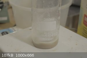

Solvent interaction on NAP
I have just tried a few tests with alcohol solvents preparing NAP. The results were interesting so I will add here.
First two images are NAP patent procedure in terms of ratios and volume but I replaced H2O with 91% Isopropanol. The mixture begins as turquoise but then changes to a red then at completion a brown black. The color change began at bp of isopropanol ~82 C.
The next four images are NAP reaction in commercial denatured alcohol solvent. The alcohol was brought to boil and there was no reaction. The volume of alcohol (11ml) reduced over 5 minutes with no noticeable reaction. More alcohol was added to replace evaporated level. And as no reaction proceeded 10ml dH2O was added which immediately initiated a reaction which then proceeded through turning tan/brown, then reddish. At the end of the reaction the (presumably) NAP separates and drops to bottom with a clear layer above. There is no black layer in this denatured alcohol method. When water is used as the solvent there is a black color in solution and when isopropanol is used the black appears to mix with the product and create a dark red/brown/black product.
Are there other solvents of interest? MeOH or Acetone?
I am also curious for other experimenters, how is the NAP coming out of solution for you? Is it dropping out immediately or forming slowly over the 4 hour sitting period? I ask this because all of my tests have resulted in immediate precipitation at conclusion of boiling. These pictures were all taken following removal from heat, Im allowing them to stand 4 hours now.

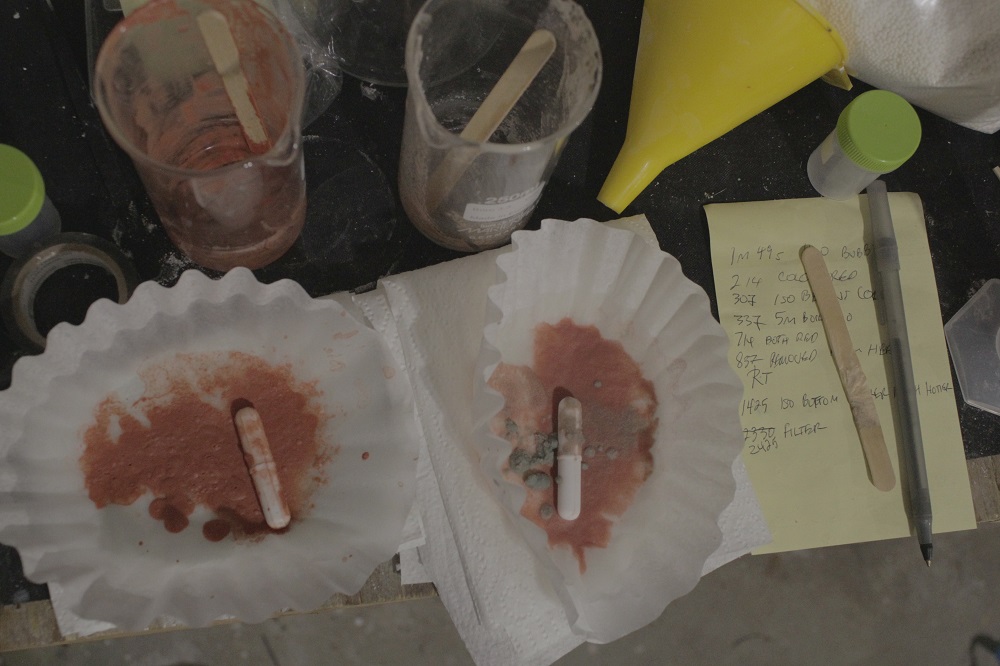

First image is comparison of the two materials on coffee filter paper. The denatured alcohol version is very granular and has homogenous color. I thought it looked kind of less vibrant color red but in the second photo you can see its actually a shade lighter and deeper red tone than a previously made sample shown in the vial. You can clearly see in the second picture the grainy consistency from denatured alcohol/water reaction. normal consistency is powder.
_MG_9534.jpg - 162kB _MG_9533.jpg - 164kB
[Edited on 13-4-2023 by Hey Buddy]

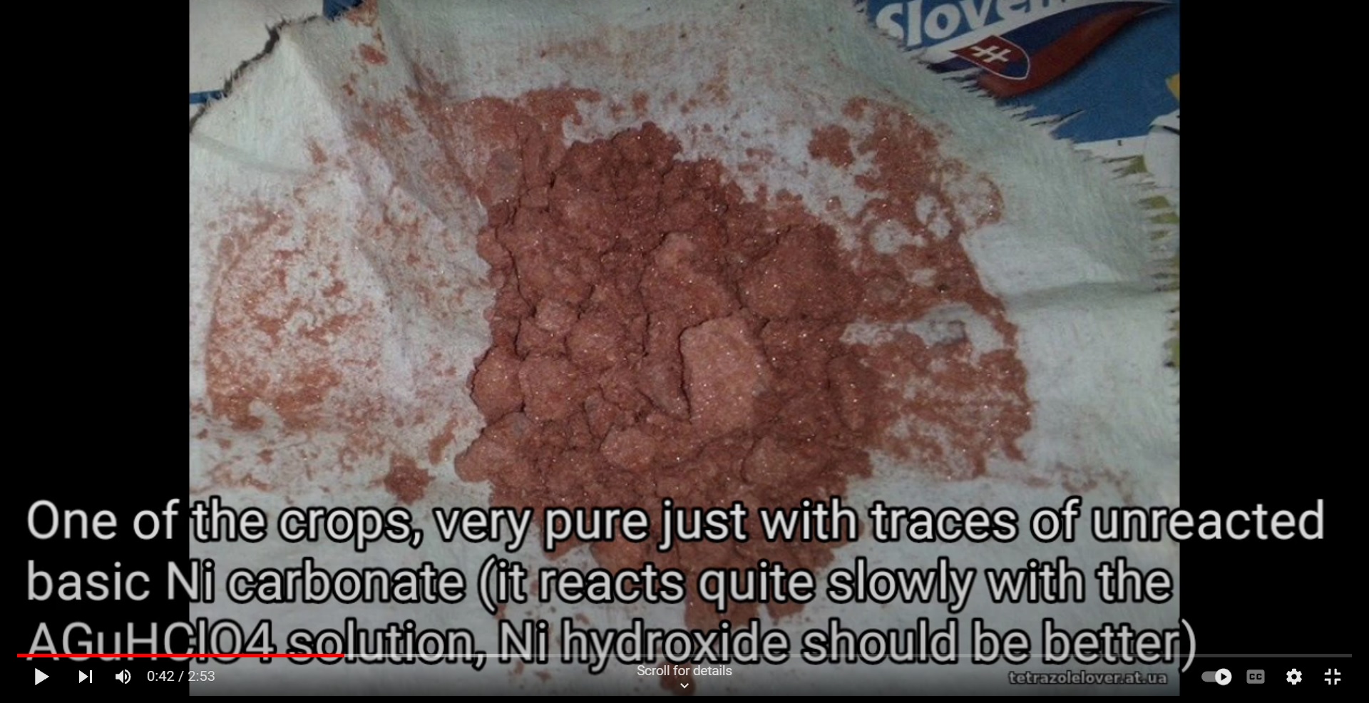

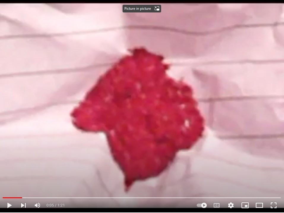

Is this color similar to what others are finding or is this color darker or lighter?
The only other colors Ive seen for comparison are the videos from energetic heretic aka tetrazole lover. Its hard to tell what saturation of hue he is getting. He has one picture that looks crazy red.

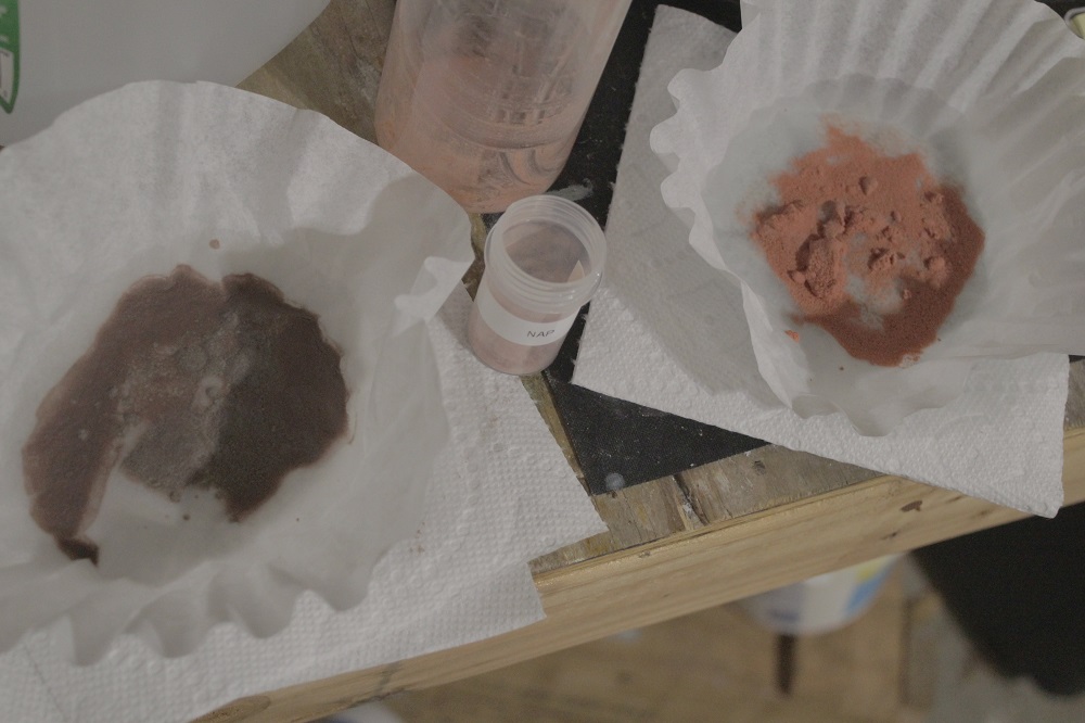

UPDATE:
Its now the next morning and the samples have been dried. I tried burn tests of the samples. Again, I was surprised. The nice red color sample burns unconfined by flame underneath. It turns black. It does not deflagrate or detonate. I'm a bit puzzled as to what is going on here. Direct hot ember doesnt burn it either.
The less homogenous brown/black material from 91% isopropanol detonates ferociously in mg proportions without confinement. And also detonates confined, which is logical.
I dont know what happened. I assumed for granted the red material was very pure and the black material was contaminated. I assumed the black material would probably have performance issues. The experimental case was opposite. The black material DDT so powerfully. I think it is more brissant than samples previously made by patent instruction. It is much more powerful than SADS or lead azide. I could feel the pressure energy in my skin from a few feet away. And that is only from a small pinch. Incredible stuff.

I attempted to scale up the isopropanol method, using an equal ration of solvent but increased all portions from patent to 3x. I got a red paste this time with less isopropanol boiling off at boil. Im going to first see if this batch high-orders then try to replicate a brown/black version again, test a couple variations until I find consistency that is highest yielding and high power. Will follow up.
_MG_9540.jpg - 194kB IMG_9547.jpg - 131kB IMG_9551.jpg - 124kB IMG_9557.jpg - 144kB

The colours that you are getting look ver close to what I have observed when doing this synthesis. I can also confirm that I get crystals coming out of solution as soon as it starts to cool down. In fact I have noticed that yield seems to decrease if you leave it the suggested 4 hours. I generally filter as soon as it has cooled to about room temperature. Looking forward to seeing how you go with the isopropanol.

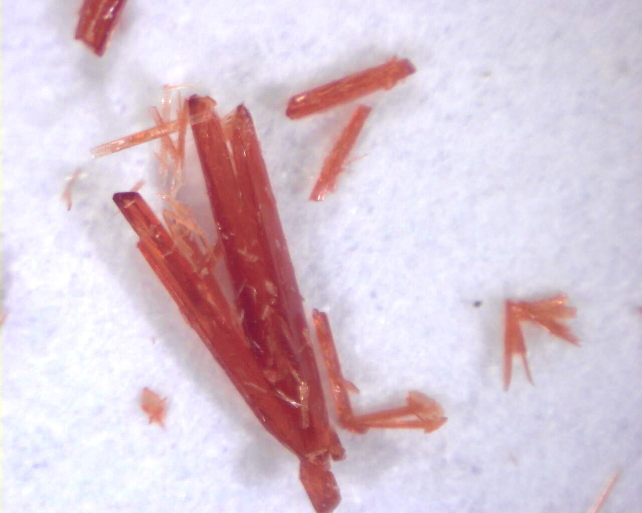

IMG_0764.jpg - 594kB
I've been experimenting with methods of production of NAP. My interest has been to simplify its preparation and understand it's character further.
I am happy to say that this material has a lot of variation in its product and that isn't a detraction but a strength. It's possible to modify sensitivity somewhat depending on purity, form etc.
I have found a route which prepares very high purity NAP in high yield. The nickel ion source is nickel carbonate and the perchlorate source is ammonium perchlorate.
In my opinion, this route prepares the purest form of NAP other than using HClO4 directly. The added bonus is that with this route, each respective material can be simply purchased and mixed in correct stoichiometry as needed.
Without capping agents or crystal modifications, this method produces entirely high purity, Blood-red, needle-shaped crystals. These crystals seem to be more sensitive than other forms. This is opposed to NAP derived from Ni(ClO4)2*6H2O. which seems somewhat different in product. This also differs entirely from Ni(ClO4)2 produced from NH4ClO4 or KClO4.

I'm curious for a proper writeup, since if you have NiCO3, you can make the acetate from it directly and use the preparation via that. It will be interesting what gives a higher yield (and especially if some reagent has to be in excess).
These microscope images are old, but still fairly pretty:
NiAGuPerc_.jpg - 5MB PIC018_cc.jpg - 387kB PIC019_cc.jpg - 346kB PIC021_cc.jpg - 361kB
The corresponding nitrate has a totally different crystal morphology, and the sulfate on account of being quite insoluble in water doesn't form good crystals at all. It would be nice to find a salt that is as pretty and crystalline as the perchlorate, but without being energetic - it would make for a good beginner friendly experiment in coordination chemistry.

You can avoid the formation of long needle crystals (which, while pretty, are less safe and more difficult to process) by maintaining stirring throughout the precipitation phase. It's probably possible to tweak the morphology by adjusting the RPM of the stirrer.
Hey Buddy
Posts: 444
Registered: 3-11-2020
Location: Bushwhacker Country
[*] posted on 11-5-2023 at 07:28
I saw that you mentioned this earlier in the thread and can confirm. RPM adjustment on cooling does change crystal size. At 200 rpm Im finding about the same size as with IPA.

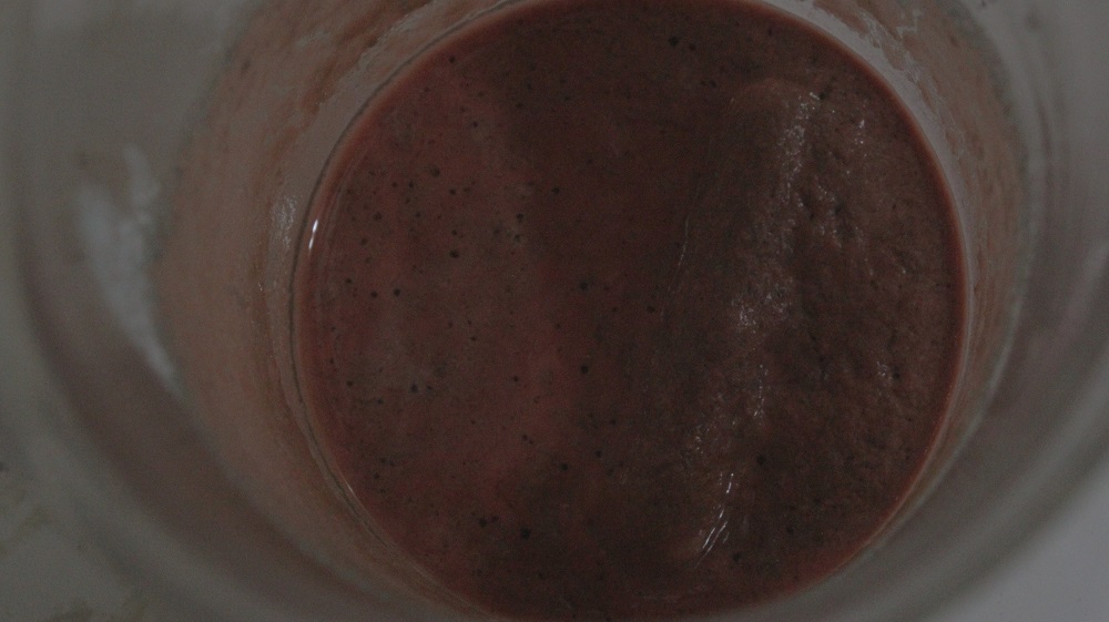

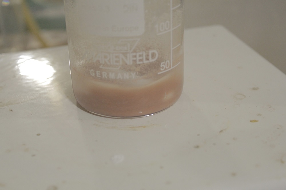

I've tried some different crystal modifications:
-Propylene Glycol solvent: reacts with complex, red/brown syrup results.
-CMC: prevents complexation
-Dextrin: prevents complexation
-CMC: added after complexation, diminishes yield, impractical, short blocky crystals
-Dextrin: added after complexation, diminishes yield, long needle crystals are still formed
-Isopropanol solvent 90%: changes time of boil of reaction, lower boiling point, longer reaction time, complex crystallizes as a paste/powder with a lighter salmon color, apparent reduction in mechanical sensitivity
IPA yields are about +40% over H2O solvent. Beginning with a 1 g AGu reaction, H2O results .97 g, IPA results in 1.38 g
There is always green nickel remaining in filter after reacting stoichiometrically in H2O, IPA appears to leave less Ni in filter. Ni may benefit from reduction to less than stoichiometric in order to reduce unreacted Ni in product.
