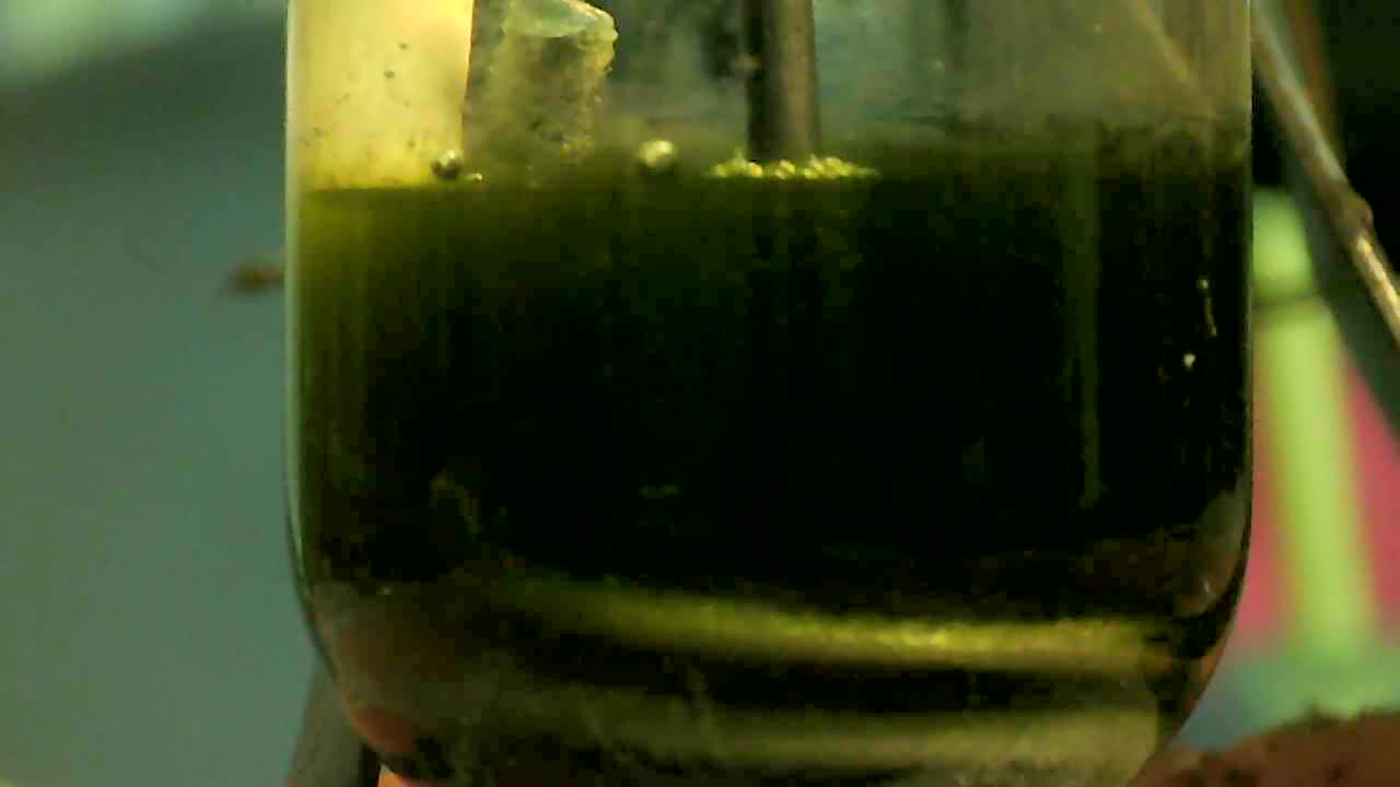

Nickel electrode +, 2 graphite electrodes -.
Initial test of conductivity is good; the Boric acid's oxygen + alcohol, does cause the glacial acetic acid to become conductive.
5 mA current flows. I can see nickel haze forming slowly in the first half hour of operation.
Solution is rapidly greening, which suggests the alcohol + Boric acid might be abnormally breaking the dimmer bonds and increasing the exposure of free acetic acid to the nickel. ( It's not the boric acid, alcohol, by itself which is conducting the current; as the color is not green. )

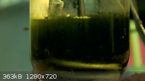

vlcsnap-2023-12-04-17h32m29s533.png - 679kB
This appears, even within three hours of starting, to be a successful plate; although it is bubbling hydrogen out at the cathodes.
There is un-evenness in the nickel plating; but that is normal when hydrogen gas is bubbling off the cathode. I'll have to wait to see if the hydrogen ever stops bubbling or not.

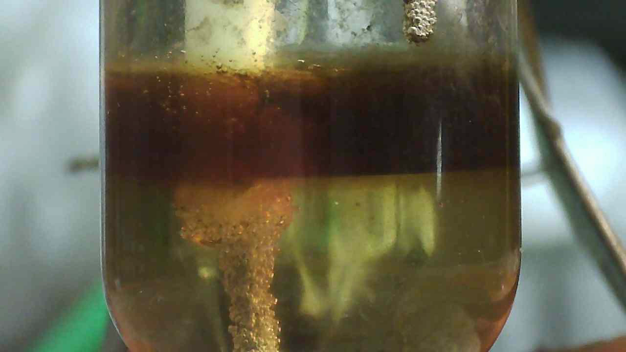

vlcsnap-2024-02-29-13h40m24s391.png - 523kB
I can see a little discoloration of the nickel anode; so perhaps there is some solid reaction product possible, too. EDIT: No, it was just pitting. The nickel is clean.
From studying acetone, I think that the alcohol/enol form of the chemical is less stable than the ketone form. I would suspect that this makes hydrogen evolution harder, since a more stable alpha hydrogen needs to be displaced before an enol can be formed. I hope this will make acetone more willing to give up complexed metal ions.
But: The hydrogen can be displaced/removed from the Enol form, and should allow acetone to chemically react with nickel: either one or two molecules per nickel ion:
I suspect: [ C3H5O- ]2 [Ni++] (I am open to suggestions, or corrections; recall, I'm an amateur at best. )
I think: Positively charged nickel ions, then, can be complexed by acetone and/or form a salt with an acetone, enol tautomer, molecule.
I find it surprising that no sign of plating occurs with this solution even after hydrogen evolution stops. I'll clean the anode, and wait until the second dose of acetone (+14 drops) stops evolving hydrogen.
This brings the acetone content up to around 50% of the solvent volume.
bubbling stopped several hours after re-starting and conductivity dropped to the micro-amp region. There's no way that all the acetone reacted, so it seems to me that the yellow/green product might be suppressing further ionization of the acetone.

vlcsnap-2024-03-04-14h35m02s213.png - 490kB
There is much less bubbling this time around. I think this experiment is going to be successful. I need to figure out how much epsom salt is needed for a given amount of glacial acetic acid in order to make a final solution with minimum colloidal solids remaining. I think it's an optimization problem. Cool!
After 48Hours, pretty much the only place bubbles come from is the contact point between the graphite and the epsom salt. Bubbles are hardly forming (at all) in the liquid areas on the visible part of the graphite electrode. The current level has dropped, considerably, though. From 10mA yesterday, down to 2mA today. I'm going to allow it to run at 2mA for a full day and see if the plating properties change.
This picture a fresh electrode, that has been electroplating for 20 minutes at 2mA.
vlcsnap-2024-03-05-13h52m13s999.png - 427kB
You can see: The liquid is still electroplating even in places where bubbles are not being formed, and the color of the deposit is about the same as at the start of the experiment.
It's not a normal nickel/silverly color, but is tinted salmon pink to brownish as if some copper were alloyed with it.
This is a bit puzzling. Nickel sulfate is bluish, Nickel acetate is greenish, and neither of these colors are showing as a tarnish on the plated metal;
There's likely a tiny bit of contamination metal in 1CC's worth of epsom salt. eg: But only something like 0.01%. That should have already deposited out by now!
I would expect to be getting a nickel plate at this point.
It makes me wonder if I've got some kind of magnesium-nickel alloy plating, or maybe a basic hydroxide. I'm not sure what color those would give. Google(TM) searches don't help much.
[Edited on 5-3-2024 by semiconductive]

[*] posted on 6-3-2024 at 10:03
Experiment completed: The color does slowly change to silvery nickel as the reaction proceeds. The current continnues to drop as the reaction proceeds; after 96 hours, it was stable at 1.8 mA (regardless of voltage applied.)
I think this means that the ionization process with acetate/MgSO4 is pretty close to independent of temperature and voltage.
The reaction is too slow to do electro-forming, or thick nickel plating. It could only be used to make a thin surface coating of nickel. But, it does work.
Noticeably, the MgSO4 prevents glacial acetic acid from becoming emerald green and absorbing a large amount of Nickel. But, it also increases the percentage of Nickel that plates from solution per coulomb. This suggests that like pH problems in water, that the concentration of Mg ions will affect the plating quality and rate, significantly.

vlcsnap-2024-03-11-13h41m40s933.png - 503kB
Obviously a crystalline precipitate is sticking to the electrode (-), this March 11th,2024 morning. No signs of Nickel plating Metal.
The line of material that was greenish in color, 48 hours ago, is still green but it looks like it's darkened (concentrated) a lot. Compare the pictures. I'm puzzled.
Conductivity has dropped, It was only 100 uA, this morning. As I cleaned the electrode, scraping off a hard crystaline deposit / perhaps an oxide/hydroxide, I notice that the epsom salt continues to bubble even without the electrode present.
After cleaning, reinsertion of the electrode shows 0 uA current (immeasurably small.). Bubbles resume forming on the graphite electrode, though, so there is a current at least in the liquid if not in the attaching wire.
I'm really not sure what to think about this experiment.
It's only a small deviation from the previous experiment, but it seems a total failure.
Oh, one detail. Propionic acid wouldn't evaporate in these conditions, but the liquid film is not visible. The current loss may be due to absence of liquid solvent. I'll add a few drops (7) more propionic, and see if any change.
edit: +7 drops, still couldn't see film; it seems to mix with the kerosene a little too easily/abnormally. Added +8 drops more, then gave up. I can see diffraction swirling in the kerosene, so maybe propionic acid will settle out in a few hours.
I checked the nickel anode; it had completely dissolved below the epsom salt layer.
I replaced it with a new piece of nickel; current resumes at 400 uA.
Edit 2:
Conductivity dropped again over a period of hours, no settling of the propionic acid is visible. I took a glass stir rod, and tried to stir the epsom salt dust, but it had aggregated. It was hardest near the graphite electrode, and softest near the nickel source. I pressed down hard, and was able to break it up again. Current rose to 4mA for a while, and then dropped back down to about 2mA.
I don't know if it's thermally induced, or a chemical reaction near the graphite; but on the glass, on the graphite, anywhere near the cathode; crystals seem to grow rapidly in response to electric current flowing.
After breaking up the salt with a glass stir rod, I could see a meniscus about 2mm above the salt form. So the propionic acid is separating out now that I've homogenized the epsom salt (again.). It's hard to see in photo, but above the meniscus uniformly across the test tube is a haze of crystals in the kerosene sticking to the glass. Just below that; Where the propionic acid accumulates, the crystalline dust mostly washes off glass.
vlcsnap-2024-03-11-19h41m43s380.png - 437kB
vlcsnap-2024-03-11-21h35m53s899.png - 451kB
Note: I did not shake or stir the test tube between these two photos. They are with an hour or two of each other. The bubbles inside the epsom salt of the upper photo have expanded and knocked the salt around. Gas forms inside the salt, near the electrode. I suppose the earlier photos of the dark band, might be a channel where tiny gas bubbles formed and it's shape is just a matter of random luck.
The color is lightening, slowly, in the salt. That would suggest either dissolving of the darker green nickel formate from before, or a chemical reaction of some kind. The current level is staying low, so I think it's more likely a reaction than dissolution of a conductive salt. Hmmm... it's not headed in the correct direction to ever plate.

I've waited long enough to exhaust the 7 drops of formic acid that I added. After a week of electrolysis, there is no more of the green lines forming in the powder. The powder has an aqua-marine, or jade hue. Occasionally, a very dark green powder will form on the anode; but after shaking or stirring the powder, it re-dissolves.
vlcsnap-2024-03-17-12h00m11s569.png - 478kB
You'll notice that the propionic acid has a greenish hue (looks golden yellow when viewed with eyes.) So, something is now dissolving into the propionic acid which was clear in all the earlier photographs. But: The reaction/solution does not appear to be stable, as I can see color changes in the solution which will precede different kinds of plating activity.
Yesterday night 12 hours ago, there was a silvery black deposit forming on the electrode. It was partially metallic. But, then the solution's color changed and it rapidly began forming crystals of the epsom salt/nickel formate. It's as if the solution turned slightly colloidal, and electroplating causes particles floating in the solution to adhere/precipitate on the cathode and (also) to the glass of the test-tube near the cathode. It's electrically induced crystallization.
This is a very interesting experiment. The conductivity does not drop to zero when the acid charge is basically depleted. Each time I add an acid charge, there is more conductivity after the formic acid is used up. The first time conductivity dropped to 500uA; The second time conductivity dropped to 2mA; and after this last charge of 7 formic acid drops -- the current drops to 3 to 4mA. (3 with crystals on electrode, 4 when electrode is clean.)
I'll see how much nickel I can get to dissolve into the solution and epsom salt, will post results below. I think nickel salts (double salts, perhaps?) are increasing the conductivity. Propioninc acid isn't conductive by itself, but it does appear to dissolve nickel formate / nickel sulfate / whatever I have in there. :)

Then I added 1 CC kerosene, as an inert cover layer in the test-tube.
Since dissolving KOH is a problem, and tends to leave chunks and solidify during electrolysis; I decided to use a few drops of formic acid, to bring the bulk of the potassium into a liquid solution. I figure that the water formed, and possibly the K+formate, can be removed by electrolysis.
I heated and stirred, and slowly added just enough formic acid (drop by drop) to cause almost all the KOH to dissolve, but leaving a trace of it.
Then I added a few drops of poloxamer-124. This is much less dense than the potassium/diol/formate solution and slightly soluble in kerosene. I was hoping it would mostly float between the kerosene and alkoxide mix; it does (very well!)
Then I placed a graphite cathode, with an insulating sleeve except for the very tip, into contact with the diol/KOH solution; and I placed an anode *above* the poloxamer 124 layer by about 0.5 mm. This is close enough that ions in the poloxamer will penetrate the kerosene and hit the anode. The anions then electrolyse to release oxygen (from water). I think formate ought to turn into some kind of gas (An alkene or CO2, Kolbe electrolysis; this is not an acidic electrolyte, but it's CO2 when acid as shown by Woelen: https://woelen.homescience.net/science/chem/exps/precision_e... ).
This result appears to be 4x (or more) gas bubbles at the cathode compared to the gas at the anode.
As the reaction proceeds, the slight brownish color in the KOH/diol layer migrates *up* into the poloxamer 124 layer.
This does clarify the KOH/diol layer. Heating the glass test-tube with a soldering iron speeds up the color migration and clarification a lot. It doesn't cause re-browning, either.
I've run it for 24 hours, and the KOH/diol layer is very nearly clear; with the poloxamer layer increased in width (about double original) and turning medium brown. It's a very successful separation. This should (I'm hoping), allow a build up of alkoxide at the bottom of the test tube.
vlcsnap-2024-05-24-12h09m04s295.png - 510kB
I'll allow this to continue to run; and see how it proceeds.
The current is resistor limited to roughly 30mA or less.
[Edited on 24-5-2024 by semiconductive]

Experiment #510; postlog.
The use of poloxamer to separate our darkening electrolysis impurities during the addition of KOH, works reasonably well.
Electroysis of the resulting mixture for about a week with a graphite anonde, caused the solution to become a very light amber color which could not be removed by more poloxamer. Still, the solution is clear enough to see the effects going on, which was my goal. The graphite electrode was oxidized at the tip, and I suspect this is the source of the amber darkening that poloxamer could not remove.
I switched to a nickel anode and attempted plating for a week. The solution turned green, slowly, which suggests that Ni + a di propyl alcohol, or potassium makes this color.
No metal plating was observed (at all). But, there was a continuous whitish crystalline formation on the electrode. Conductivity slowly dropped over a period of a week.
I wonder if this could be K2O, since I'm destroying water; and I would have expected nickel to remain green. Anyway, it's run nearly to exhaustion, and the green is strong enough that it's getting difficult to see the electrode; I could add ester and centerfuge in order to make it transparent enough to watch again; but the conductivity would be very low and there's no sign of metal deposit which I would have expected by now; so I'll give up.
vlcsnap-2024-06-10-20h19m36s674.png - 363kB
bnull
Posts: 995
Registered: 15-1-2024
Location: East Woods
Mood: Fecking annoyed
[*] posted on 11-6-2024 at 13:55
Your persistence (and curiosity, of course) amazes me.
Quote: Originally posted by semiconductive
But; most solutions turn super dark brown or black during the process. I tried 1,3 propane-diol, glycerol, and di-propyl-diol (food grade, O bond in center.). All of them turn brown (or reddish-brown) during electrolysis.
About 10 years ago, I tried to plate copper from a complex copper-glycerol-sodium hydroxide using lead and copper electrodes. Instead of a nice coat of copper, what I got was a brick-red sludge of cuprous oxide that smelled funny. I'm not sure what it was (I didn't research) but reminded me of cookies.
One solvent that you can try, if you haven't tried it yet, is molten urea. A large number of salts is soluble in urea slightly above its melting point (~130 °C, see attached paper).
Attachment: R. E. D. Clark - Urea as Solvent.pdf (353kB)
This file has been downloaded 365 times
Edit: I forgot to mention that I had tested copper oxide in molten urea two months ago. Copper oxide dissolves with a slight fizz and the solution turns blue. The conductivity is good enough to allow plating.
[Edited on 11-6-2024 by bnull]
