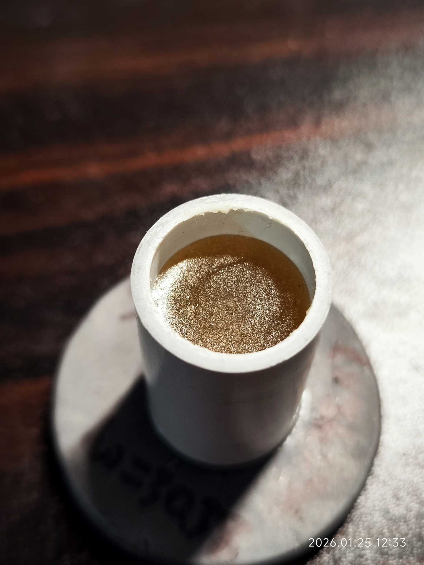

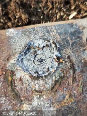

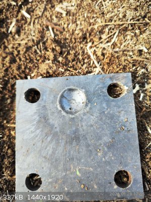

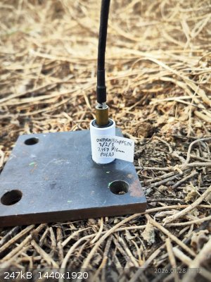

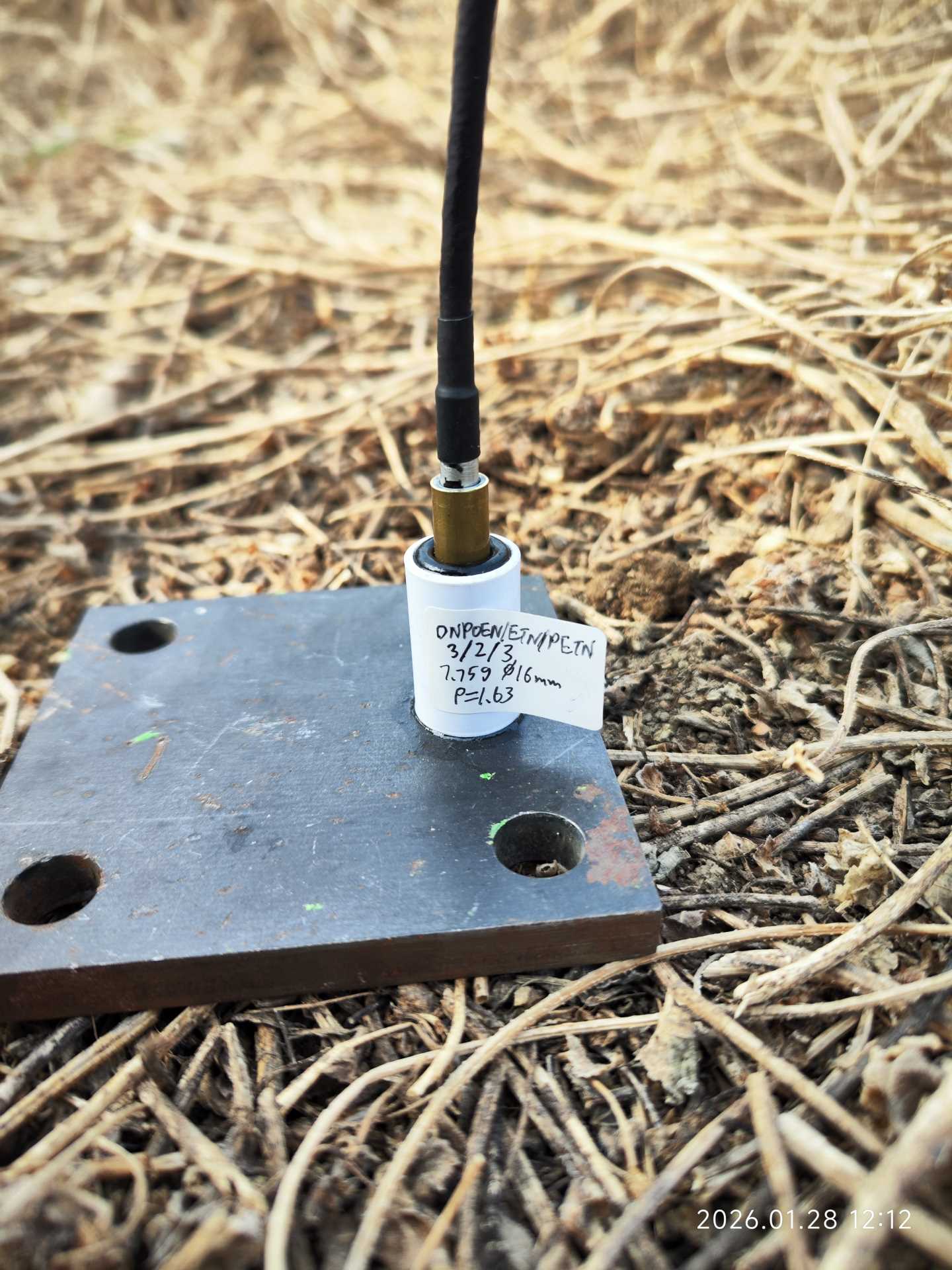

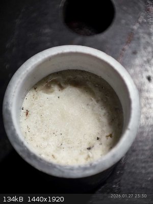

Several casting mixtures containing DNPOEN tested.
First is the DNPOEN/ETN/PETN (3/2/3) mixture.
This mixture completely liquefies upon heating with steam, and the PETN dissolves completely. It has the lowest possible viscosity.
However, it solidifies very slowly, requiring at least two full days to fully solidify, which is perhaps a common problem with low-melting-point nitrate ester mixtures.
Attachment: VID_20260311_235009.mp4 (1.6MB)
This file has been downloaded 27 times
DNPOEN-ETN-PETN 3-2-3.jpg - 119kBDNPOEN-ETN-PETN 3-2-3 (2).jpg - 134kBDNPOEN-ETN-PETN 3-2-3 (3).jpg - 247kBIMG_20260128_123537.jpg - 337kBIMG_20260128_123613.jpg - 403kB
Attachment: VID_20260128_124025 00_00_00-00_00_04.mp4 (1.4MB)
This file has been downloaded 24 times

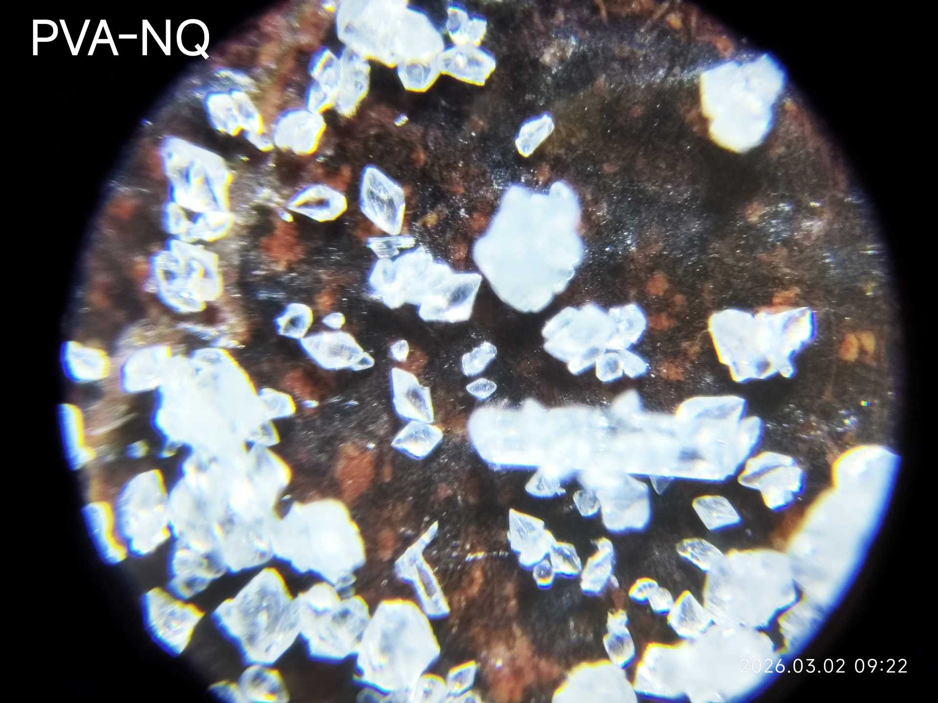

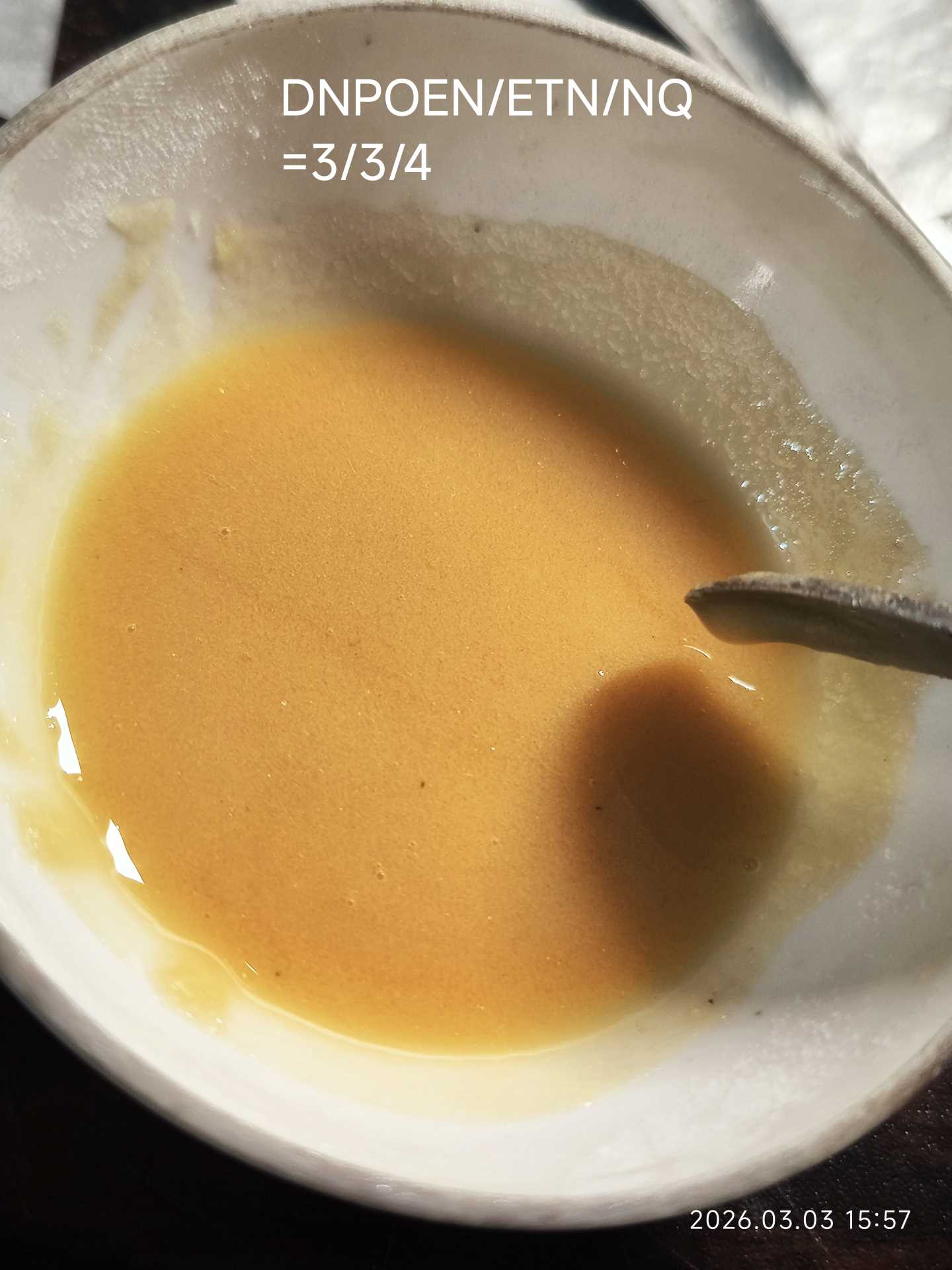

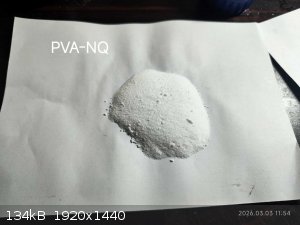

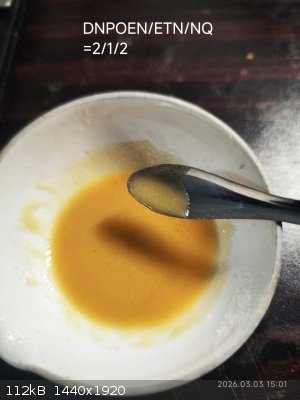

So I thought of adding solid components that cannot be dissolved in it, as these solid powders would help speed up the solidification process.
NQ recrystallized from PVA solution is indeed a good choice, as it possesses a high free packing density. Furthermore, it exhibits good compatibility with nitrate esters and does not compromise overall stability.
However, both NQ and DNPOEN are relatively insensitive explosives. If only these two components are used, initiation will become difficult, and a large amount of explosive would be needed to reach the critical diameter for detonation. I believe this is not practical.
Therefore, I believe it is necessary to add some sensitive substances, such as ETN. This would significantly reduce the critical diameter of the fused mixture, making it applicable in more situations.

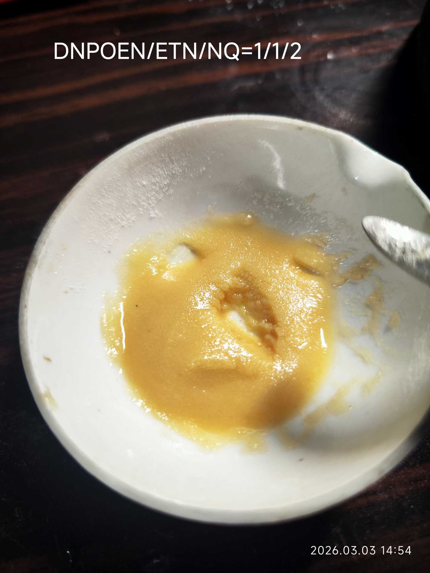

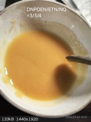

The following are liquidity tests for several different ratios of DNPOEN/ETN/NQ.
IMG_20260302_092245.jpg - 180kB IMG_20260303_115508.jpg - 134kB IMG_20260303_160843.jpg - 112kB IMG_20260303_161038.jpg - 133kB IMG_20260303_160446.jpg - 122kB IMG_20260303_160518.jpg - 130kB IMG_20260310_130624.jpg - 114kB
Attachment: VID_20260303_160647.mp4 (1.2MB)

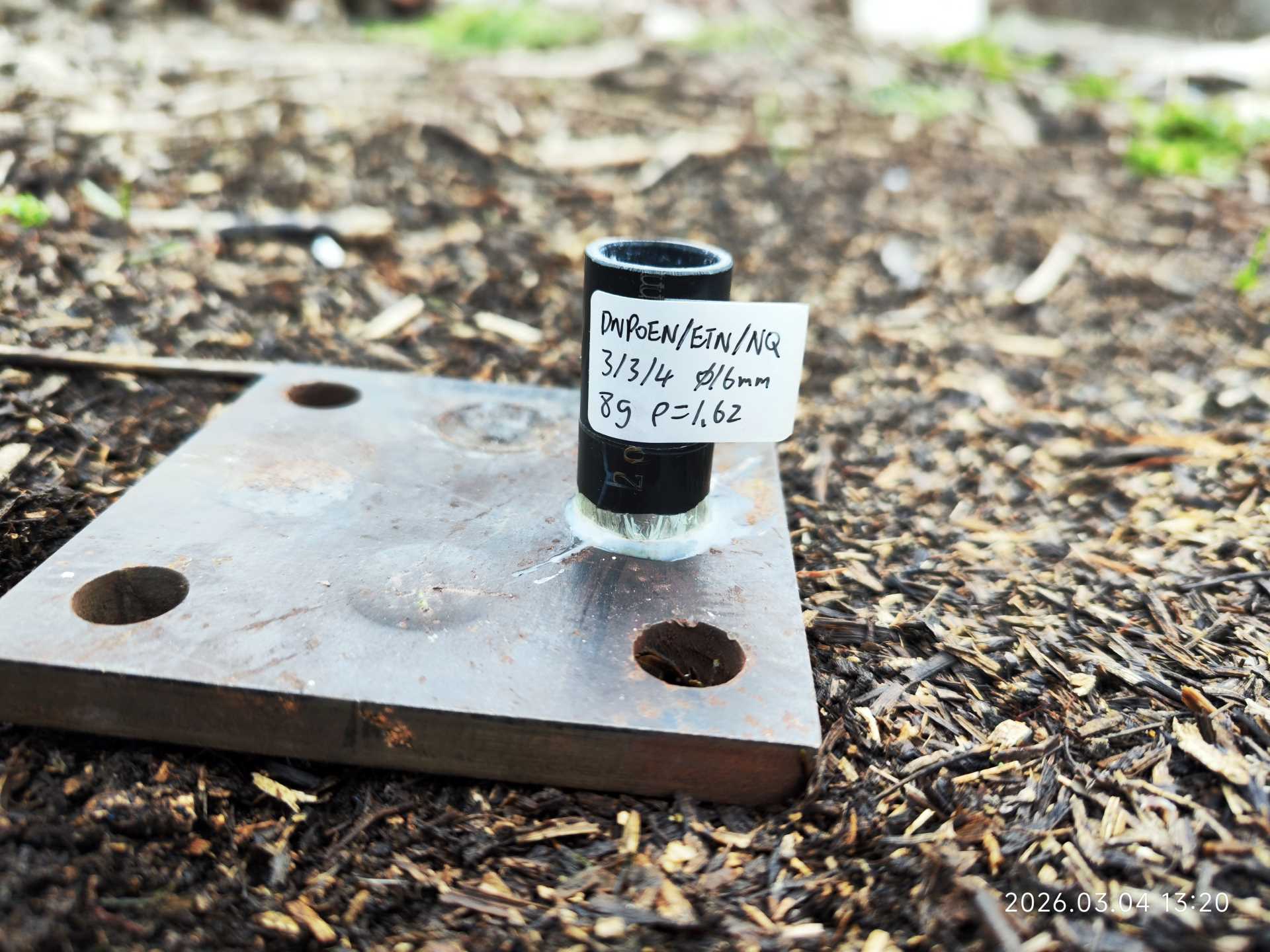

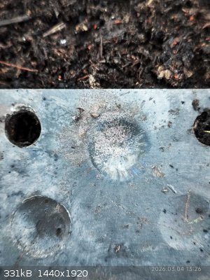

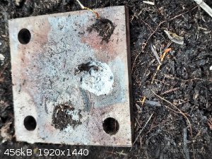

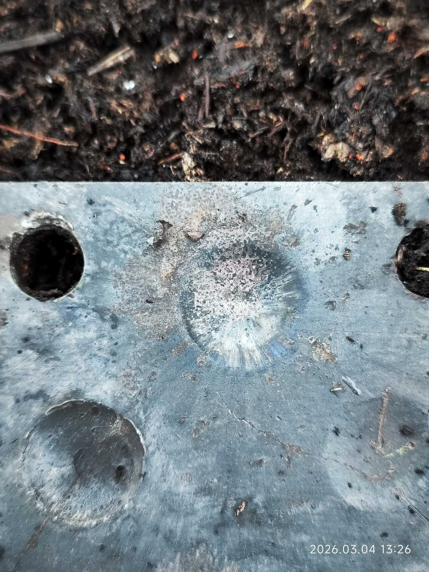

[*] posted on 12-3-2026 at 11:08

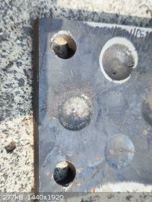

It appears that they can be started and function normally with 0.6g of etn at a density of 1.55.
DNPOEN/ETN/NQ=3/3/4
IMG_20260304_132012.jpg - 232kBIMG_20260304_132647.jpg - 331kBIMG_20260304_132701.jpg - 456kB
Attachment: VID_20260304_133242.mp4 (1.1MB)
This file has been downloaded 25 times

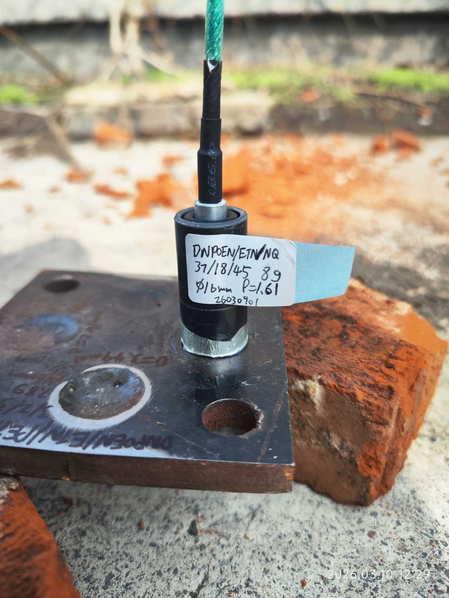

[*] posted on 12-3-2026 at 15:25

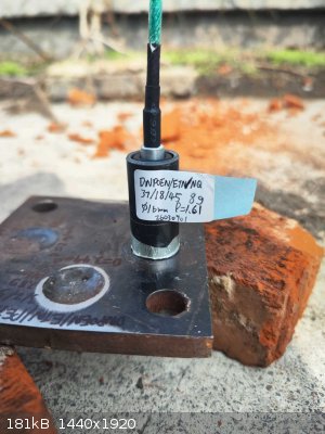

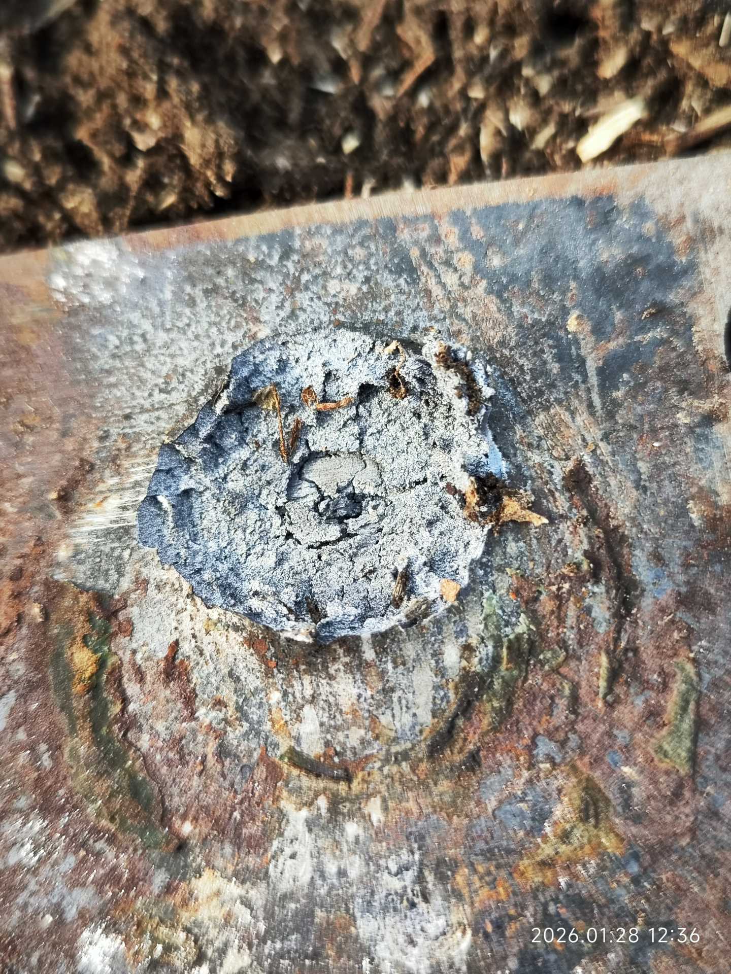

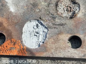

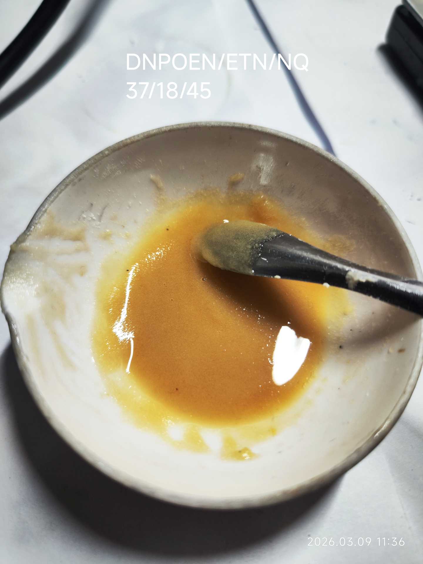

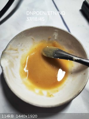

DNPOEN/ETN/NQ=37/18/45
IMG_20260310_122952.jpg - 181kBIMG_20260310_123238.jpg - 277kBIMG_20260310_125907.jpg - 382kB
Attachment: VID_20260310_123446.mp4 (1.1MB)
This file has been downloaded 23 times
KFeNAT
Posts: 29
Registered: 27-5-2025

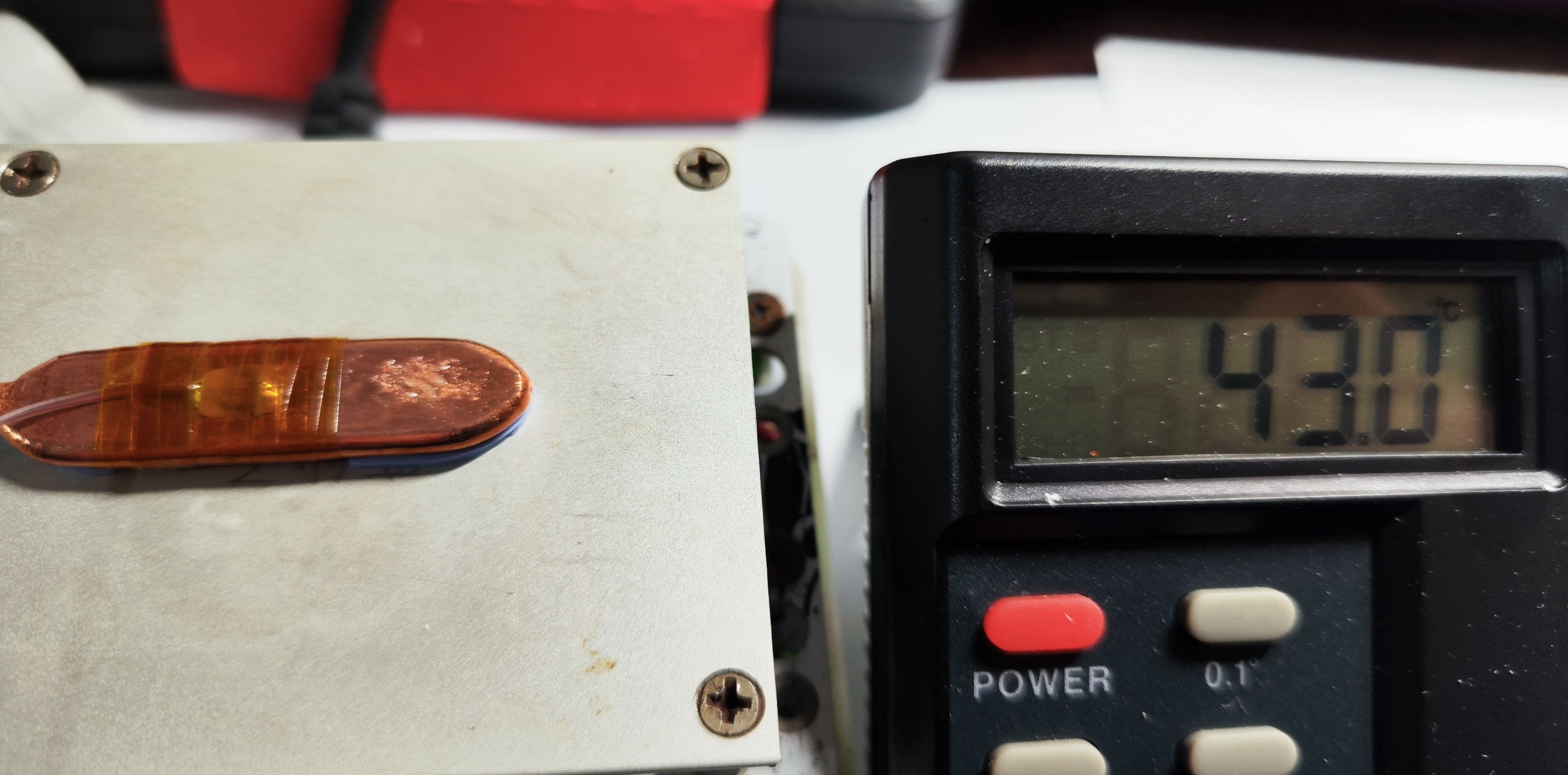

[*] posted on 12-3-2026 at 19:09

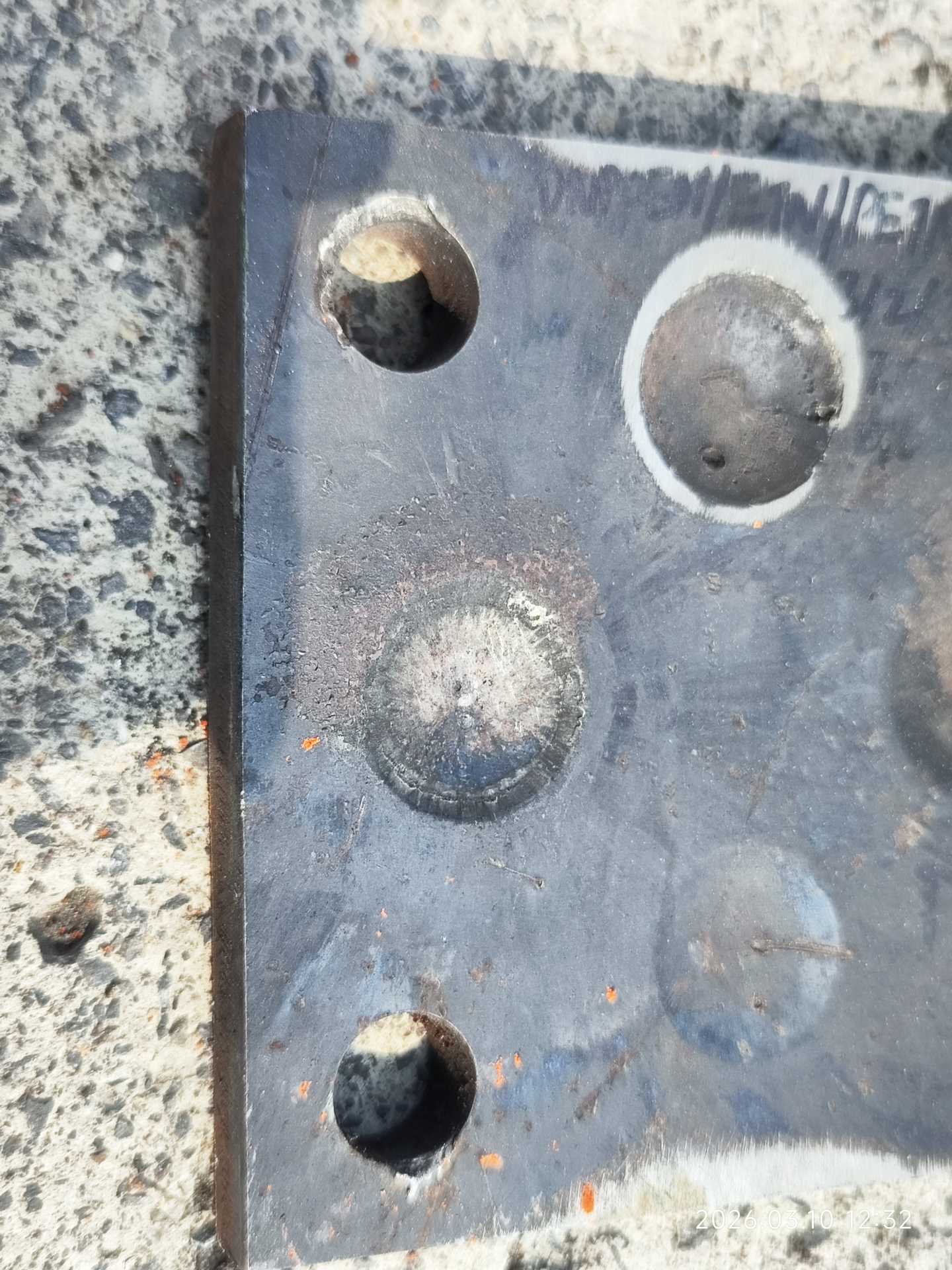

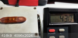

Some simple conclusions
1. The maximum NQ content is 45%. When it reaches 50%, the fluidity of the melt mixture becomes very poor, making it difficult to pour from the container.
2. At the same NQ content of 40%, the DNPOEN/ETN ratio has little effect on the melt fluidity.
3. The ambient temperature is approximately 10°C, and the melt is allowed to cool naturally after casting. With a DNPOEN/ETN/NQ ratio of 3/3/4, the time required for complete solidification is less than 24 hours.
By reducing the ETN content and increasing the NQ content (37/18/45), the time required for complete solidification is further reduced to less than 4 hours.
4. The steel plate is ordinary low-carbon steel (S235 or A36) with a thickness of 9.7 mm.
5. The 3/3/4 ratio mixture begins to melt at approximately 43°C.
1000065140.jpg - 912kB 1000065151.jpg - 416kB

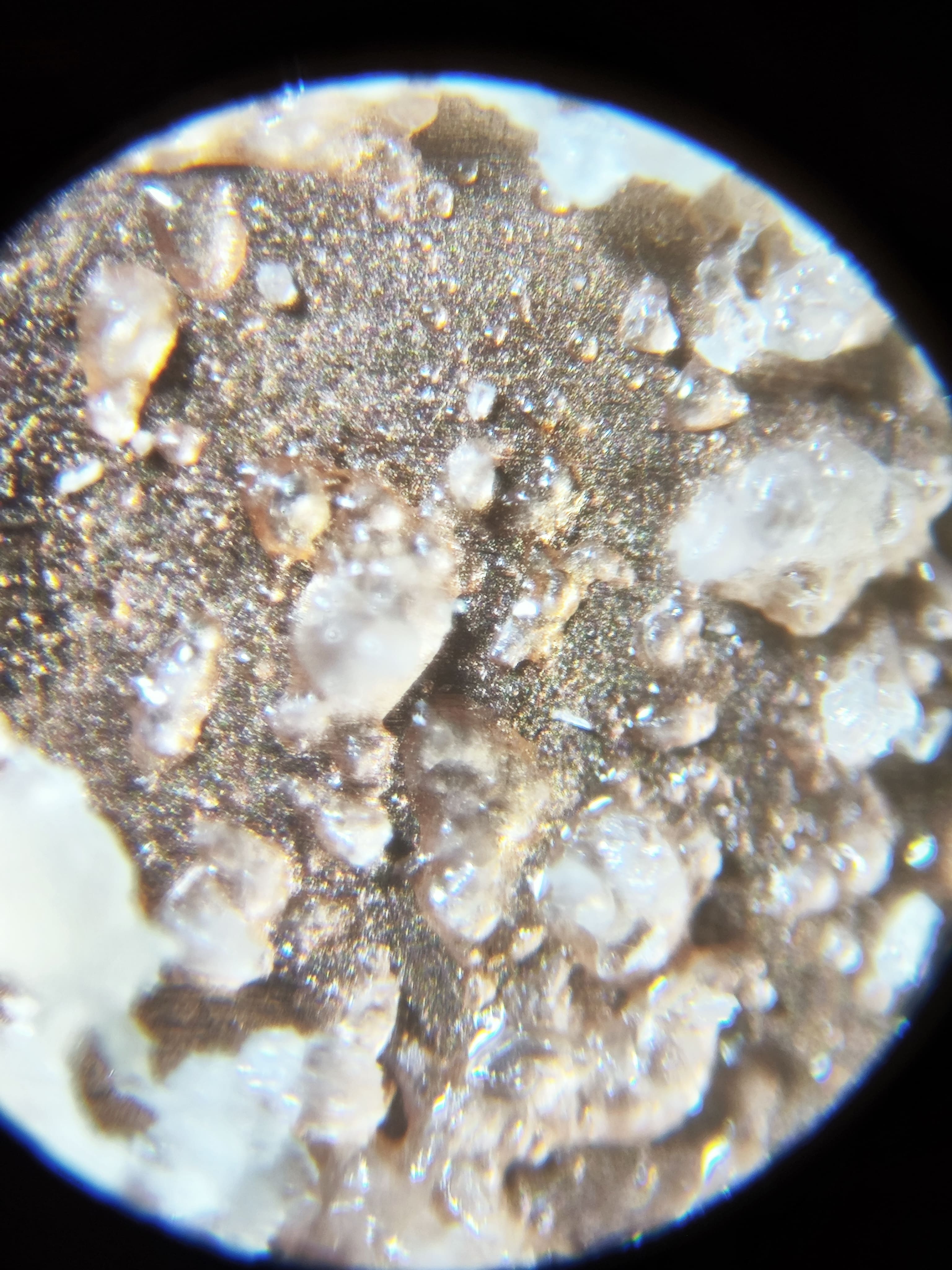

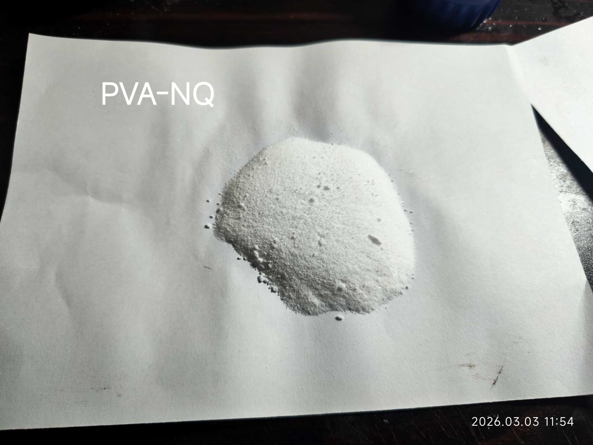

KFeNAT
Posts: 29

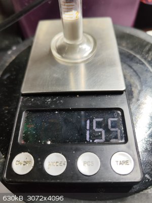

[*] posted on 18-3-2026 at 16:34
That's a neat composition KFeNAT, thankyou for the visuals.
Did your NQ recrystallisation vary much from the Chinese lit method? ie.
1 part NQ
14 part water with 0.01-0.10 % PVA (poly ~1750)
Boil to dissolve
Adjust pH to 8 with ammonia solution
Under stirring cool 0.1-0.5C per minute to 50C
Rapidly cool from 50C to 20C
Filter, rinse and dry at 65C.
Nominal density increased from 0.16 to 0.8-0.9g/cm3.

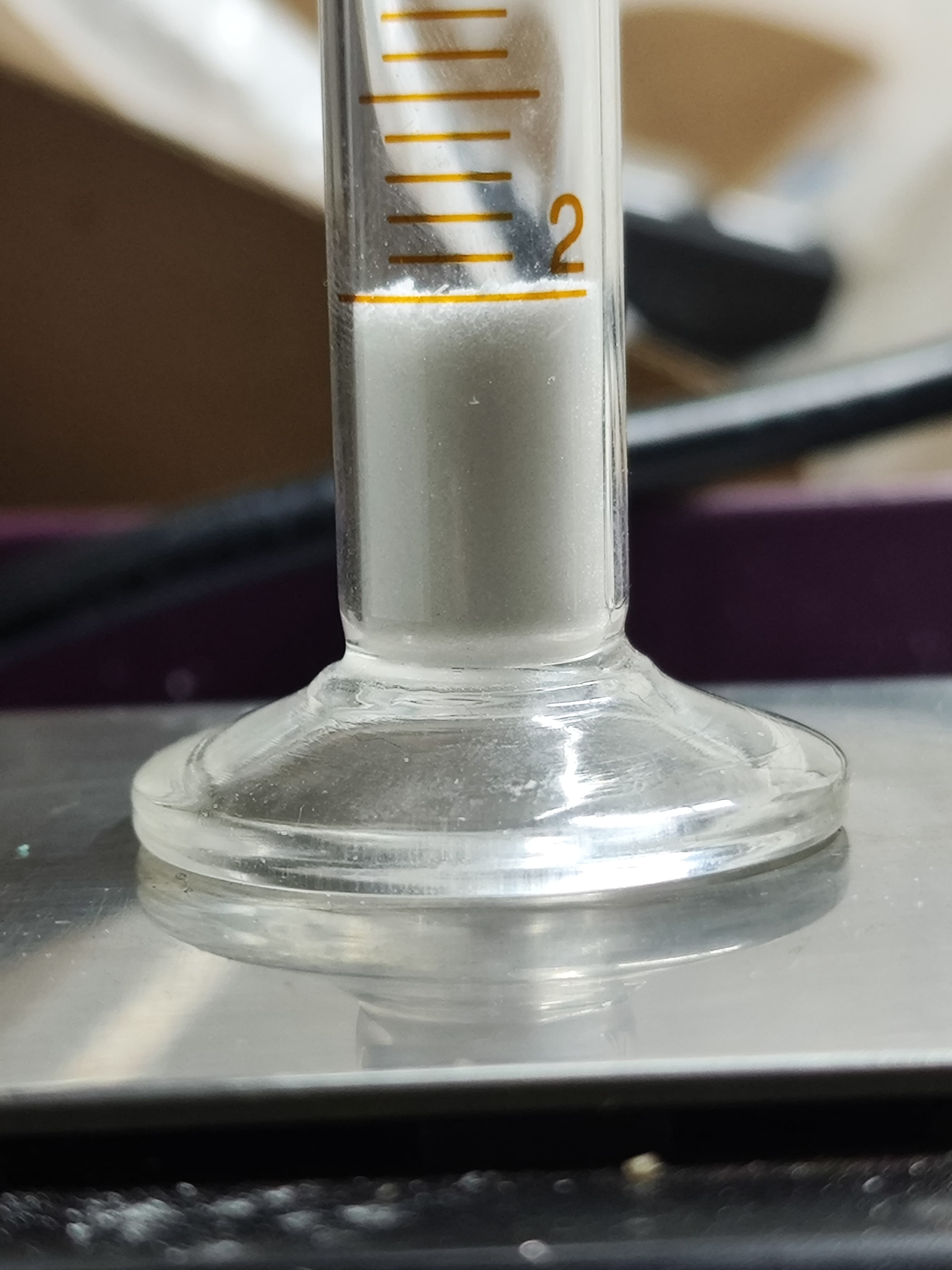

No, there is no significant difference; it is basically the same as this method, with only some differences in details.
1. I used PVA1788, but I don't think it will make a significant difference compared to 1750. In addition, 1750 dissolves in water faster and is easier to use.
2. I did not strictly control the cooling rate, but simply kept stirring and allowed the solution to cool and crystallize naturally at room temperature of about 10°C.
3. Using a small liquid graduated cylinder for rough measurement, the free bulk density of this product is approximately 0.77 g/cm³.
1000065283.jpg - 395kB 1000065282.jpg - 630kB
