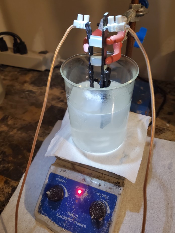

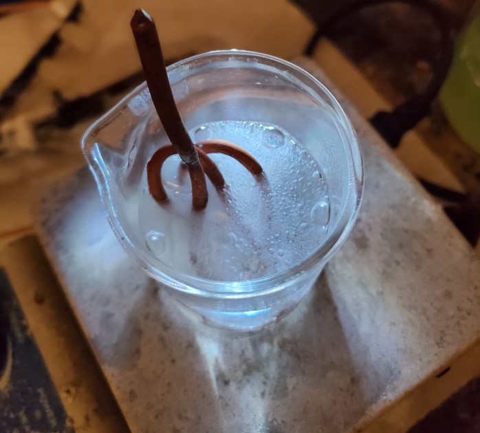

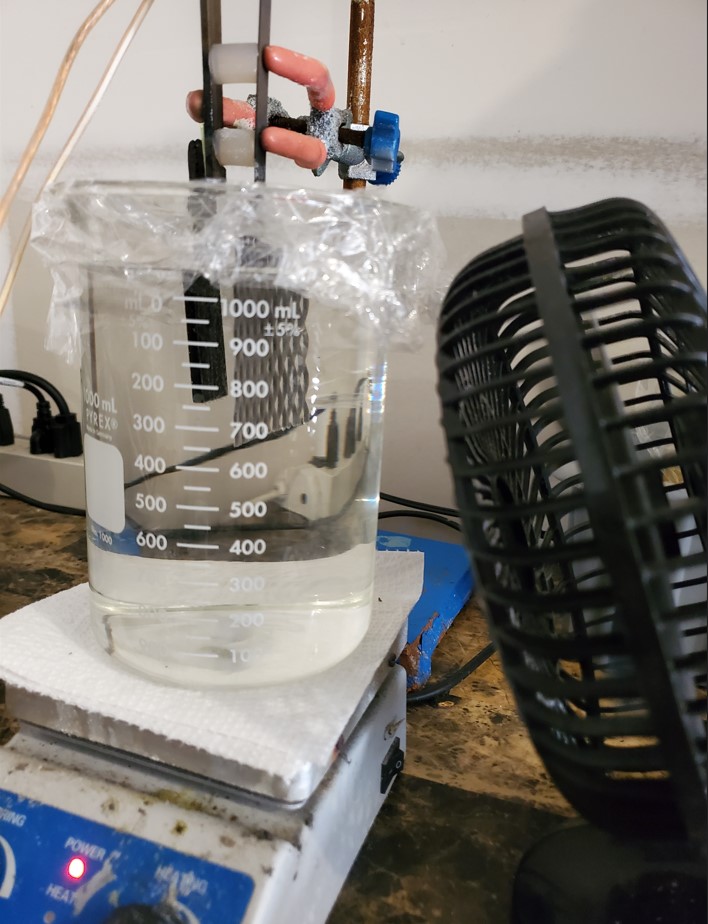

Experiment: Hydrogen Peroxide by Sulfuric Acid Electrolysis
Breathing some fresh air into this threat.
I prepared a ~50% H2SO4 solution and started electrolyzing.
Current: 3 [A]
Cathode: Titanium mesh
Anode: Boron Doped Diamond
Current Density on Anode: ~250 [mA/cm^2]
Here some pictures:

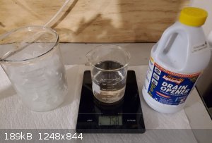

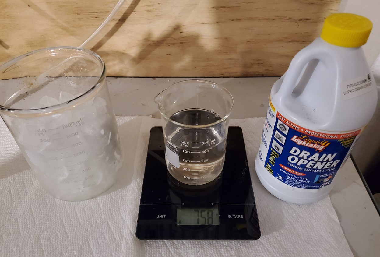

720g ice cubes & 750g H2SO4 (Drain Cleaner):
Acid.jpg - 189kB

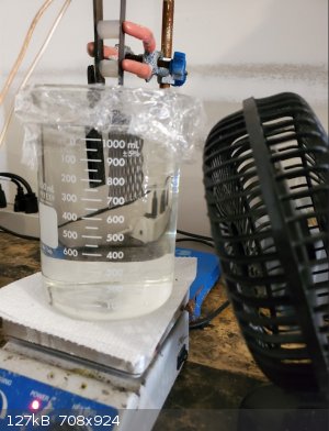

The setup:
Setup.jpg - 127kB

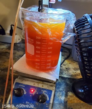

Electrolysis after 2 hours:
After 2 Hours.jpg - 154kB

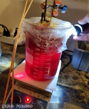

Electrolysis after 12 hours:
After 12 Hours.jpg - 132kB
I was not expecting to see any colors in this experiment. Because of this I assumed that the H2SO4 was contaminated, and I distilled the whole batch.
I also reduced the amount of water in the acid a little, so it should now have ~55%.

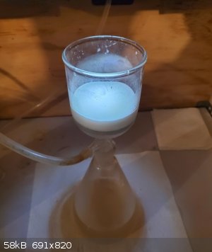

Here the residue in the distillation flask:
Residue.jpg - 135kB
There is some green color visible in the residue and my guess is that this is Iron(ii) Sulfate. I heard somewhere that sulfuric acid plants use iron piping, as high concentration acid does not readily attack iron metal. So, this would make sense.

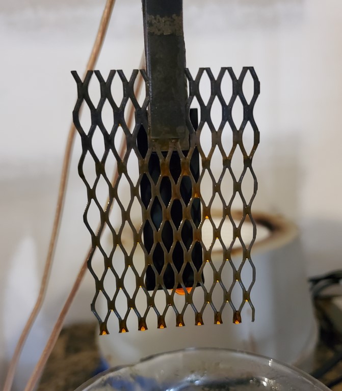

I then restarted electrolysis. To my great astonishment, the same orange color appeared again. After a day, it is as red as the 12hr picture above.
I did find an article about some unspecified Titanium-peroxo complex, which is orange or even red in sulfuric acid:
"pH Effect on the Optical Properties of Peroxo-Titanium Complex"
"Interesting optical properties of peroxo-titanium hydrogen peroxide complex against pH changes were studied for the first time using an analytical UV-VIS spectrophotometer. A freshly prepared peroxo titanium complex with pH value of 2.21 exhibited an orange color. This color changed to light orange, cloudy yellow, and then translucent pale-yellow as its pH value increased to 3.9, 5.8 and 6.7 or above. UV-VIS spectra show that the fresh complex had an absorption band rising at wavelength around 400 nm to higher energy, but had no maximum peak. A new absorption peak appears at 245nm for the cloudy yellow samples. This is similar to that of colloidal TiO2, which suggests that TiO2 particles might form upon increasing pH value to or above 5.80. The formation of TiO2 particles was accelerated in the pH value range from 6 to 9, but not in the acidic environment. In H2SO4 acidified environment, the color turned red-orange instead, and a strong absorption at 397nm was observed only at pH =0.99. Based on the experimental observations, a model for the color-forming species and possible applications by using the techniques generated from the present study were proposed."
I derive from this, that the Titanium cathode is slowly dissolved and forms this beautiful color with H2O2 present in the solution. I will let the cell run another day and then attempt to vacuum distill the content - let's hope something is there :-).

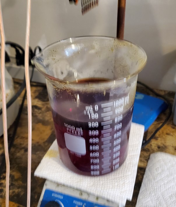

Update On: Hydrogen Peroxide by Sulfuric Acid Electrolysis - Failure

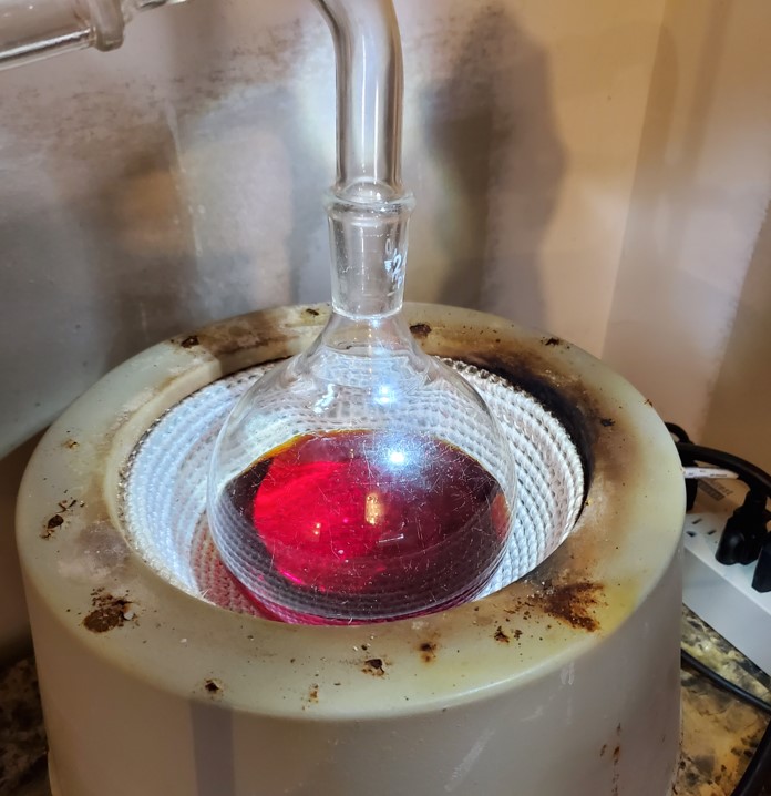

Today I distilled the first half of cell liquor. I was not able to detect any H2O2 in the distillate :-(.

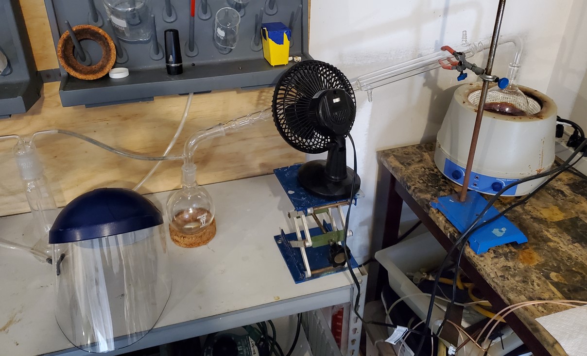

Here some pics:

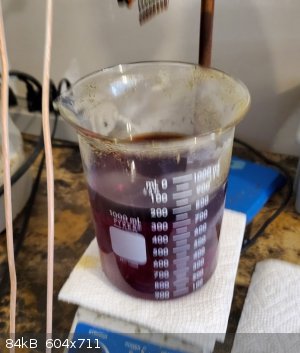

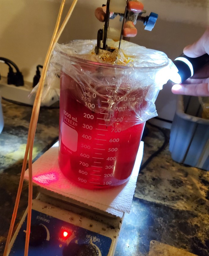

Cell liquor after ~3 days of electrolysis - very dark red color:
Cell Content.jpg - 84kB

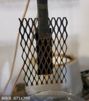

Etched cathode - lower part which was in the liquid lost thickness:
Electrode.jpg - 86kB

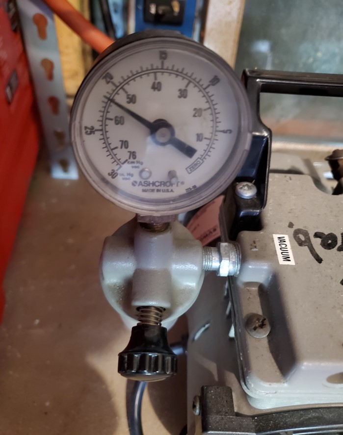

Max vacuum the pump could reach:

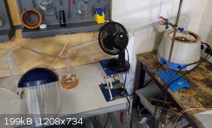

Distillation setup:
Setup.jpg - 199kB

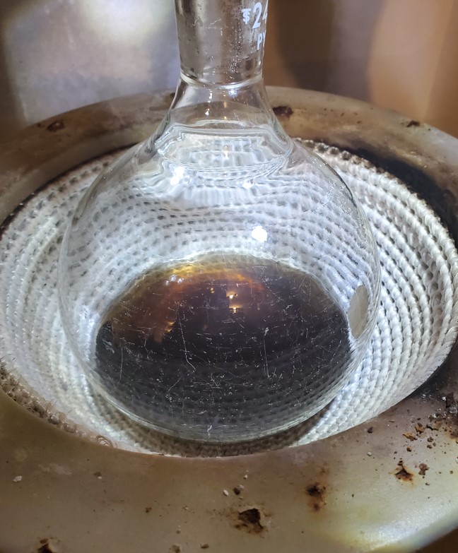

Before Distillation.jpg - 94kB
Liquid in flask after distillation:
After Distillation.jpg - 119kB

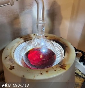

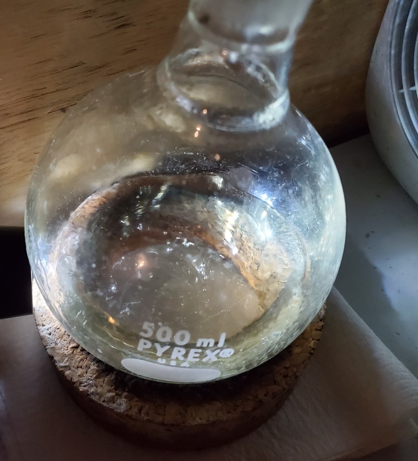

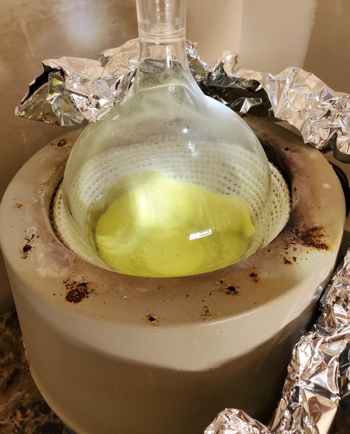

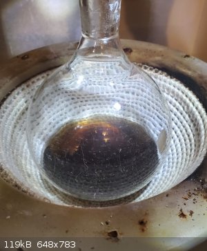

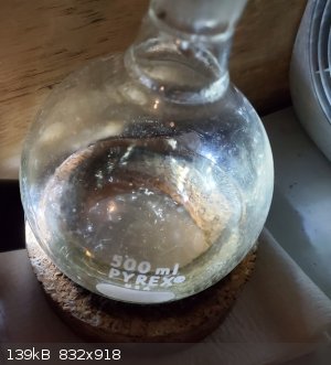

Before I started the distillation I tested if both the distillation flask and also the receiving flask could hold the vacuum without imploding. This was done by wrapping them in a thick towel and then placing in a heavy-duty plastic crate.
After the first half of the distillation the liquid in the distillation flask went to almost colorless. During the second half, the temperature was increased, and the liquid became greenish. Does anyone know what that green color could be?
Anyway, I still got the second half of the batch. I want to wrap the distillation flask in aluminum foil, so less hydrogen peroxide condenses on the way up. The setup is a basically a very simple rectification column. Also, I want to improve the cooling on the receiving side, so I can distill quicker (first half took almost 2 hours).

1. Get a greater vacuum. My pump creates a vacuum of 55 cm-Hg which should be 180 mbar. Commercially this distillation is done by lower pressure.
This website (https://chemistrypage.in/hydrogen-peroxide-properties/) states that it is distilled at 26 mm (I assume Hg as it did not state) this would correspond to ~31 mbar. The website also states that water jet pumps can get down to these kinds of absolute pressures.

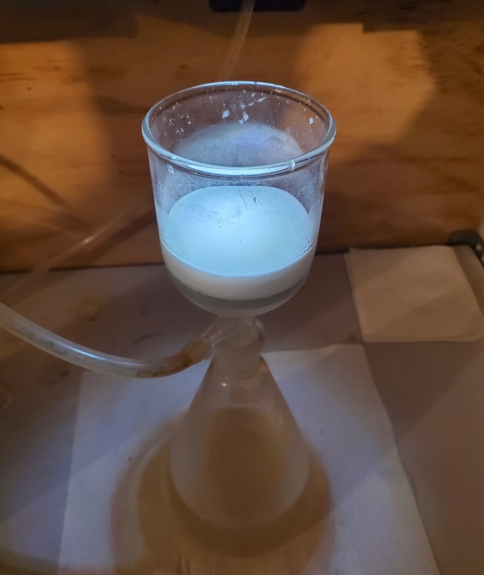

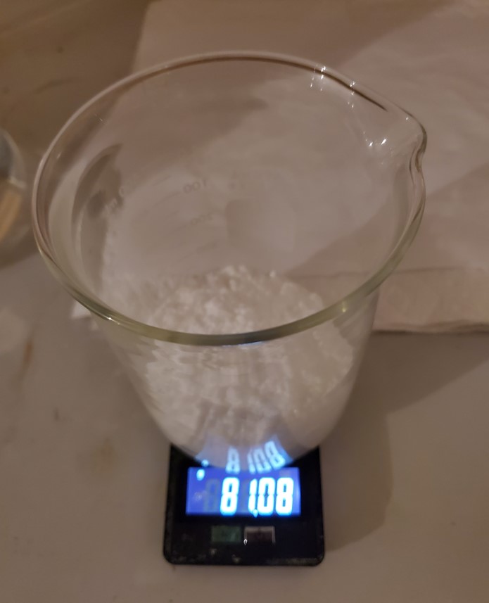

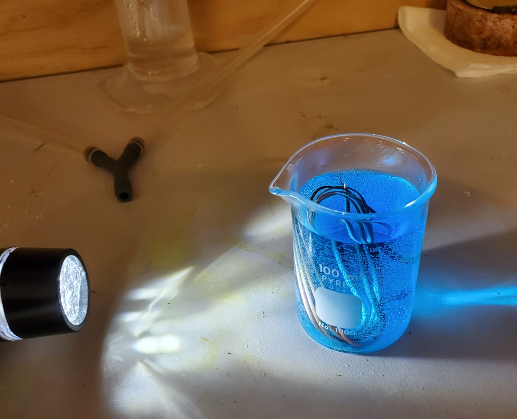

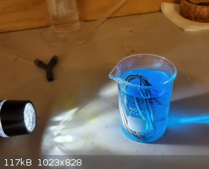

Sodium Bisulfate Electrolysis for H2O2 - Minimal Success
Hello Folks,
Did another run of electrolysis with Sodium Bisulfate in a clay pot.

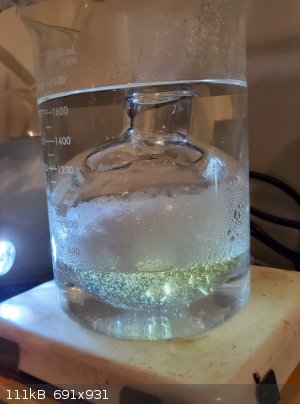

The anode compartment contained 400 ml and initially 100g of NaHSO4. Then more Bisulfate was added to a total of 200g over the course of a 2-day run. Current was 2 A and anode was BDD again.
To test how much Sodium Persulfate was created, 50 ml of the anode liquor were taken (spilled the first time) and 50 ml of H2O were added. Into this 21 g of copper wire were dropped and left for a couple hours. After that the solution was heated to drive the reaction to completion. The copper weighed 18.6 g afterwards - which means 2.4 g were dissolved (0.038 mol). This means that 9 g of NaS2O8 were in the sample. In other words, in the whole 400 ml anode liquor were 8*9 = 72g. So current efficiency was not very good, but I must mention that I did this in my garage and the cell was at ~40 C.
After this initial test, the remaining 300 ml of anode liquor were vacuum distilled, but this time heated with a water bath. The distillate weighed 118 g. 38 g of this was taken and heated on a hot plate with some copper in it to watch for O2 bubbles. There were some, but a lot less than a 3% commercial solution. 100g of 30% HCl were added to the remaining 80 g of the distillate, and this was also left with copper wire in it for a couple of hours. 0.35 g of copper was dissolved. That means there was 0.18 g H2O2 in that sample (considering there was some headspace with air in the beaker maybe even less).
Anyway, here the pics:
Foaming distillation flask:
Waterbath.jpg - 111kB
Receiving flask with some decomposition bubbles (hard to see):
Receiving Flask.jpg - 139kB

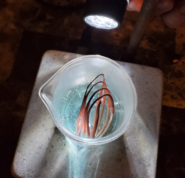

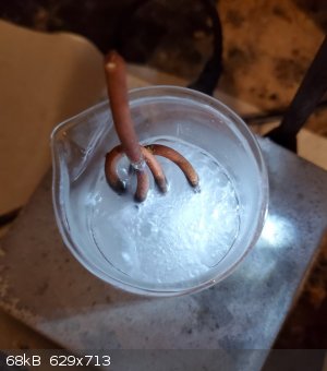

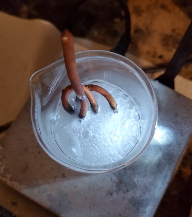

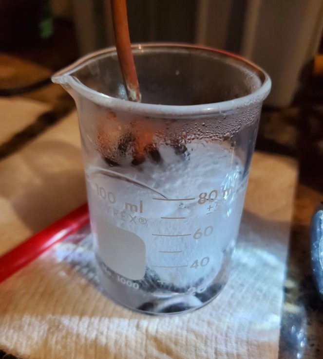

50 ml of anode liquor + 50 ml of water with copper after some hours:
Copper Sulfate.jpg - 117kB
Distillate heated with copper - some bubbles visible:
Hotplate.jpg - 66kB
Conclusion: Generation of Persulfate somewhat successful for the high temperature, but only traces of H2O2 survived distillation. Again, the pressure might need to be lowered further to get real amounts of H2O2.

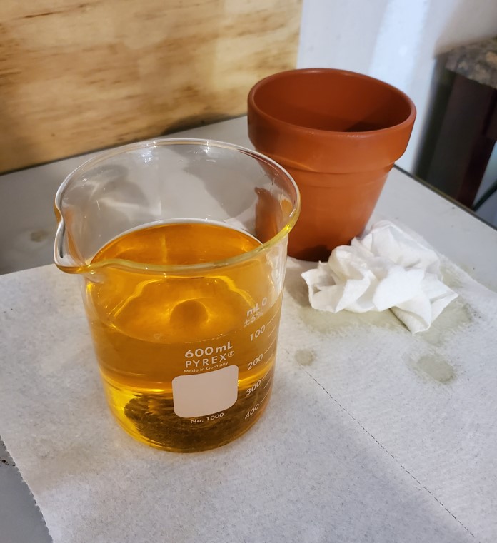

Persulfuric Acid
Hello,

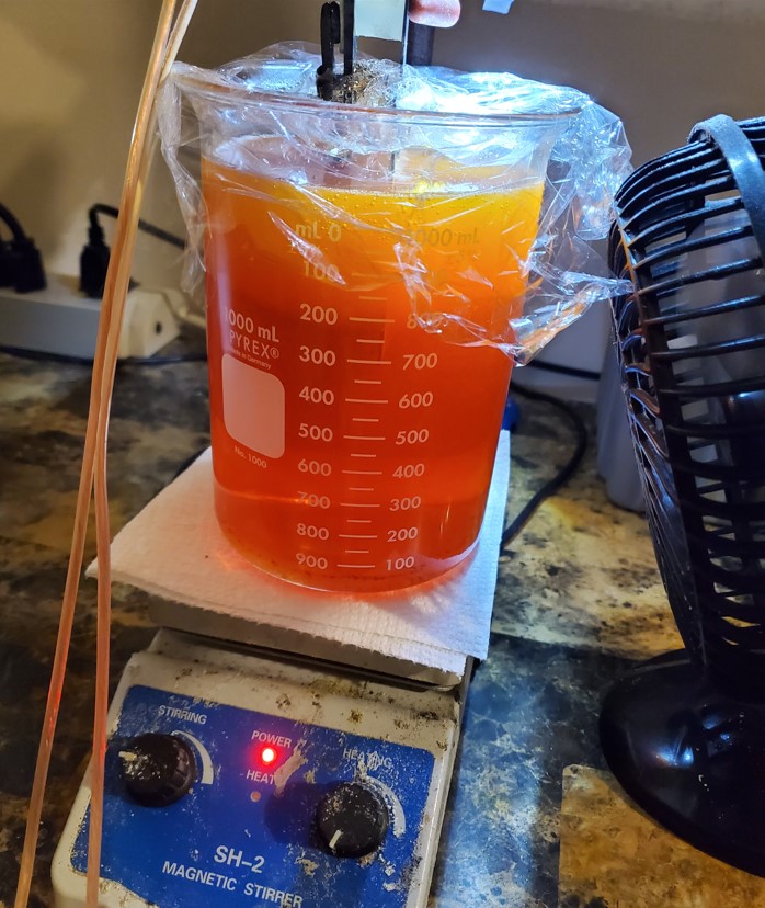

I thought about the problem of generating H2O2 by electrolysis of Sulfates, and I think it is fair to say that there are 3 major aspects to it:
1. Electrolytic generation of Persulfate.
2. Hydrolysis of Persulfate to Hydrogen Peroxide.
3. Isolation/Distillation to get H2O2 in solution without anything else.

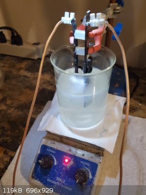

Since my last post, I have done some small experiments regarding the Persulfate generation.
I wanted to see, how effective it would be to make Peroxodisulfuric Acid. I have read somewhere, that this would better hydrolyze to H2O2 than the peroxo salts. All experiments were conducted at ambient temperatures ~25C.

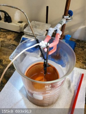

Here some photos:

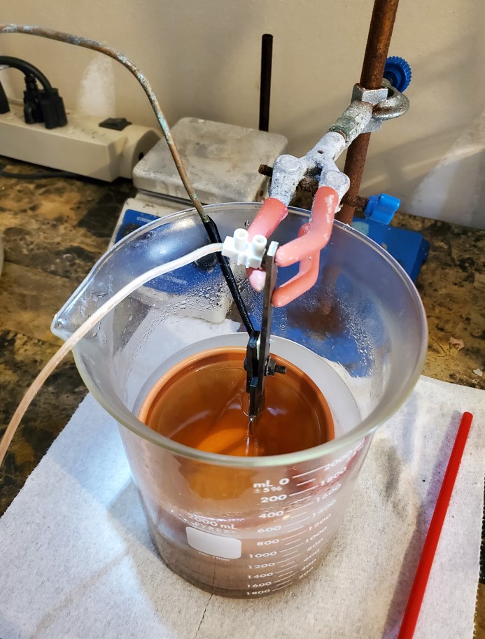

Setup - 2l beaker with the anode compartment (400ml) being a flowerpot to prevent cathodic reduction (anode is again BDD).
The concentration of the acid was ~60%; current was 2A at ~5.5V.
Cathode was a copper spiral plated with nickel:
Setup.jpg - 155kB

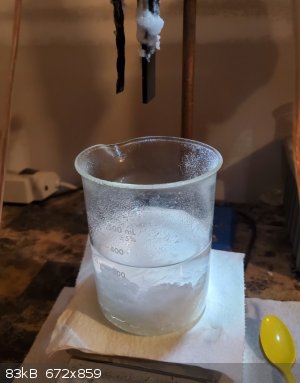

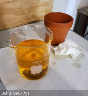

Anode liquor after completed run (~2days):
Anode Liquor.jpg - 88kB
Interesting is the yellow color of the anolyte. I initially though it might be iron, but the color faded over the course of a day. In other words, I do not know what it is.
Result:

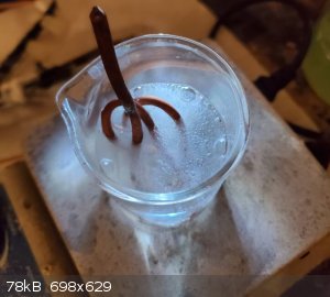

50ml of the anolyte were diluted with another 50ml of H2O and some Copper was left in the solution until no more reaction took place. The weight loss of the copper was 0.3g. That means that there were 0.3[g]/63.5[g/mol]*194[g/mol] = 0.91g H2S2O8 in the sample (7.3g in the whole annolyte. This result seemed not very encouraging.
I did remember though that a couple years back, when I tried to make Sodium Persulfate, that I had better results with lower concentrations of the salt vs adding more NaHSO4 over the course of the electrolysis. So, after this, I repeated the experiment with ~30% H2SO4. Run time was ~1day.
Results 2:
100ml of the anolyte were taken and a piece of Copper introduced. Weight loss of Cu was 1.44g -> There were 17.6g H2S2O8 in the whole anolyte.
So, in one day the amount produced was more than double compared to the 2-day-run with the 60% acid. Astonishing is that in literature (e.g. The manufacture of Chemicals by Electrolysis) it is mentioned that concentration needs to be rather higher than lower.
Anyway, I want to do another run with 20% acid and see how that works out.
Best Greetings :-)

I was thinking about bleeding some air into the system to have the air carry H2O/H2O2 over. I am just not sure, if I would be able to condense anything.
Anyway, as this setup would make things much more complicated, I decided to buy a cheap (60 USD on Ebay) rotary vane vacuum pump - should arrive some time this week.
Vacuum Pump.jpg - 57kB
Not sure how long it will last, but I got a small smelting oven from Vevor and it is of a not too bad medium quality.
Concerning a divided cell, that is what the flowerpot was for. Anode compartment in the pot, cathode compartment outside.

Potassium Peroxodisulfate
Hello,
Last week I decided to prepare some K2S2O8. I am not sure if it will be a good precursor to H2O2, but I wanted to actually see a product to keep my motivation going.
The electrolysis was carried out in an undivided cell without any additives.
Starting point was a solution prepared from 140g KHSO4 and 350g H2O (28.5%).
I = 2A
T = 30 - 40C (depending on daytime)
t = 24h (duration of electrolysis
Here some photos.
Setup:
Setup.jpg - 119kB
After completed run:
Comleted Run.jpg - 83kB
Vacuum filtration:
Vacuum Filtration.jpg - 58kB
Final product:
Yield.jpg - 47kB
After the run was completed, the product was vacuum filtered and washed twice with ice cold water. It was then spread on a piece of paper and left to dry in ambient air for 3 days. The yield was 81g of a very fine crystalline product, which was almost free flowing and had no odor.
The current efficiency for this run was 33.5%.
To test the purity of the product, 10g were dissolved in 100ml of water. The solution needed to be heated to ~50C for all K2S2O8 to dissolve. Then dissolution of a piece of Copper was measured as in the previous experiments.
2.4g were dissolved. For that amount of Cu to dissolve, it takes ~10g of Persulfate. In other words, the product was almost pure.
Next will be mixing the remaining product with H2SO4 and vacuum distillaton...

Distillation of K2S2O8 with 30% H2SO4 - Failure
Attempted the distillation of ~70g Potassium Persulfate with ~200ml 30% H2SO4 with my new vacuum pump.
Unfortunately, a lot of decomposition was visible in the boiling flask and just water made it over to the receiver.
Max vacuum the pump could reach was 27 inHg. Which converts to ~100mbar absolute pressure.
The distillation temperature was 65C.

Distillation of a purchased 3% Hydrogen Peroxide Solution
After the previous failures, I wanted to see, if H2O2 can be distilled at 100mbar without decomposition or if the pressure is just not low enough.
Boiling started around 35C. From there the temperature slowly rose to 45C and remained there for the rest of the distillation (+/- 5C, my thermometer is not very accurate).
It did not look like any decomposition was happening at all. I only saw big 'boiling' bubbles and no small foaming 'decomposition' bubbles.
After the first half distilled over, I heated the liquid with some copper wire.
Gas evolution was visible:
First Fraction.jpg - 78kB
When the rest of the liquid was distilled over, the same test was performed as previously.
Vigorous gas evolution was visible:
Second Fraction.jpg - 68kB
Second fraction kept bubbling for several minutes after being taking of the hot plate:
Seconf Fraction without Heating.jpg - 75kB
Conclusion: Hydrogen Peroxide can be distilled at this pressure without decomposition. Since Persulfates were clearly created in previous experiments, the problem lies withing the hydrolysis / distillation (contamination) step.
