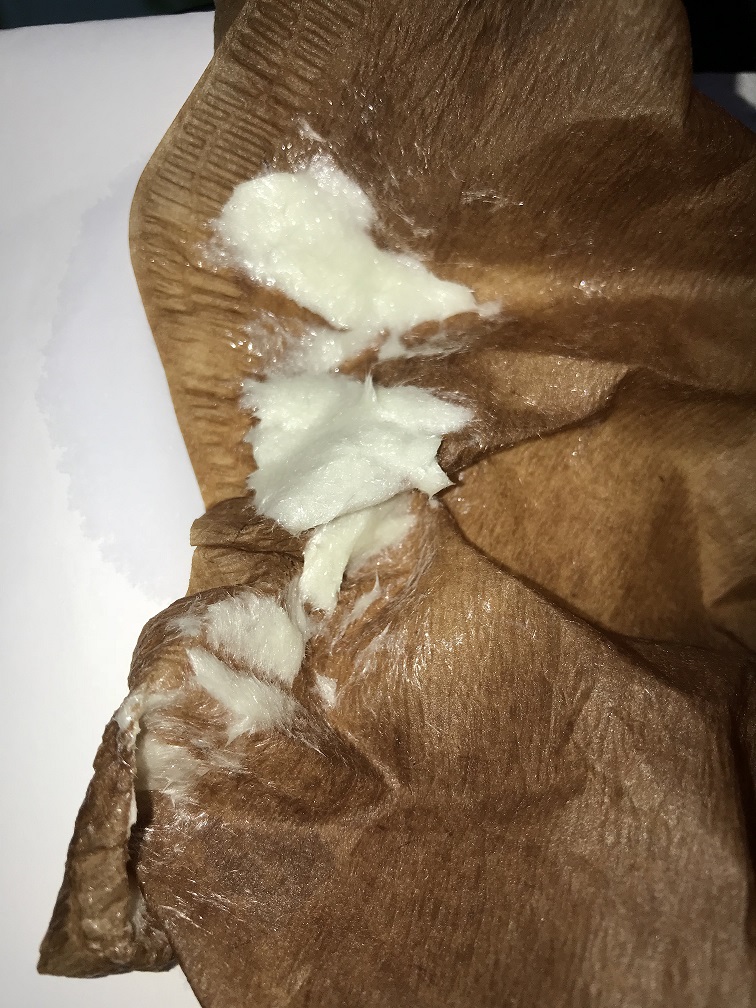

The picture is not quite the curdy milkshake like product mentioned in the main thread, that was thought to be due to oxidation and/or dinitration, but could it actually be the result of bad toluene that needs purification?

https://www.oc-praktikum.de/nop/en/instructions/pdf/1001_en....
they still use excess of HNO3 and the DNT is obtained by vacuum distillation as a remainder in distillation flask after distilling out mononitro.
I did the same and the dinitro recrystallized from ethanol few times, I got quite pure 2,4-DNT with nice m.p.
the MNT is still waiting for vacuum distillation through column (I got yet a little of para by crystallization after cooling to -15 C).
[Edited on 17-4-2021 by Fery]
S.C. Wack
bibliomaster
Posts: 2419
Registered: 7-5-2004
Mood: Enhanced
[*] posted on 17-4-2021 at 19:28
Not a big fan of overcautious modern German directions that give DNT or 60% yield. Temperatures over 30C might lead to a darker color of the raw product, and over 40C there can be some nitrous vapor in the system, but even so the industrial method (or large excesses of azeotropic HNO3, apparently) does not dinitrate, with proper stirring. Everything is as Cumming says except where they didn't notice that the distillation in Cain's text is with vacuum.
BTW n-propanol is good at separating dirty, mixed NT crystals; 91% IPA might be better.
