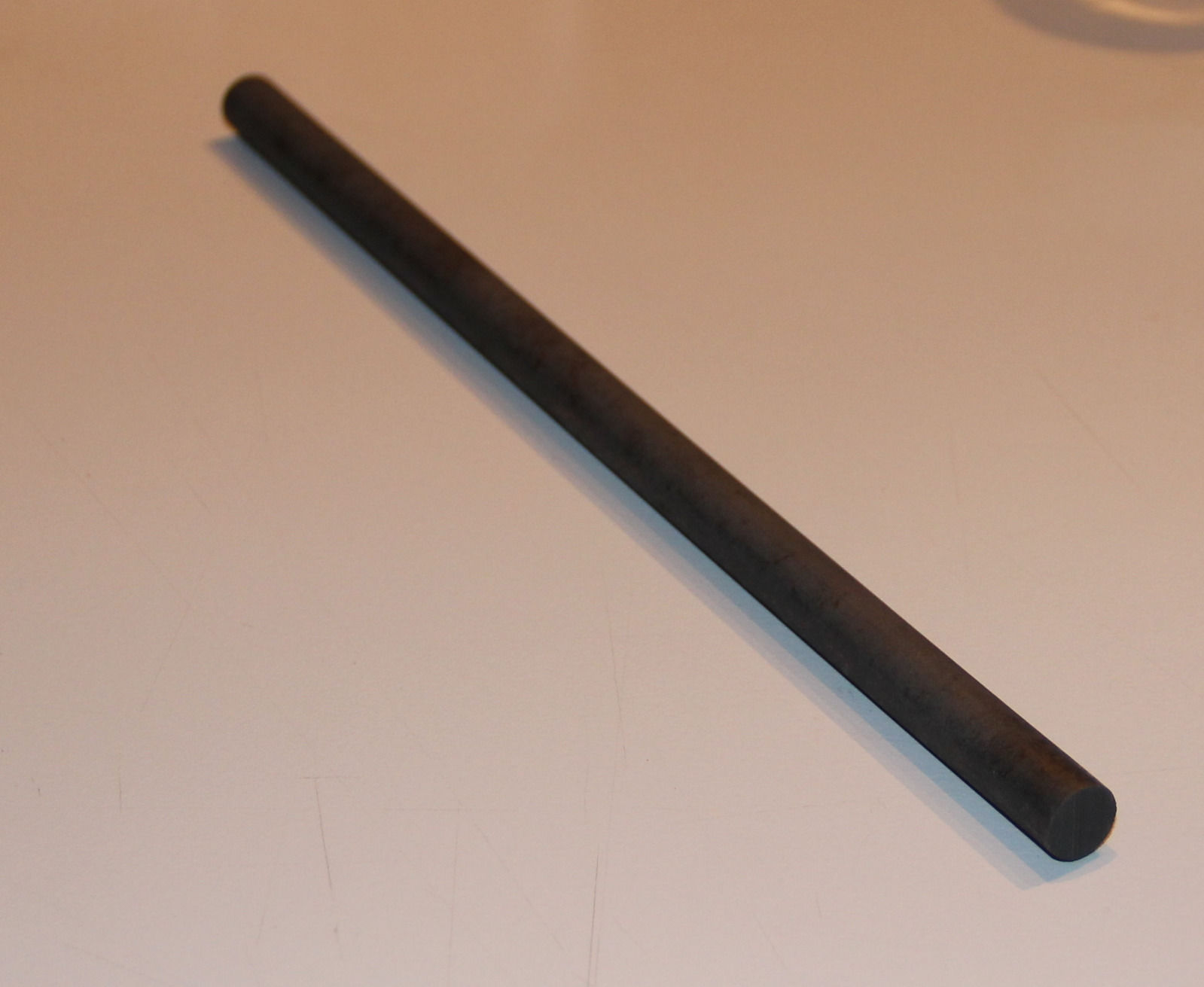

I am thinking to electroplate graphite rod with lead dioxide.
I found two different kinds of graphite electrodes, one is black and one is gray.
$_57.JPG - 109kB $_587.JPG - 115kB
what is the difference between both ?
hissingnoise
Posts: 3940
Registered: 26-12-2002
Mood: Pulverulescent!
[*] posted on 17-2-2016 at 09:42
The grey rods contain graphite and the black one looks like compressed carbon . . . ?

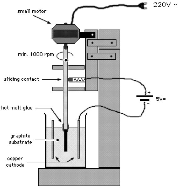

I am ready to build this setup :
Capture.PNG - 64kB
I bought lead , some copper and diluted nitric acid 65%.
I have a fan motor and some beakers.
I think I am ready.
I have a problem now to connect the shaft of the motor with a aluminium rod and to connect the Al rod with the graphite rod.
is there a better way than using glue? I prefer mechanical ways. I wish I find something like a drill chuck that can connect things together with different dimensions.
any suggestions ?
Hennig Brand
Posts: 1284
Registered: 7-6-2009
[*] posted on 25-2-2016 at 11:09
This has worked for me in the past for reasonably low torque arrangements:
Plastic tubing (vinyl, polyethylene), from the hardware store comes in all the standard sizes. The outside diameter of one size is the inside diameter of another. Short lengths of tubing can be used as couplings. If connecting two shafts of different diameters, build up the small shaft with smaller diameter couplings. If the shafts are standard sizes the tubing will fit snuggly like a glove. If friction isn't enough then drill a hole through all (shaft and coupling) and put a pin through, or use an adhesive of some sort.
ecos
Posts: 464
Registered: 6-3-2014
Mood: Learning !
[*] posted on 25-2-2016 at 13:29
Thanks a lot hennig ,
you mean a tube like this ?? :
tubing.jpg - 7kB
I got your idea, this will be between the shaft of the motor and the Al tube.
what about the connection between Al tube and graphite rod?
my problem , I plan to get graphite rods with different diameters (13 mm , 19mm , 23 mm , ..)
Hennig Brand
Posts: 1284
[*] posted on 26-2-2016 at 11:57
You're welcome. There are at least several different types of tubing available at the better hardware stores around here. Even the more basic stores usually have vinyl and polyethylene. Also, a tube with the least curvature is best (outside start of a large diameter roll perhaps). With the two shafts close together in the "coupling" the connection is almost perfectly straight even with tubing with a bit of bend (imbalance of stress from one side of the tube to the other causing curvature). I think this would work with a graphite shaft as well.
The plastic tubing (coupling) also acts as a torsion shock absorber. Depending on the tubing chosen the coupling can be very elastic. This could possibly be a good thing when brittle shafts are involved.

Laboratory of Liptakov
Posts: 1457
Registered: 2-9-2014
Location: Tel Aviv University
Mood: old jew
[*] posted on 27-2-2016 at 03:39

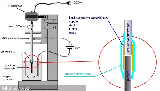

Crisis place in the red circle. If the connection is soft, graphite misalignment occurs. You need hard tube against axis displacement.
cap.jpg - 73kB
hyfalcon
Posts: 1003
Registered: 29-3-2012
[*] posted on 27-2-2016 at 05:34
How about something like this:
https://www.zoro.com/climax-metal-products-coupling-rigid-st...
Hennig Brand
Posts: 1284
[*] posted on 27-2-2016 at 06:04
If it is so soft and so much slack is allowed that it is flopping around when spinning that is a problem of course. However, even relatively stiff polyethylene, which holds its shape well under most normal conditions, has enough elasticity (is non rigid) so that spikes in torsion force are greatly reduced (lowered in amplitude and stretched out). Too soft is of course a problem. Not sure it is even needed, it was just a passing thought.

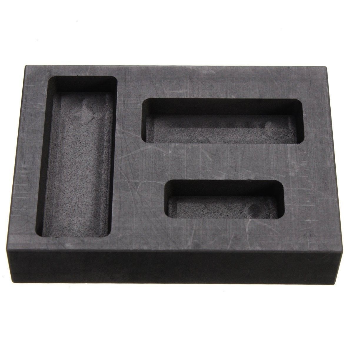

I have a question.
I found some offers on the internet for crucible graphite. some of them are used and with good price.
anybody know if they can work as electrodes?
$_57.JPG - 119kB
Jstuyfzand
Posts: 166
Registered: 16-1-2016
Mood: Learning, Sorta.
[*] posted on 20-7-2016 at 06:47
I have a question.
Problably, although they might have some additives to make them more suitable for their purpose, I guess.
