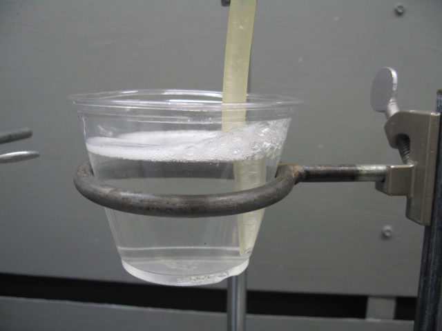

I added some dish soap to the water where the H2 vents and tested the bubbles with a match. They are indeed flammable. All operations were conducted with my efficient hood fan on.
The pictures below show the test set-up. The small cup is where the H2 was being vented to form soap bubbles for the ignition test.

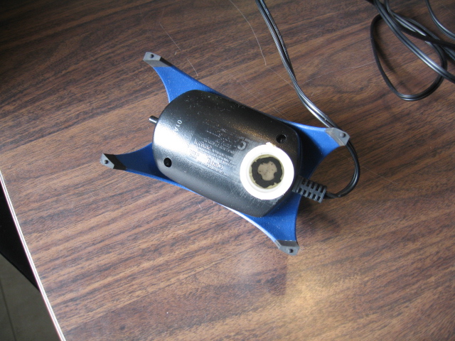

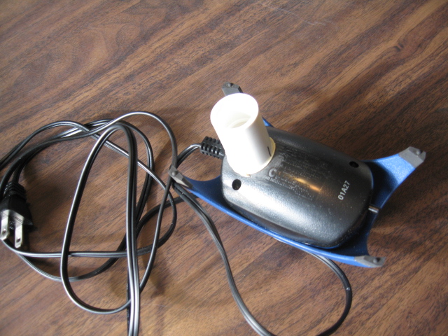

...I wish I could find an aquarium pump that has an inlet port to speak of, anything I've seen has a hole somewhere on the housing but nothing to use as an inlet.
Yes, my pump was like that too. To solve this I took a 3/4"PVC coupling and sanded the end to conform to the curvature of the pump inlet. Then epoxy this to the inlet. This then takes a rubber stopper w/hose barb. :D
aquarium air pump inlet adapter 1.jpg - 201kB aquarium air pump inlet adapter 2.jpg - 203kB

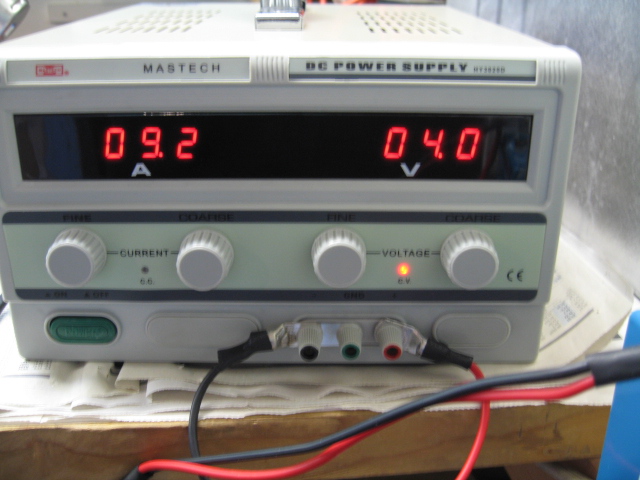

My electrolysis unit is fully operational now. I first tried using a sat. soln of NaHCO3 as electrolyte but found this was unsatisfactory due to the generation of significant CO2 contaminating the product H2. A test bubbling the H2 into lime water definitely showed the presence of CO2. So I switched to Hurley's recommended 29 wt% KOH. After purging the system to eliminate air I successfully filled my first H2 balloon as shown below.
Edit: Warning: do not use PETE containers for 29wt%KOH. The small PETE cup I was using at the O2 outlet cracked overnight and leaked to my hood catch pan. The PP larger cup is OK. The milk container in the picture, probably also PETE, would not be useful for storing this liquid either.
H2 balloon filling.jpg - 149kB H2 generation volts & amps.jpg - 135kB H2 filled balloon.jpg - 159kB
