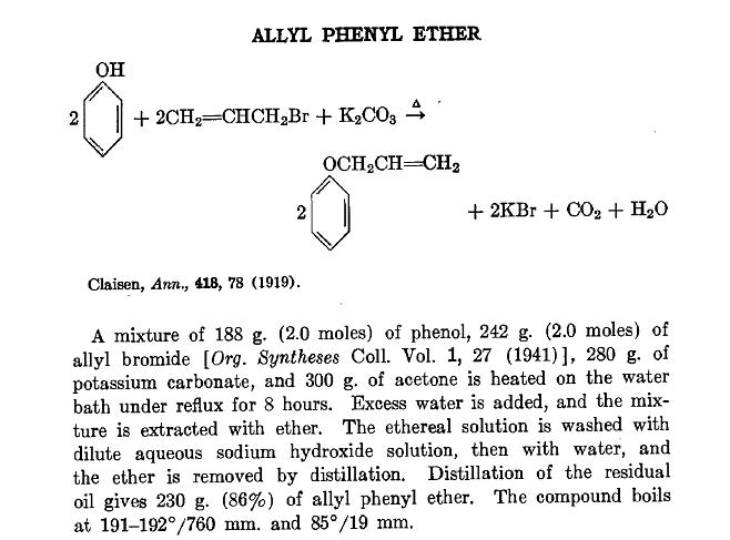

His book King's Chemistry says you can do a reaction that closely resembles a Friedel-Crafts on catechol with allyl alcohol in acetone using potassium carbonate as the catalyst instead of a Lewis acid:
Does this actually work? It's questionable but interesting.
Hey @JJay, I'm afraid it will not work. I suspect Jared Ledgard books are not so trustworthy as I have thought.
I found the same reaction you described from his book King's Chemistry Survival Guide at another book called Preparation of Organic Intermediates - David Shirley - Wiley - 1952, between a phenol (cathecol in this case), allyl bromide, Potassium carbonate as a catalizer and acetone as a solvent. That is quite the same reagents.
However, the product is an allyl phenyl ether and not an allyl phenol (cathecol in this case). The addition isn't like a friedel-crafts reaction, but instead, a substitution of the phenolic group by an ether.
Take a look on this:
Reaction between a phenol with allyl bromide and K2CO3.JPG - 56kB
EDIT: Ok, I apologize, The allyl phenyl ether will rearrange (Claisen) to allyl phenol (cathecol) at high temperature. I see that now. Jared Ledgard is not so stupid after all.
