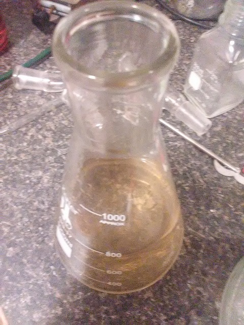

Here's the barium acetate solution that was left behind after gravity filtering. It has a slight sulfurous odor, and it is obviously impure. I'm not
exactly sure what the brown color is... I believe that iron (iii) acetate is rather insoluble. There were iron filings in the barium carbonate; they
stuck to the stirbar.
My plan is to add some sodium hydroxide solution, which should precipitate barium hydroxide octahydrate. Heating to boiling and doing a hot filtration
will hopefully get rid of any carbonates. I'll probably recrystallize the product a few times for purity then dry it to the monohydrate in a warm oven
(easier than using a desiccator).
I have some disgusting and toxic barium waste sludge that I have to dispose of. I'm pretty sure I should not put it down the drain. Right now it is
just sitting in a container while I figure out what to do with it.

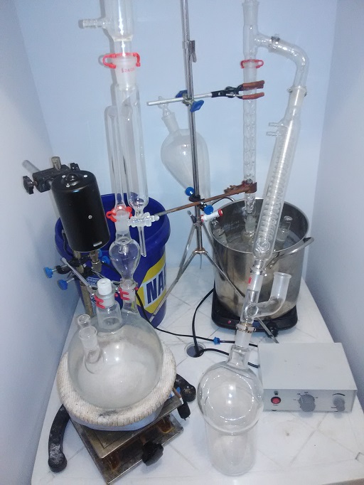

I removed a couple of centimeters from my 20 cm thermometer tube so that it will fit into a 3 L flask. I am not very experienced at glassblowing, but
I managed to get the end to seal without doing too bad of a hack job.
I also constructed a large gravity filtration apparatus by drilling numerous small holes into the bottom of a 3.75 L ice cream bucket. The bottom of
the pail is exactly the same size as a coffee filter. It works pretty well except the bucket is a little too flexible to hang without the sides caving
in and reducing capacity. I'm going to try it with a more rigid pail.
