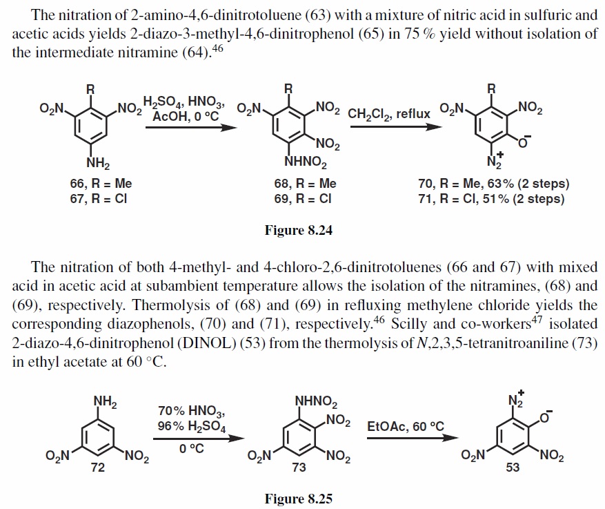

Reviewing the circa 1881 work of Benedikt and Hubl which was doubtlessly followed by Von Herz in 1922 without due attribution to the prior art, it is significant that Von Herz reported that the preferred precursor for DDNR is the mononitroaminoresorcinol and not the dinitroaminoresorcinol which would be styphnamic acid, derived from the partial reduction of styphnic acid, which is analogous to picramic acid derived from partial reduction of picric acid.
The interesting aspect about the diazotization method of Benedikt and Hubl is that it is a combined reaction which not only diazotizes the amino mononitro phenol, but simultaneously adds 1 nitro group, resulting in a diazodinitrophenol as the product instead of the expected diazo-mono-nitrophenol. This unexpected result could be general as a reaction, so that it is not necessary to partially reduce a trinitro compound like picric acid or styphnic acid to a dinitro-mono-amino compound and then diazotize.
What is suggested is that ordinary o-DDNP may be possible to make from a mono-nitro-aminophenol derived from a partial reduction of a dinitrophenol by applying the diazotization method of Benedikt and Hubl which could simultaneously diazotize the 2 position amino while adding a second nitro at the 6 position, or the 4 position, depending on the structure of the 2-amino-(4-nitro or 6-nitro)-phenol precursor used. This general reaction may proceed without preference for any particular ring position amino to diazotize or any particular ring position to add a nitro, but will generally do both as a matter of course, simultaneously diazotizing the existing amino and nitrating a vacant or susceptible to nitration ring position in one step. This would be half confirmed if 4-amino-6-nitroresorcinol is subjected to the same diazotization method and the result is DDNR identical as that produced from 4-amino-2-nitroresorcinol.
Since the diazotization method also works with the usual dinitroamino precursor, it may also serve as a diazotization method that is general and applicable to picramic acid or isopicramic acid or styphnamic acid or any of their anaolgues.
The possibility exists also for a 2-diazo position for DDNR, which was the best guess of Von Herz regarding structure.

[*] posted on 22-7-2015 at 17:51
Regarding the synthesis of DDNR:
In a recent experiment I heated 3 grams of isopicramic acid with 20 ml 65% HNO3 to about 50 deg. C. for 4 hours. (At lower temperatures there is no reaction and/or little dissolution of the isopicramic at all.) I was curious whether this way crystalline pDDNP could be formed for people without access to nitrite, but also whether this could be a possible route to DDNR.
The reaction and colour changes are very interesting. After reaching 50 deg C. most of the isopicramic has gone into solution, forming a deep orange-red solution. After prolonged heating, the colour seems to change to more of a deep dark red (1-2h), to a deep brownish red (3h) to an almost transparent light orange-yellow near the end. It is hard to tell, since the soluble isopicramic nitrate is already a very strong orange-red, but the side of the beaker did seem to show some dark red compound, which would concur with the colour of the trinitroaminophenol, or compound 6, from the Klapotke article.
When the reaction mix was allowed to cool down it was poured onto crushed ice, precipitating a bright yellow-orangeish crystalline compound. A small amount was dried at 50 deg C. on the hotplate, it flashes similarly to DDNP. It is drying now, so no yield yet, though it will be very interesting to react the resulting compound with KHCO3 or PbCO3 in either ethanol or water, as described in one of the patents regarding DDNR salts Rosco posted a while back.
In the worst case it may be a diazotizing scheme to pDDNP, allowing good control of crystal formation, and usable for those without nitrite. :D

nitro-genes
Posts: 1048
Registered: 5-4-2005
[*] posted on 24-7-2015 at 02:32
Holy shit!!! :D:D:D It may turn out the nitration of isopicramic with 65% nitric acid at elevated temperatures does produce some DDNR! Some of the yellow orange stuff was carefully neutralized with one mole equivalent of sodium bicarbonate with overnight stirring, after which a strong solution of KNO3 was added. Unlike pDDNP, a speck of the resulting dark brown stuff detonates when heated.
Another equally interesting possibility is that a sort of a neutral potassium nitrate/pDDNP double salt has formed. Maybe crystallization from sodium perchlorate solutions would be interesting to test. Alternatively, the strong KNO3 solution may have precipitated the presumably more energetic diazonium nitrate of pDDNP. The latter would be easy to test, since it would dissociate when added to water again. :)
[Edited on 24-7-2015 by nitro-genes]

Interesting read from "organic chemistry of explosives", it seems diazophenols are presumably formed through a primary arylnitramine from nitration of the corresponding arylamine. Although the reaction is only described for methyl and chloro dinitroaminophenol, would this somehow be possibble for (iso)picramic acid, or does the hydroxy group lead to excessive oxidation and HNO2 formation? :) Maybe adding urea or even ammonium nitrate? Ideas anyone?
Arylnitramines diazo conversion.jpg - 192kB
Attachment: organits_chemistry_of_eksplosives__agraval_j._p._hodgson_r._d._-_2007_g._418_s..pdf (4MB)
This file has been downloaded 3046 times
[Edit: Didn't see the book in the SMDB library, so I uploaded it here, if is has already been posted, it can be deleted again, or transfered to the library]
[Edited on 27-7-2015 by nitro-genes]
