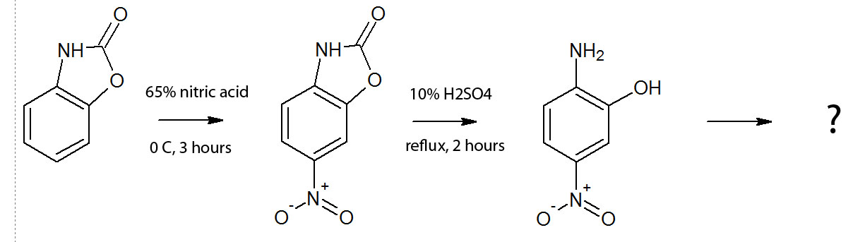

the N-O-diacetaminophen nitration to trinitroacetaminophen also brought me another idea. Don't know theoretical background on the most likely ring
substitutions, but what if benzoxazolone was nitrated in 65% nitric acid? The N position may be more dominant in oriantating nitro groups orho para,
but the alkylated O is more suscpetable to hydrolysis, which shifts the orientation during the reaction, likely very similar to the formation of
trinitroacetaminophen klapotkes group described. Curious what the outcome may be.
Unlike trinitroacetaminophen, which needs Ac2O or very unhealty alkylation agents, benzoxazolone is potentially completely OTC from salicylic acid
--> salicylamide --> treatment with household bleach (and maybe sulfide to prevent ring chlorination).

Another question for those who may know more about organic chemistry than me:
Benzoxazolone can be made in high yield, completely OTC. From literature it seems the 6 and 5 positions are most activated, and 6-nitro benzoxazolone
can be made from just 65% HNO3 in high yield by nitration at 0 deg C. Now, could you hydrolyze the oxazolone ring using reflux conditions and dilute
mineral acids, or would the nitro group decompose? If you would get 2-amino 5-nitrophenol and nitrate it further, what would be the outcome? I
couldn't find anything on this, not even for 3-nitrophenol. Suggestions for followup or stability of these compounds? This could be really
interesting, as most of the reactions involved are smooth sailing.

Viable route to a possible iso-DDNR? What do you guys think?
Up to the reduction of 5-nitro benzoxazolone to 5-amino benzoxazolone is described in literature, the nitration of the latter isn't, so this is
somewhat of a guess that the 4,6 nitro derivative would result, same for the oxidation/diazotization.
[Edited on 7-9-2015 by nitro-genes]
