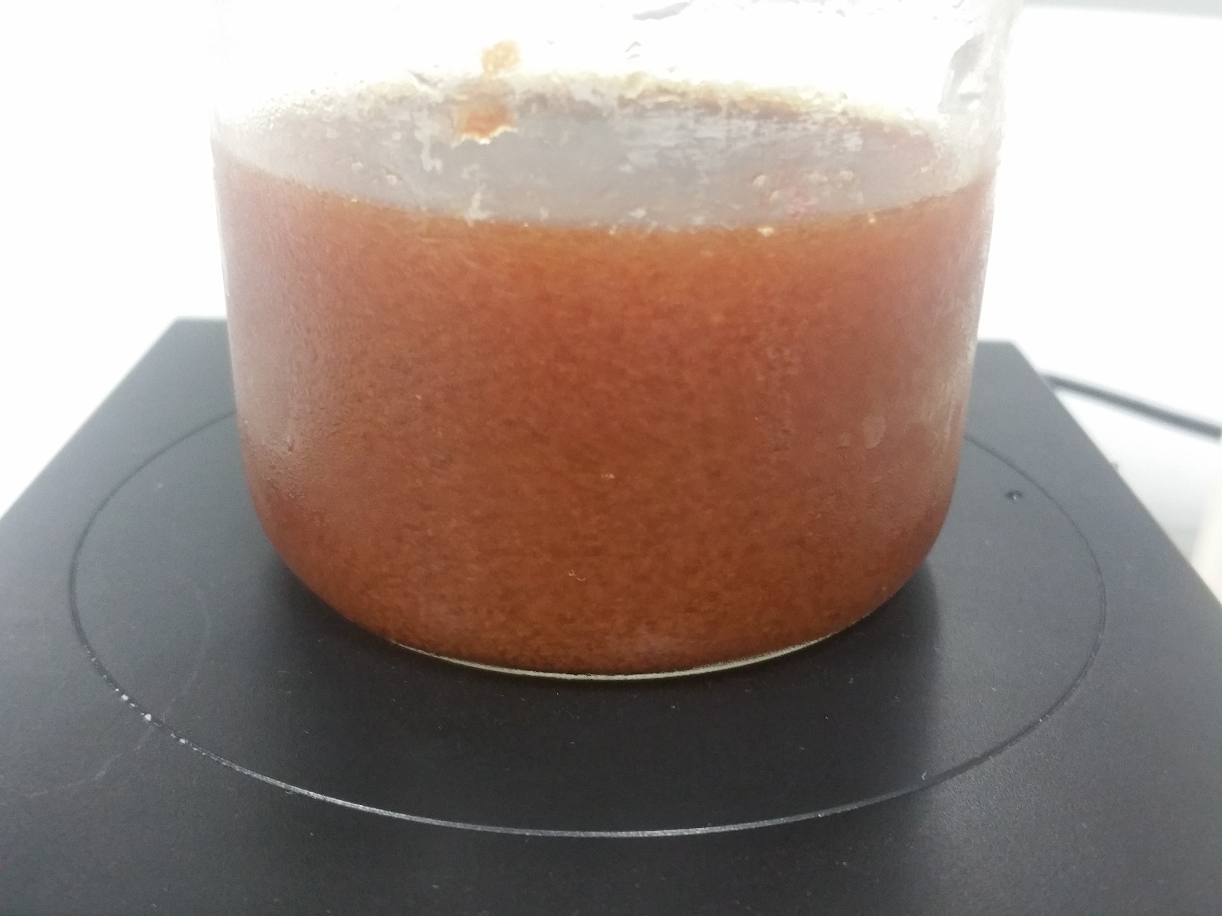

I just attempted Nitro-genes revised last step from isopicramic acid to DDNP.
1 gram isopicramic, 2 grams copper beads, 2.2 grams Potassium nitrate, 3 ml 96% Sulphuric acid and 3 ml distilled water were used.
Heated for an hour at about 46-47 Degrees celcius with clear foil wrapped around the beaker to prevent escape of NOX before being poured into ice cold water and filtered.
Does this look right before I get my hopes up waiting for it to dry?
[Edited on 25-9-2015 by greenlight]

Disregard the above results, the product is not DDNP at all, the colour looks wrong too.
I had another attempt today with the same procedure and even added about 1 ml of 30% HNO3 half way through to see if that improved things, but still no luck:mad:.
All my reagents are pure and the copper beads are the right size, the only things is I don't get a greenish tint to the brown solution that nitro-genes speaks of at the end of the hour heating at 50 C.
Maybe I am not heating for long enough.

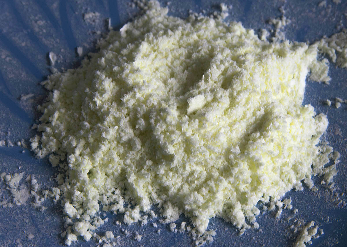

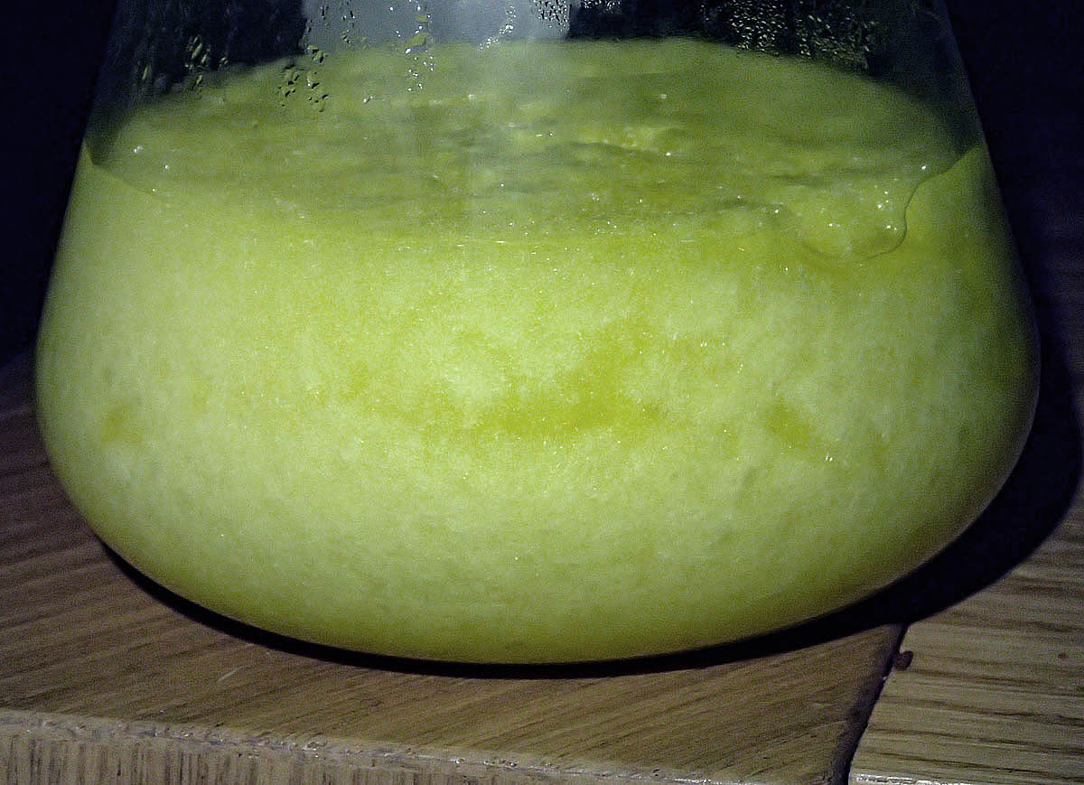

Recently did some experiments regarding the synthesis of 3-5 dinitrosalicylic acid (DNSal), seems like an interesting compound since it may be useful for several purposes:
1. Determination of glucose concentrations by reaction under alkaline consitions to produce the bright red coloured 3-amino-5-nitrosalicylic acid
2. Conversion of the resulting 3-amino-5-nitrosalicylic acid to o-DDNP
3. Reaction with excess urea may produce 3,5 dinitro salicylamide, which after hofmann rearrangement may produce 3,7-dinitro benzoxazolone (Wasn't able to find this compound, so it may not exist or cannot be synthesized this way, hypochlorite may also interact with the benzene ring since the nitrogroups promote formation of all kinds of meissenheimer complexes under basic conditions (chloropicrin?). So not sure about this one, although supposedly m-nitro aniline can be formed by hofmann rearangement of 3-nitrobenzamide. If this would work however the 3,7-dinitro benzoxazolone may be hydrolysed under mild conditions by a strong acid to yield a soluble picramic acid salt that can be titrated with a base to yield free picramic acid (analogous to isopicramic), which would be a hydrolysis and purification step in one. This route may have some advantages over reduction of picric, since in my experience benzoxazolone is stable to further attack during the hofmann rearangement, whereas over or under reduction of picric is always a danger, as well and canbe obtained in very high yield as well as that the reduction of PA can produce difficult to filter sulphur particles. Further nitration of 3,7-dinitro benzoxazolone may also be interesting, though perhaps not possible without hydrolysis.
6. Salts of DNSal may form interesting pyrotechnic compositions with chlorates/perchlorates
Anyway, where was I? :) Ah yes... DNSal synthesis
The synthesis protocol for the first article is pretty limited regarding detailed information. I attempted the synthesis using 10 grams of salicylic acid from hydrolysis of aspirin, only replacing the large excess of nitric acid used by an equimolar amount of ammonium nitrate and sulfuric acid. The reaction was kept between 5 and 10 deg C during the additions (45 minutes) and was stirred at 0 deg C. for an additional hour before crashing on ice. After recrystallizaton from boiling water, there were 3 distinctly seperate colours and crystal structures present, melting point of between 120 and 140 deg C. The solution further darkened pretty fast in sunlight, which lead me to believe that the product was mostly composed of 3 and 5 mononitro salicylic acid, together with a small amount of DNSal. Obviously, the presence of the deactivating nitro and carboxyl group prevents dinitration at these temperatures. The synthesis utilized by Meldola uses a very large excess of fuming nitric acid to overcome this. During the synthesis of piric acid there seems to be however very little decarboxylation going on below 60 deg C. So I tried the synthesis again heating in increments to 50 deg C to see if DNSal may be produced at higher temperatures and without an extreme exess of fuming nitric acid. Also here the use of AN may have some benefits over NA, since the formation of some of the NOx secies responsible for the decarboxylation (nitrous acid for example) may be hindered by the presence of the ammonium. The procedure looked something like this:
70 grams of 97% sulfuric acid was poured into a 250 ml glass beaker. The beaker was added to an icebath together with a thermometer put on a magnetic stirrer plate, after which 12.5 (2.2 molar eqv) grams of completely dry ammonium nitrate was added and stirred for 5 min to dissolve. When the AN/SA solution was cooled down to 0 deg C., 10 grams of finely powdered salicylic acid was added in about 0.5 gram amounts while keeping the temperature between 5 and 10 deg C. The exotherm is a mean one and lags considerably, so the total addition took almost 45 minutes to complete. During the aditions the mixture takes on a very slight yellow colour. After the final addition the mixture was stirred in the icebath for another 30 minutes, after which the mixture had thickened considerably and looked like unwhippped cream (off white colour, slight yellow tint). The beaker was then removed from the hotplate and allowed to slowly come to room temperature while stirring and kept there for another 30 minutes. Then the mixture was slightly heated to 40 deg C. for another hour, no decarboxylation was observed yet, viscosity was much lower and stirring easy. After briefly heating to 50 deg C, I thought to see some gas formation and icecold water from the ice bath was added to a total volume of 250 ml. The mixture was prety thin after adding the water and needed to be put at 4 deg C. for several hours for precipitating the product. After 1 hour the entire mixture had solidified to one mass. After stirring the suspention briefly with a thermometer to loosen things up, it was filtered, washed with 300 ml of icecold water and put in a clean 250 ml beaker again. To this was added 150 ml of boiling dH20 to dissolve completely and left to cool to 4 deg C in the fridge. As Meldola observed, the light yellow solution is prone to supersaturation, and was cooled almost completely when crystallization commenced. The crystals look much cleaner this time, sort of large spherical aggregates of cream coloured needle shaped crystals, clining together as one solid mass. Sort of resembles a heavy crowd of sea urchins. (Hehe, there is probably a more professional word for this).
Total yield after drying was 16.17 grams of DNSal from 10 grams of salicylic acid. This would represent a 97.9% yield, which seems a bit high. Maybe there is some TNP contamination explaining the high yield, or perhaps DNSal forms a hydrate. For the monohydrate, the yield would translate to 90.7%. :)
The dry material behave peculiar on the hotplate. When heated fast, it briefly partially melts at around 150-160, only 30 seconds later to solidify again, thereafter melting at around 180 deg C. Best bet would be DNP/MNS contamination, which probably sublimes at around 150, leaving only DNS behind. Other explanation would be it releases its hydrated water. Opinions?
DNS recrystallized from dH2O.JPG - 191kB DNS dry.jpg - 223kB
