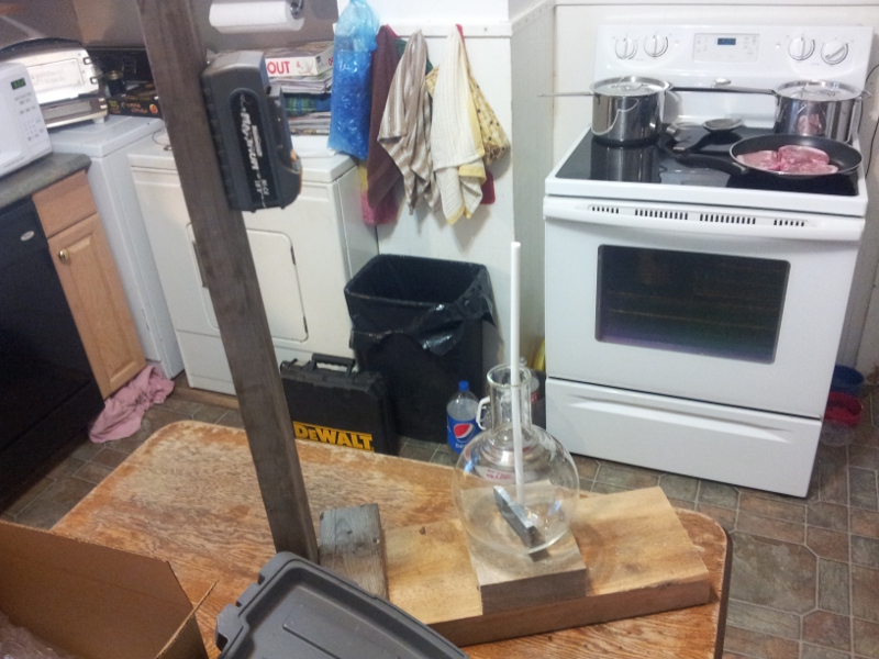

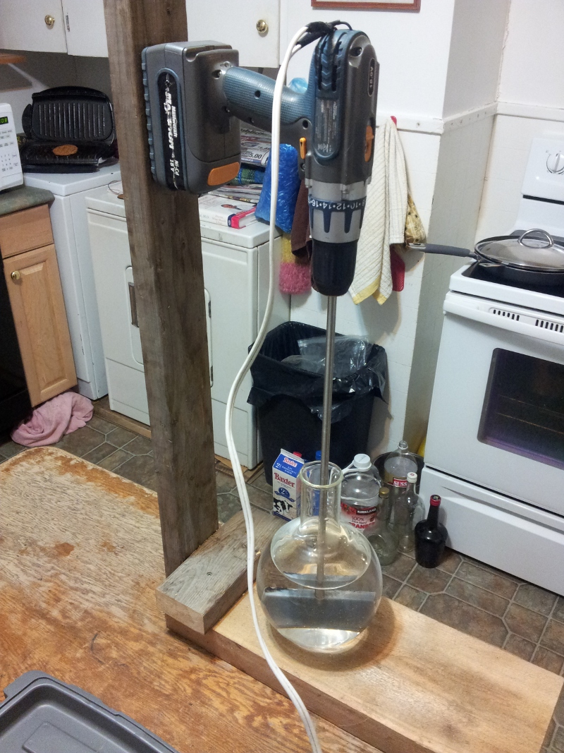

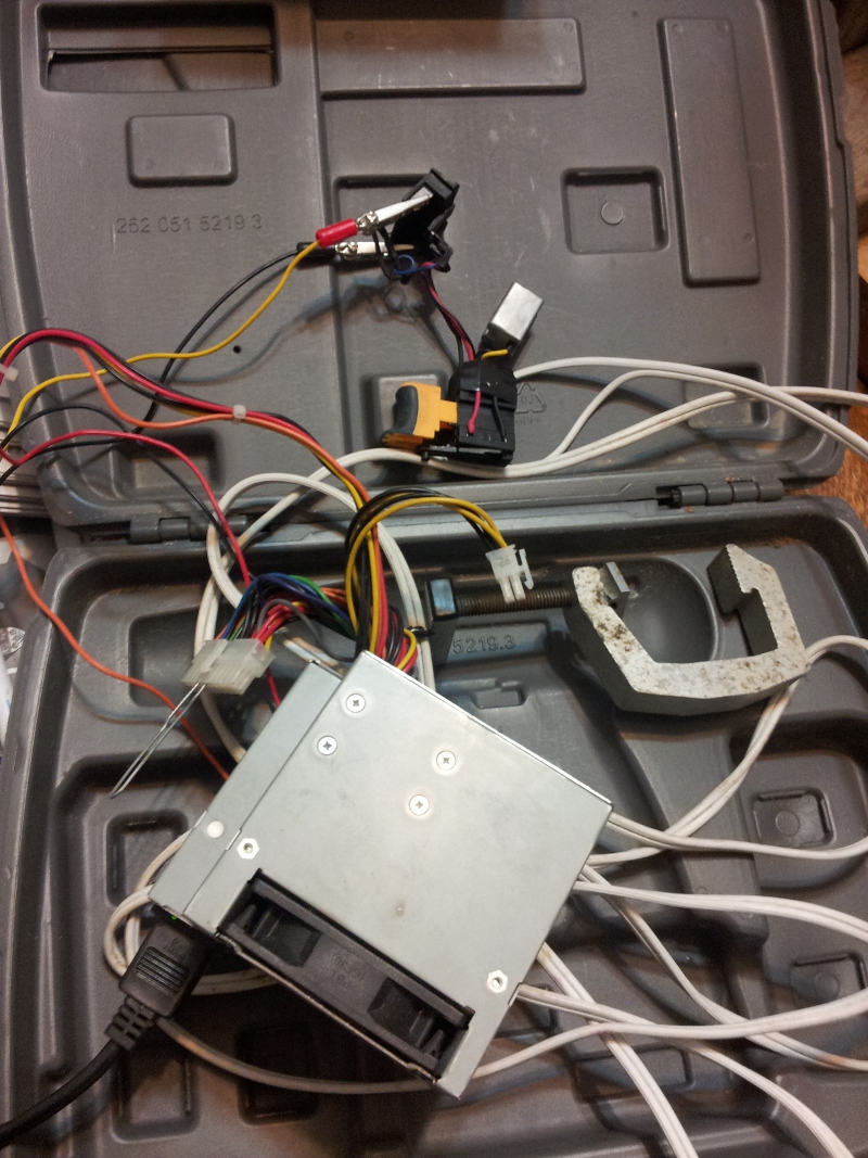

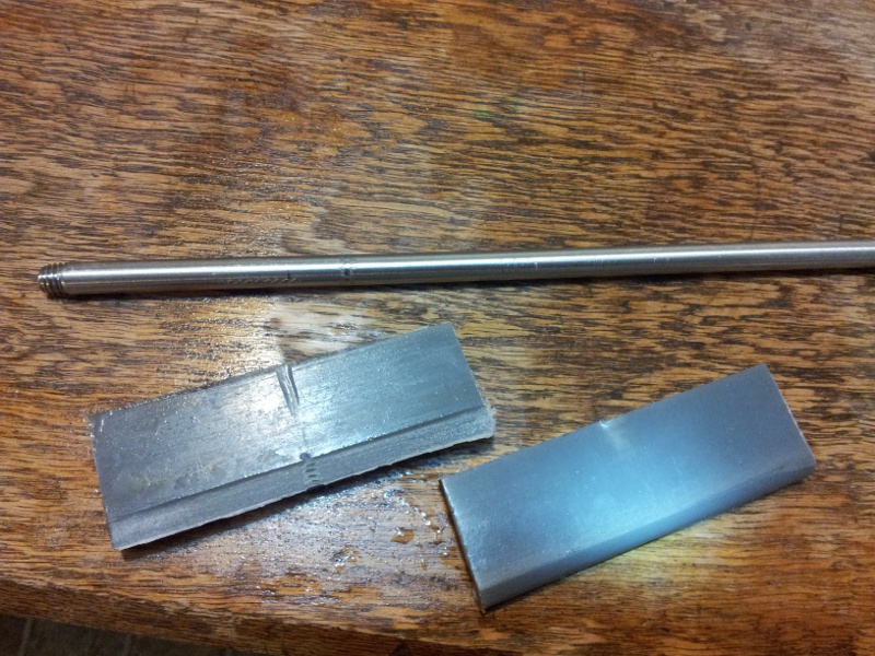

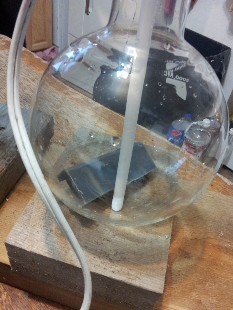

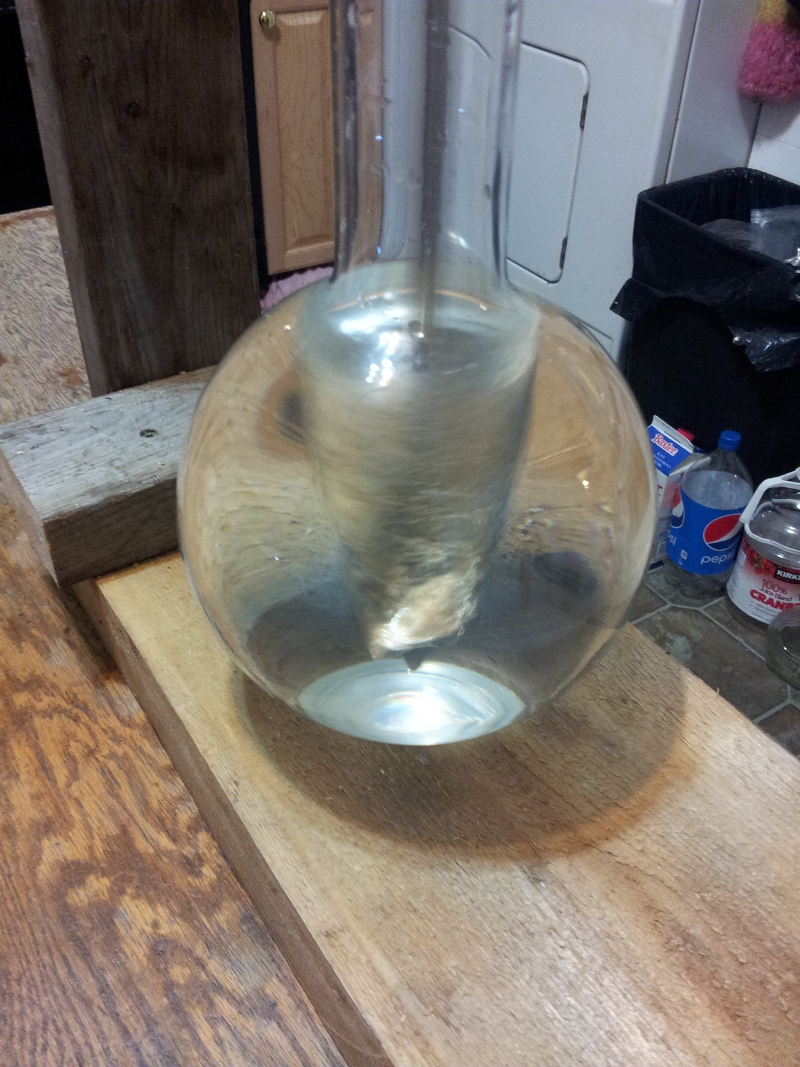

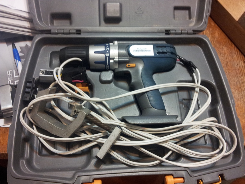

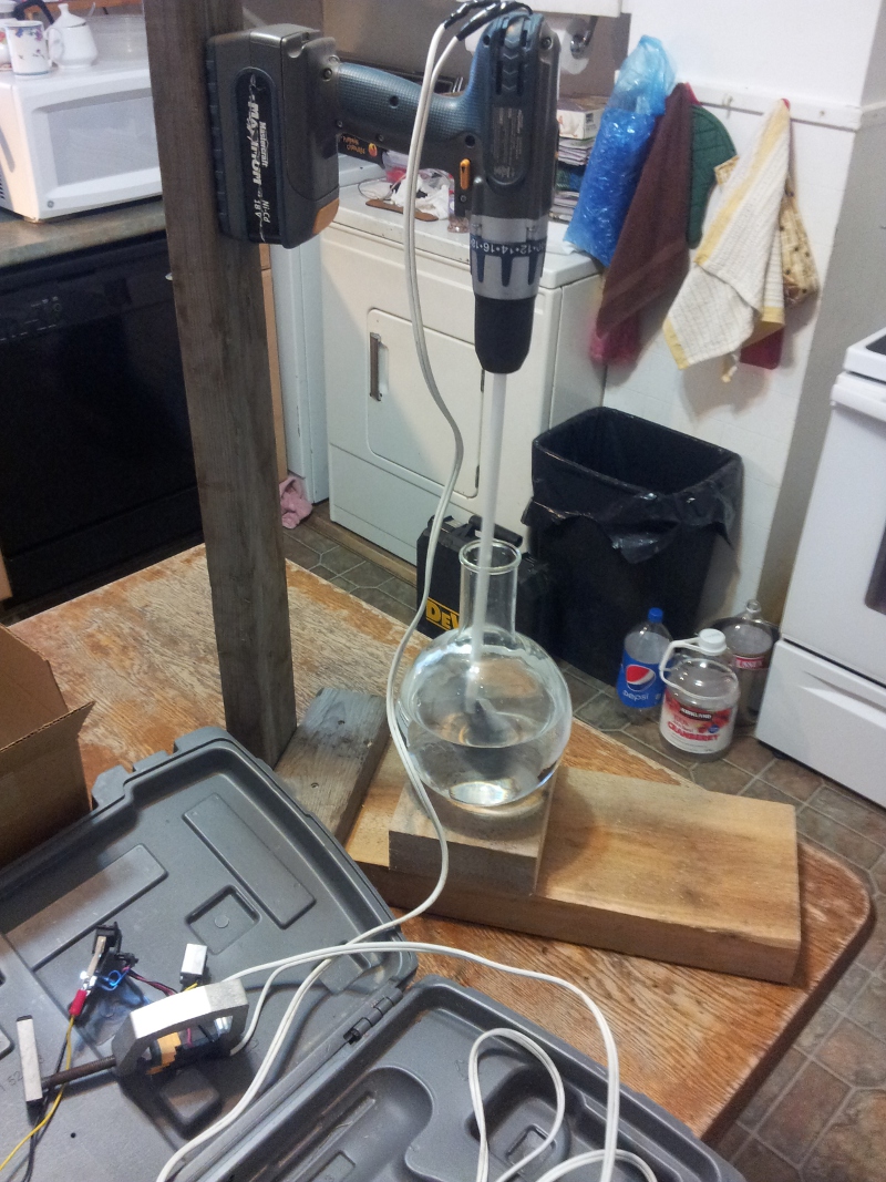

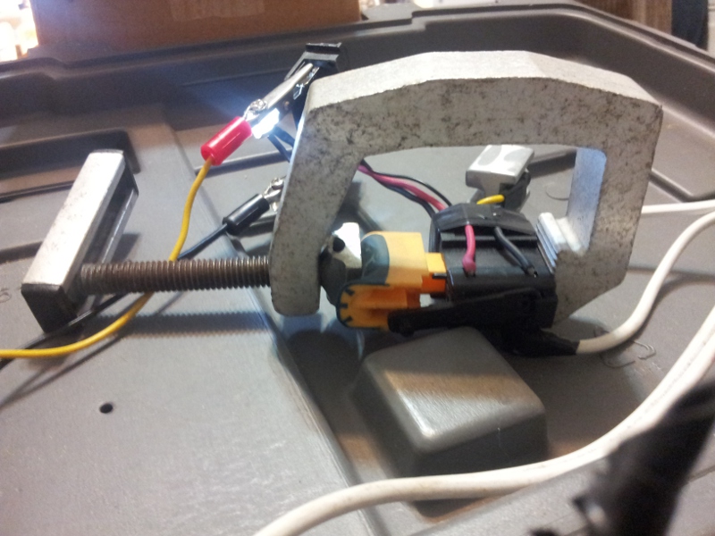

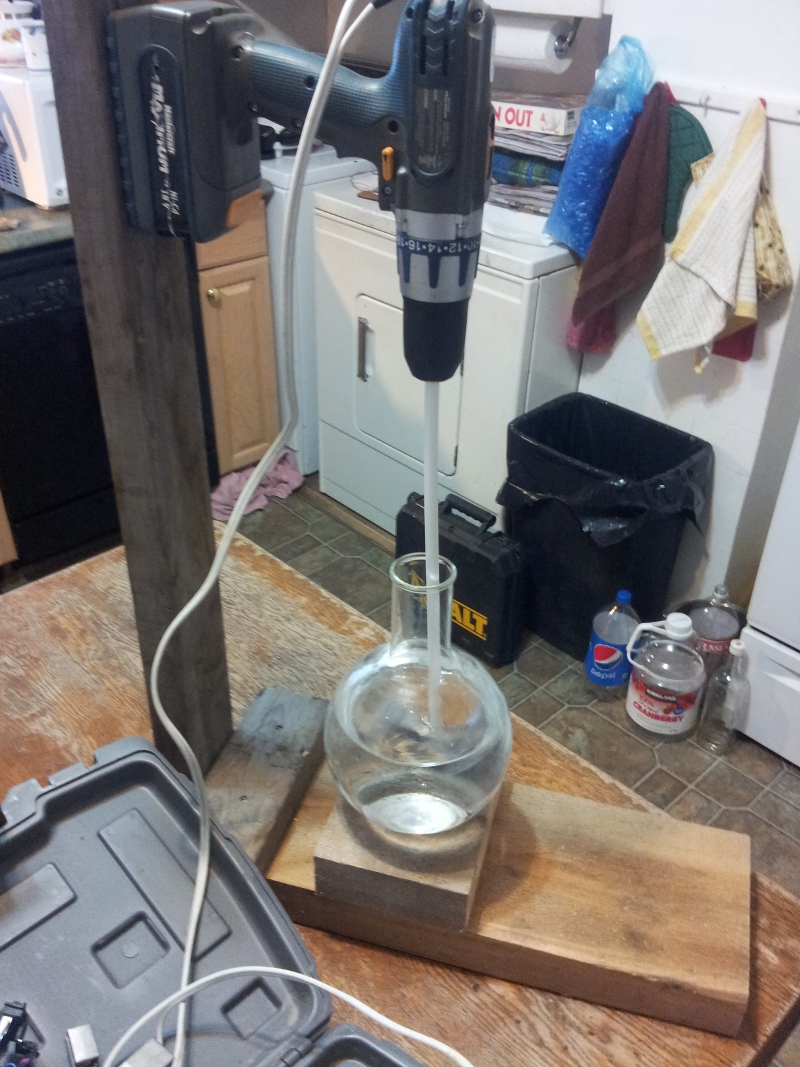

Homemade Overhead Stirrer
Thanks for the ideas. For now I am going to try and use what I have lying around though.
It isn't beautiful, but it is a good working homemade variable speed overhead stirrer with lots of power and speed. Total cost ca. $26.60 ($10 for second hand 18V cordless drill, ca. $15 for 10mm diameter Teflon rod & $1.60 for mounting hardware). Often times drills in nearly perfect shape like this can be found very cheap or free because the batteries need replacing. It is often more cost effective to simply buy a whole new drill kit than to replace just the battery or batteries. I discovered that cordless drills have very good speed control; all that is required is a way to precisely control the trigger position. The trigger position controls the position of a variable resistor in the pulse width modulator trigger module. The drill also has a high and a low speed setting on the gear head. A c-clamp was found in the junk pile which was originally designed to hold a half ton truck cap on. The c-clamp works very nicely for setting and maintaining trigger position and speed. The trigger mechanism (pulse width modulator) was removed from the drill. A section of regular household extension cord (3m long) was spliced in as an extension between the trigger mechanism (pulse width modulator) and the drill. The useless cells were removed from the battery pack and the pack casing was mounted to the vertical member of the stirrer stand; the drill can be easily attached and removed in this way. The drill is rated as 18V, but works fine from 12V providing all the speed and power needed. The pulse width modulator is rated for 9-24V and 12A. A computer power supply rated for 12V and 12A was used to supply power to the PWM. The stirring blade or paddle is put in the 2L flask lengthwise then turned sideways and threaded to the rod. A much larger paddle can be put through the neck of the 2L flask in this way. Two stirring blades were made which can both be threaded to the end of the rod together if desired. The Teflon rod has a slight bend to it, so I will be looking for something better such as a steel rod coated with Teflon or HDPE. I would imagine that HDPE plastic tubing could be used to coat or slide over a straight steel rod. A tight friction fit where the rod and paddle are threaded together could make a decent seal and prevent acid from reaching the steel rod. It is very easy to form a vortex, even at about medium speed, but the bent shaft makes higher speeds unstable. The blade is also not balanced which could be a problem at high speed. When both blades are attached together they can be installed so that there is better balance.
BTW, the "Teflon sled runner" that I obtained from a scrap yard is actually HDPE (determined by density). Checking density is a good way to help determine what type of plastic one has if it is found as salvage and the identity is uncertain.
A plastic shield could be attached to the shaft, close to the chuck, to prevent most acid vapors from reaching the drill. An exhaust fan with the inlet positioned just above the flask neck would also help prevent acid vapors from reaching the drill.
1.jpg - 259kB 2.jpg - 230kB 3.jpg - 227kB 4.jpg - 422kB 5.jpg - 439kB 6.jpg - 454kB 7.jpg - 208kB 8.jpg - 448kB

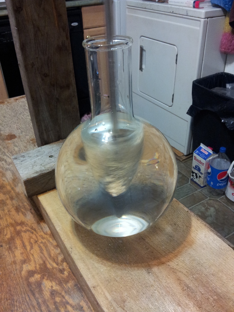

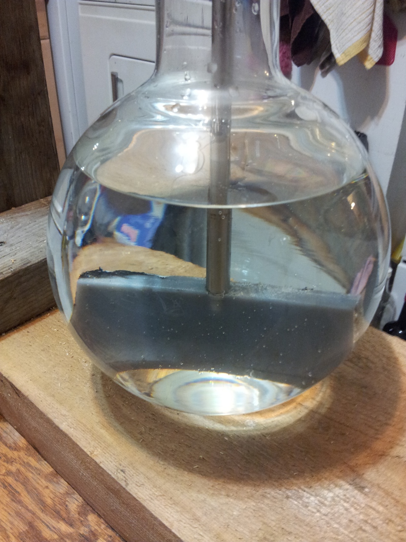

Looking at the common stainless steels, it appears as though none are ideally suited for contact with nitration acid though 304 is fair according to several compatibility tables. I picked up an 18 inch long piece of 3/8 inch diameter 304 SS from a local machine shop for about $3. The end of the SS rod was threaded with a die. The HDPE stirring paddles were drilled and tapped and made balanced by cutting off the bottom lip that the Teflon rod was threaded into earlier. With the relatively straight rod and balanced blade the stirrer can be run at high speed now with only minimal vibration.
The 304 SS will corrode in the mixed acid, but the rate should be very slow especially at the low temperatures of a nitric ester nitration. HDPE is also not an ideal material for nitration mixtures, but it too should degrade relatively slowly especially at the low temperatures of a nitric ester nitration. Also, the contact time is normally fairly brief since nitric ester nitrations are normally relatively rapid.
Here are a few pictures. The flask is 2L and contains water. The last picture is of the stirrer running at about 80% of full speed.
1.jpg - 466kB 2.jpg - 418kB 3.jpg - 440kB 4.jpg - 448kB

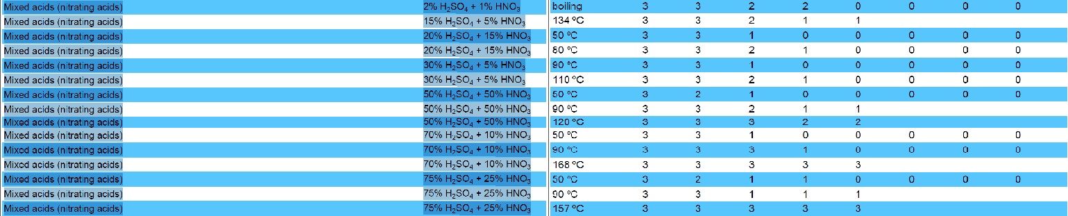

Found a decent compatibility table with lots of information for nitration acids in contact with different stainless steels at various concentrations and temperatures. From this table it looks as though 316SS is actually better than 304SS is some cases, though both appear to be very good at low temperatures.
The pdf containing the compatibility tables is attached below. The ratings include a general corrosion rate as well.
0 = resistant to general corrosion (mass loss rate <0.1 g/h · m² corresponding to a corrosion rate < 0.11 mm thickness reduction/year)
1 = slight susceptibility to general corrosion, suitable for some applications (0.1 – 1.0 g/h · m² corresponding to 0.11 – 1.10 mm thickness reduction/year)
2 = low resistance to general corrosion, unsuitable for virtually all applications (1.0 – 10.0 g/h · m² corresponding to 1.1 – 11.0 mm thickness reduction/year)
3 = no resistance to general corrosion (>10.0 g/h · m² corresponding to > 11.0 mm thickness reduction/year)
The following warning is provided for the major forms of localised corrosion
L = risk of pitting, crevice corrosion or stress-corrosion cracking, even in resistance class 0
A jpg of the nitration acid part of the table was made as well. Column 4 and 5 refer to 304 and 316 stainless steels respectively.
Stainless Steels & Nitration Acids Compatibilities.jpg - 175kB

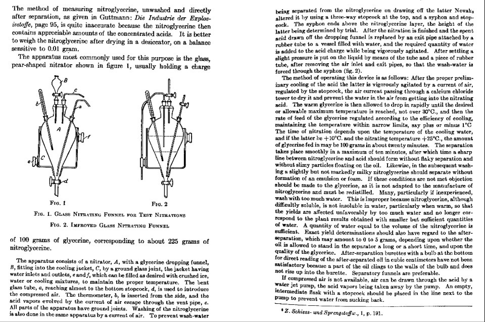

Bert
Posts: 2822
Registered: 12-3-2004
[*] posted on 23-2-2015 at 08:17
Kind of like this?
image.jpg - 314kB

Praxichys
Posts: 1063
Registered: 31-7-2013
Mood: Coprecipitated
[*] posted on 23-2-2015 at 10:19
Kind of like this?
Yes, I saw this several posts back. I believe it is also the method many manufacturers used industrially. I have not seen anyone actually use this technique in an amateur laboratory though.
It may be worthwhile investigating since amateur stirring setups are usually rigged and may involve running heavy brushed motors on cobbled-together stands, teetering over pools of high explosives/flammable liquids as they spark away, wobbling occasionally to strike the stirrer against glass...
Air stirring is also cheap. I have a fishtank pump for air sparging that cost me $7, and the tubing usually comes free with the pump.

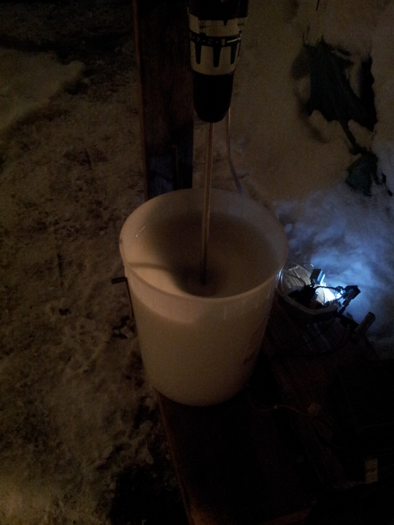

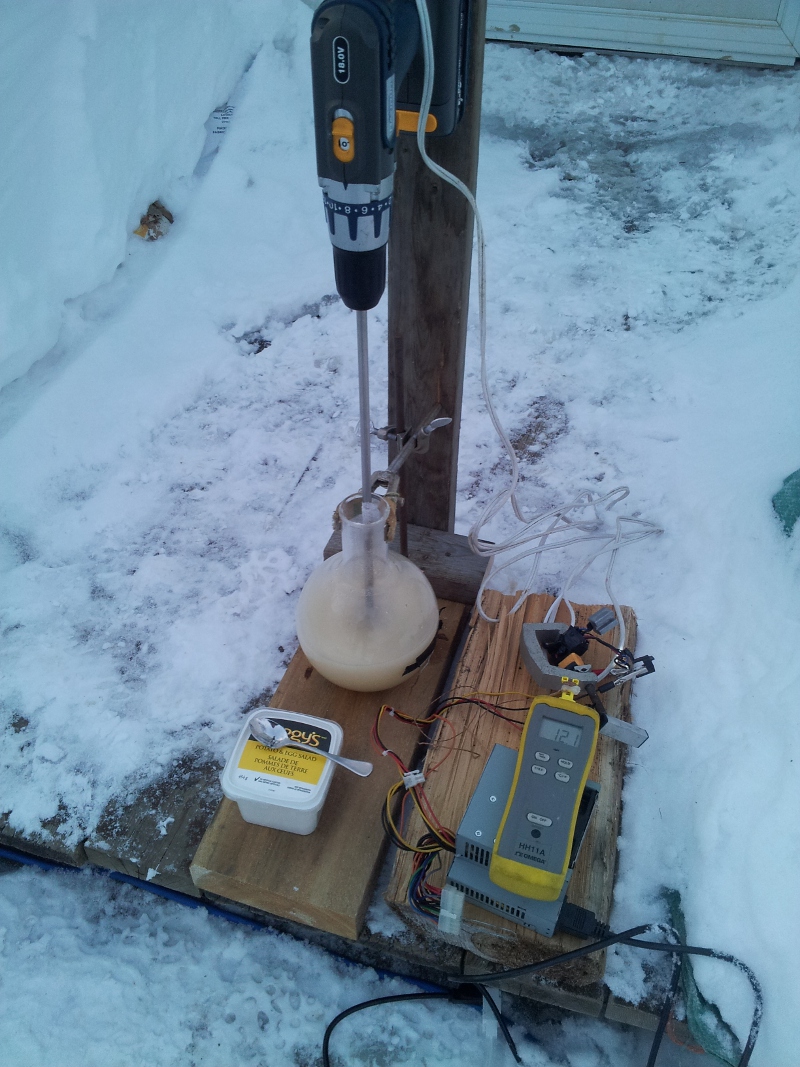

304 Stainless Steel and HDPE Held Up Well In Nitration Acid
I will just give a brief description here and possibly later something more thorough with more pictures in an ETN thread. A mixed acid was made from 600g of ammonium nitrate, 900mL of 91% sulfuric acid and was used to nitrate 150g of erythritol in a 2L flask. Mixing was provided for nitration, dilution and washing stages by the previously built overhead stirrer. The HDPE blade and 304 SS shaft were in contact with the mixed acid for about 2 hours and there appears to be no visible damage whatsoever. The tool marks, which are visible in the picture, are the result of my sloppy work earlier during construction. The temperature of the nitration never went above 15C which is ideal from a corrosion prevention perspective.
Addition of the 150g of erythritol was done over the course of about 30 minutes. No supplemental cooling was used. The ambient temperature was about -5C, which is a different situation entirely from performing the reaction in the summer with an ambient temperature of +30C for instance. Using this type of mixed acid and coarse crystals of erythritol (about the size of granulated white sugar) this reaction is very easy to control; very slow and gentle if a little care is used. Supplemental cooling or slower erythritol addition would be required in a hotter environment.
It is very possible, and would not be much more difficult, to make a pound of ETN at a time with this arrangement. A 3L or larger flask should be used, however, and a 20L pail should be used for dilution and washing as well.
3.jpg - 432kB 6.jpg - 327kB
